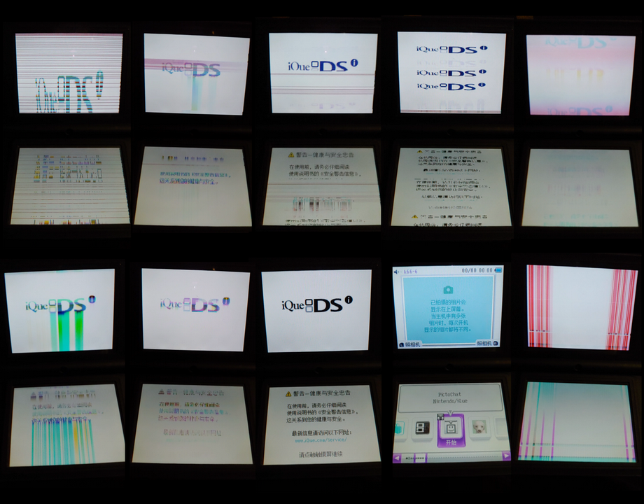

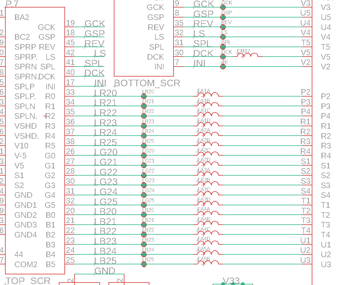

Console boots to Black Screens, but the console is otherwise functional (can hear sounds of navigating menus.
  • (0) (Confirmed) OP replaced the bottom screen, and reseating the display cables fixed this issue.

Bottom Screen flashes, but console powers on with the console fully open, and works normally.
  • (0) No Solution

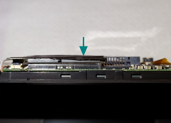

Console shuts off when Changing the Brightness.
  • (0) No Solution Found
Console shuts off when the back is tapped.
  • (0) (Confirmed) Cleaning the battery contacts.
  • (1) (Confirmed) Adding double sided tape to the battery to hold it fixed the issue
  • (2) (Confirmed) Using a piece of card stock paper between the battery and the battery door to keep the battery from moving unexpectedly.
  • (Personal Story) Could be a faulty/dirty gamecard slot and/or Pins. When tapping the back of one console I have, the gamecard would vanish from the main menu. While in the main menu, the console won’t turn off, but if a gamecard is being played, the console will think the gamecard was ejected. A similar effect can be observed when lightly pressing the gamecard and shifting it left and right in the gamecard slot. Might be the pins are pressed down overtime.
  • Loose/ Faulty battery
  • Dirty/bent battery contacts.

Screen Related Errors. Console is Fully Functional, but There are Errors in the Displays.
Color Related
Colors are fine at first, but after about 20 minutes, the color invert on the top screen.

Colors are fine at first, but the screen fades to white.
Colors are fine at first, but after about 10 minutes, the screen fades to white.
  • (0) (Confirmed?) Potentiometers
  • (1) No Solution Found
  • (1) (Information) “If it powers on OK and transition into that, the LCD is probably ok. Best case bad capacitors, just replace them. Worst case, bad regulator which need skills to diagnose.” - u/DesignerKey442
Top screen colors are inverted.
  • (0) (Confirmed) Adjusting the potentiometers for the top screen.
  • (1) (4) (Theoretical) Adjusting the potentiometers for the top screen.
  • (2) (3) (5) No Solution Found.

Fading, Flickering, or Vignetting.
Vignetting on one or both screens.
  • (2) (Theoretical) Try adjusting potentiometers.
  • (4) (5) (Theoretical) Replace Screen.
  • (0) (1) (3) (6) (7) (8) (9) (10) No Solution Found.

Flickering both screens.
  • (2) (Confirmed) Adjusting the screen potentiometers resolved the issue. Not sure about long term viability.

Dark screens rapidly pulse bright lights. Scanlines.
  • (0) (Theoretical) Adjusting potentiometers
  • (0) (Theoretical) Replace Shoulder Button ribbon cable assembly.

Top Screen fades with “Flickering Lines”
  • (2) (2) (Confirmed) Adjusting potentiometers.

Artifacting, Dead Pixels, and Light Bleeding.
Top screen Stuck Pixel(s).
Top screen Stuck Pixel.
  • (0) (Confirmed) The LCD Display was fine, but the screen lens had a scratch creating the appearance of a dead pixel.
  • (1) (Confirmed) OP was able to fix a stuck pixel cluster on a 3DS by putting the console in the freezer. (I would not try this)
    • Procedure:
      “You can try putting your 3DS (do not include the battery) in airtight container in the freezer for a certain amount of time. In my case, I left it in there for 24 hours, and guess what? The dead pixel is gone!! Before turning 3DS on, I let it sit at room temperature for 30 minutes and wiped it with a tissue. So far, the 3DS has turned on like normal—everything works fine, including the sound, screen, buttons, card slots, charging port, and Wi-Fi.” - u/Maguma190
  • (2) (Theoretical) Try running a pixel fixer, but the screen may just need replacing as I don’t think it’ll get better.
  • (3) No solution Found
Top Screen artifacting.
Sources: (0 0)
  • Maybe caused by R4 card with a dodgy kernel according to the OP.
  • It was fixed when the console was left off overnight. Pulling the battery may also fix it.
Top Screen has colored vertical lines.
  • (0) (Theoretical) Top screen is damaged, and needs to be replaced.
Top Screen has horizontal white lines.
  • (0) (1) (Theoretical) Needs new screen.
  • (2) No Solution Found. This is a bit on an unusual case as it only appears in games. Not in the main menu or Twilight Menu.
Top screen has dark specks.
  • (0) (1) (Theoretical) Dust below top screen lens.
  • (0) (Theoretical) Dust or damage within the LCD display. Since there is a White Spot in OP’s console, it’s possible that display need replacing.
  • (2) (Theoretical) Possibly a scratch on the top screen lens. Hard to tell.
  • (3) No Solution Found
Top screen is dark with some white horizontal bars.
  • (0) (1) (Theoretical) Top screen needs to be replaced.
Grey gradient discoloring on Top Screen.
  • (0) (Confirmed) Replacing the 4 Filter Arrays (Labeled FA1-4) for the top screen. These are located above the Wi-Fi Card plug.
Bottom screen has a white vertical line.
  • (0) (Theoretical) Needs a new screen.
Parallel Lines on the Bottom Screen.
Sources: (0)
  • Could be potentiometer related.
  • Probably requires a new screen.
Backlight bleed on the bottom screen.
  • (1) (2) No Solution Found
  • (2) (Information) “The "glitters" are just backlight 'light bleed' from the bottom screen. The screen border thing is supposed to prevent this but some little paint had chipped away I guess and thus letting some light pass through.” - u/scv_good_to_go
Sources: (0)
  • Some of the bleed was lessened by “twisting” the shell. It could mean there needs to be more pressure behind the bottom screen. Maybe a pad or something.
One or both screens have scanlines.
One or Both screens have scanlines.
  • (1) (Confirmed) Adjusting potentiometers.
  • (0) (Theoretical) Though OP didn’t confirm it, I am extremely confident adjusting the bottom screen potentiometer will fix the issue.
  • (0) (Information) “The “varistors” or “variable resistors” are named VR1 and VR2. The VR1 controls the pulse width or frequency (not sure which) of the signal going to the top screen and VR2 corresponds to the bottom screen. Adjusting them has the effect of adjusting the flicker, appearance of lines, or in some cases, the saturation of color. As far as I know all of the DS handhelds from the original DS to the newest 3DS have these two varistors.” - u/graysky311
Both Screens are “Glitchy” and unusable.
Sources: (0)
  • (0) Reseating the ribbon cables and adjusting the potentiometers didn’t do anything. I believe the should button ribbon is faulty, but the images on the screen are well beyond anything I've seen before in relation to potentiometer faults.
One or both screens have white cloud over the picture.
  • (0) (Theoretical) May require screen replacement. Not a whole lot of information to work with, but it is unclear the extent of the damage until the screen lens/digitizer are removed. I have heard of fungus growing in the screens, and though it could be a niche case, I don’t have enough information to declare that.

I've fixed discoloration of the top screen (yellow/magenta/blue lines) on non-xl dsi by replacing all coil arrays(i presume) labeled FA on the board that lead to top screen from the donor board, then did a charge cycle.
Reactions: k66 and KIlly728
That is interesting. I assume you are referring to cases like this with colored lines in the display?
I always assumed that to be damage to the LCD display. I spot 4 components labeled FA (FA1-4) that have traces leading to the top screen. I won't pretend to know what they are.
Checking the schematic, they are intercepting the lines from the main CPU. I suppose it would make sense for them to create issues.
Reactions: k66
Not quite, my lines were horizontal and most prominent on greys, altering colors between blue and yellow(1st photo shows discoloration on gray gradiends, and both rectangles(Prev, Next) on 2nd photo should be gray). I'm pretty confident that it's not the display and not the connector, because i've resoldered the connector before with no change and also tested this motherboard with different display. Also this "new" motherboard was pretty rusty, i guess that's what you get when buying boards from aliexpress >_>

I often encounter people asking about the 00 time and date issue, and today I encountered it too.
My DSi problem:
1.Unable to power on, both screens are black, blue LED stays on.
2.Press the Wi-Fi board, this will warp the motherboard, DSi can access the system. If pressed lightly, various graphical glitches will appear on the screen, and the sound will disappear.
3.The date and time are all 00.
4.Opening any app(&system settings) results in a black screen with white text error.
Tests performed:
Remove cart and SD card.
Restart the DSi several times.
Remove the battery, put it back in half an hour, and then try turning on DSi.
Check all cable.
Reseat Wi-Fi Board.
Replacement Wi-Fi Board.
Boot using an ntrboot cart, unable to start ntrboot.
You can start ntrboot even without a Wi-Fi Board. If ntrboot cannot start, I think maybe a certain trace on the PCB has a bad connection, or a cold solder joint on the CPU or RTC chip.
Strangely, this DSi is a idle console. I tested it a month ago, and it was working perfectly. Then keep it as it is and place it in a sealed container with a desiccant.
Solution:
- Replace the motherboard.
- Heat or re-solder the CPU/RAM/RTC/NAND chips.
These graphical glitches look pretty cool:rofl:
Reactions: KIlly728
Thank you for the additional information. I haven't encountered, or at least noticed it with any of the faulty motherboards I have.
I did find this part to be most perplexing. In various tests I did to try and find a solution to "An error has occurred" on application launches, or code 0000FEFE, pressure on the wifi board didn't result in any of these graphical issues (it often didn't fix the error code, but it was worth a shot).
Reactions: k66
I uploaded a video.
The unstable display is because I am massaging the motherboard(Press the Wi-Fi board):yaynds:.
Because this glitch graphic is really cool, I don't want to fix it for now. The solution I provided on #37 is to replace the motherboard.
It might be fixed by heating the CPU/RAM/RTC/NAND chips.
Reactions: KIlly728
