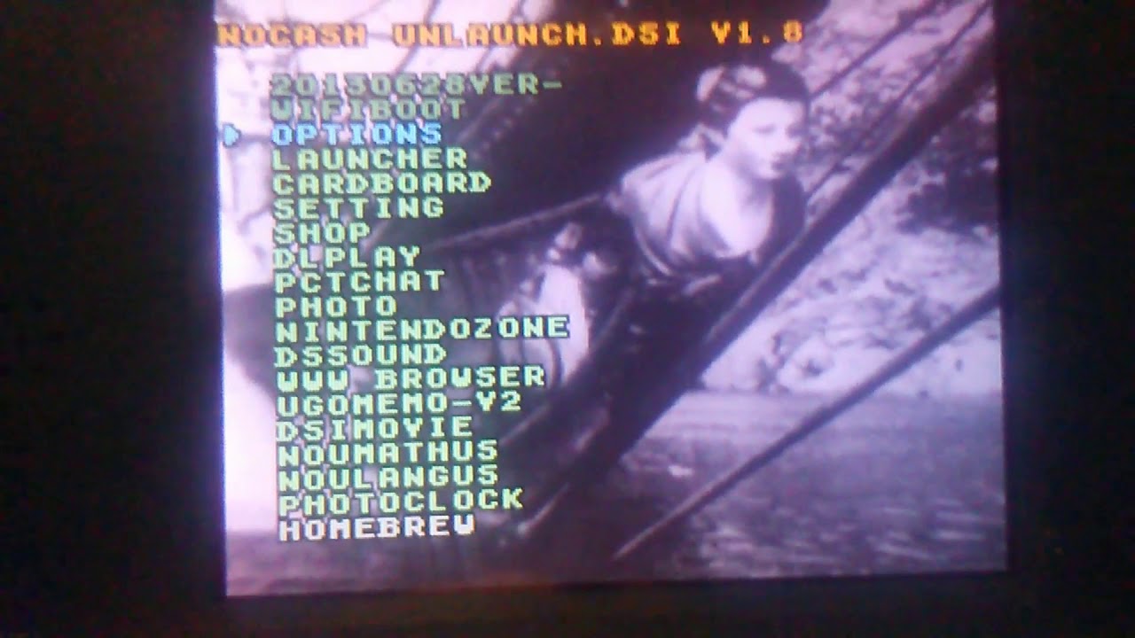

Can you please post a picture of your Startup Unlaunch screen with an inserted Game Cartrige please ?
Like this:
Thank you.:)
I have a Flashcard inserted in the console but also gives the problem with original cartridges
Tengo una tarjeta Flash insertada en la consola, pero también me da el problema con los cartuchos originales
Thank you.:) (please stay on english language to help you further.Thank you).
Ok that looks not good.:(
I recommend you to try more original Game Carts to get sure nothing is wrong with your Gamecart DSi Slot.
Please look evertime on Unlaunch if it is "mutilated" again like on your Screen on the top on the Unlaunch Menu.
