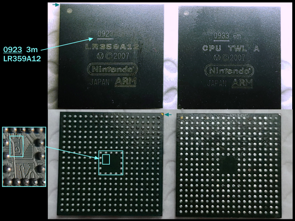

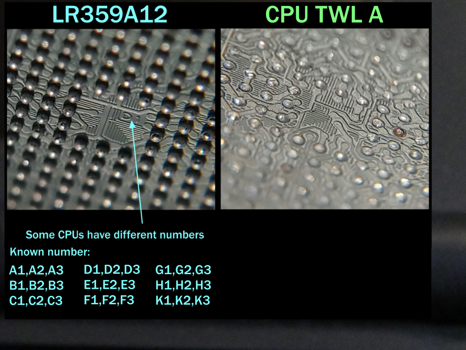

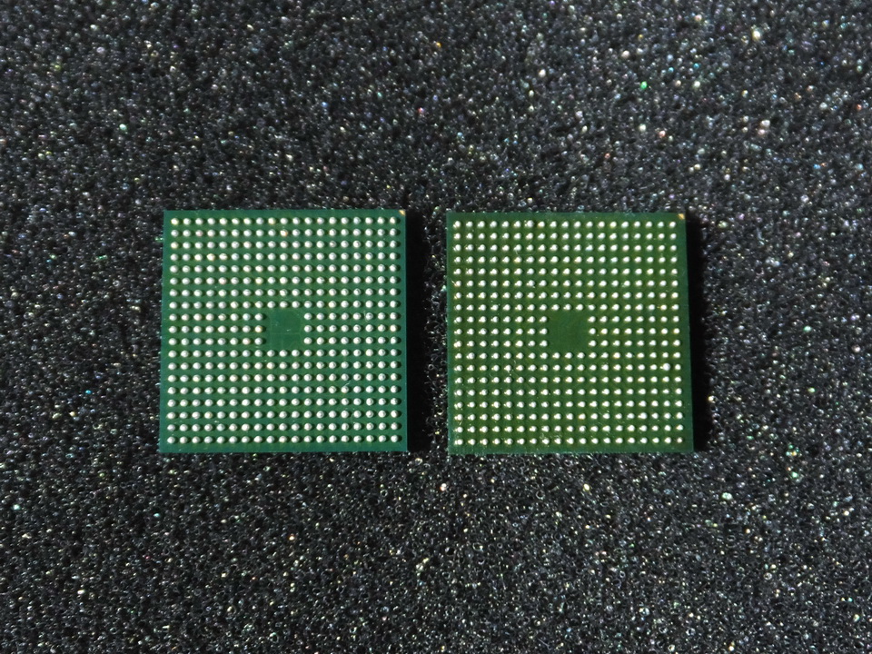

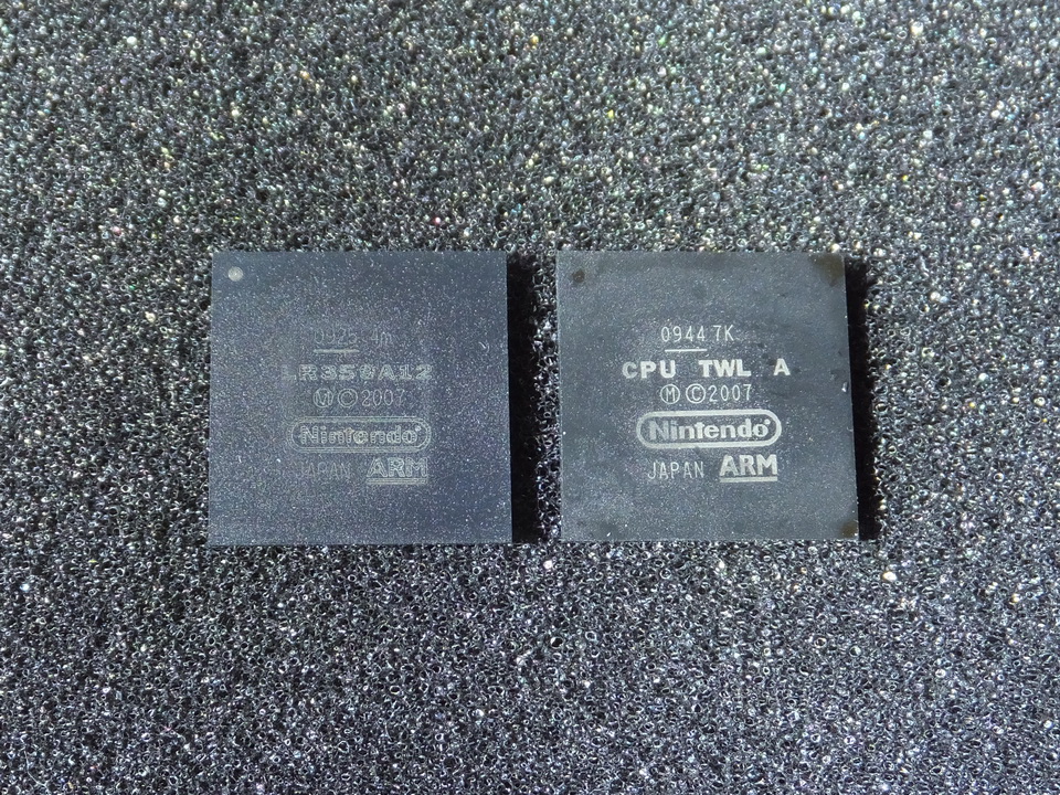

I noticed there are some differences between the substrate of 'CPU TWL A' and 'LR359A12'.
Are there any other differences between these two CPUs?

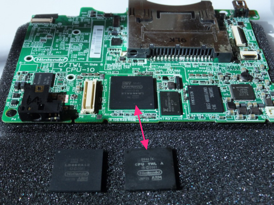

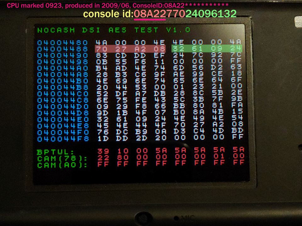

Not long ago, one of my unused DSi had a graphical glitches, it seems the CPU has a cold solder joint.
I went ahead and replaced it, just for fun:yaynds:
(Click the image to view original)
The CPU I replaced

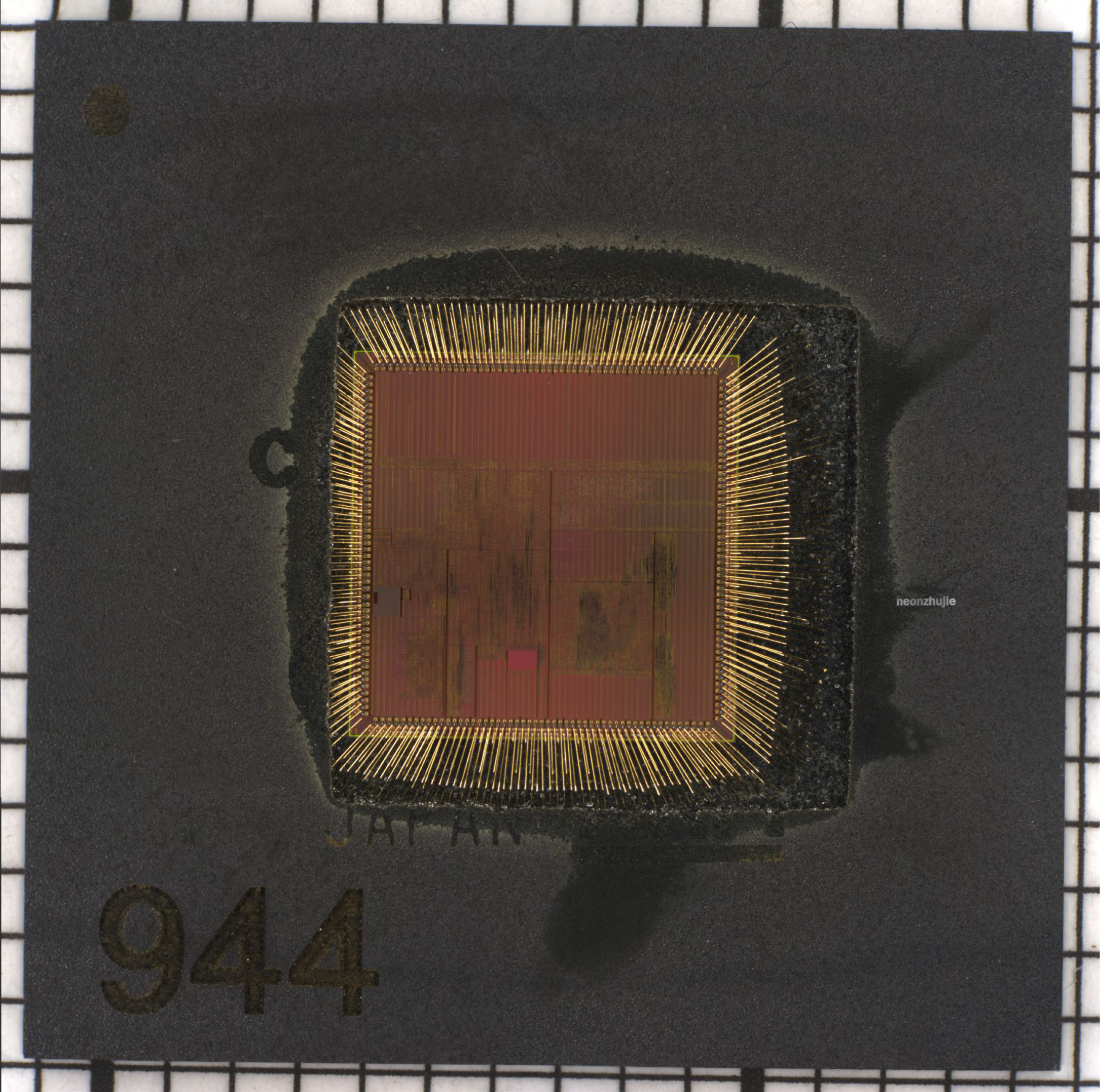

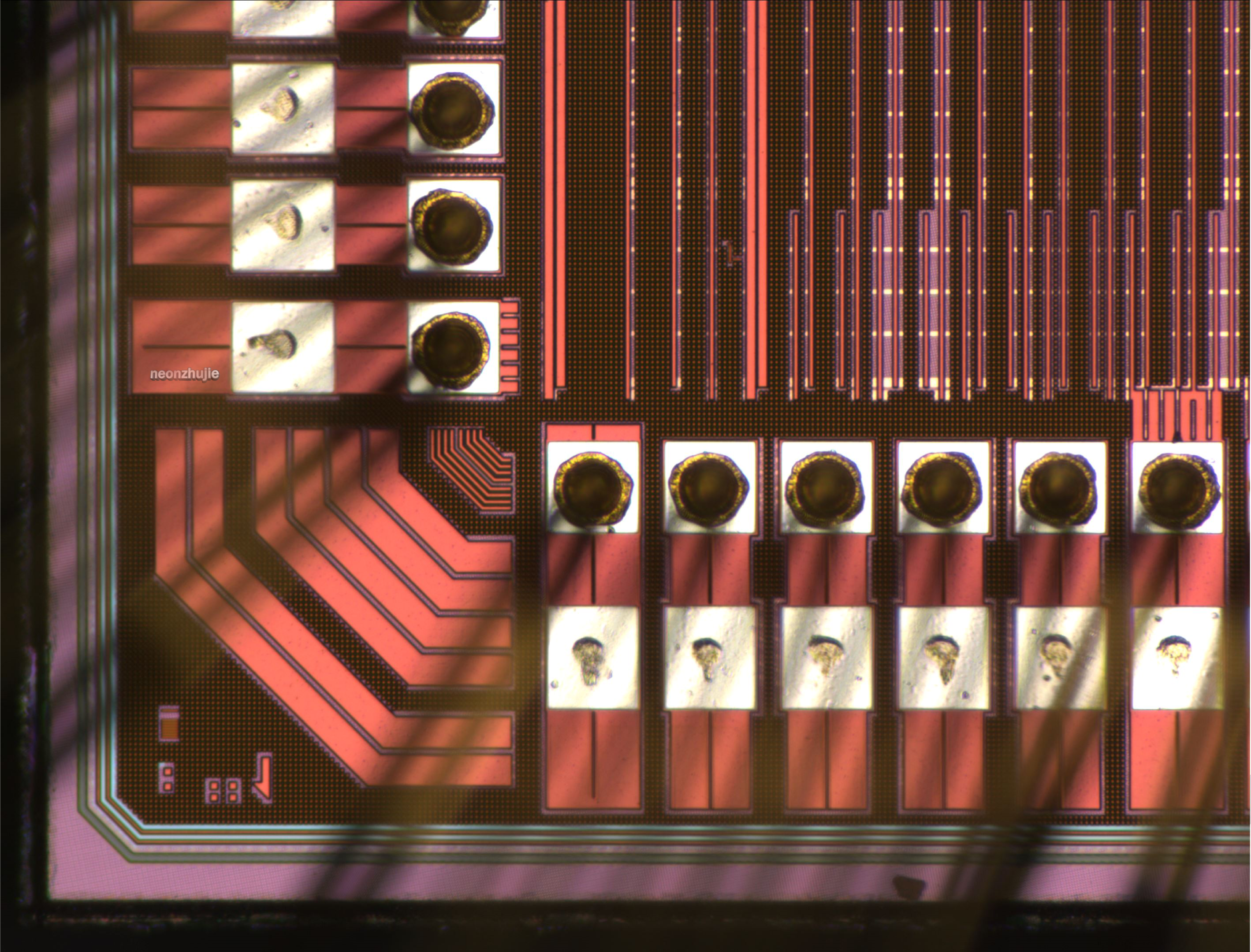

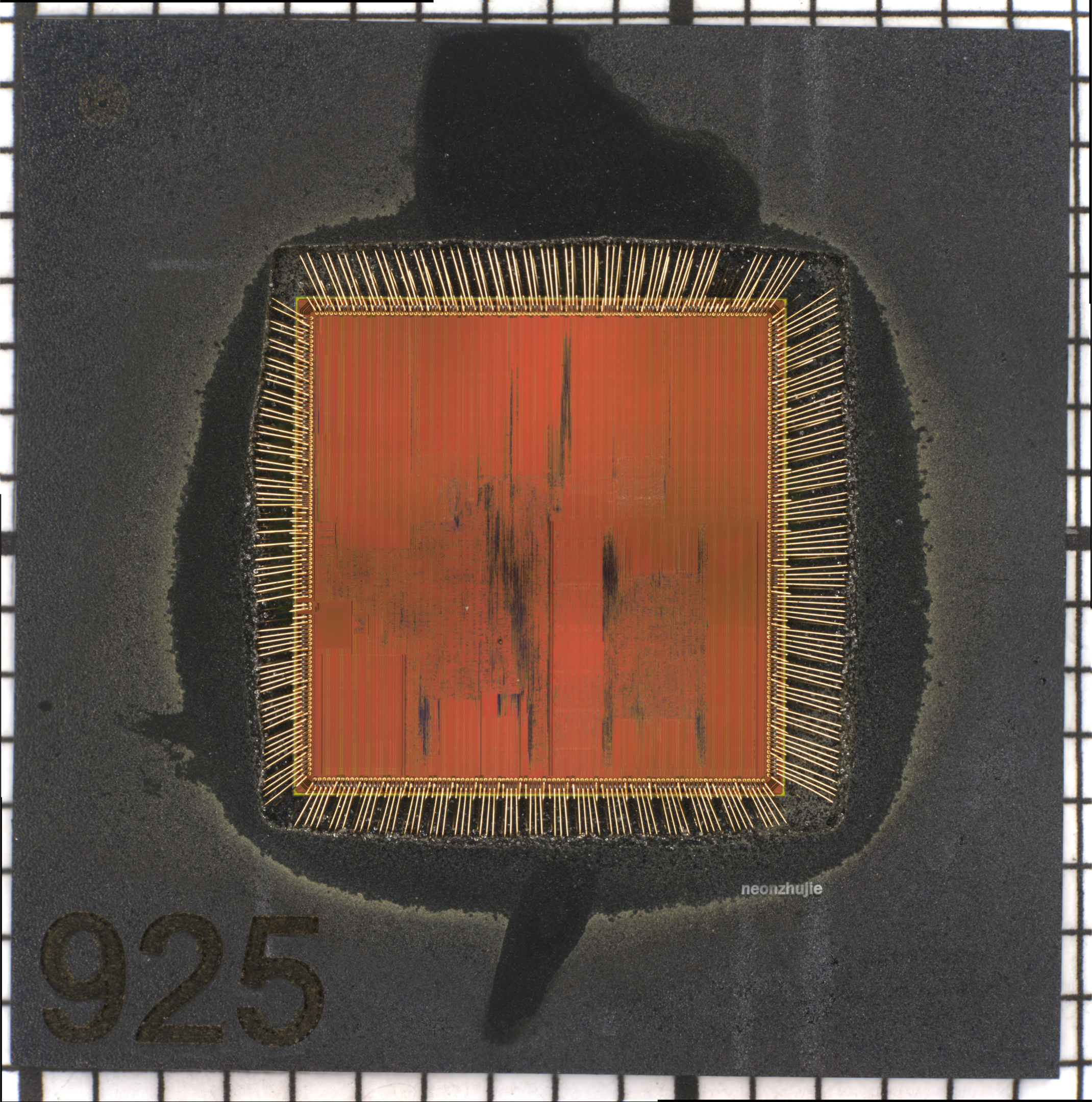

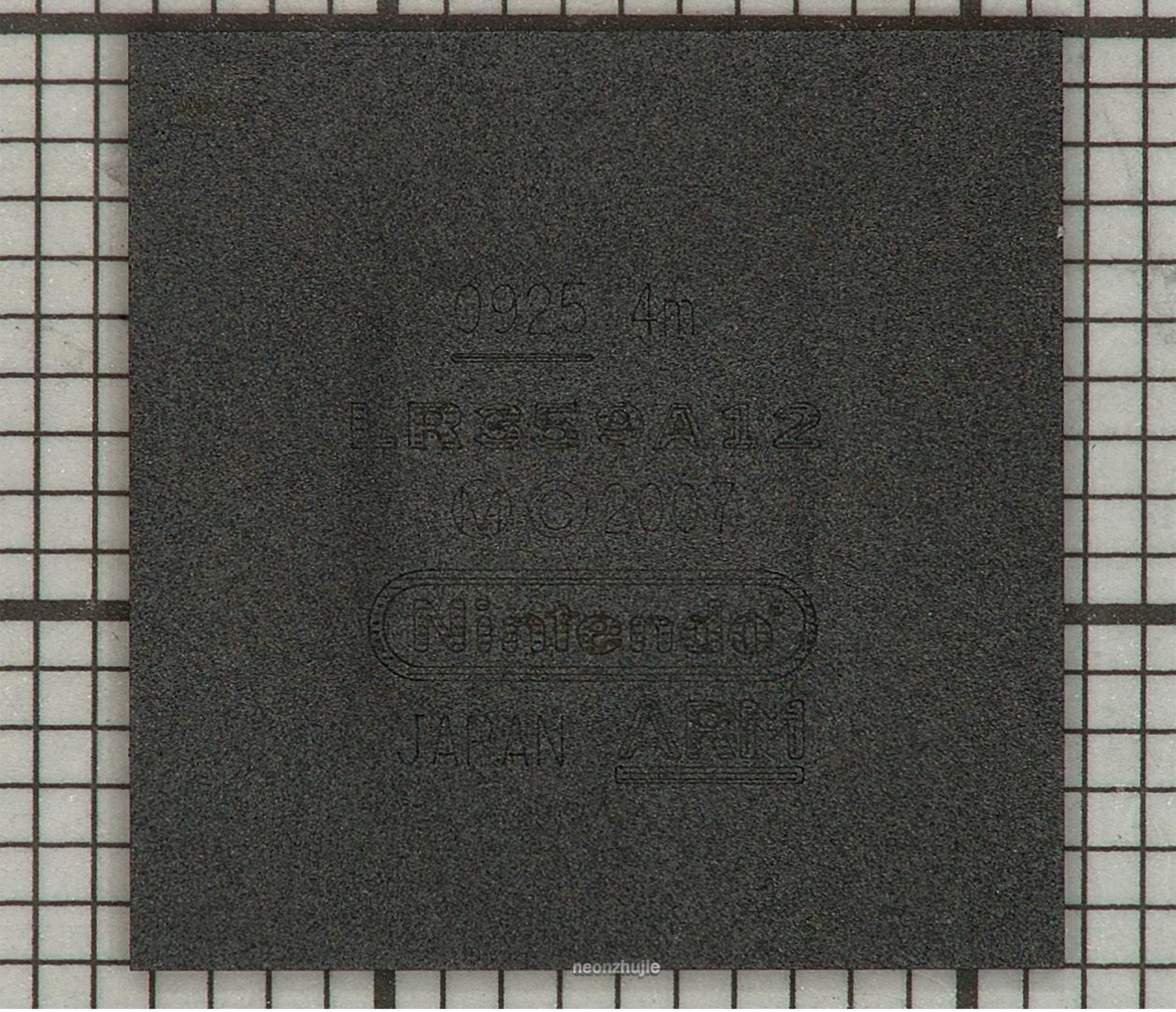

- CPU: LR359A12 , "0923 3m", produced in 2009/06?, console ID:08A2277024096132
Then I had a professional take CPU dieshot.
(The CPU size is measured manually and may have some error)
The CPU on the right

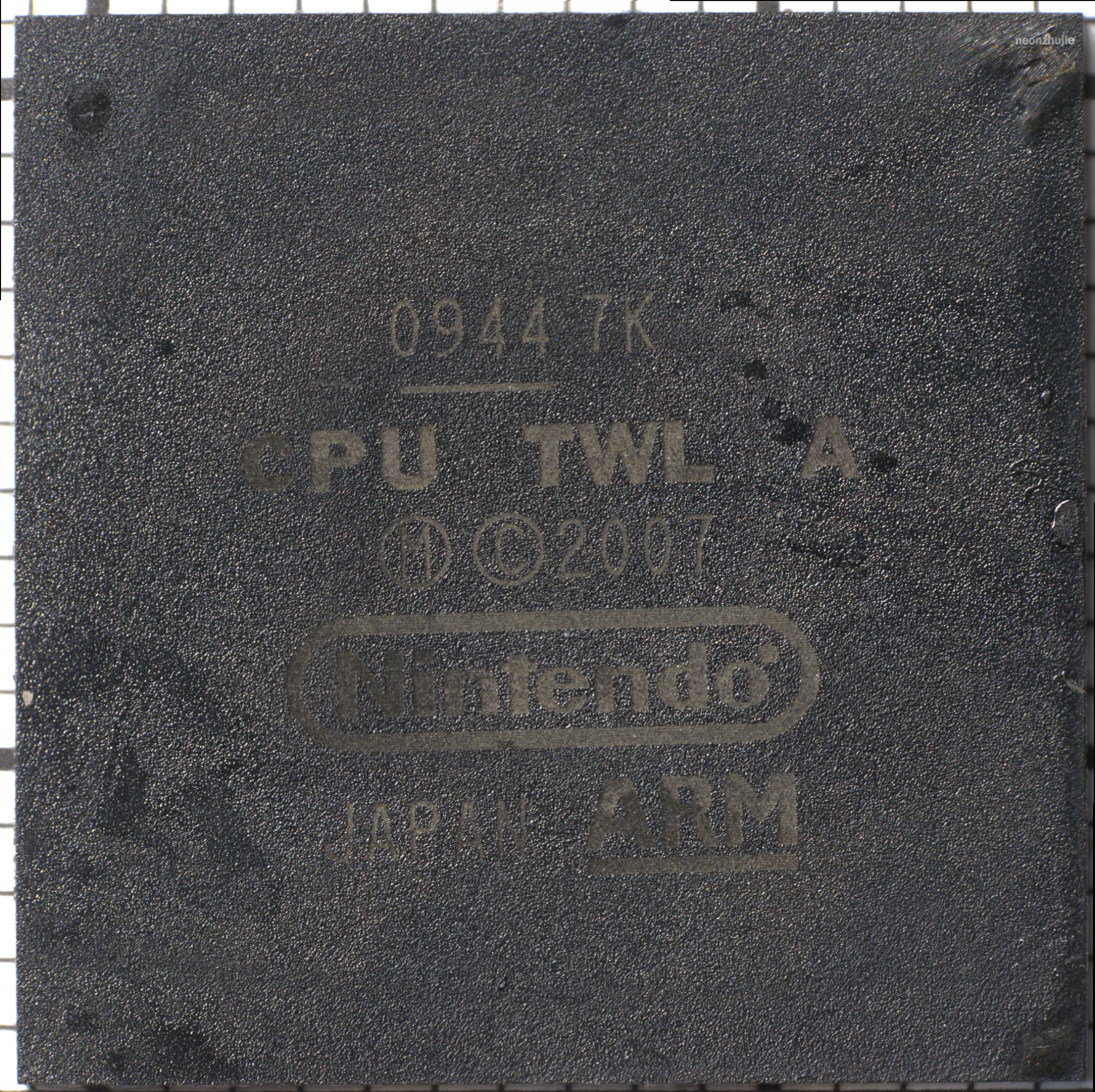

- CPU: TWL A , "0944 7K", produced in 2009/10?, console ID:0820150305099126
- iQue DSi, TCF100264951
- board C/TWL-CPU-10
- Wireless card DWM-W024
- eMMC CID:BC847011EF034D303046504100001500, produced in 2009/11, NAND product.log date 2010/01/25
The CPU on the left
- CPU: LR359A12 , "0925 4m", produced in 2009/06?, console ID:08A*, substrate number "D2"

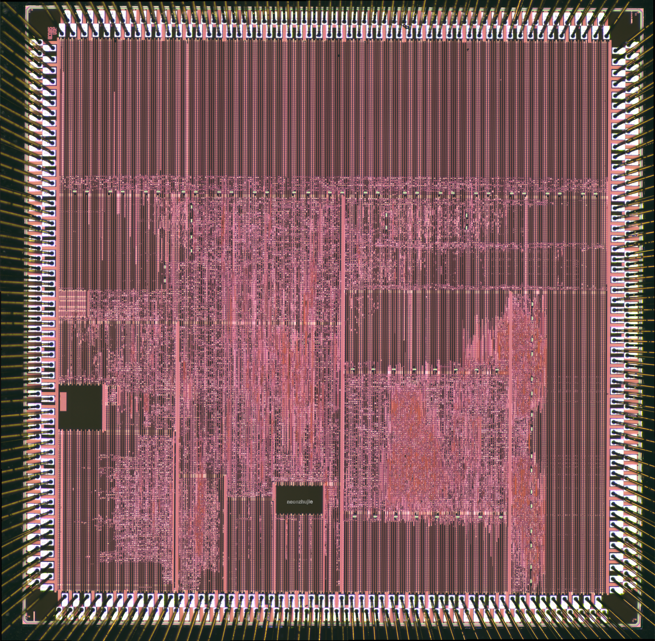

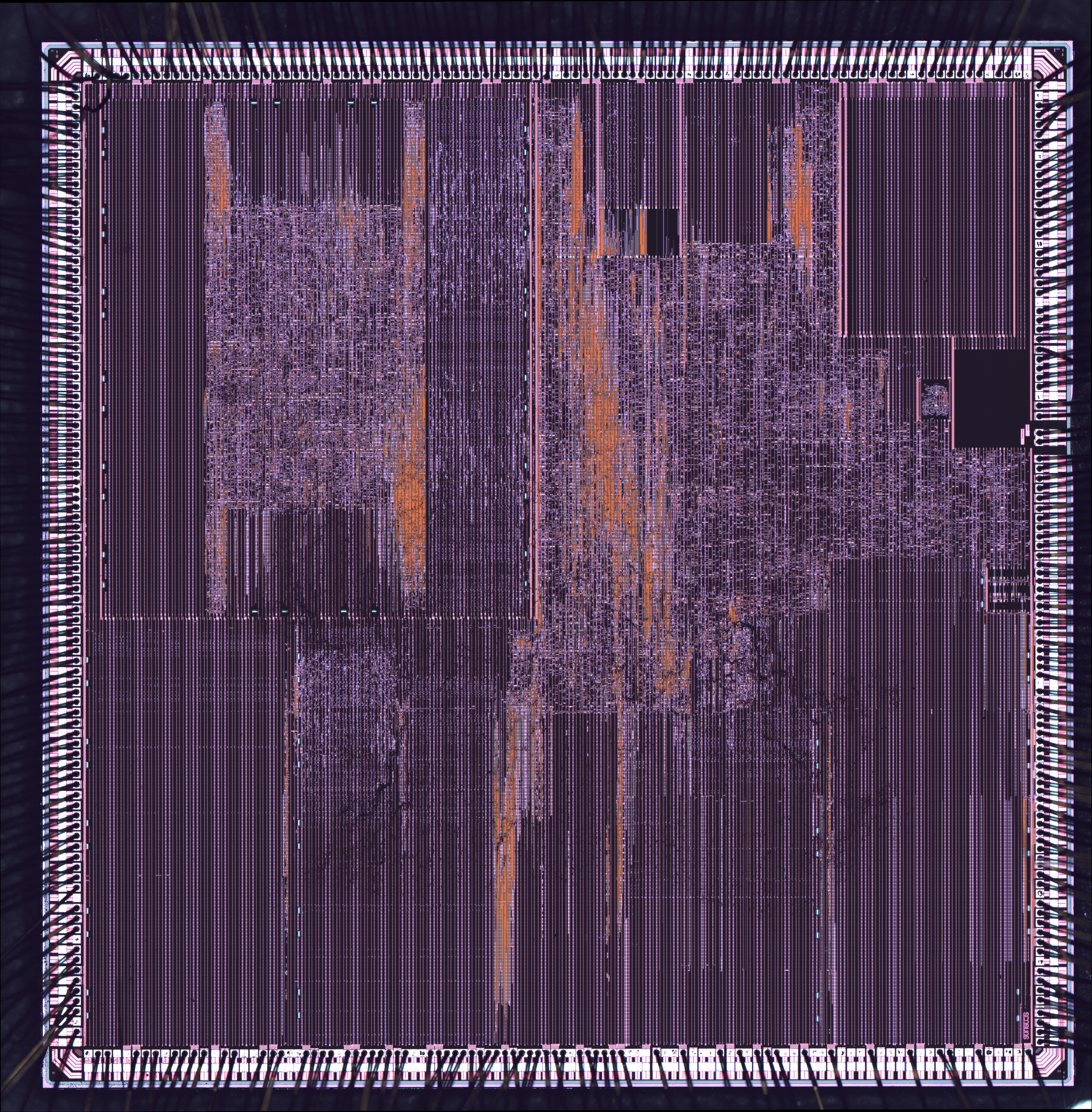

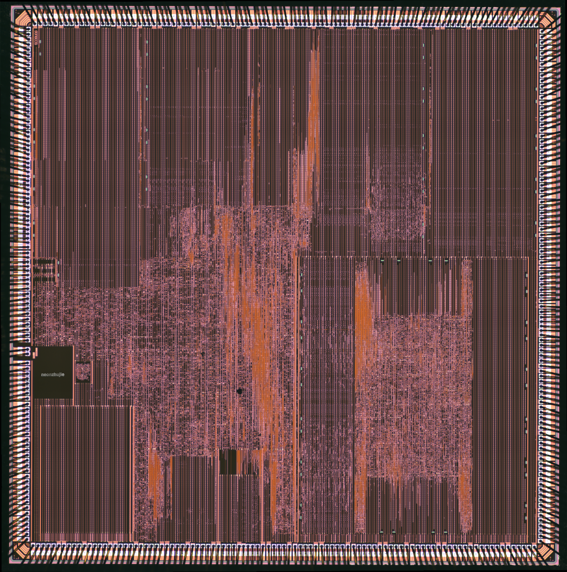

This afternoon, I received dieshot.
(The original image is very large, and I don't know the forum's upload limits, so I resized the image)
(Click the image to view)
They are indeed different:O.

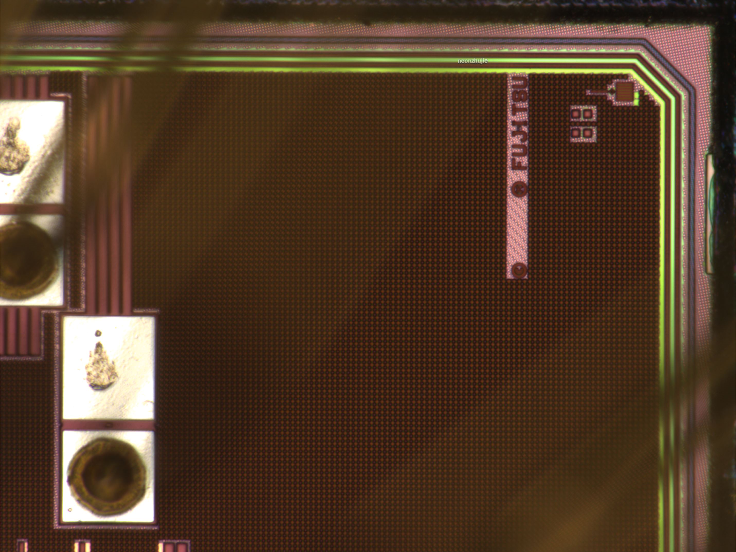

The core of the ‘LR359A12’ is larger than that of ‘CPU TWL A’.
...LR359A12 (left)......CPU TWL A (right)...

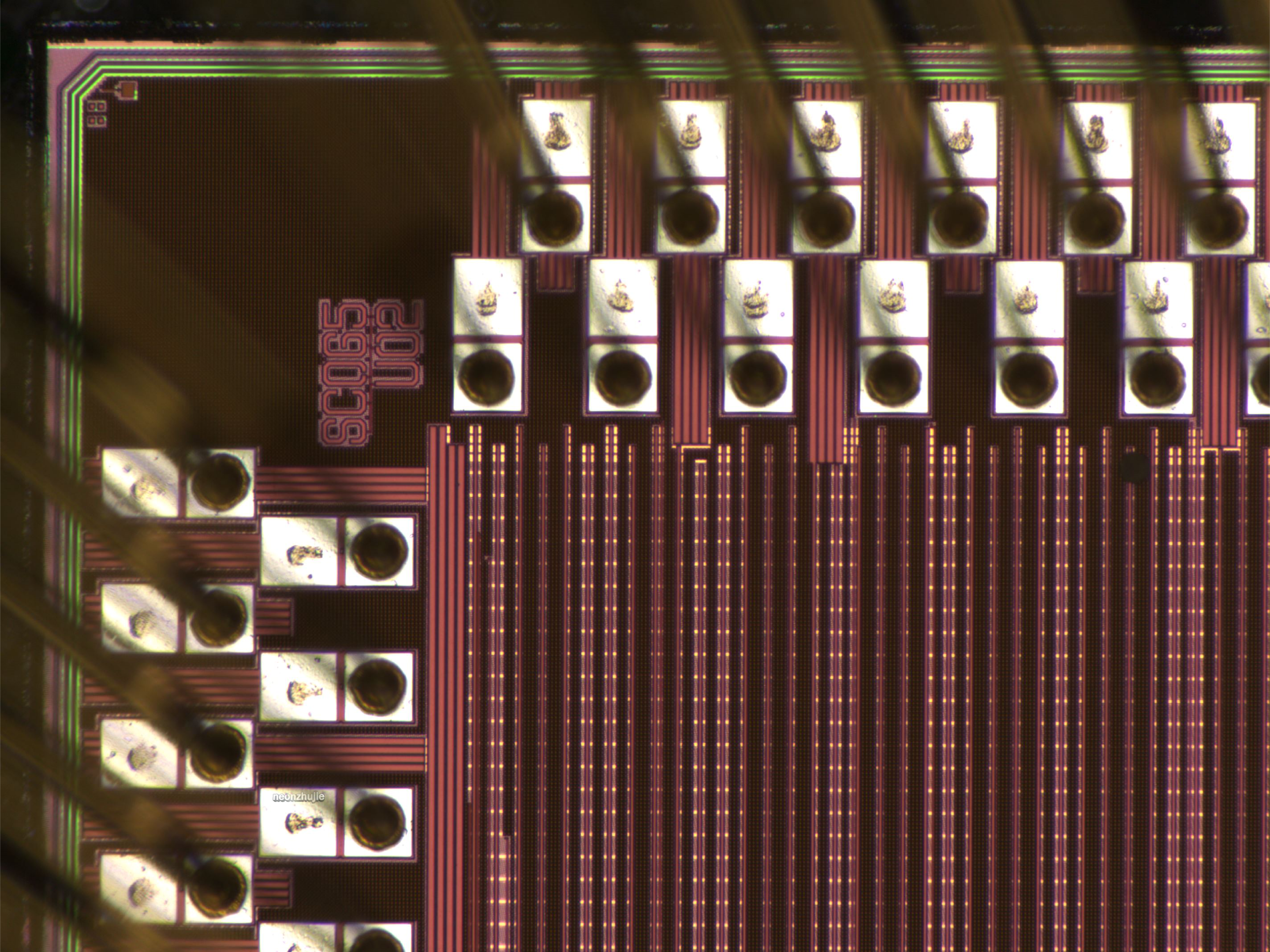

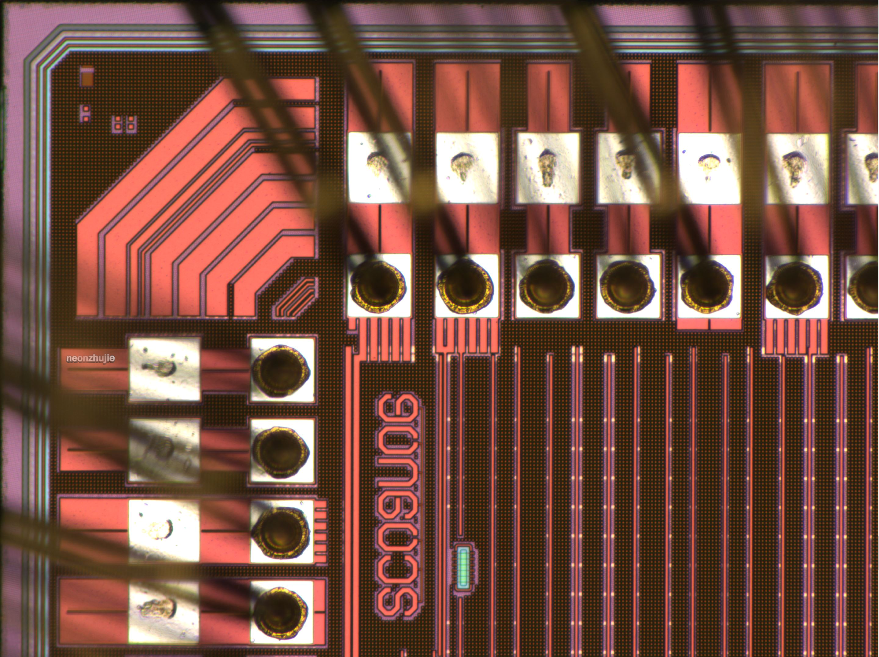

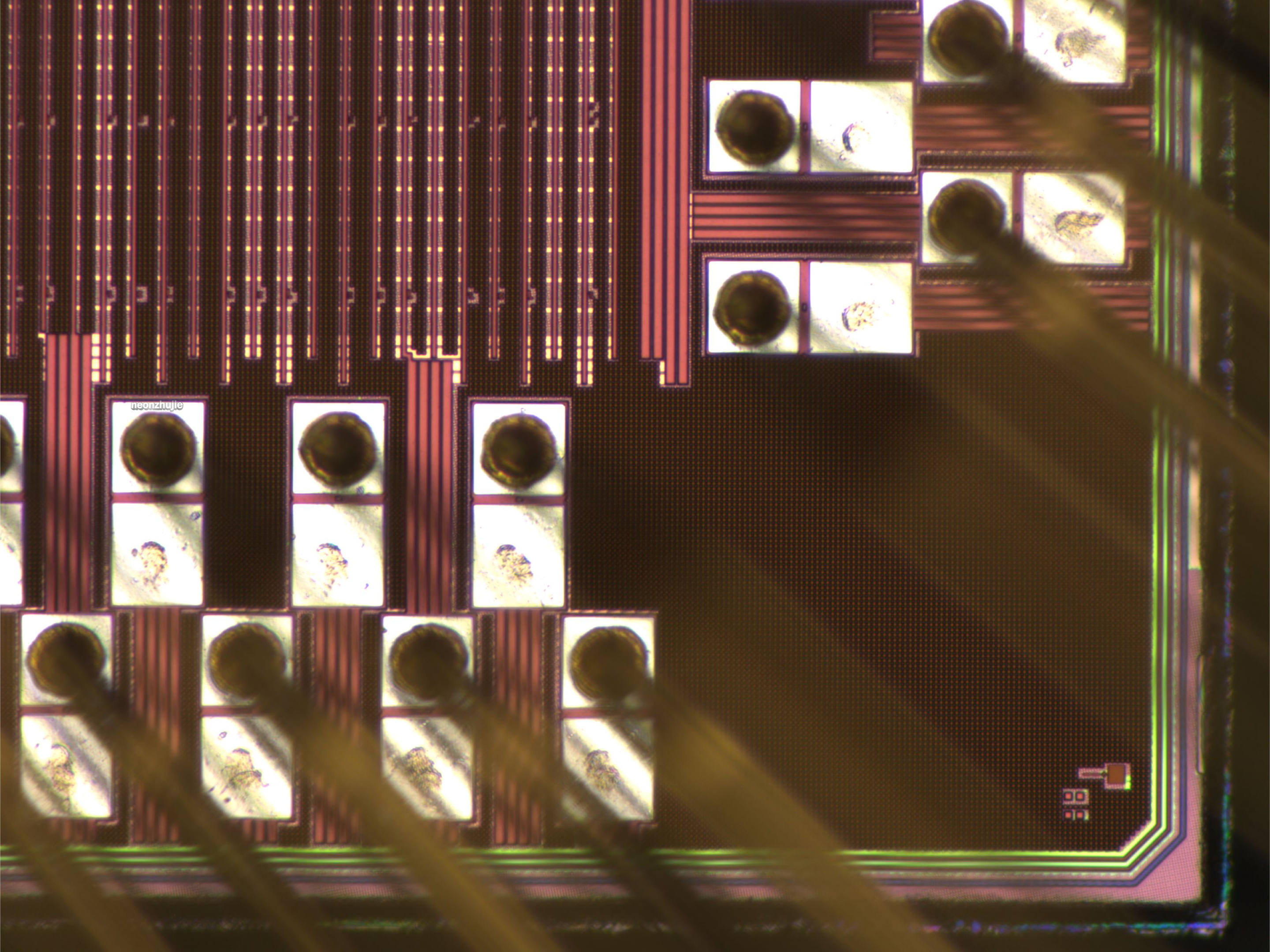

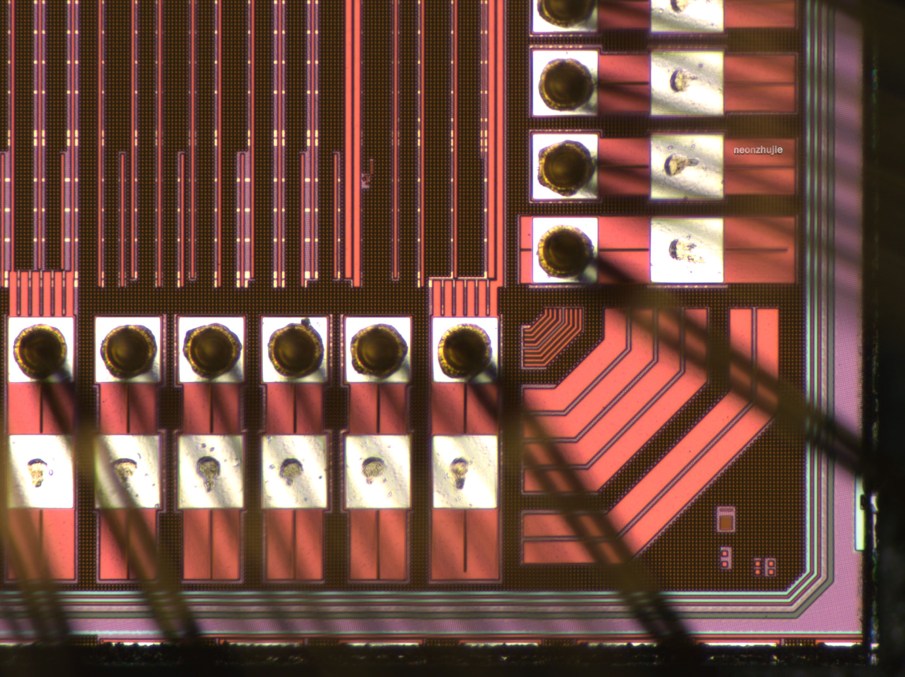

Details (LR359A12): It might be made by Sharp?
Details (CPU TWL A): It might be made by Fujitsu?

Hi, someone pinged me with a link to this post (I don't look at GBATemp otherwise), so I guess I'll write what I know by now.
The current hypothesis is that the only functional difference is that the dies are bonded out differently, which is reflected in the SCFG_OP IO register. This register is read by the second-stage bootloader to then in turn configure SCFG_JTAG with a specific value, to enable either ARM7, ARM9 or DSP debugging. (The LR359A12 most likely allows for ARM9 JTAG). Problem is, the JTAG pinout is entirely unknown, which is why I am doing the ISTD RE in the first place.
Regarding the die shots, these seem to be of the top metal layer only, and everything looks roughly like standard cell logic. With the differing IO pads it does seem like they have been fabricated by different fab houses indeed. This would have necessitated generating a new synthesis, place&route, and GDSII output per fab house (because they most likely have different design rules and standard cells). Hence, most of the differences you see in the die shots are most likely because of that, instead of any sort of functional difference.
To see anything 'useful' (to be able to see the different components, CPU cores, etc. inside the chip), you'd need a die shot of the bottom transistor layer, and I expect these to be very similar between the two. The bond wires -- the parts hypothesized to be the actual difference -- are not visible in die shots, but instead you need micrometer-resolution X-ray scans of the unopened BGA packages.
As part of the ISTD RE, I'm planning on taking such an X-ray scan of the LR359A12, but unfortunately this work is being delayed because there's other more important stuff I have to deal with. Making bottom-layer die scans is more annoying because for that you'd have to either remove the chip from its package entirely (instead of merely exposing it, as shown in your photos) and then delayer it, or you'd have to take a backside IR image (which will only have a ~1µm resolution). I have tools to take backside IR images, but no tools to decapsulate a CPU-TWL or LR359A12 (they're wire-bond BGAs, not flip-chip BGAs, so it needs acids to do, which I don't have).
Reactions: cearp and k66

Had to dig a bit for this, but, a long time ago, others tried decapsulating the CPU-TWL, but they also only imaged the top layer (aka the kind of useless layer). It looks like this: .
The IO pads (and die shot in general) look the same as your LR359A12 die shot, and different from your CPU-TWL, even though this was also a retail chip. hence: the DSi SoC chip was made by two different fab houses, which needed different tooling runs. The differences you are seeing in the die shots don't actually cause any difference in functioning.
EDIT: if anyone has (pre-)decapsulated CPU-TWL/LR359A12 chips, I can take a backside IR scan of it if you want (so we can get some "actually informative" die shots), just send them my way (contact me via email/Signal/Mastodon/Matrix).
Sorry for the doublepost but: as these are different fab houses, I just expect the LR359A12 to be physically larger because the standard cell layout and/or transistor size (aka "technology node") would be different. Same n# of logic gates, but larger logic gate size, means a larger die area too.
Can you upload images? Due to internet issues (GFW), I can't access certain websites. :rofl:
I observed the top layer photos of the CPU TWL and LR359A12, and they seem to be the same.
I think 'CPU TWL' = 'LR359A12' , It made by Sharp.
'CPU TWL A' is an improved version, It made by Fujitsu.

For the CPU xxx <-> LRxxx mapping: a few years ago, some PDFs from Sharp were discovered just being accessible online without login. These two documents: a, b both list LR359Ax chip numbers, but the final digit is missing. However, with the SCFG_JTAG and SCFG_OP docs, a pattern becomes clear:
  • LR359A10: CPU-TWL (retail/prod) [confirmed?]
  • LR359A11: dev CPU-TWL SoC, ARM7 debug
  • LR359A12: dev CPU-TWL SoC, ARM9 debug [confirmed]
  • LR359A20: CPU-TWL-A (retail/prod) [confirmed?]
  • LR359A21: dev CPU-TWL-A SoC, ARM7 debug
  • LR359A22: dev CPU-TWL-A SoC, ARM9 debug [edit: confirmed]
LR359Axy = DSi/TWL SoC , x = chip revision, y = SCFG_OP value

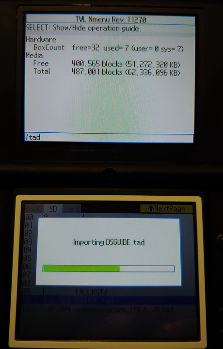

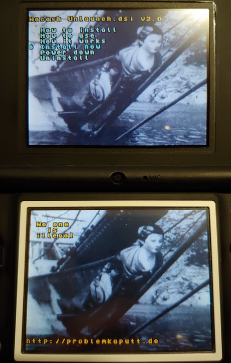

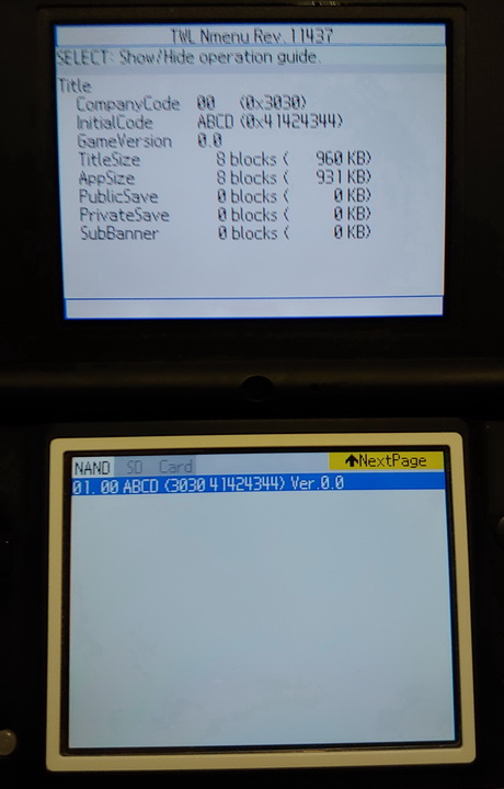

I have successfully booted NAND now. :yaynds:
Although it is currently just a clone of my DSi panda, I'm happy to see it come back to life.
thanks to @rvtr :bow: And to everyone who helped me, thank you.:grog:
The method I am currently using is:
Use the methods of 'Region changing a DSi on NAND' & 'Replace stage2' to 'clone' a DSi Panda console.
(For reference only.)
Do not attempt if you do not have an ntrboot cart.
Steps
1.Fix NAND:
1.1.ntrboot (twlnandtool)(rvtr's tool), Repair MBR. This is the most crucial. :bow:
1.2.Import NandFirm(SDMC) using twlnandtool.
1.3.Restart DSi ,SDMC_Launcher loading TWL EVA PRE_IMPORT 1.0dev/1.3dev (menu.srl) and install.
If ERROR 31-11: TWL EVA → Checker Menu → LOG → Write Dummy
If ERROR 09-06: TWL EVA → Evaluation Menu → RTC → RTC to RAW(DEB) & RAW to FAT(DEB)
(These two errors seem to be skippable. Once, I just clicked around in the Checker Menu/LOG and was able to get past these two errors. It might be that I unchecked some options in 'Checker Menu → Set Sequence'.)
(If TWL EVA PRE_IMPORT is not installed, OSFMount cannot access twl_main.img)
2.Backup NAND: ntrboot(godmode9i) → safenandmanager, dump NAND.
3.Edit NAND:
3.1.Change DSi region: Region changing a DSi on NAND (rvtr's tutorial) :bow:
(I used my DSi Panda NAND as a donor.)
(I tried using retail DSi NAND as a donor, the result is black screen and blue LED stays on.)
(Pay attention to the wifi board, DWM-W015 used for all, DWM-W024 or J27H020 used for V1.4 or higher.)
3.2.Replace stage2 files.
(stage2_bootldr.bin, stage2_footer.bin, stage2_infoblk1.bin, stage2_infoblk2.bin, stage2_infoblk3.bin)
(Copy all bytes from the donor file, then select all bytes of the target file, then paste.)
4.Restore NAND: ntrboot(godmode9i) → safenandmanager, restore NAND.
Now I can boot Unlaunch, TWiLightMenu++, Launcher(Original system, DSimenu).
Cartridge:
- Nitro (DS) cart work fine.
- DS cart with special hardware work fine. (e.g. DS-TV)
- Hybrid (DS & DSi) cart unrecognized in DSimenu. Starting with slot1launch works fine, work in DSi mode, camera works.
- Limited (DSi only) cart unrecognized in DSimenu. Starting with slot1launch works fine. (e.g. DSi XL Demo Video)
- Flashcard work fine. (e.g. DSONEi&AK2i)
(The situation is same as original DSi panda V1.4U_dev.)
I will try using TwlSystemUpdater again later.
Now that I have ntrboot and a NAND backup, I can mess around with it as much as I want.:evil:
Good news, TwlNmenu work :toot:
(slot1launch can be installed using TwlNmenu.)
I tried hiyaCFW, using both the original NAND and the current NAND, hiyaCFW version 1.6.2.
The hiyaCFW SELECT settings interface appears, but then it gets stuck on a white screen.
What I'm about to do next:
- I don't know if TwlNmenu can install the TwlSystemUpdater.tad from the SD card, I'll give it a try. Update: Completed, update system using TwlSystemUpdater ( #17).
- Try other hiyacfw versions. Update: Completed ( #17).

Installing Unlaunch(original Unlaunch) will display: Unknow bootcode version.
(If it's a region-changed DSi panda 'clone', there is an Unlaunch tmd in the 484e4141 folder, Unlaunch tmd and Launcher'app as read only, Unlaunch will be successfully installed to the Launcher's tmd, and display "installation complete".)
There are still problems...
TwlNmenu: screen freezes when installing tad, and the progress bar is blank.
NandFiler: screen freezes after startup.
(I guess it's because the Launcher hasn't been updated? Or is it a bug in system version 1.2?)
Other system apps (&system settings) are running normally.
I started TWiLightMenu++ with Memory Pit , and then I installed the new version of TwlNmenu and NandFiler using TDT.
They are working now. :D

I converted slot1launch* into a tad file and installed it with TwlNmenu, and it works fine.
(Already signed, no need to install Unlaunch first.)
*slot1launch is a component of TWiLightMenu++
(v27.24.1)
Installation location: NAND:/title/00030004/54574c31
(Uninstall: TwlNmenu → NAND → select TWL1 (3031 54574c31) → press X button )
Now DSi panda can start the Hybrid(DS & DSi) and Limited(DSi only) cart through this icon.:lol:
For old auto-boot flashcard(e.g. DSone, M3 DS Real) and DSpico: Insert the flashcard after starting slot1launch.
