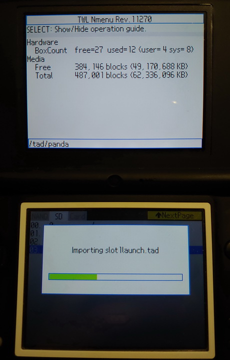

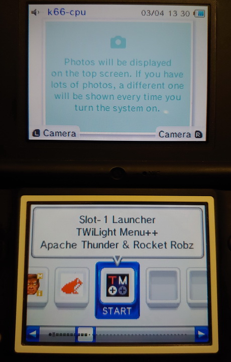

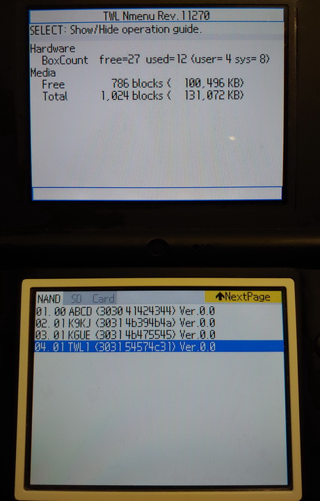

I converted slot1launch* into a tad file and installed it with TwlNmenu, and it works fine.
(Already signed, no need to install Unlaunch first.)
*slot1launch is a component of TWiLightMenu++ (v27.22.2)
Installation location: NAND:/title/00030004/54574c31
(Uninstall: TwlNmenu → NAND → select TWL1 (3031 54574c31) → press X button )
View attachment 560230View attachment 560235

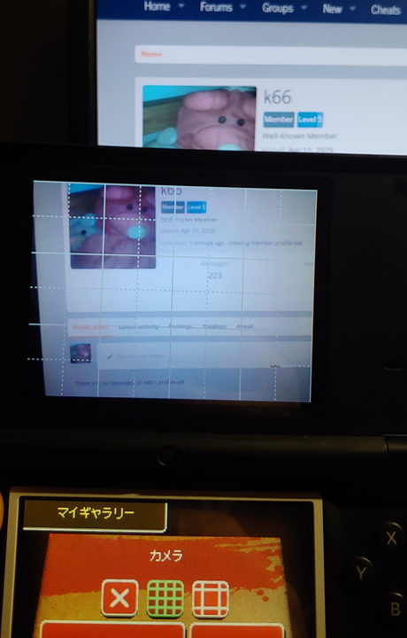

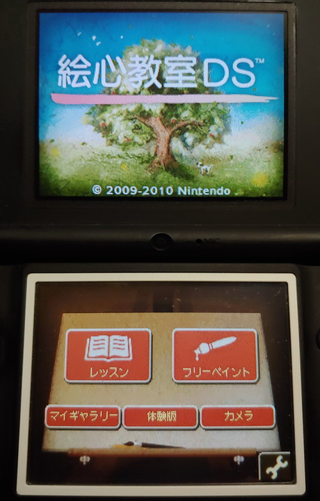

Now DSi panda can start the Hybrid(DS & DSi) and Limited(DSi only) cart through this icon.:lol:
View attachment 560236View attachment 560237View attachment 560238
It's better to use https://github.com/Lorenzooone/Simple-DS-Slot-1-Launcher rather than what comes bundled with twilight
  • Love
Reactions: rvtr and k66
Thank you for telling me.
I downloaded it, and its release already includes a tad file.
I installed it using TwlNmenu, and the cartridge works fine.
If the cartridge is not inserted at startup, it will display a settings, there are many functions that can be set.

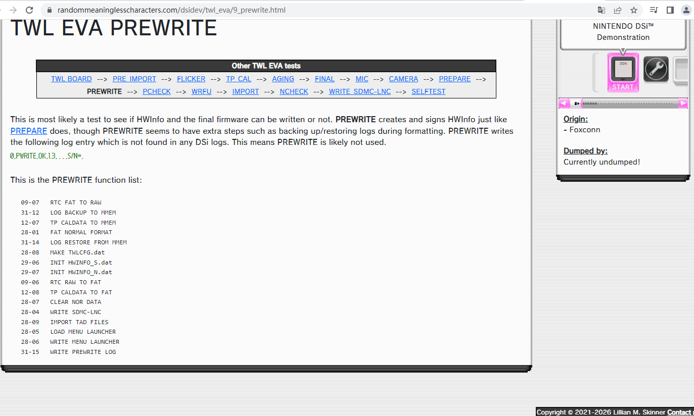

Based on my previous attempt (DSi panda clone), and the generation principle of the temporary pseudo serial number(only based on MAC address).
I think the HWINFO file can be replaced to allow TwlSystemUpdater to read the serial number (just like factory-set serial number).
I tried it and it worked.:O
TwlSystemUpdater installed successfully, it uses the serial number from HWINFO.

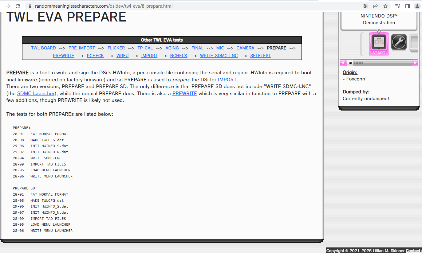

The factory-set serial number is indeed carried out during the PREPARE or PREWRITE stage, by creating an HWINFO file that contains the serial number.
Setps
1.
TWL EVA PRE_IMPORT
2.ntrboot backup NAND
3.edit NAND, replace HWINFO_N.dat&HWINFO_S.dat&cert.sys, add HWID.sgn&dev.kp (from 'real' DSi panda clone )
(If file from Original DSi panda, TwlSystemUpdater cannot read the serial number. A temporary pseudo serial number will be generated based on the MAC address.)
4.ntrboot restore NAND
5.ntrboot(twlnandtool) install SDMC_Launcher
6.SDMC_Launcher load TwlSystemUpdater and install
Now serial number is VW10000XX00 (my DSi panda EUR)
The factory-set serial number is indeed carried out during the PREWRITE or PREWRITE stage, by creating an HWINFO file that contains the serial number.
The best thing about these is that they’ll likely have the retail HWInfo keys! But no dumps exist…

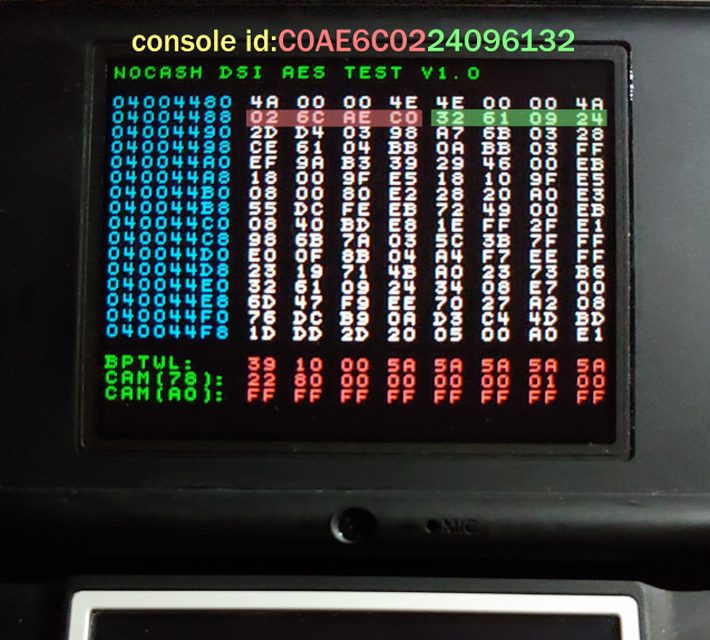

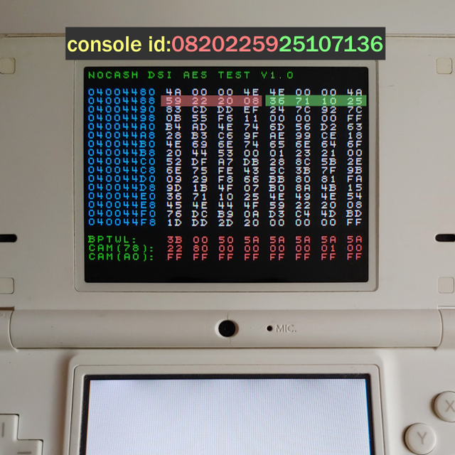

TWL EVA displays UID(console id) as all 00.
Use AES TEST to check the UID, the first 4 digits become strange.
08A2277024096132 → C0AE6C0224096132
(Using this strange UID to create NAND/hiyaCFW or encrypt tik does not solve the problem.)

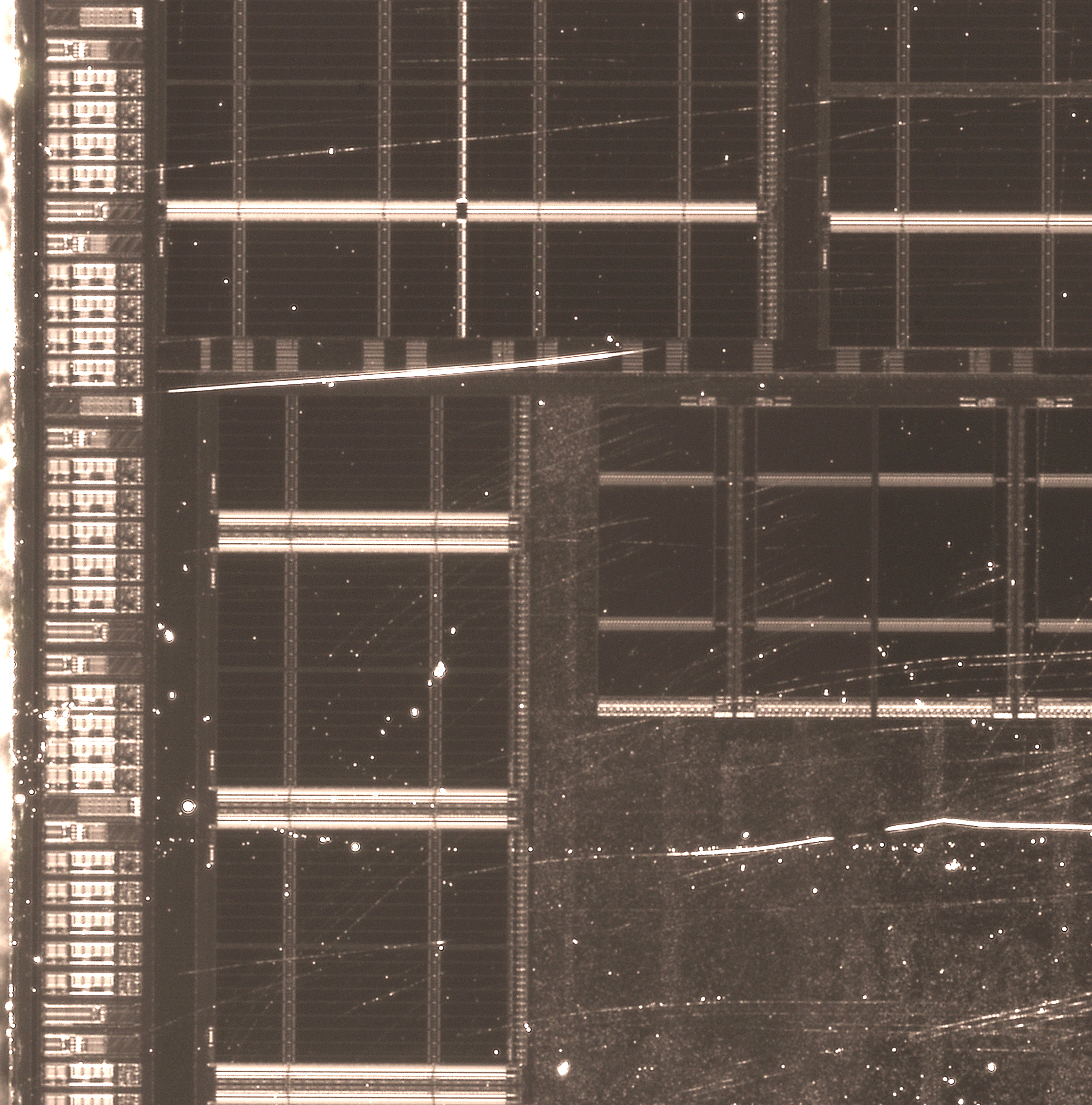

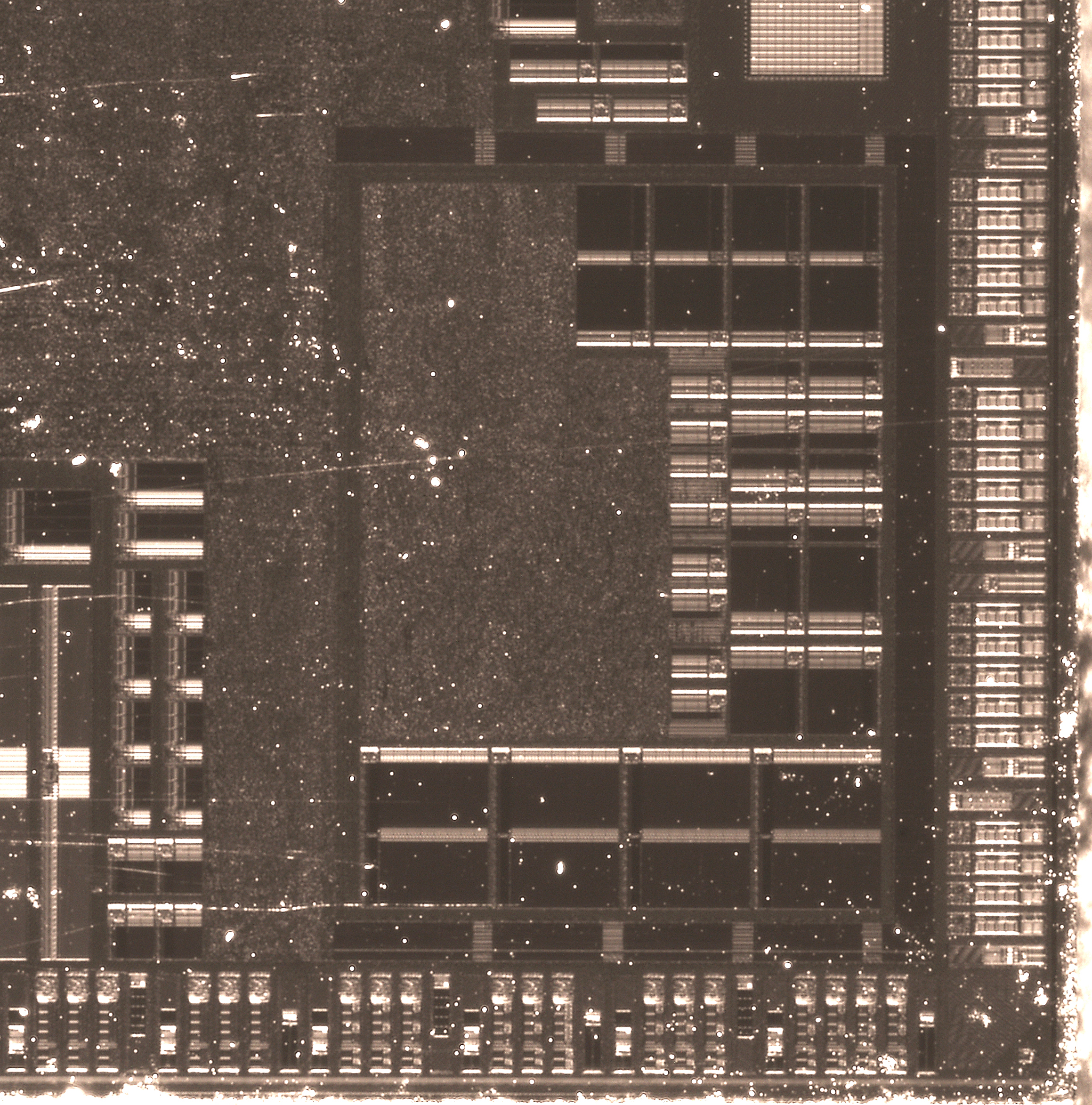

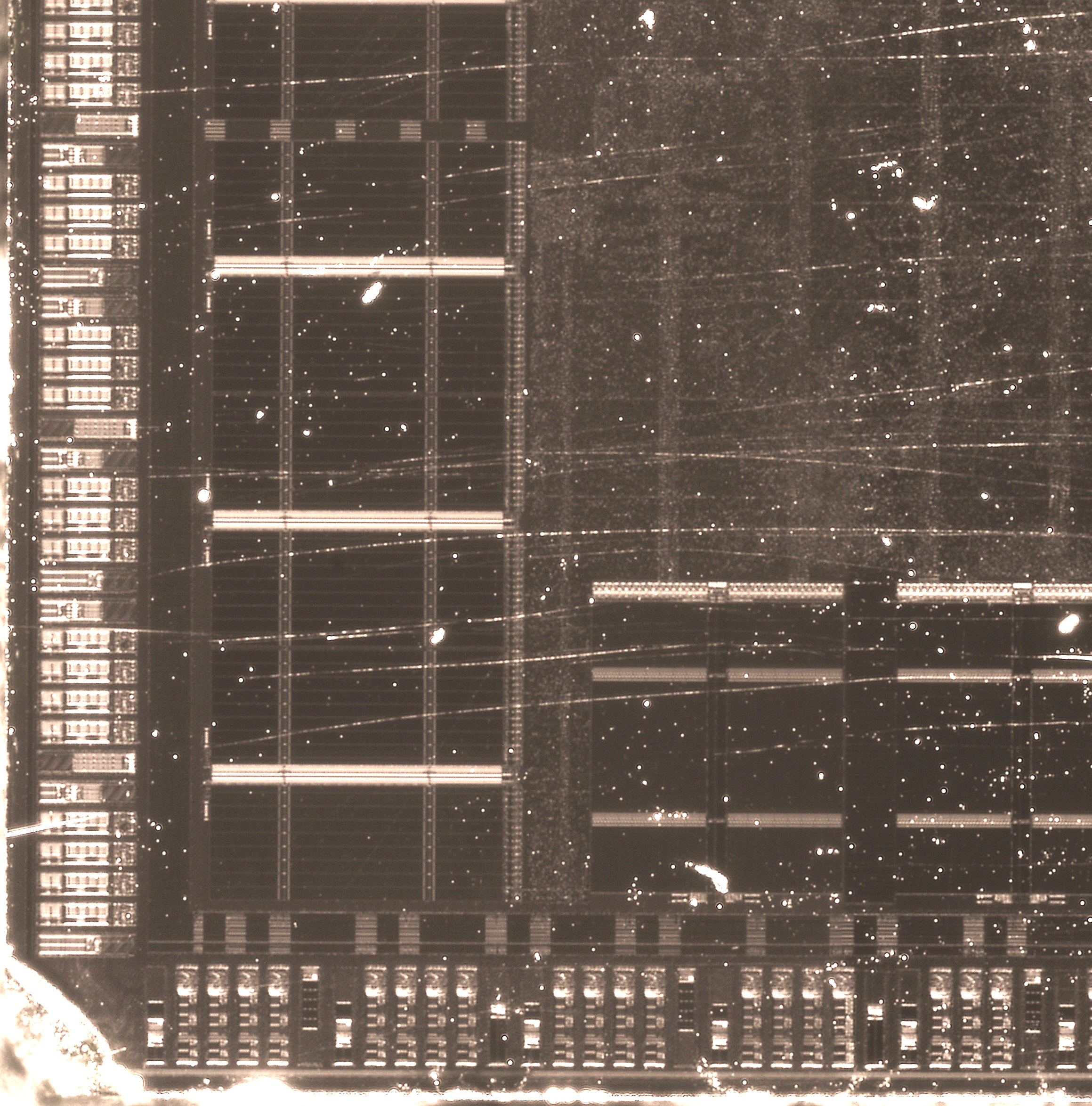

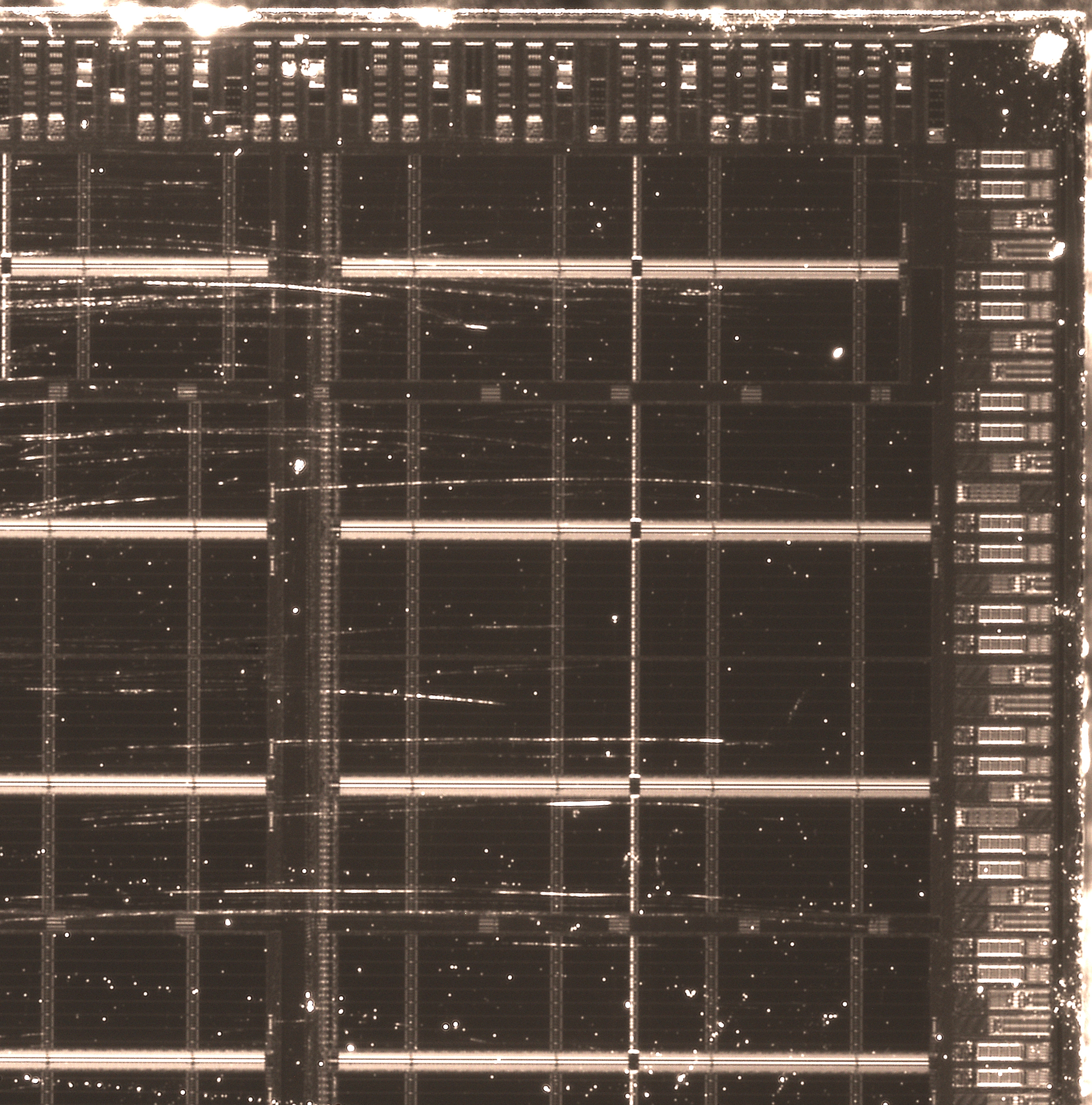

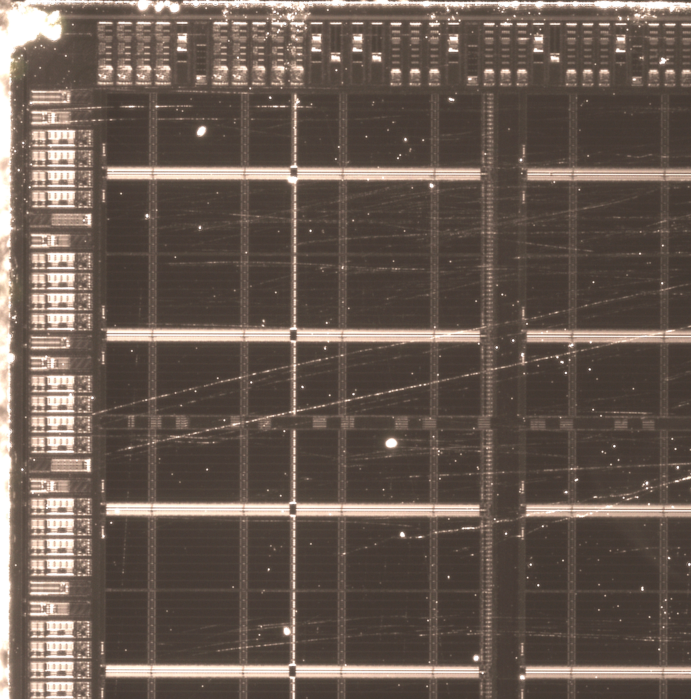

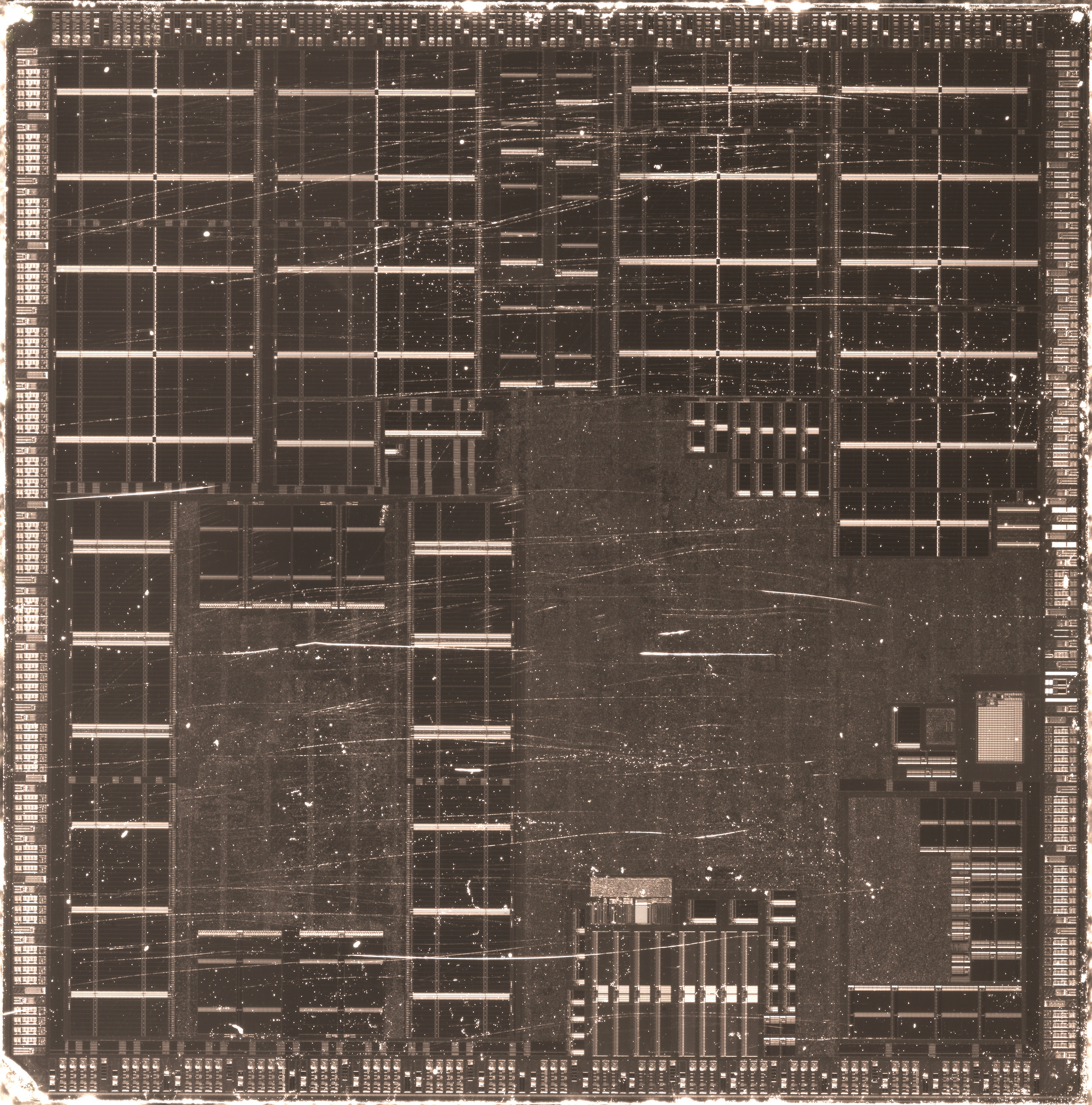

New IR photo :lol:.
Inspired by @PoroCYon ('CPU TWL' near-IR photo), I also want to take infrared photo of 'LR359A12'. Of course, I am just a noob, so... Two weeks ago, I sent 'LR359A12' to @BIGic_Lab (this is a bilibili link).
I received the IR photo today:wub:.
(Due to limited conditions, this does not seem to be taken with a professional SWIR camera, with a magnification of only 5x, so it is not very clear. I'm quite satisfied, just for fun.)
Because the architecture of 'LR359A12' is the same as 'CPU TWL'(LR359A10), there should be no difference.
The scratches in the photo come from the bottom of the chip and are very obvious under IR, this is normal.
(Click the image to view)
3x3
Other photos:

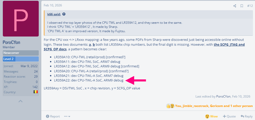

Found an 'LR359A22' CPU, from a Nintendo DSi Panda (factory ver).
- CPU: LR359A22 , "1032 5m", produced in 2010/07, console ID:0820225925107136
It is installed on the 'C/TWL-CPU-10' motherboard, NAND product.log date 2012/01/08.
I think it is the development version of 'CPU TWL A'.
Current conclusion:
'LR359A12' (≈CPU TWL, made by Sharp) is used for older version development kits. For DSipanda, board C/TWL-CPU-01 is used.
'LR359A22' (≈CPU TWL A, made by Fujitsu) is used for newer version development kits. For DSipanda, board C/TWL-CPU-10 is used.
:creep:I previously installed 'LR359A12' on the C/TWL-CPU-10 motherboard, and it actually worked properly.:yaynds:

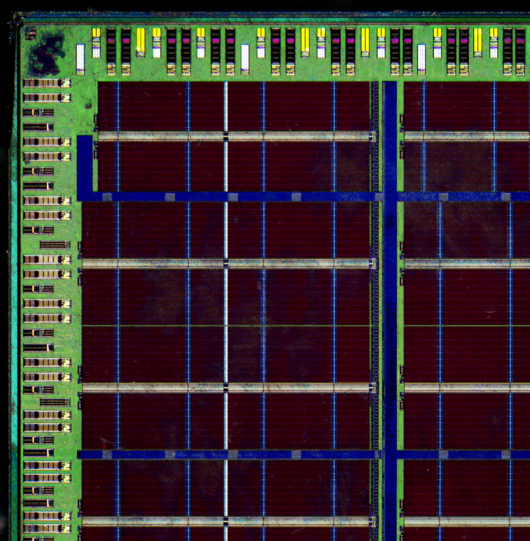

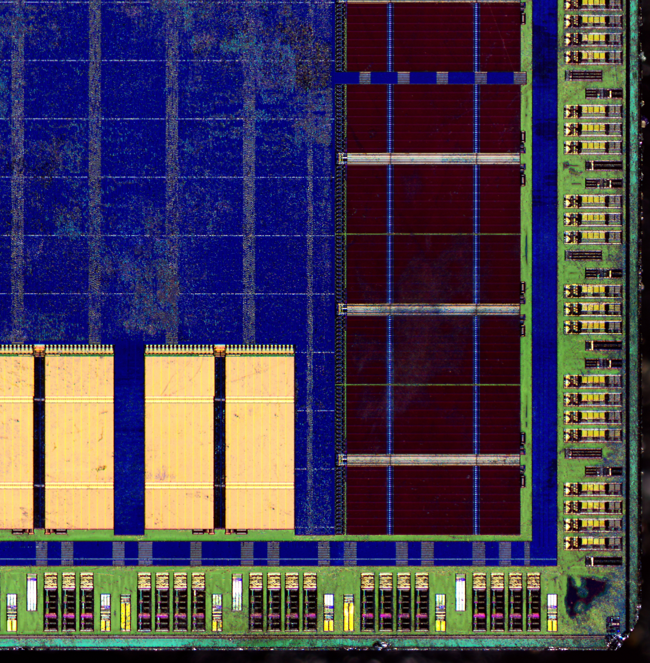

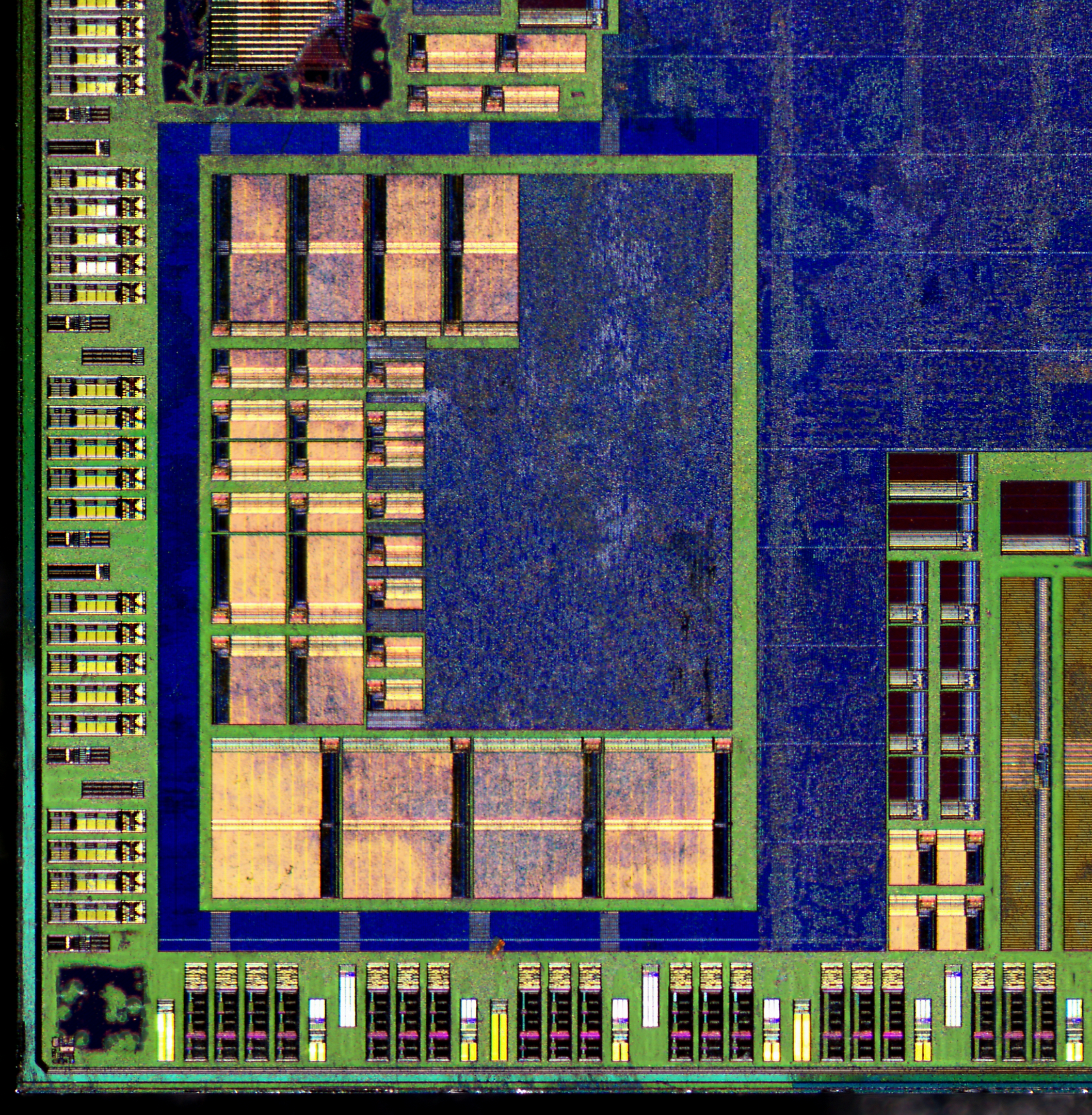

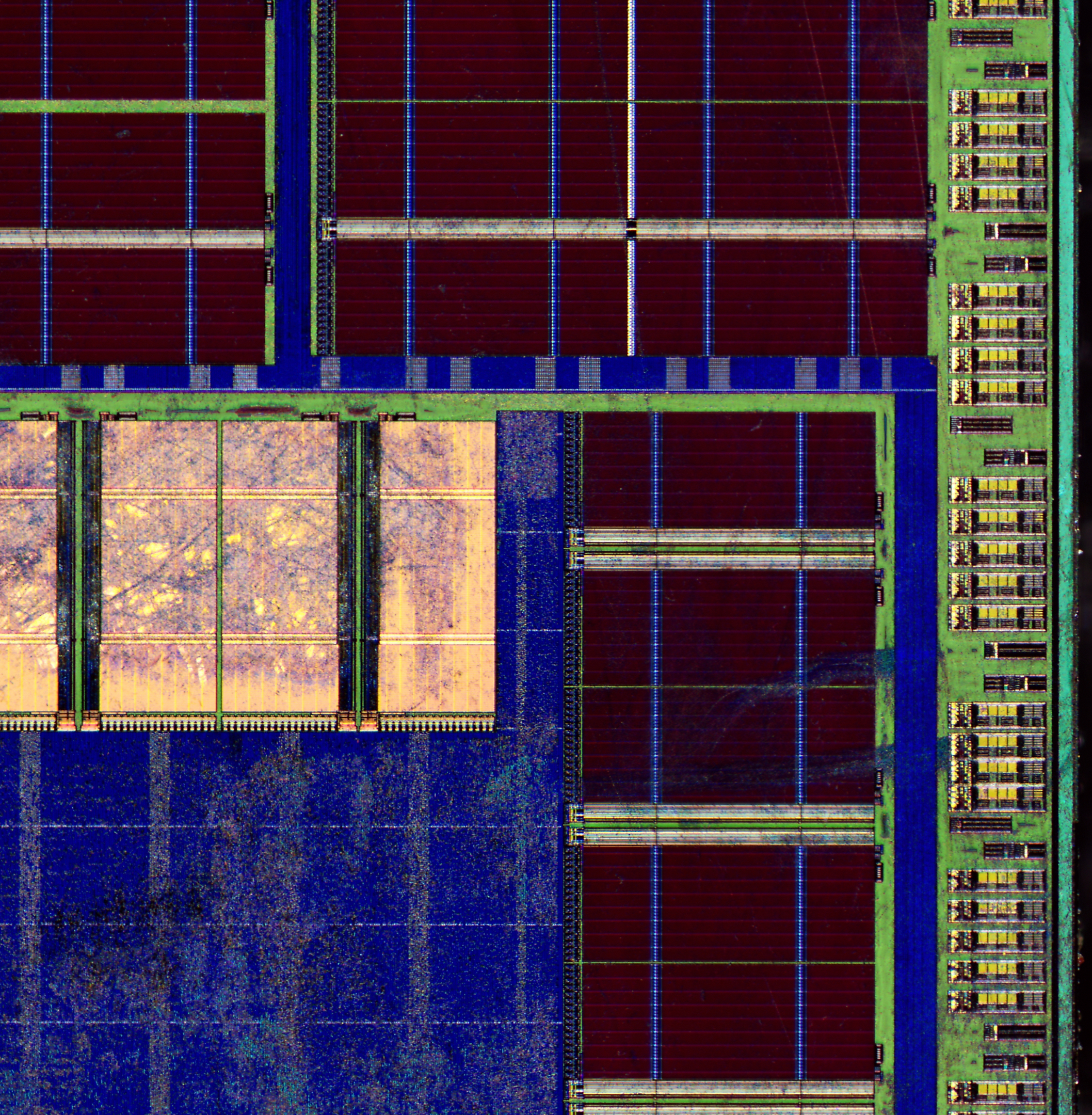

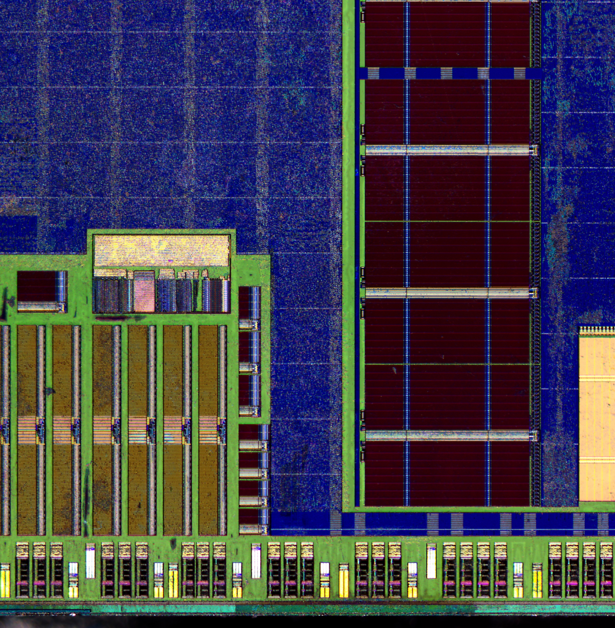

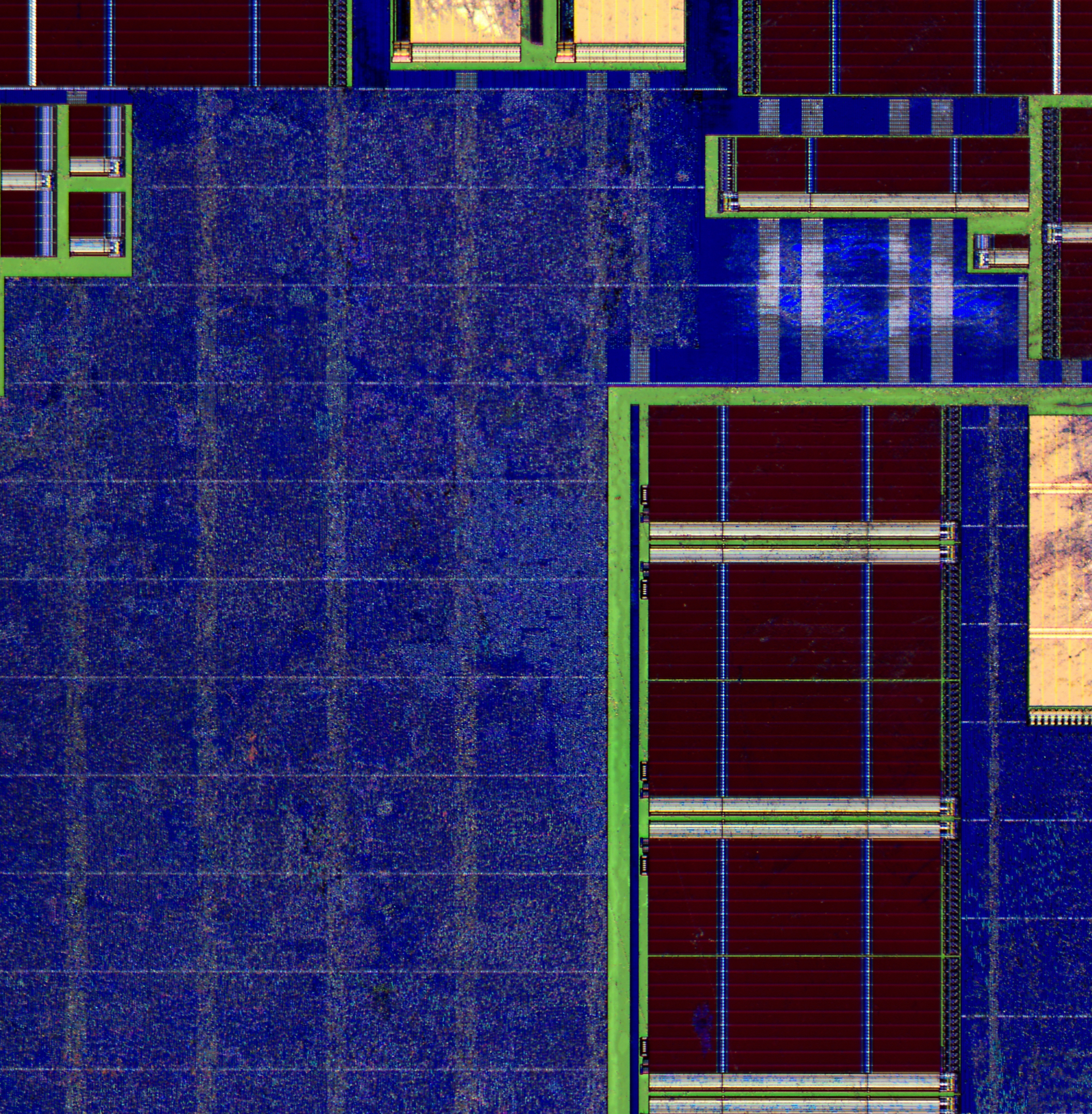

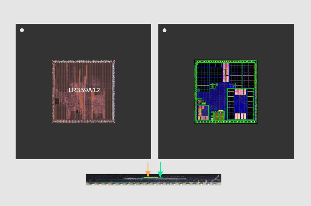

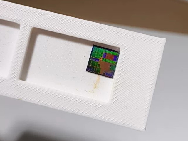

New Dieshot :lol:.
Filmed and produced by @BIGic_Lab (this is a Bilibili link). Delayering requires a lot of very meticulous manual work and effort, and I really appreciate his contribution to this project.:bow:
It's a follow-up to post #26, It's an 'LR359A12' CPU.
Because the architecture of 'LR359A12' is the same as 'CPU TWL'(LR359A10), they might look the same in photos.
2X objective lens
5X objective lens (Click the image to view)
3x3

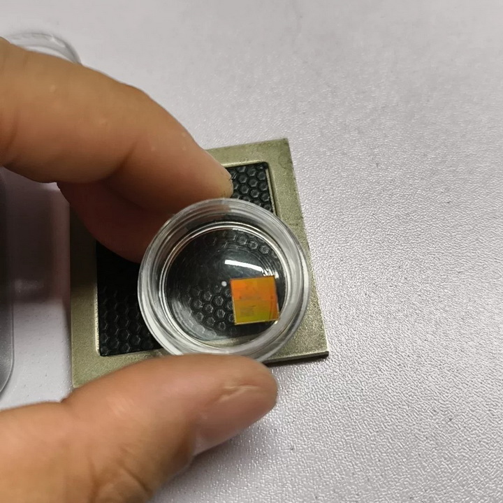

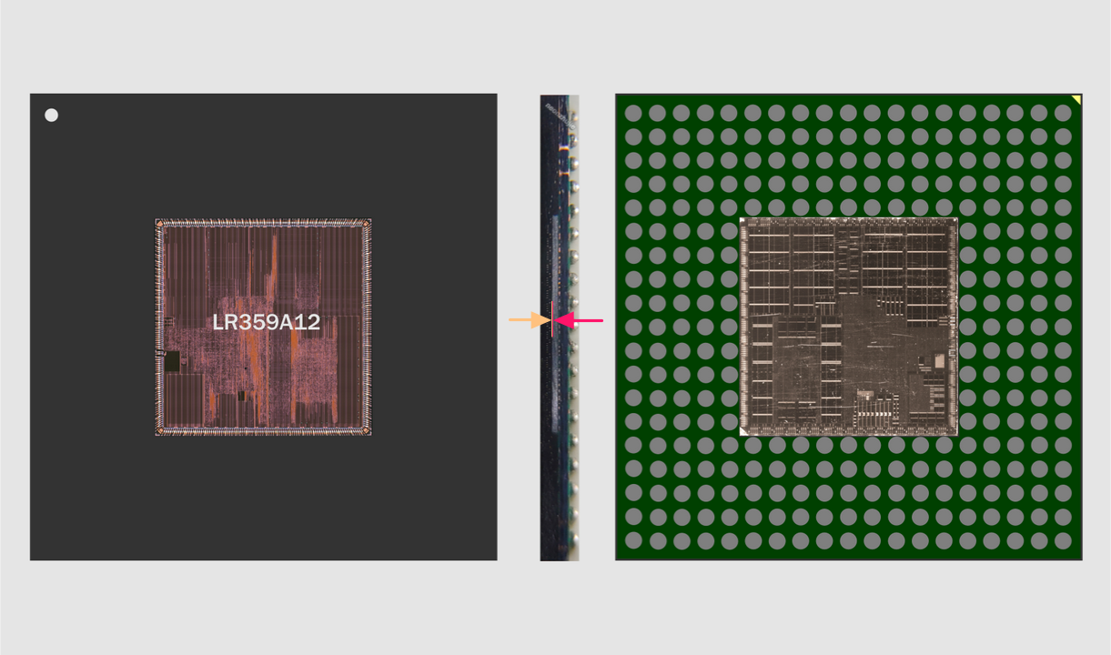

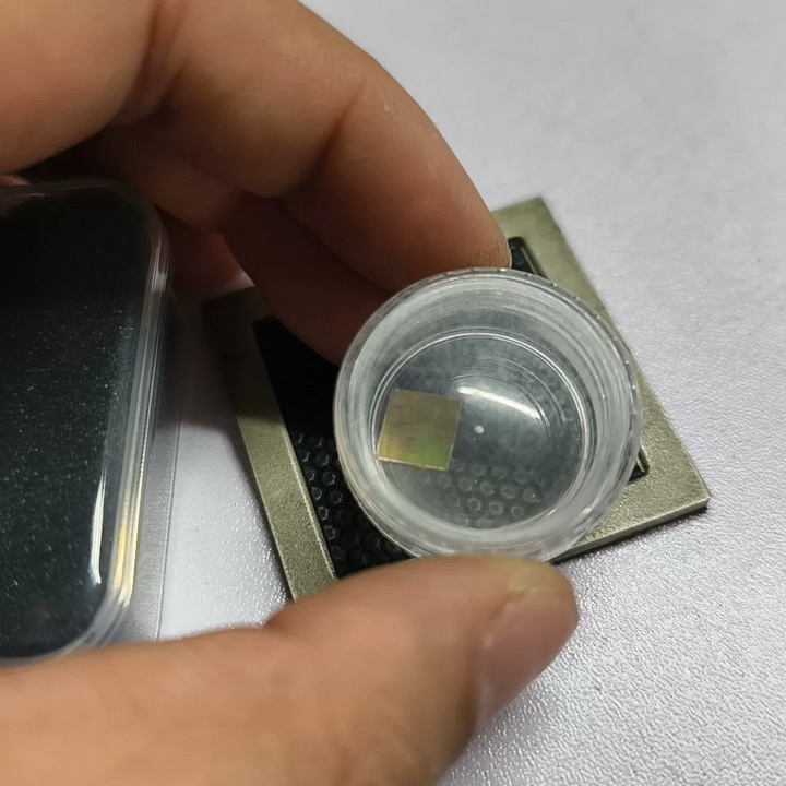

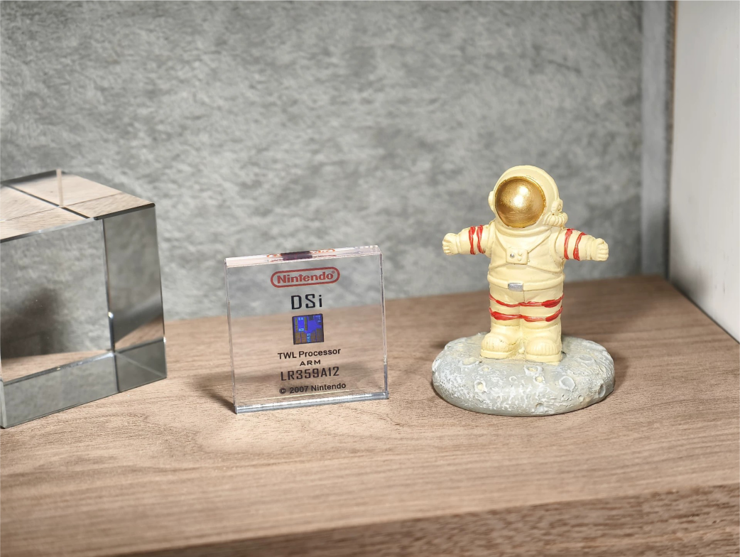

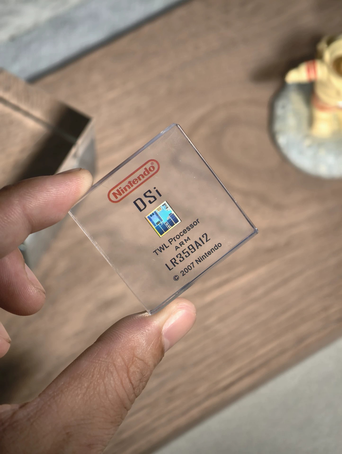

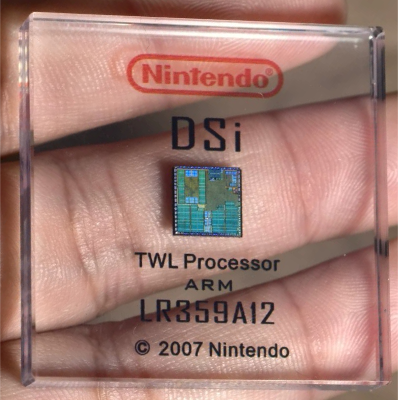

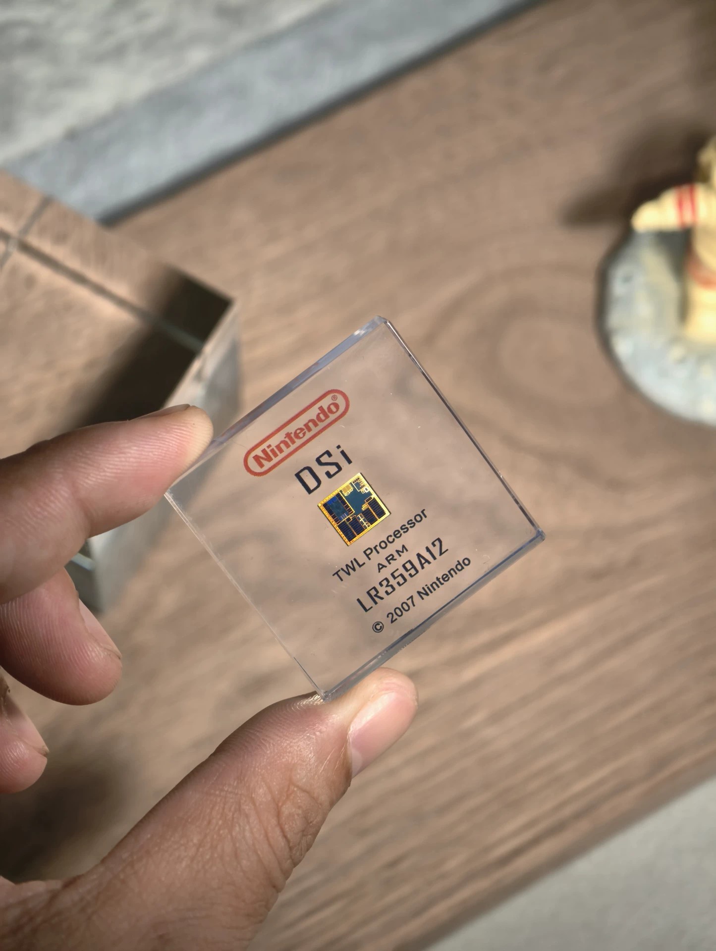

2026/8/24 Update:
BIGic_Lab made a transparent resin package for the chip, which prevents oxidation, and he also designed the LOGO.
He's really thoughtful, I'm super grateful to him.
The following photos were also taken by BIGic_Lab.:wub:
