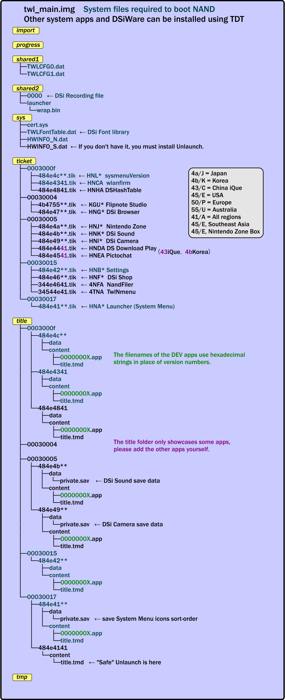

Installing system titles
There are a few essential system titles* needed for the NAND to boot. These are the System Settings (HNBx), Launcher (HNAx), wlanfirm (HNCA), and sysmenuVersion (HNLx).
*I suggest starting with factory firmware, as this has fewer requirements to work. HWInfo (discussed later) is not needed, and configs can be somewhat ignored.
If you have WiFi module versions DWM-W024 or J27H020, you will need wlanfirm v512 or higher. Otherwise you will experience a brick. If you have DWM-W015, you can run any wlanfirm.
You can find lists of all titles, their versions, and downloads here. These downloads will need a TAD unpacker (perl | python).
DSiWare title data is split into two locations. One for the ticket, and one for the app + metadata (TMD):
  • Ticket folder : nand:/ticket/[TID_CATEGORY]/
  • App+TMD folder : nand:/title/[TID_CATEGORY]/[TID_UNIQUE]/content/
The TID_CATEGORY is the application type (Launcher, system, user, data), obtained from 0x234-237 in the app (may be .nds). The bytes are in reverse order, so you'll need to flip them around (eg. 0f 00 03 00 --] 00 03 00 0f).
The TID_UNIQUE, found from 0x230-233 in the app, is a unique 4 byte ASCII identifier. This ID is also in reverse order.
To install, take the ticket file and save it to the ticket folder as [TID_UNIQUE].tik. Now take the TMD and copy it to the title folder as title.tmd. The naming of the app is a bit more complicated.
The name of the app is based on the app version. So, version 1 of the app would mean the app gets saved to the title folder as 00000001.app. The version of the app can be found at 0x1E4-1E7 in the TMD. Dev apps will be a bit different, having hex strings in place of versions, like 0f960d6a.
Each title installed MUST go into the paths listed above, otherwise it will be deleted by the Launcher, or cause the system to fail to boot. Below are preset title paths for the latest firmwares of each region. I suggest using the lists as a reference.
Copying System Data
I've listed all the paths below, with links to download the files. There isn't much more to this stage of the NAND setup than copying and pasting.
  • nand:/sys/cert.sys (prod | dev)
  • nand:/sys/TWLFontTable.dat (Worldwide | China | Korea)
  • nand:/shared1/TWLCFG1.dat (all)
  • nand:/shared1/TWLCFG0.dat (all)
  • nand:/shared2/launcher/wrap.bin (all)
  • nand:/shared2/0000 (all)
  • nand:/sys/HWINFO_N.dat (all)
If you have an existing HWINFO_S.dat, you can place it in nand:/sys/. This file is tied to the CPU, and is signed, so your HWInfo MUST match the console you install it to. You can verify that the HWInfo matches the target console with this script. If you have a development unit, it is also possible to resign HWInfo.

Unlaunch
Instead of the typical unlaunch install (unlaunch gets appended to the region specific Launcher), we're going to install it to the prototype Launcher directory. If the main Launcher ever fails (gets corrupted, is deleted), then stage2 will look for a prototype Launcher to boot. This fallback will cause the "backup unlaunch" to be loaded, giving us an extra layer of protection.
Install the unlaunch TMD to nand:/title/00030017/484e4141/content/title.tmd. Be mindful of if there is an existing TMD in that location. If there is, overwrite the start of the unlaunch TMD with the pre-existing TMD. With the TMD as it is now, the Launcher will try to delete it. Write protect the unlaunch TMD to prevent this.
By default, unlaunch will be disabled due to the region specific Launcher being valid. We can safely break the Launcher to enable unlaunch by changing the TMD from "HNAx" to "GNAx". Use specifically "GNAx", as this is used by custom installers. Now, write protect this TMD as well.
Unless you are using factory firmware, or you have a valid HWINFO_S.dat, unlaunch MUST be enabled.

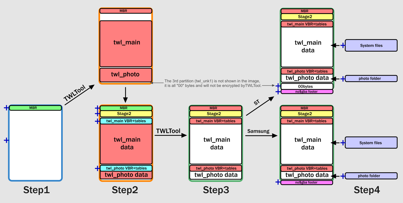

(The following is a quick process I wrote based on rvtr's guide, for reference only.)
This is the process of manually creating a compressible NAND
Steps
1.
Create nand.bin, (Samsung eMMC) length 0xF000000, overwrite paste Stage2(.nand) to 0x00, overwrite paste MBR to 0x00.
(Stage2 won't encrypt, I can add it at any time. It's more convenient to add at this time.)
(twltool can only output 240MB (Samsung NAND size), so creating a 245.5MB ST NAND seems pointless.)
2. Encrypt nand.bin using twltool, output nand.enc.bin: copy twl_main (at 0x10EE00, length 0xCDF1200) and twl_photo (at 0xCF09A00, length 0x20B6600), overwrite paste to nand.bin. (Re-encrypting the NAND will restore the encrypted bytes to '00')
Overwrite paste twl_main VBR+00bytes (length 0x11200) to nand.bin 0x10EE00 .
Overwrite paste twl_photo VBR+00bytes (length 0x6600) to nand.bin 0xCF09A00.
3. Encrypt nand.bin using twltool, output nand.enc2.bin.
3a. Samsung eMMC add no$gba footer (length 0x40) to the end of nand.enc2.bin.
3b. ST eMMC add 00bytes (length 0x580000), and no$gba footer (length 0x40) to the end of nand.enc2.bin.
4. ninfs (Allow writing) to mount nand.enc2.bin. OSFMount (cancel Read-only drive) to mount twl_main.img, add system files ,and mount twl_photo.img add photo folder.
5. Test NAND on emulator (e.g. melonDS).

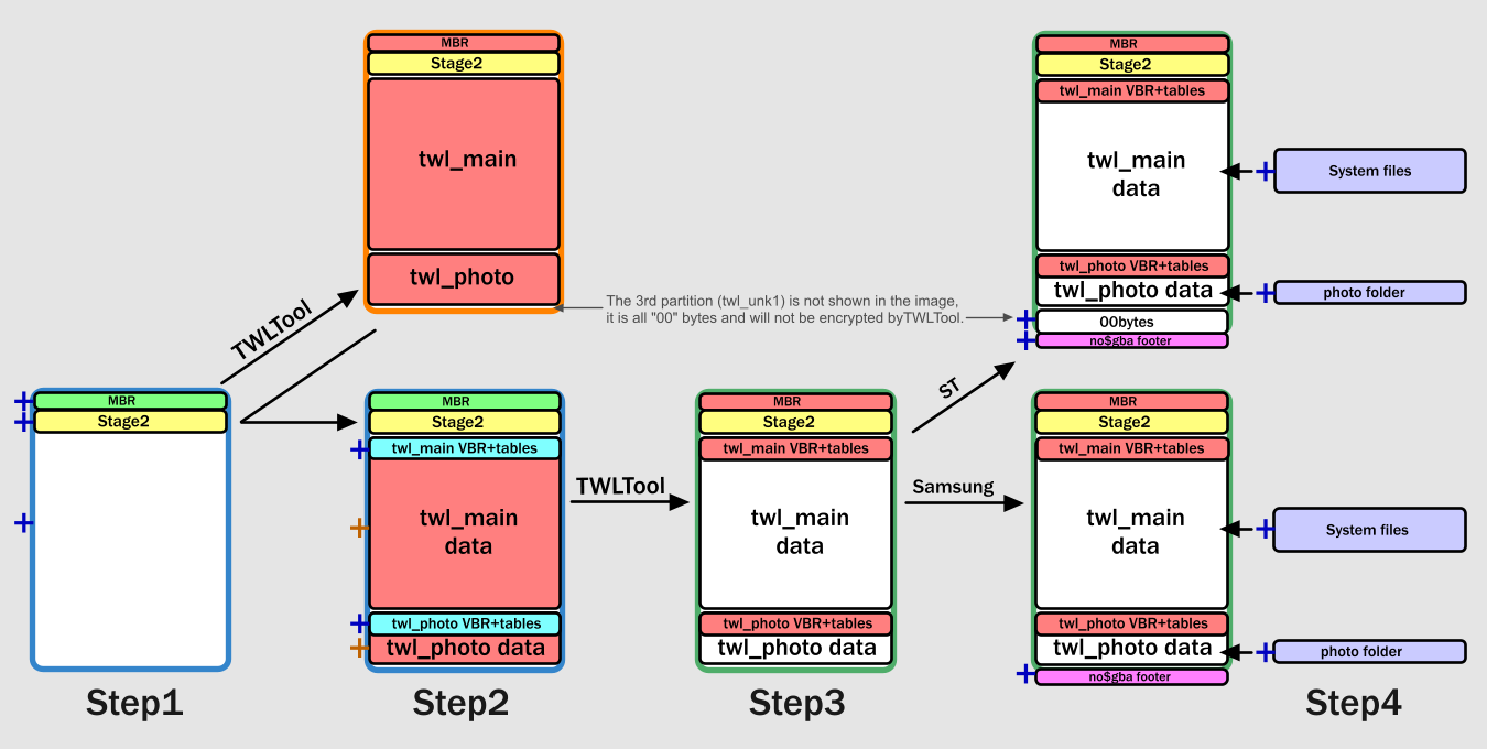

If doing this can be a bit faster (The attachment contains a Python script that can perform steps 1-3)
1. Create nand.bin, length 0xF000000, overwrite paste MBR to 0x00.
2.Encrypt nand.bin using twltool, output nand.enc.bin.
Overwrite paste Stage2(.nand) to nand.enc.bin 0x00.
Overwrite paste MBR to nand.enc.bin 0x00.
Overwrite paste twl_main VBR+00bytes (length 0x11200) to nand.enc.bin 0x10EE00 .
Overwrite paste twl_photo VBR+00bytes (length 0x6600) to nand.enc.bin 0xCF09A00.
3. Encrypt nand.enc.bin using twltool, output nand.enc2.bin.
Copying System Data

Unlaunch
Photo partition
Making TWL_PHOTO is pretty easy. Just like with TWL_MAIN, we'll insert the TWL_PHOTO VBR with extra bytes into a zerofilled file matching the partition's full size. The only difference is that this partition is 0x20B6600 long.
Rather than a bunch of files, we just need to create a single folder. Make photo:/photo/. The photo folder is seen as the "root" of the partition, so, without it, the management file cannot be created, and the camera app will fail.
Creating full nand.bin
Now that we've prepared both partitions, it's time to put them into a larger nand.bin. First, make a zerofilled file with a size of 0x0F000000. Now, insert both TWL_MAIN and TWL_PHOTO.
  • TWL_MAIN gets copied at NAND offset 0x0010EE00, until the entire file is written
  • TWL_PHOTO get copied at NAND offset 0x0CF09A00, until the entire file is written
Copying stage2
Download any stage2 that supports unlaunch, and matches your current console (retail on retail, dev on dev). Each stage2 (.nand extension) will be one to one with how it appears in NAND, with the exception of MBR being zerofilled. As such, we can copy 0x00 onwards of the stage2 into 0x00 onwards of the NAND, until the entire file has been written.
There are a few different stage2s available. The standard one shipped on all DSis (v2435-8325) works fine, but we use a slightly updated version (v2665-9336) for the NAND builder. The later revision stage2 is functionally the same, but it blocks the dangerous standard unlaunch installer, pushing people into using a safer alternative. Though if you've followed my guide this far, you probably don't care about safety (:
Copying MBR
There are two possible MBRs depending on your NAND manufacturer, assuming you're using an official NAND chip. If you are using a custom chip (ie. SD card as NAND), you will need to set up the MBR manually to match the DSi's layout. I won't go into that here, but the Wikipedia article on MBR has very detailed information to get you started.
  • SAMSUNG : KLM5617EFW-B301 OR KMAPF0000M-S998 (download)
  • ST : NAND02GAH0LZC5 (download)
To add the MBR, overwrite the first 0x200 of NAND with the .bin.
Encrypting
Encrypting is pretty easy. Simply download twltool, then run the command below.
 twltool nandcrypt --cid [cid] --consoleid [consoleID] --in [nand.bin] --out [nand.enc.bin]
If you try to compress your newly built NANDs, you will notice that the size stays the same. Why? Negative encryption.
When you initially work on the NAND, it is decrypted, and filled with zerobytes. This compresses well. However, when we encrypt the NAND in order to flash it back, all those zerobytes will turn into encrypted data. When this happens, the entire NAND becomes high entropy data, none of which compresses well. There is a solution to this though.
Encrypt the data region of TWL_MAIN (make sure to avoid the file tables), then mount and write to the partition. Afterwards, the final encryption with twltool will turn unused encrypted data back into zeroes.
