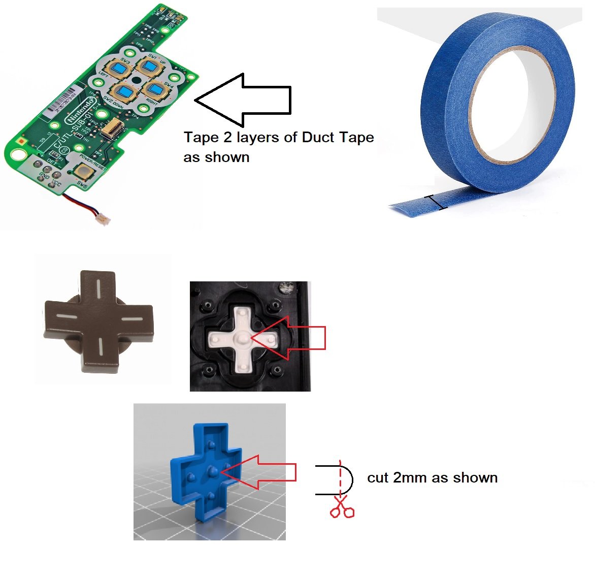

simple solution without reversing rubber dpad, works flawessly
