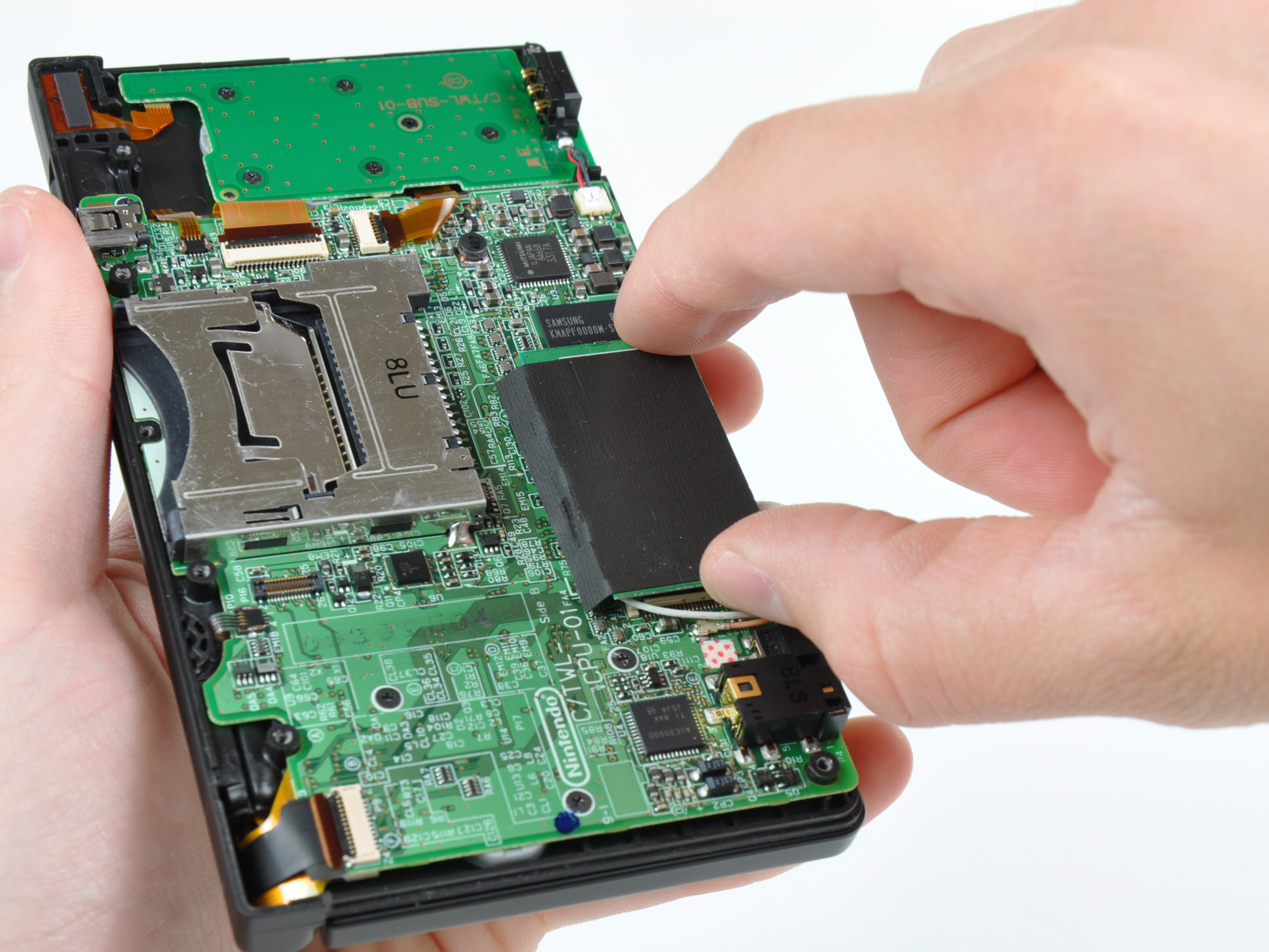

I replaced an danaged cartridge port with a new one. But the DSI still cant see the game?
i notised that an SMD resistor is gone EM13 can this be the problem? what resistor is that?
We tend not to see component level lists for consoles outside of specific fixes.
I lack a DSi to check against but all the images I have seen thus far have that one populated ( https://upload.wikimedia.org/wikipedia/commons/3/35/Nintendo_DSi_main_and_sub_pcb.jpg ). I am not sure it is a resistor as it looks more like it is labelled EM and might be slightly taller than the others ( https://d3nevzfk7ii3be.cloudfront.net/igi/kmVh26fubSE4TiMD ), possibly also slightly more brown than black. I am not sure what EM would be in this case but a ferrite bead makes sense, and most of the other things called EM on the PCB shots and the other Nintendo boards that popped up in the search would appear to be noise suppression of some form.
I don't want to suggest bridging it but were it mine on my bench it would be being done.
