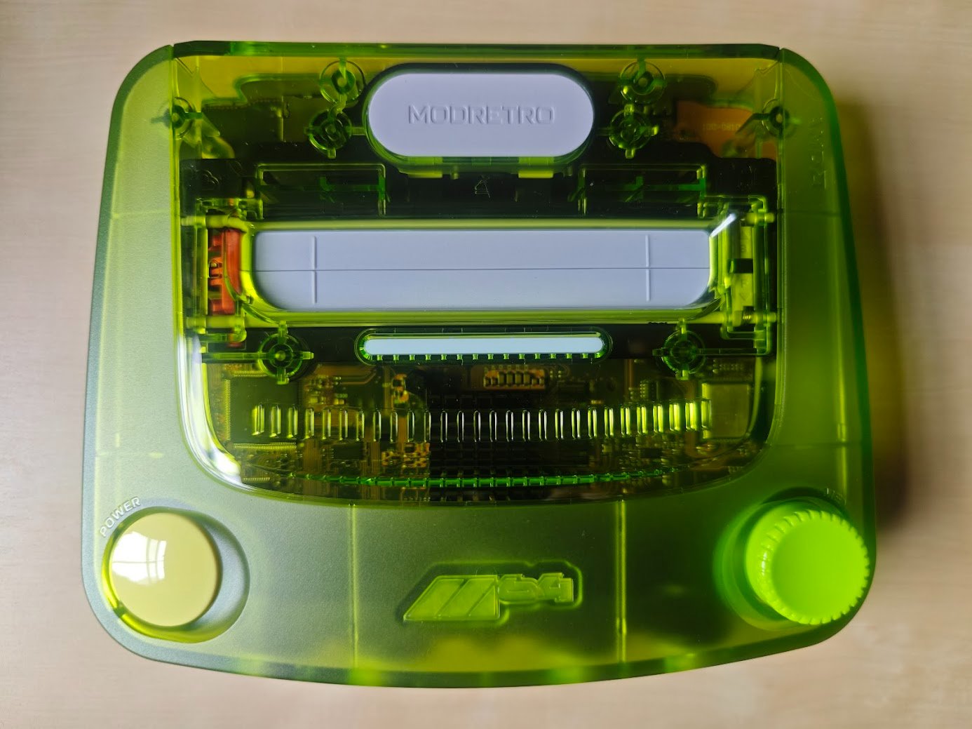

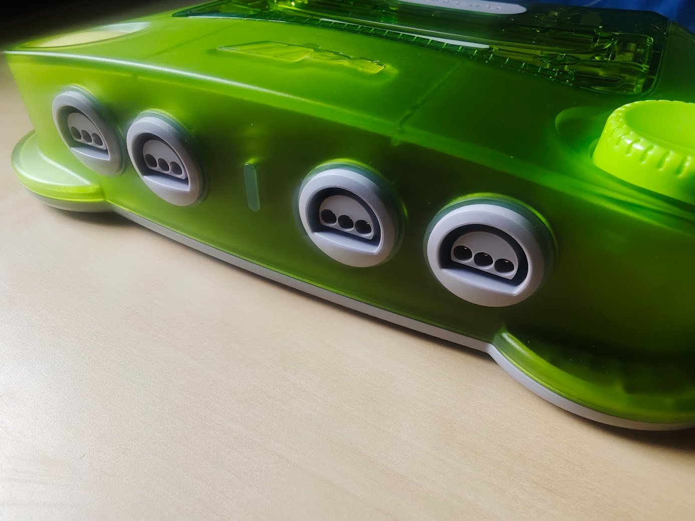

No one will mistake the M64 for something other than an N64-inspired console. The form factor and nostalgic clear shell are easy giveaways. However, the new system introduces some welcome hardware upgrades. Notably, the M64 is smaller (8.5” x 6.5” x 2.2”) and lighter (1.6 lbs) than the original console (10.23” x  7.48” x  2.87”; 2.42 lb), making it less space-consuming and easier to manipulate and fit onto your gaming setup. While it is a more compact device, the M64 does not feel cheap or fragile by any means. There is no rattling or odd artefacts that might come with third-party hardware; ModRetro showcases its attention to making premium, faithful retro hardware remakes yet again.
attachFull592780

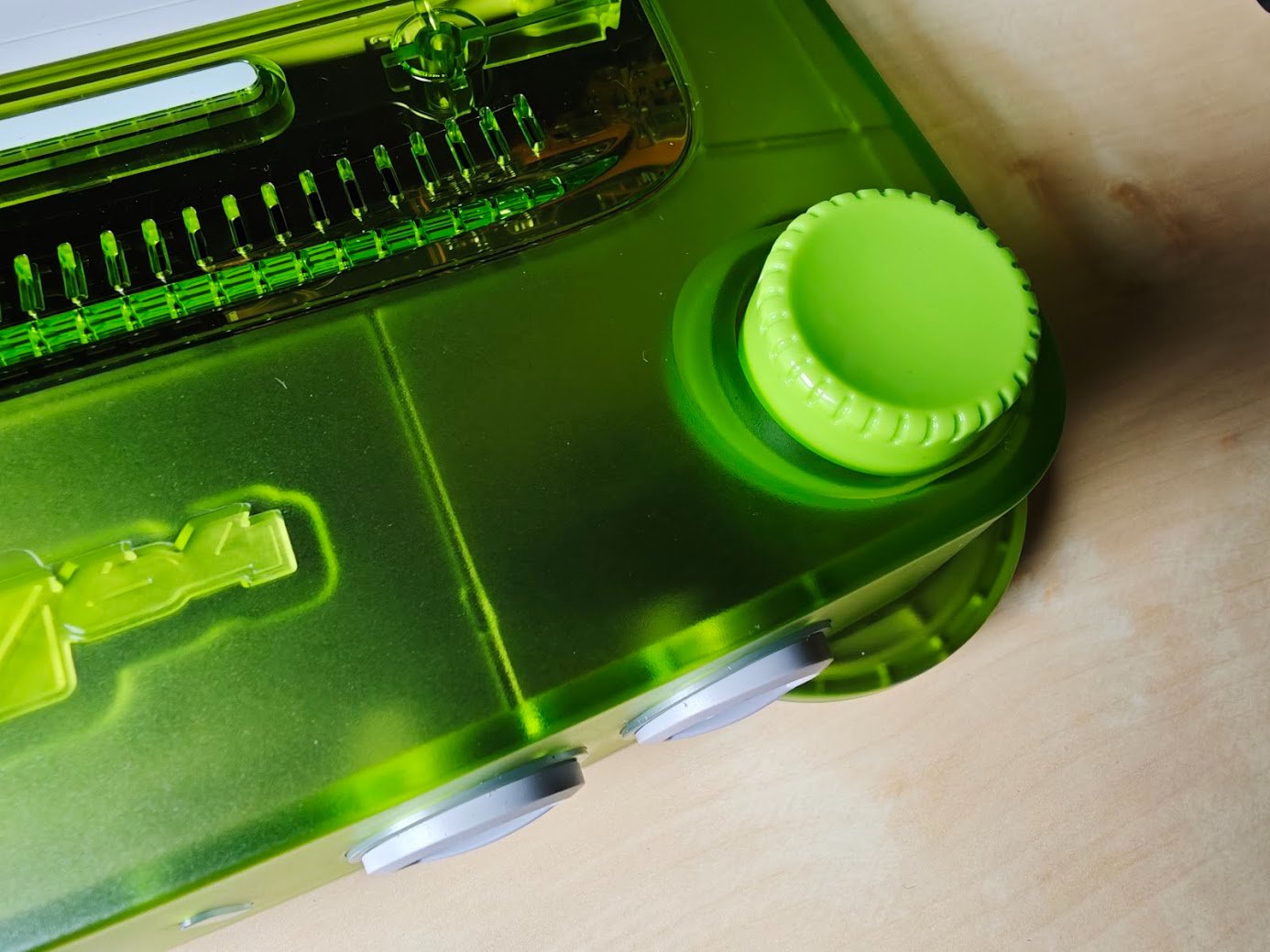

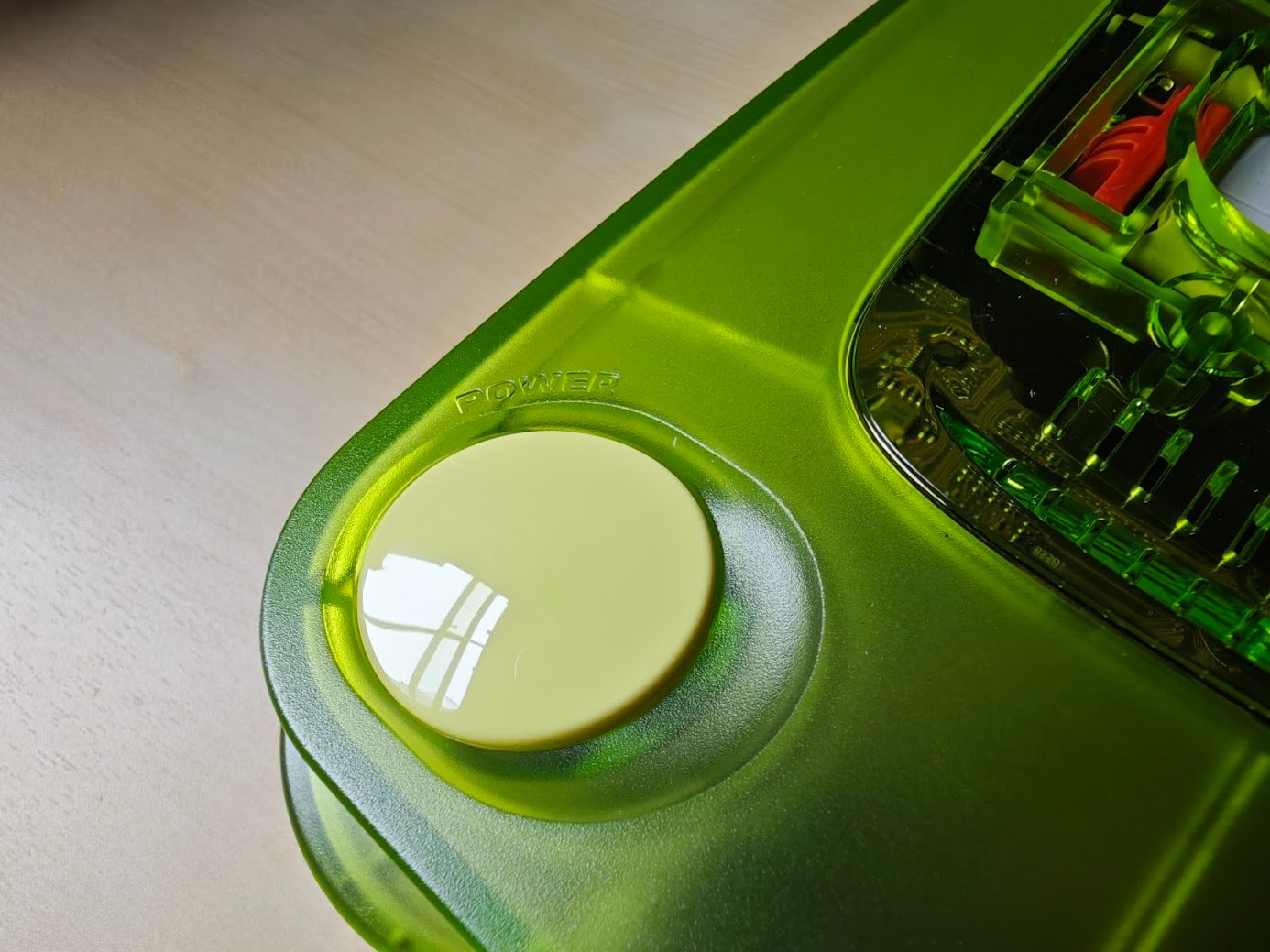

There are some changes to the hardware buttons as well. Instead of a Power and a Reset button, the M64 has a Power button and a clickable Menu dial. The latter allows you to navigate the system’s built-in menu to configure settings and update the device. A new button that the M64 introduces is the cartridge eject button (bearing the ModRetro branding). It’s a welcome addition that makes swapping cartridges easier. Also new is an LED uplighting strip that illuminates cartridge artwork (with adjustable brightness).

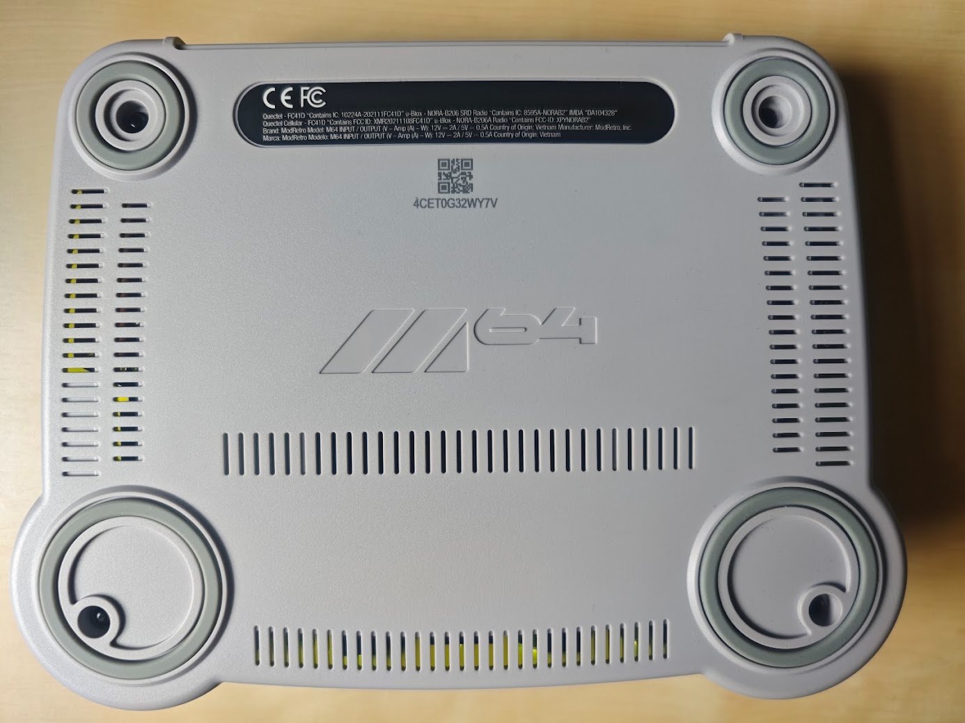

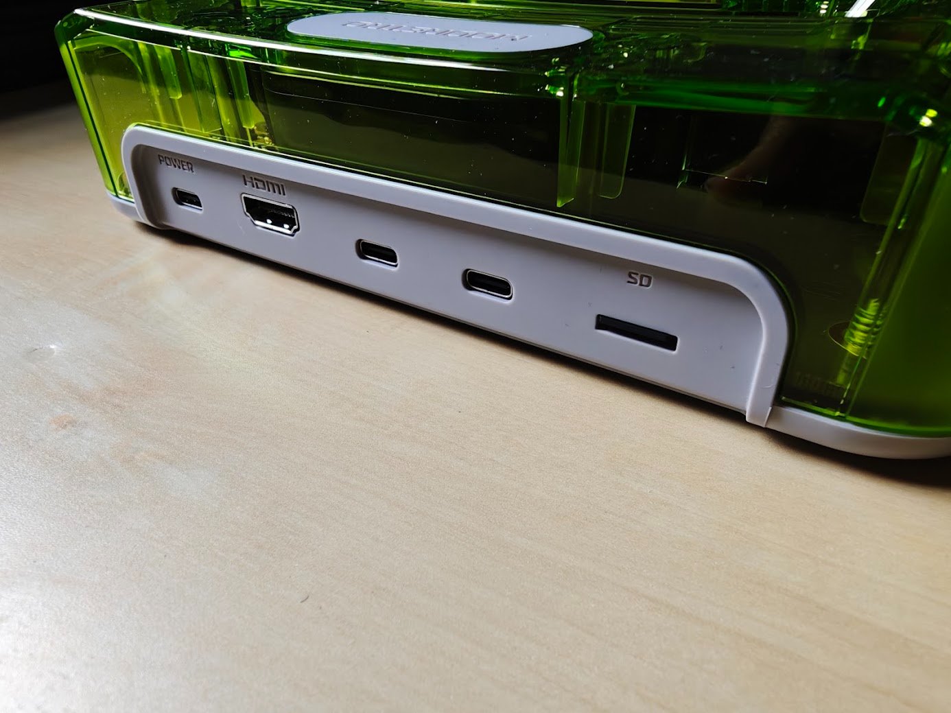

As a device released in 2026, the M64 also features contemporary connectivity options. At the back of the M64, you will find a microSD slot, three USB-C ports (including one for power supply) and an HDMI port. I was somewhat surprised that it does not include an AV port to directly connect to CRT TVs to recreate the classic N64 experience that the company seems so keen to achieve. However, ModRetro does have a dedicated CRT adapter in the works that is available to pre-order for $90, and the console’s menu includes a range of customizable scanline and CRT filter effects.
There are also subtle hardware upgrades that the M64 introduces that aren’t as evident to the naked eye. It has built-in Expansion Pak and Controller Pak, and Transfer Pak support through the Chromatic will become available in a future firmware update. Interestingly, the M64’s circuit board features gold traces to resist corrosion and improve conductivity.

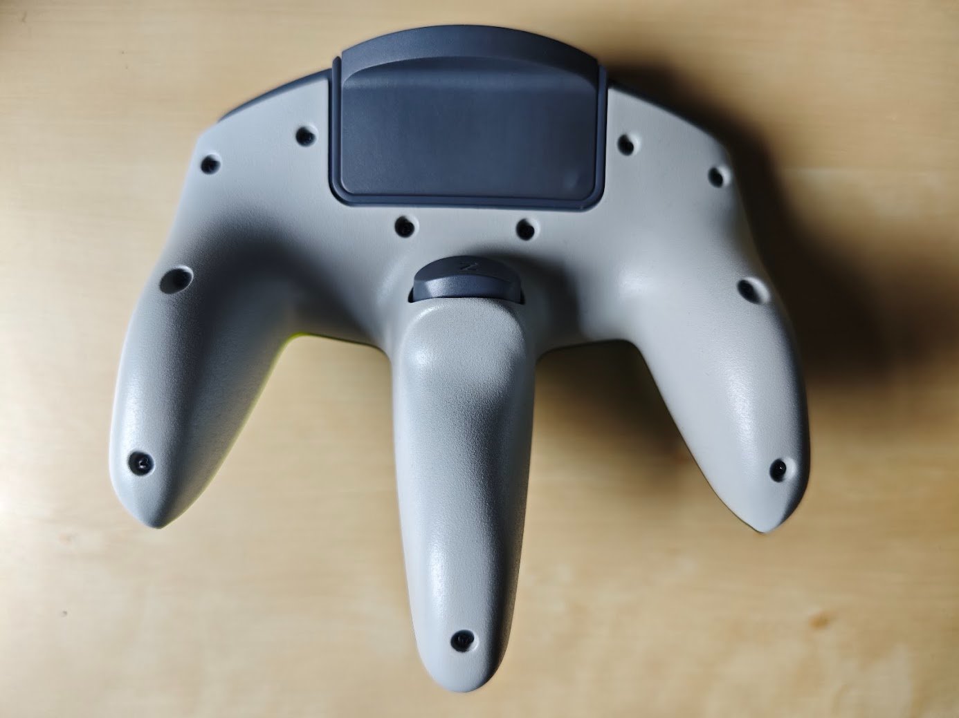

As noted earlier, the M64 ships without a controller. This Apple-like behaviour is uncommon for gaming consoles, but ModRetro notes that this deliberate choice stems from many customers already owning compatible N64 controllers and not needing an extra one. Omitting a controller from the base package also lowers its price, and the console is compatible with an array of controllers, including the M64 Pro Controllers, N64 controllers, Hyperkin Captain+ Controllers, Retro Fighters, Nintendo Switch NSO controllers (requires accessory), and 8BitDo 64 controllers.

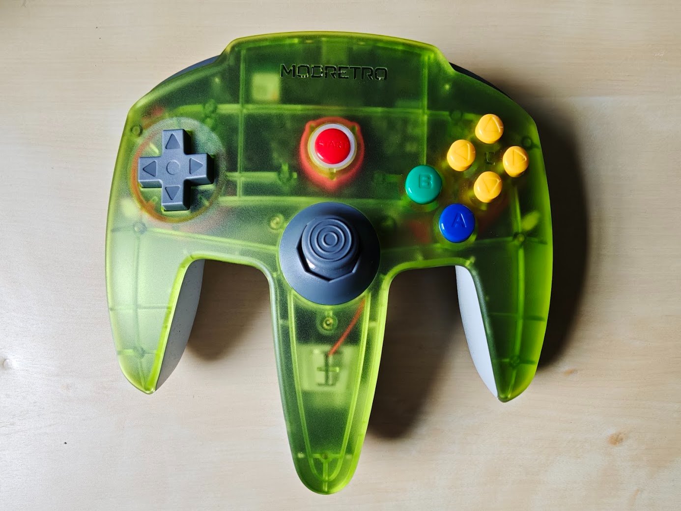

ModRetro’s own $90 M64 Pro Controller follows the original N64’s design and questionable ergonomics. Just like the M64, the controller packs a premium build, with an aluminium body and TMR analogue thumbsticks. The modern twist it brings is the ability to use it with the M64 in both wired and wireless modes (via ultra-low-latency Bluetooth SCI). This enables it to be used with the original N64 in wired mode as well as with Android and PC wirelessly (for N64 emulation, for example).
Review image Review image Review image
On the hardware aspect, the M64 and M64 Pro Controller are built to last. They both boast a premium build quality, with durable components and modern features that are reflective of their price points. It is simply a shame that the console is not packaged with a controller, although I can see the company selling them as a bundle in the future.

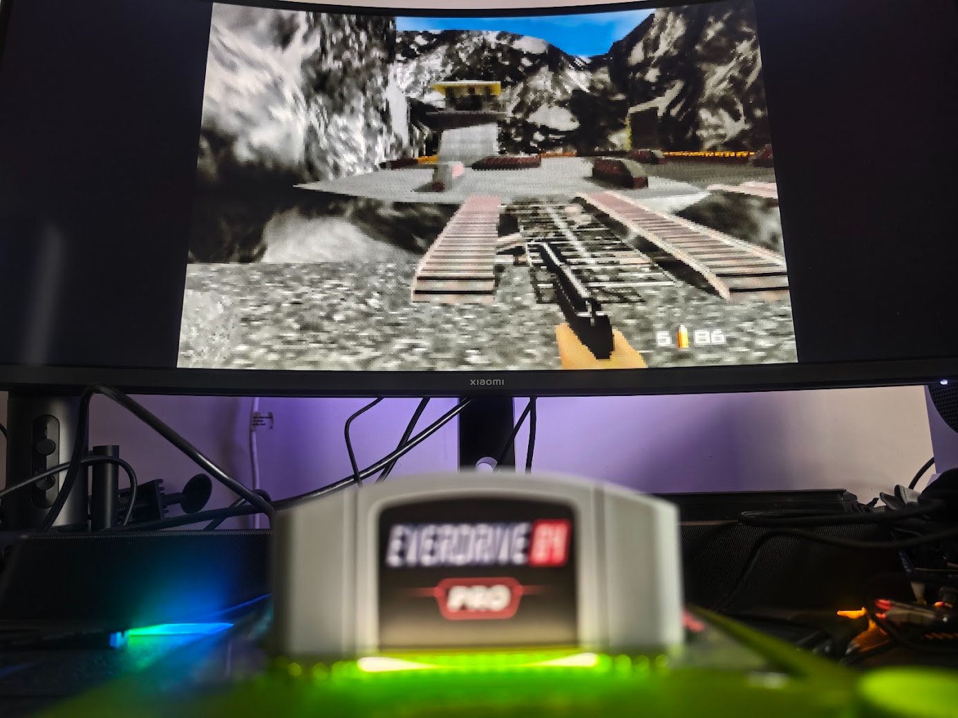

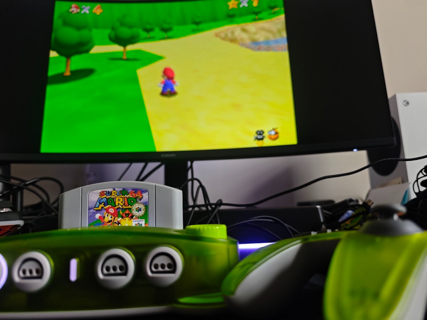

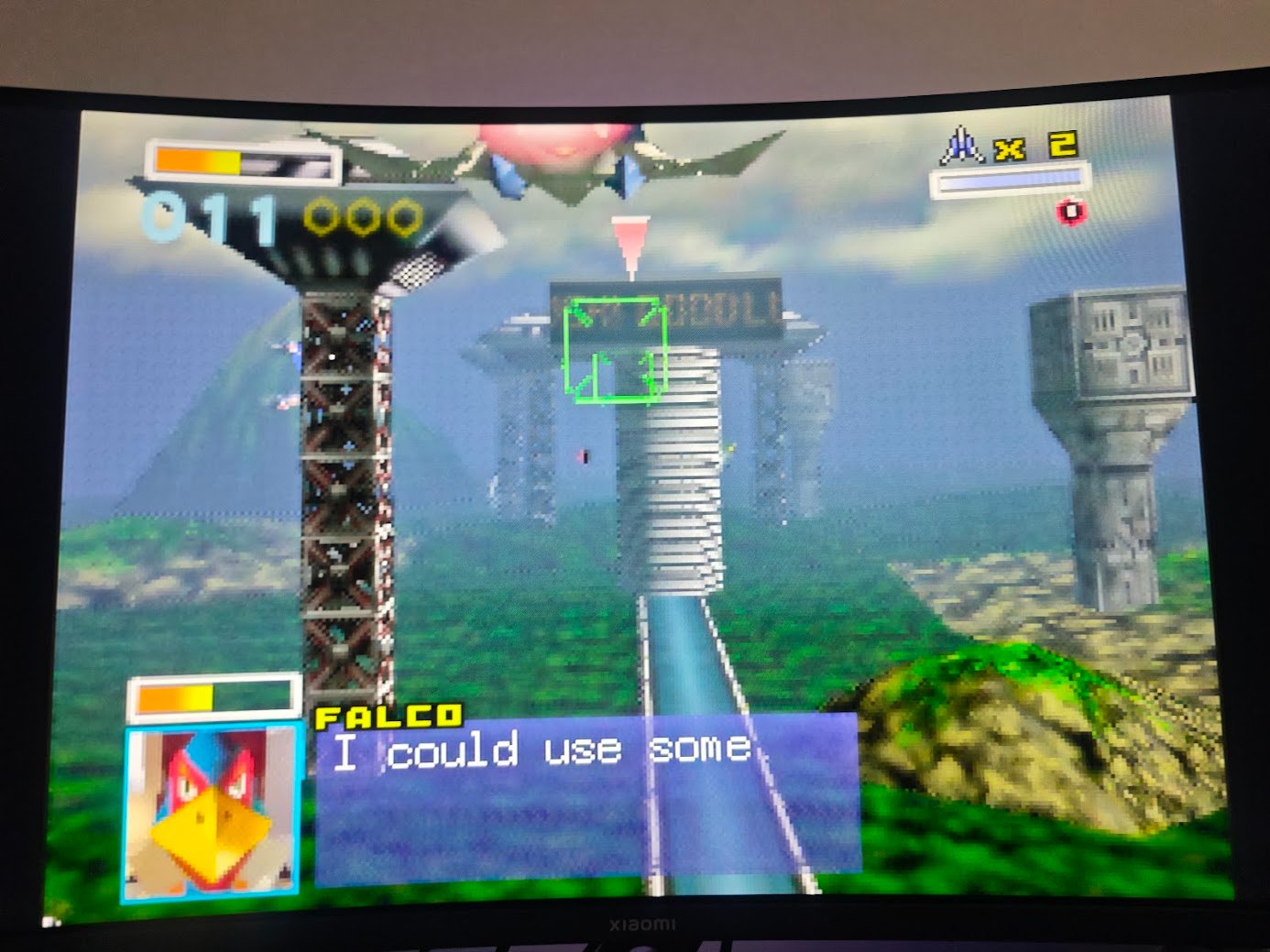

All games that I've thrown at the M64 ran flawlessly. Classic games such as Super Mario 64 and Perfect Dark are revitalised with the M64’s support for 720p, 1080p, 1440p and 4K resolutions (and filters for that extra retro look). Even unofficial carts are supported, such as the recently released Everdrive 64 Pro. The best thing regarding cartridge support is that the console is region-free. This lets you play NTSC, PAL and NTSC-J cartridges on the same system with no issues. This is a major step-up from the original N64, allowing you to experience some games that were tied to specific regions (I’m looking at you, Sin And Punishment).

That said, there are some known issues with some titles (20 at the time of writing). Some, such as Turok 2: Seeds of Evil, suffer from FPS drops, while others, like StarCraft 64, face occasional crashes. This is not ideal, but ModRetro is transparent about these issues and is working to resolve them via updates.

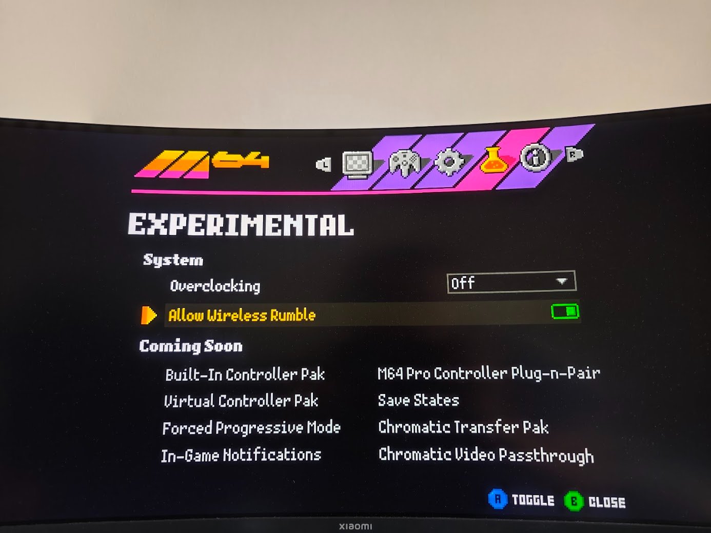

Some issues might even be fixed with overclocking, and the M64 comes with a standard overclocking mode. An advanced mode is being developed that leverages the M64's PSRAM memory architecture that supports higher overclocking. This will be made available via a future update.
It is recommended to update the M64 to make the most of the system. This can be performed in several ways, over WiFi, via an SD card or by plugging it into a computer. Like with the Chromatic, updating a retro system feels contrary to the purist ethos that the company aimed for, but this can address performance and compatibility issues that the original system faced.

That aside though, the controller really feels top-notch. Everyone thought the 8bitdo controller was ass until they realized it just needed calibrated, lmao. Now it's the best N64 controller in my home.

@codezer0 SummerCart64 and Everdrive (2.5/X7/Pro) work fine, as does the N64 Cart and 64Drive (NeoMyth64 probably too, I haven’t tested that one).
In fact, my Z64 also works on the M64.
Only flashcart emulators on the M64 need “fixed” versions to work visually, the stock ones are garbled (Sodium64, for example, still runs slow but works perfectly on A3D)
You can't calibrate the 8bitdo controller? There's no software for it.
You know what impresses me the most of this? The fact it runs over USB-C... I wouldn't be surprised to learn this utilizes at least... 12V... but if it works with just 5V that'd be even more impressive.
On another hand... no pun intended... the controller... In my personal experience, I find the N64 controller very comfortable and to be more precise than the Gamecube Controller... seriously, about 5 years ago, I hooked my N64 for one last time (brick power thingie stopped working that night) and I played good old Zelda Ocarina of Time... I was very impressed with the accuracy and slow movements I could achieve while aiming with Bow and Slingshot... this threw me off rails because I CAN'T have such precision with the Gamecube Controller Analog Stick... and this year, I found that I wasn't imagining things... because when I got my 8Bit-Do SN30 pro, I got super curious about the Analog Sticks... and I still had troubles with aiming not unplayable, just found weird that "Link wouldn't respond" with tiiiiiiiiiiiny movements of analog stick as it does in real N64 with real N64 Controller.
That said... I'm guessing the N64 Controller was quite literally, built different... and if you think I'm crazy, please, test it yourself... play Zelda 64 in original hardware, and notice how Link can aim in first person mode with MORE PRECISION than what you can get with emulation and non original N64 controllers.
Then... if my eyes are not deceiving me... that N64 Wireless Controller only has a huge ass rumble motor in the middle grip? :ohnoes: Instead of having two rumble motors on the huge empty space on the D-Pad and C-Buttons handles? :sad:
To finish off my rant about a product I will NEVER utilize...

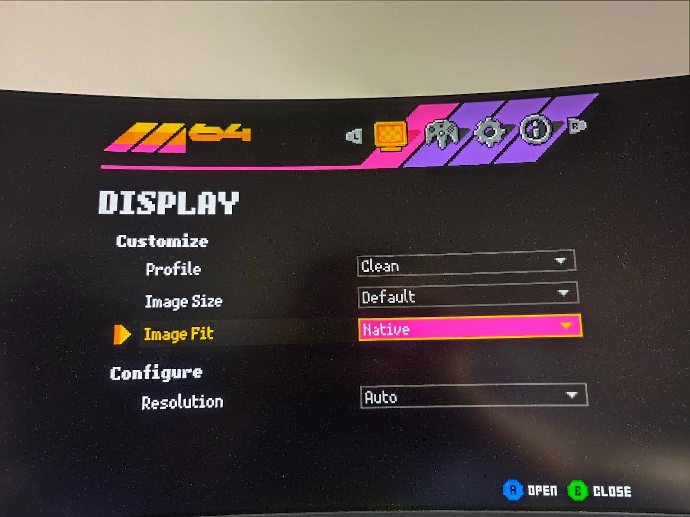

Does the M64 offer a mode where it looks better and without the crt filters. I don't get why people claim games back then were designed for it and look better.
Games weren't designed for crt, they're not supposed to have black lines and rgb blobs, this simply was the current technology we had for displays.

N64 VI filter is designed with CRTs in mind, though, and it is present in every game to improve the visuals for that particular type of display. Even if you ignore CRTs in particular, it is undeniable the games were made for the resolution they were originally rendered in, considering the asset quality.
Considering you have a MiSTer, give video filters a try to see what I mean:
  • Horizontal filter: CRT composite, or CRT S-video (less extreme, but less effective for dithering)
  • Vertical filter: Scanlines - Brighter
  • Gamma correction/shadow mask: pick whatever you like, or nothing at all
The result will be that, in most games, not only do the jaggies disappear, but rather than appear like pixel art or poorly aged 3D games, they look like an oil painting, in a very positive kind of way. Personally, I absolutely love this.
