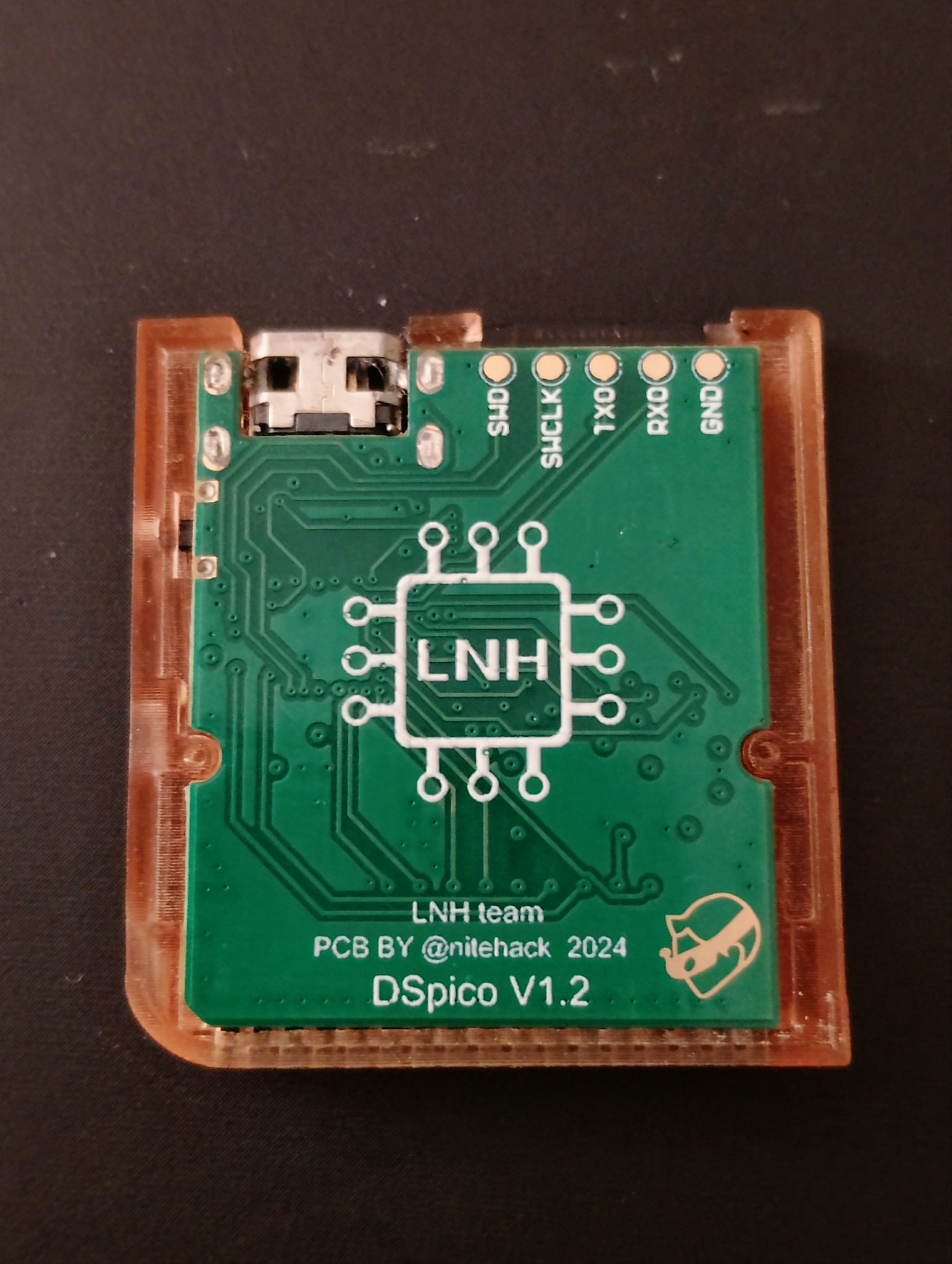

LNH Team member here! It’s been an amazing journey, guys. I’m incredibly happy to finally see this project out in the open, can’t wait to see what everyone does with it!
I’m sharing with you some photos of an earlier prototype I currently use, it’s actually not very far from the final version now available to the public.
