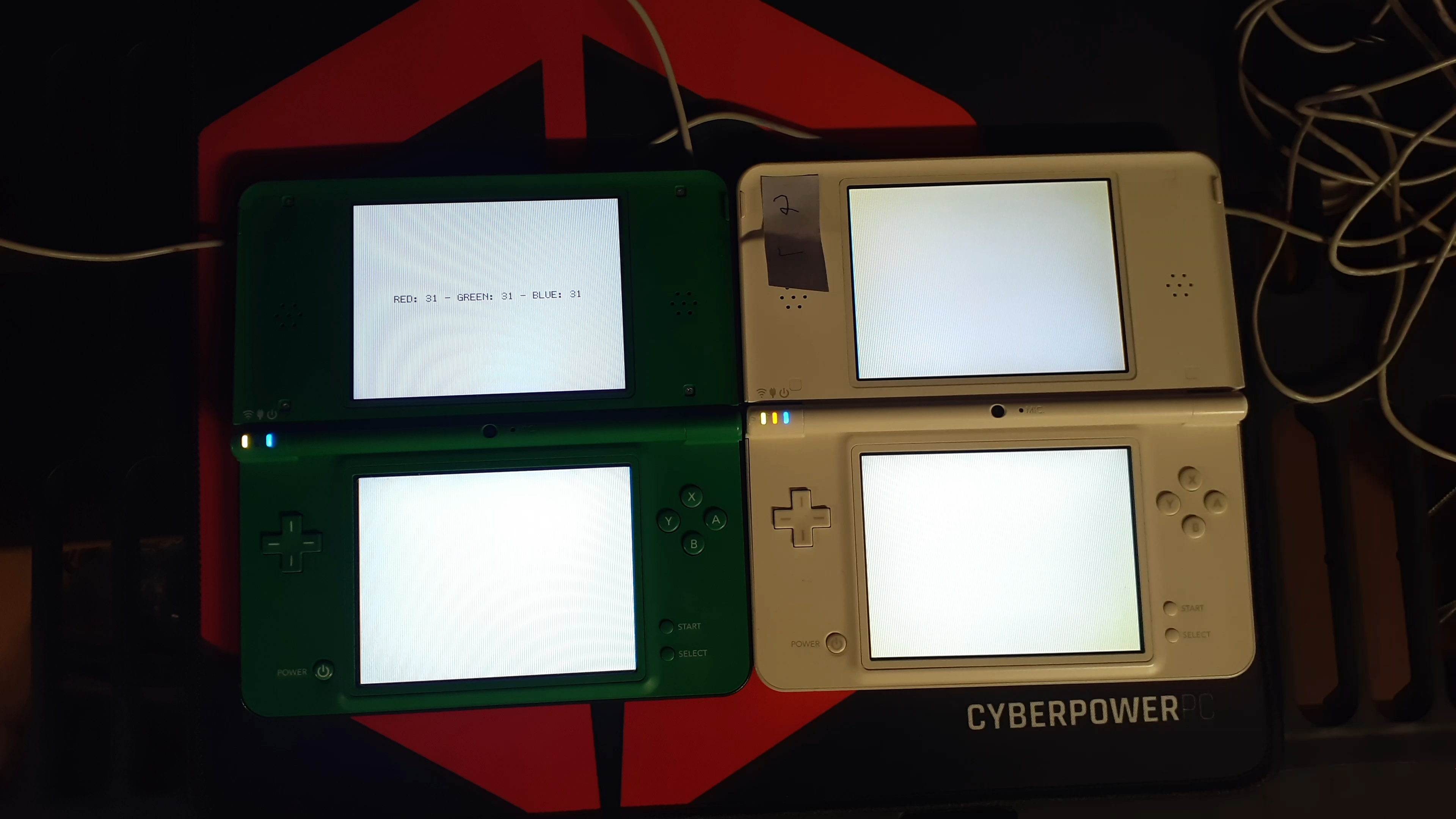

Day 0: 7/29/24 - Set Up
Equipment and Tools:
  • 5 Dsi LL consoles. Each console is functional to the extent I was willing to test them. Functional to the point of loading the LCD Tester (more below).
  • A European Green Dsi XL was used as a control. This console has screens I would consider in excellent condition in both color and temperature. The console was left off and unplayed when observations were not made.
  • SD cards containing the Flipnote Lenny exploit (Launching the Exploit (Flipnote Lenny) | DSi Guide (cfw.guide)) and a copy of the LCD Tester (DS LCD Tester – GameBrew) to create a solid white screen.
  • A Samsung A20 Smartphone is used for the camera. The phone was left on default settings.
  • Camo Sudio Application for the Samsung A20 Smartphone and Computer for communication between devices. The program was left on “auto” for all settings.
  • OBS Studio for Samsung A20 device capture and screenshots.
  • Insignia NS-22E400NA14 Computer Monitor for viewing the photos.
  • A Cyberpower mouse pad as a background for the images and a reference point for lining the console up when it came time to take photos.
  • LibreOffice for Word Processing and Data.
  • GIMP for photo and color capture.
  • CIE2000 Delta-E Calculator - ColorMine.org for Delta E Calculations.
Methodology:
The Dsi XL consoles were loaded with the LCD Tester program and left on the white screen for the entire duration of the experiment. The consoles were not turned off or put into rest mode. All consoles were plugged into a charger. Battery and charger conditions were not measured beforehand but were functional enough to keep the consoles on.
Consoles were left on an unlit shelf in a temperature-controlled home ~68 F. Due to the lack of measuring equipment, factors such as humidity and day-to-day room temperature were not accounted for. Ambient light from LED lights in the room was the only light source that would impact the images aside from the consoles themselves.
Samsung A20 is Velcro strapped to the shelf above the consoles as a means to hold the camera in a somewhat fixed position for the duration of the experiment. The software Camo and OBS were not controlled and may have been updated at various points in the experiment.
When it came time to photograph the console, each console was moved, by hand, underneath the Samsung A20 on top of a Cyberpower mouse pad. The ‘Cyberpower” text was used as a reference point for me to try and keep each photo the same.

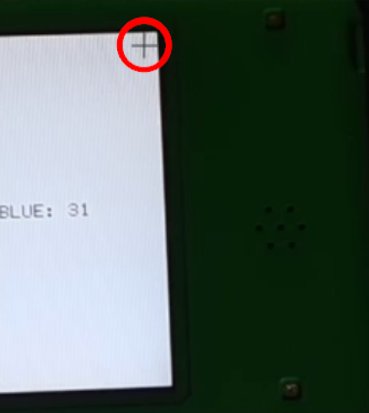

Since I do not have an objective means of capturing the exact color value of the screens (via colorimeter or other such color accurate devices), nor a controlled environment, all accounts will be subjective and to the whims of both the camera capturing programs, and the phone used to capture the images. I will make a Subjective Observation of what I see with my eyes, and an observation of the photos between the testing periods.
At the end of the experiment, the photos taken will be bought into the photo editing software Gimp and, using the Color Picture Tool and CIE200 Calculator on Colormine.org (CIE2000 Delta-E Calculator - ColorMine.org ), a Delta-E measurement compared to the control will be taken and graphs will be made for each console showing the progression. I am very ignorant when it comes to color theory, but this is the only objective measurement I can think of doing with the equipment I have.

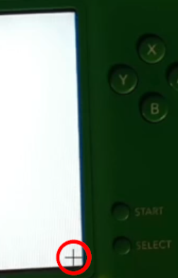

The GIMP color picker was used on the same spot for every console. Both spots were on the corner of each screen where I believe the yellowing is expressed the most. This would be the top right corner of the top screen and the bottom right corner of the bottom screen.
The experiment will last for 58 days starting on 7/29/24 and ending on 9/24/24

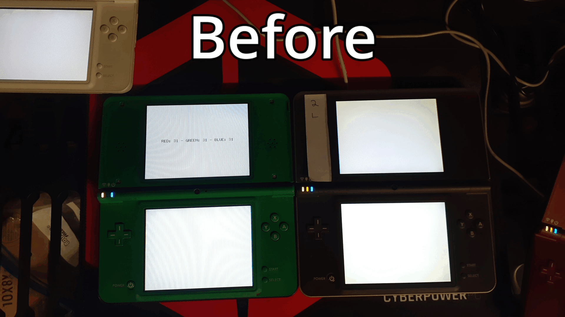

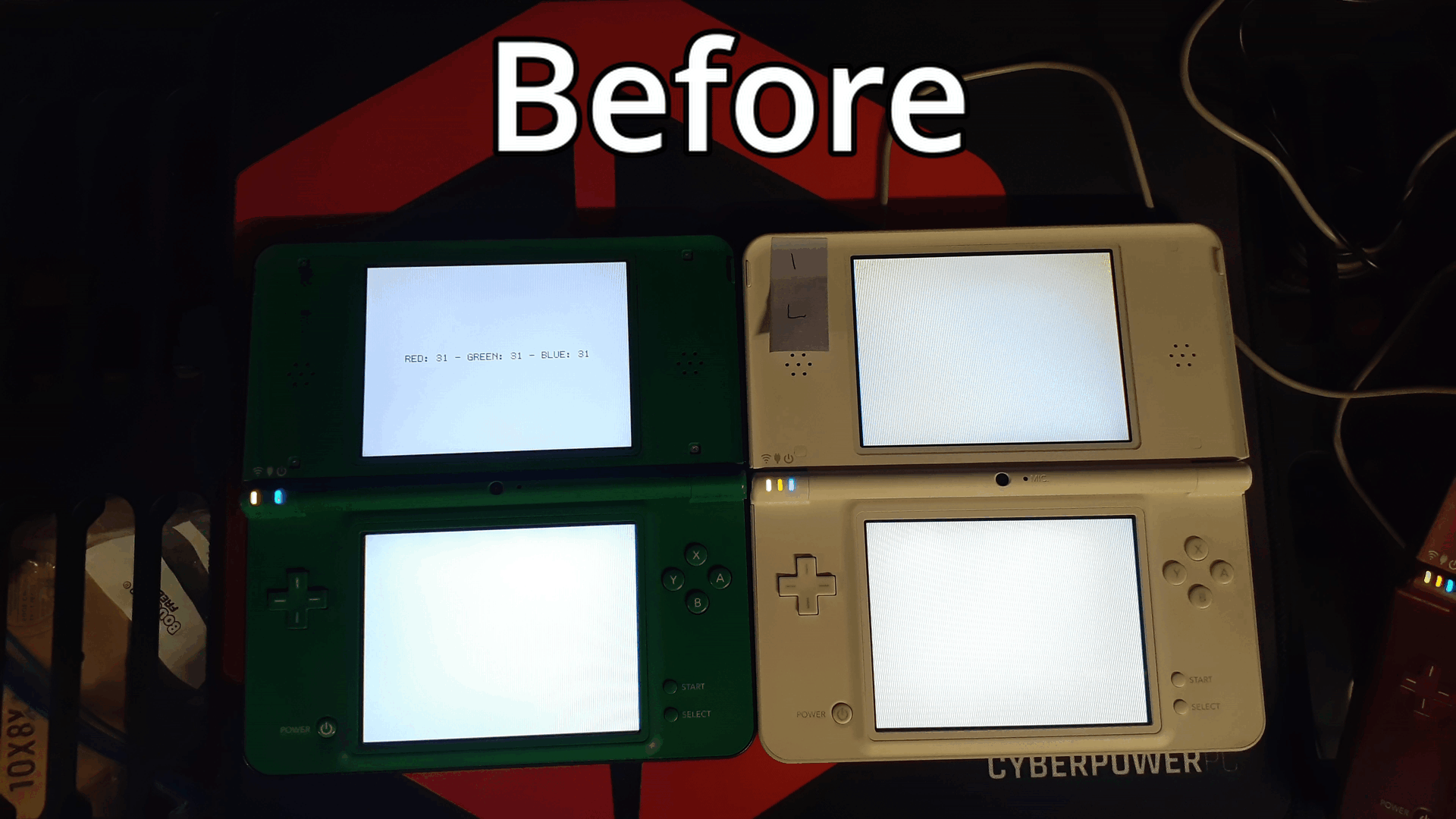

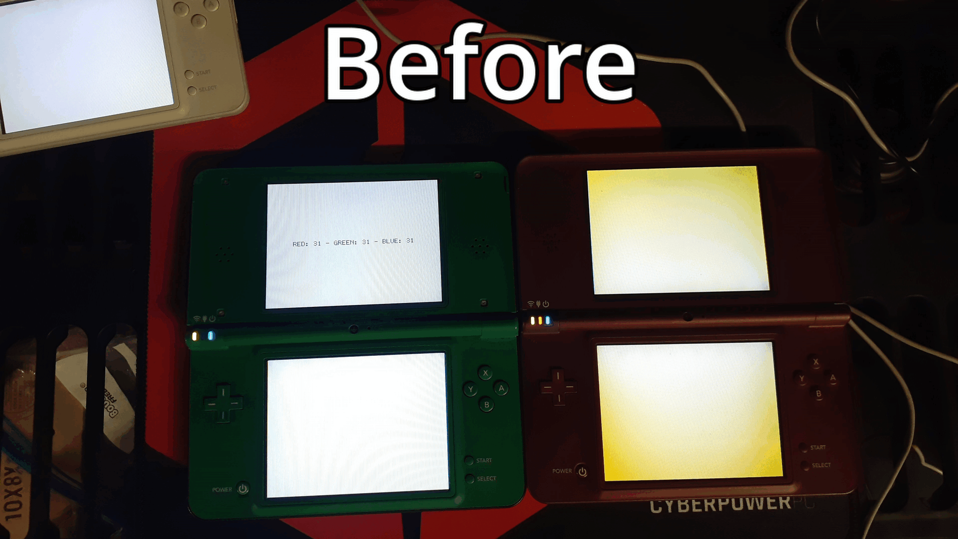

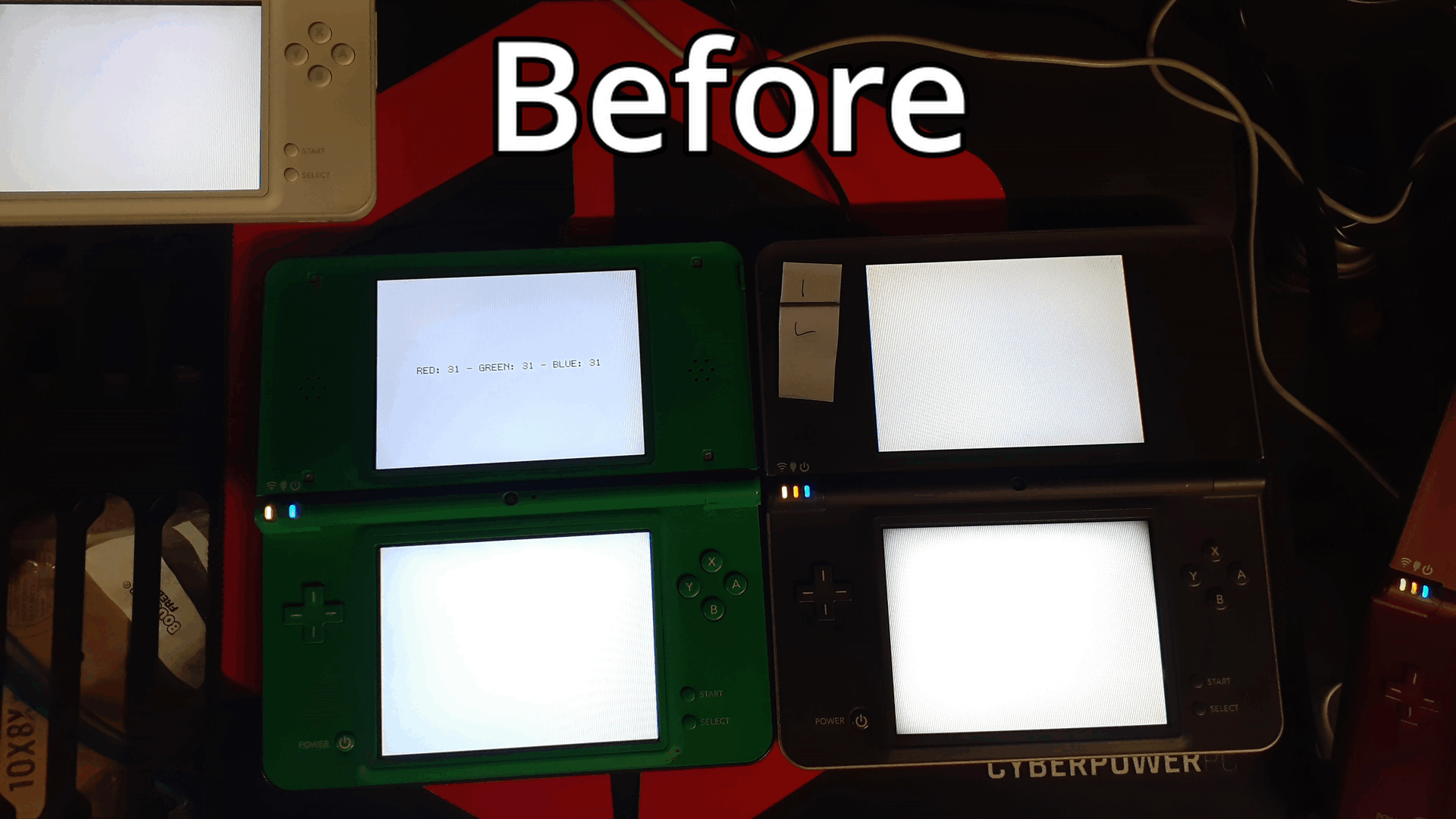

Day 1: 7/29/24
Subjective Observations:
  • White 1L – Mild Yellowed.
  • White 2L – Extreme Yellowed both screens
  • Burgundy – Extreme Yellowed both screens.
  • Brown 1L – Mild yellowing on top screen. Vignetting on bottom.
  • Brown 2L – Mild Yellowing on both screens.
Author’s comments:
I do expect a change in the extremely yellowed consoles, as what we see in @Jake64’s video, but for the idea that you can make a yellowed screen white, I do not believe that is possible for the damage has already been done.
Day 11: 8/8/24
Studying the Photos compared to Day 1:
  • White 1L – No Noticeable change.
  • White 2L – A significant reduction in yellowing from both screens. The console is very similar to the current condition of White 1L. The yellowing in the corners was reduced by a significant factor.
  • Burgundy – A significant reduction in yellowing from both screens. Screens match the current condition of White 1L and 2L.
  • Bronze 1L – Maybe a slight change, but really hard to tell. Vignetting on the bottom screen is unchanged.
  • Bronze 2L – A noticeable lessening of the yellowing.

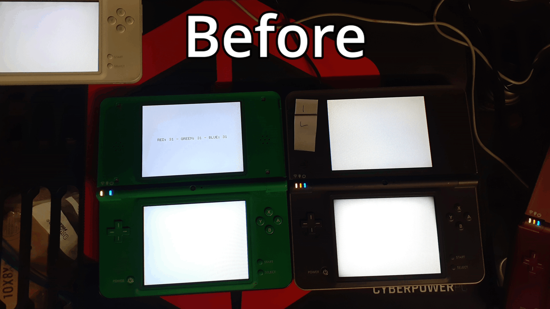

Day 22 – 8/19/24
Studying the Photos compared to Day 11:
  • White 1L – No noticeable difference
  • White 2L – No noticeable difference
  • Burgundy – No noticeable difference
  • Bronze 1L – No noticeable difference
  • Bronze 2L – No noticeable difference
  • White 1L – Extremely minor yellowing on bottom screen edges. Minor yellowing on top screen edges.
  • White 2L – Significant screen yellowing.
  • Burgundy – Significant screen yellowing.
  • Bronze 1L: - Extremely minor yellowing on top screen corners. Vignetting on the bottom screen.
  • Bronze 2L: Extremely minor yellowing on corners for both screens.
Author’s Comments:
From what I recall from Day 11, and my notes on Day 11, I notice absolutely no difference between these two time periods. I won’t say that the experiment has plateaued, but there is obviously not as much change as there was between Day 1 and Day 11.
I would say that the screens on White 1L, and both Bronze Consoles are still in good enough shape that the screens are sellable (save for the bottom screen on Bronze 1L).
Since there were no noticable change between Day 11 and Day 22, I will not do any more observations until the last day.

Based on what I see both on the consoles in person and comparing the photos, the choice to not record information between Day 22 and Day 58 was a good one as there was no difference. I was keeping an eye on them, of course, but I could see that there was no noticeable change in screen yellowing.

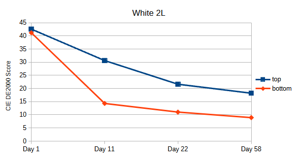

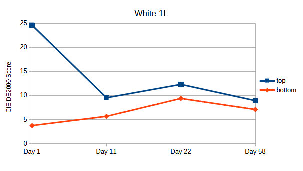

Conclusion/Discussion:

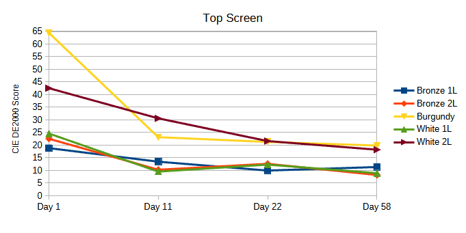

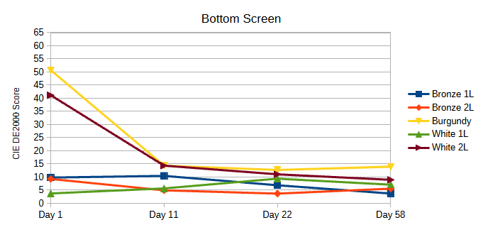

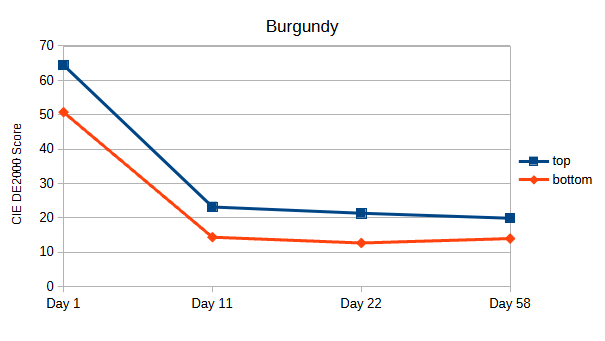

There is some validity to the theory that keeping consoles with yellowed screens on for a duration of time can work to reverse the yellowing. For the three consoles, White 1L, Bronze 1L, and Bronze 2L, whose yellowing was very minor to begin with saw, what I would consider a full recovery; for lack of a better word. For the two consoles with the more extreme yellowing, White 2L and Burgundy, the yellowing appears to be irreversible. So, in the most extreme cases, it would appear that yellowing is permanent damage.
(For the graphs, the lower the score, the closer the screens are to matching the control console)
The duration of the experiment, 58 days, ended up being wholly unnecessary as the most significant improvement to the screens occurred within the first 11 days. If I do this experiment again, I would be interested in seeing how many days are needed before the Delta E begins to plateau so that a practical recovery plan can be recommended to people who are experiencing yellowed screens on their DS consoles.
If I were to look at this batch of consoles with the goal of selling them, White 2L and Burgundy would be far too yellowed to be considered sellable. The other three consoles, however, I would part with them as their screens look very good.
Another way of saying that is White 2L and Burgundy would be unplayable for most people as the yellow would, most likely, be noticeable while playing games.
(Note the different scales for the Y-Axis)

So has anyone tried doing this with a color other than white to see if the fix is actually from the color or just the heat from the screen at full brightness?
One of my next rounds of experiments, that I hope to start within the next few weeks, will have a couple consoles running solid Red, Blue, and Green screens to see if there if the problem stems from the blue subpixel.
Reactions: Glx555
thank you very much for sharing with us this experiment! and btw. I would like to ask; if there is similar app for PSP, that would make your screen all the time white? I have psp with huge yellow dot in the middle of the screen, which as well might be related to humidity, and would like to try to do like OP...
Hello does this work with an dsi there some yellowing on the top and bottom screen but not noticable when play and should i do it?
if it worked with ds lite it might work as well with dsi. you could give it a try! and later post results:)
If I hadn't already done the white screen fix for 2 weeks just prior I would test that for you, but too late now.
Just 2 weeks has reduced yellowing by about 90% on the two DS Lites I have. Only a very faint yellow shadow remains on the edges.
