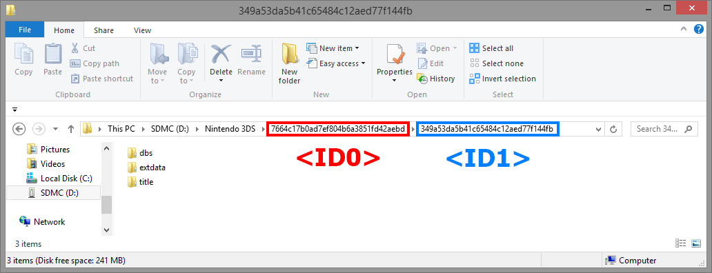

5. Verify that your Nintendo 3DS folder is still intact where it has a single <ID0> parent folder and a single <ID1> child folder. See this example image.
  • sdmc:/Nintendo 3DS/<ID0>/<ID1>/
    • dbs/
      • import.db
      • title.db
    • extdata
    • title/
      • 00040000 (games)
      • 0004000e (updates)
      • 0004008c (DLCs)

I think the unsafe removal of the SD card while your 3DS was still running corrupted your data. The missing title folder in <ID1> means all your games, dlcs, updates, saves, and extdata are gone now.
The ErrDisp could be explained by how the 3DS tries to populate the HOME Menu with your list of games from the database files (title.db & import.db), but with the titles no longer actually installed on the SD card, that means your 3DS panics trying to load but can't find their banners and icons.
Another cause of the ErrDisp is that data corruption affected the *.db files themselves.

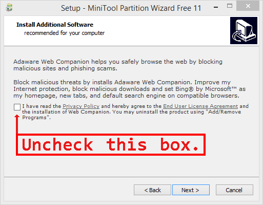

  • :!:Warning (MiniTool Partition Wizard): Do not install the Lavasoft Adaware Web Companion (bloatware).

  • Go in the sdmc:/Nintendo 3DS/<ID0>/<ID1>/ directory and delete only the dbs and title subfolders.
This is in case you still have any important extdata. There's also the Private folder voice recordings from Nintendo 3DS Sound and photos from Nintendo 3DS Camera.
Leave everything else on the SD card intact.
