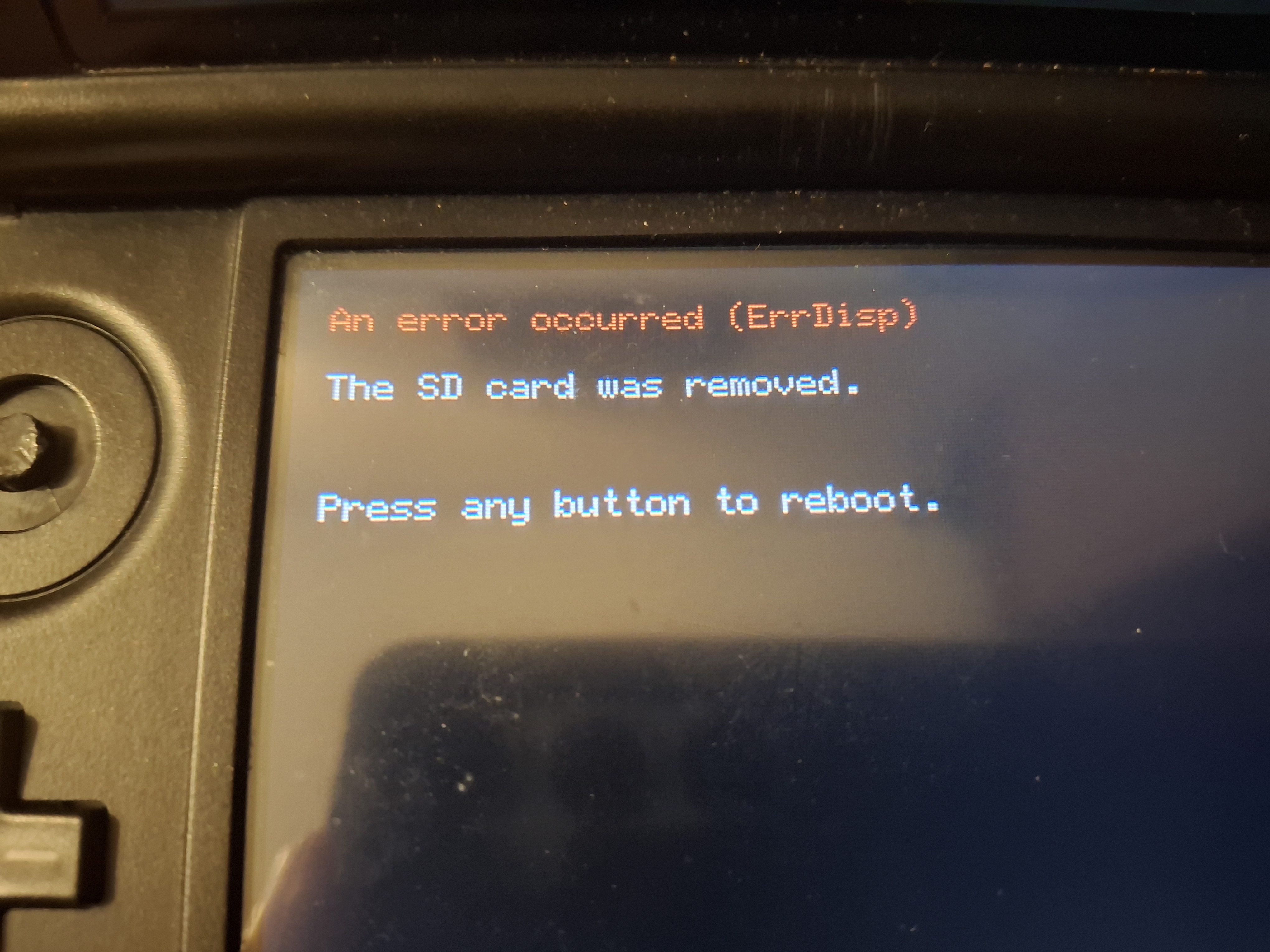

Whenever I try to load up any of my apps such as homebrew it says the SD card was removed
It says "An error occurred (ErrDisp)"
My 3ds loads up fine and it has a 64gb SD card with the Fat32 format, and any game downloaded via rhe mods work fine so im a bit confused
It also shows an orange light on the hinge when this happens if have my data backed up just in case tho
I'd test the card with h2testw and see what that says. Either your memory card is knackered or the card reader on your 3ds.

That is indeed confusing. You say "any of my apps such as homebrew" and "any game downloaded via rhe mods", so what exactly isn't working..?
Regardless, as the post above suggests, you should check your SD card.
Standard procedure: copy everything off your SD card (Roadkil's Unstoppable Copier is recommended since there's a possibility of corruption), format the card, test the empty card with h2testw, and copy everything back again. If the test fails or if you can't format the card, then you should get a new card (and copy everything to the new card after formatting and testing it). Sometimes copying everything back again is enough to fix problems.
