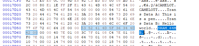

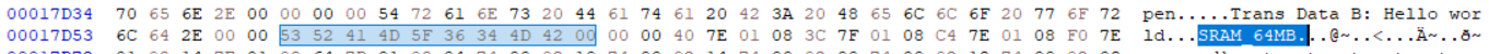

Have you tried editing FLASH_V123 to SRAM_64MB (ignore the 3 in V123 for now) then on the hex side replace the 33 of the extra 3 with 00?
Looking at GBARunner2's code it looks like that should work, any other character besides NUL (hex 00) will likely cause issues, but that should work I think.
@haddad Basically do what Pk11 wrote above, with emphasis on writing 00 as the last byte, and not just a punctuation as text on the right-hand side like I wrote earlier, since that will give you 2E as the last byte value on the left side of the hex editor (i.e. the side that shows the hex values and offsets).
Here's a picture explaining how it should be:

Does not work, I make that change, and game does not even boot or pass loading screen
That's weird, but there must be something we're missing then. I take it you made this change to a GS2 rom you had already patched with gbata first? I'll ask around if there's something else that needs to be done.
Yes I opened gbata, loaded the rom, went to SRAM Patcher, patched it, then did the hex thingy.
