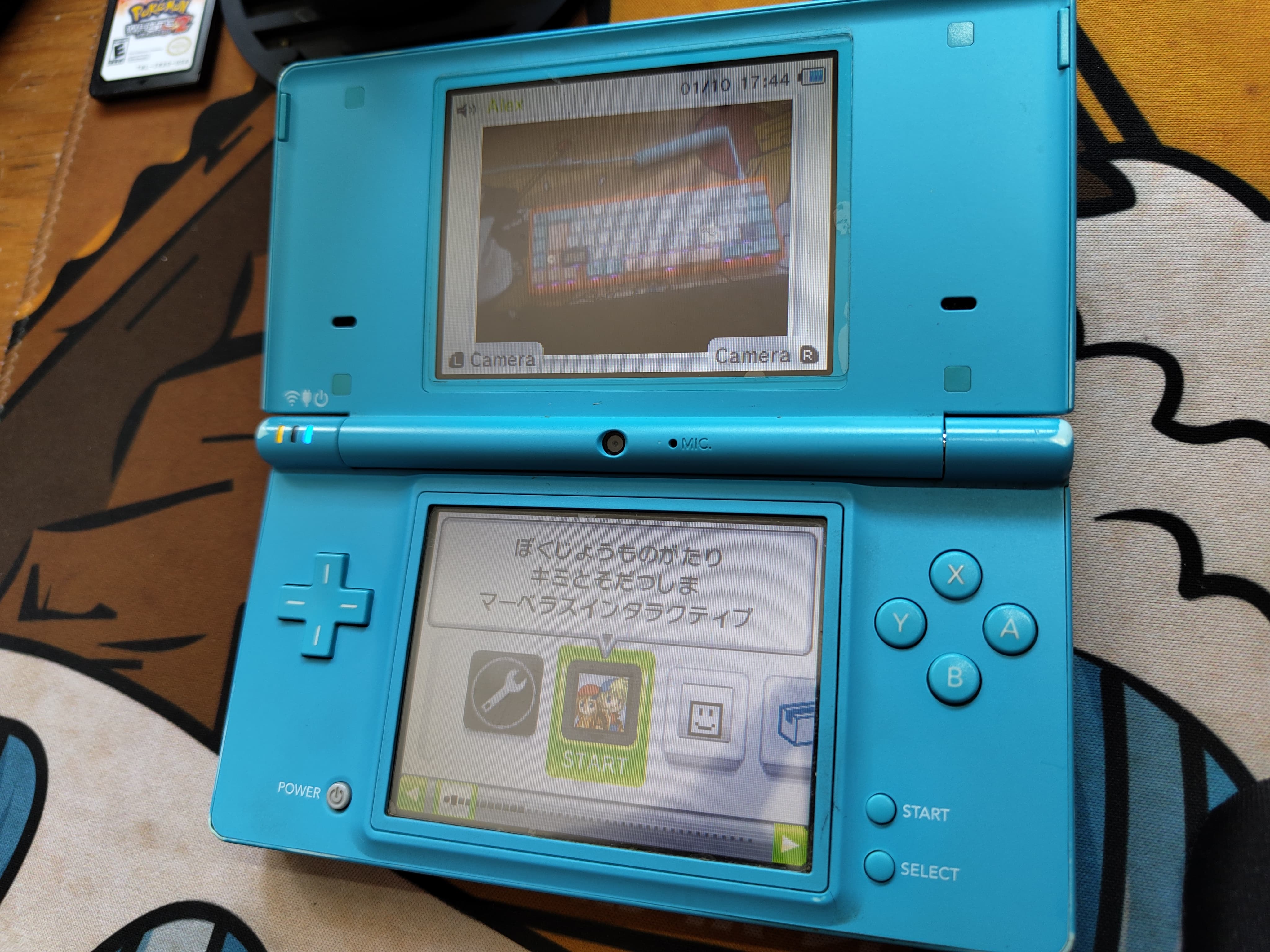

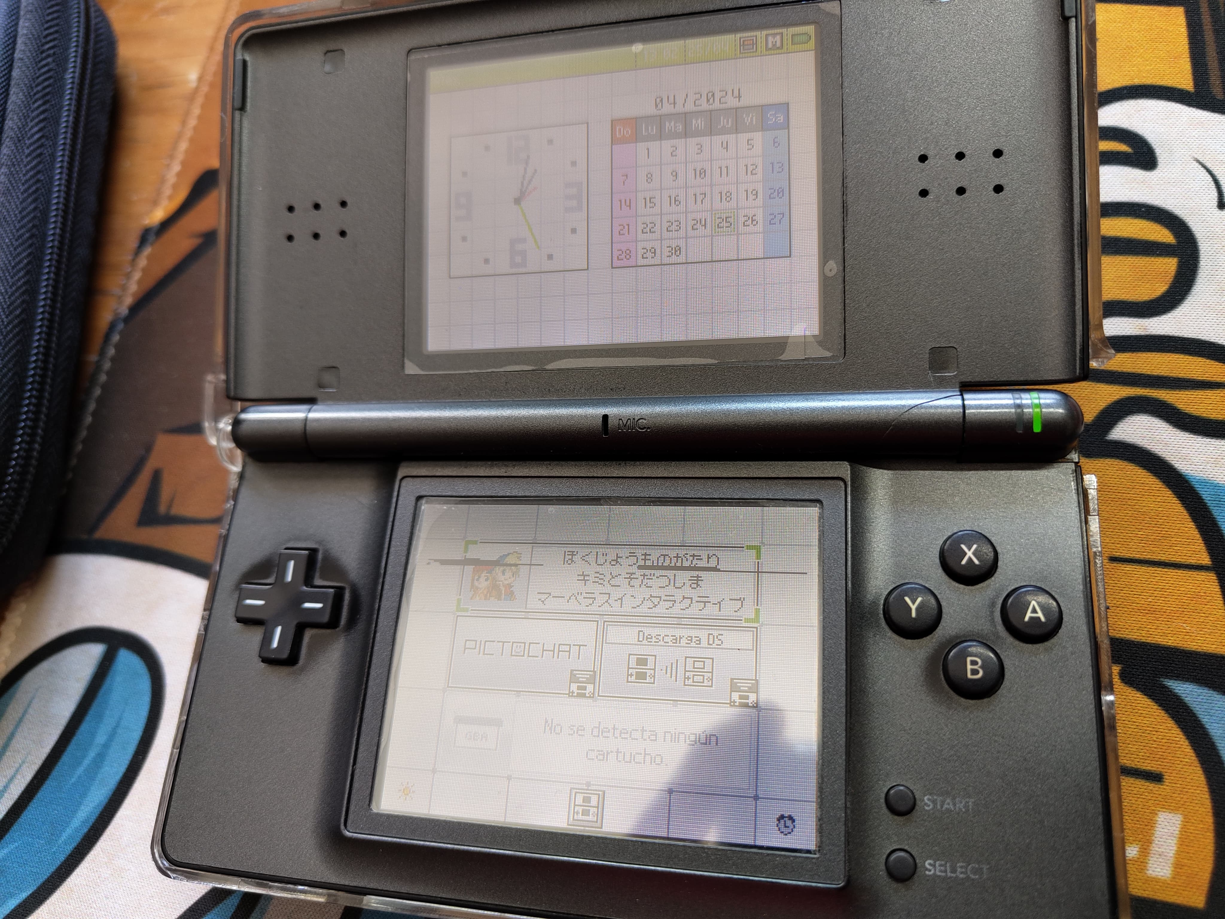

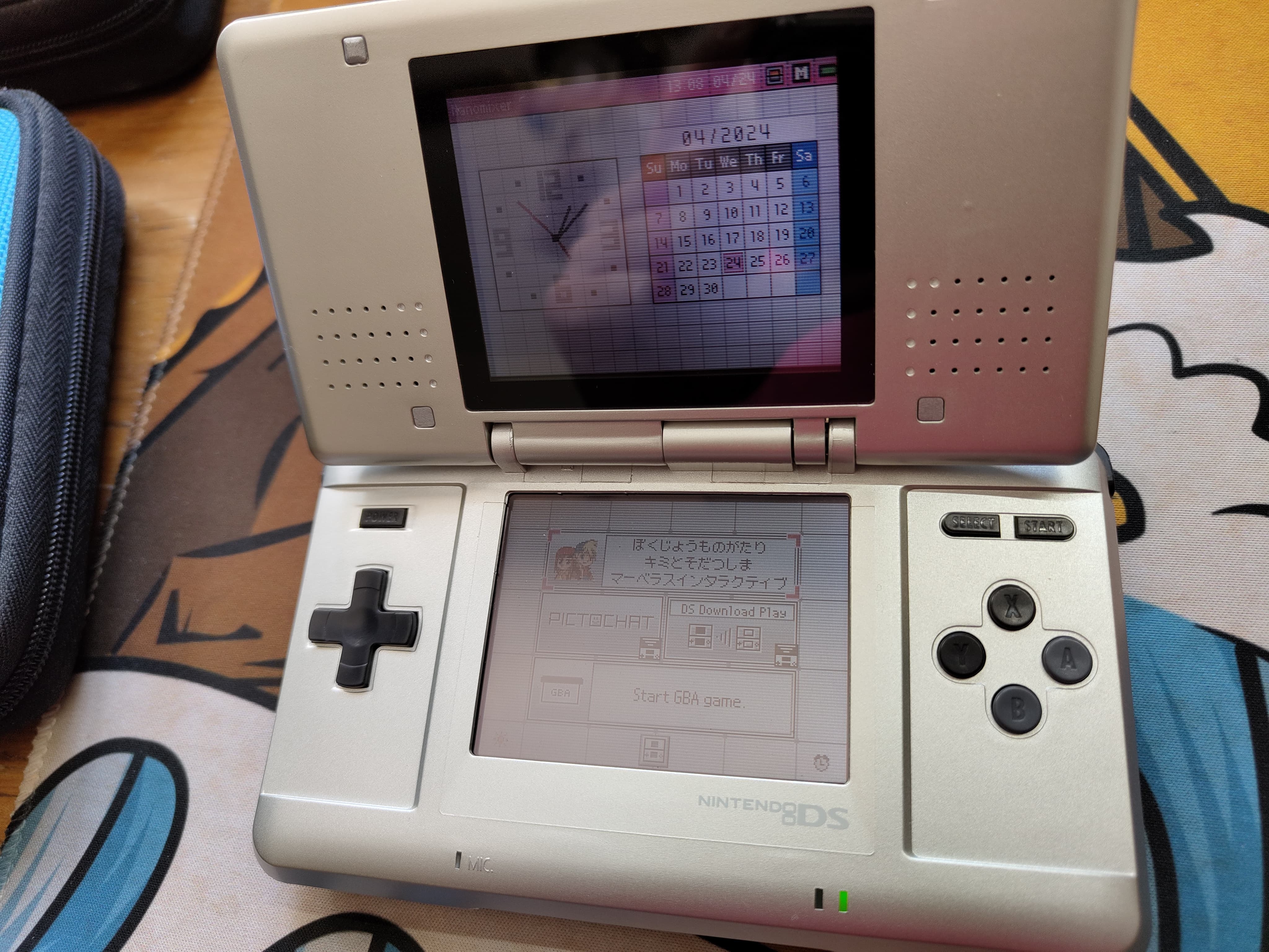

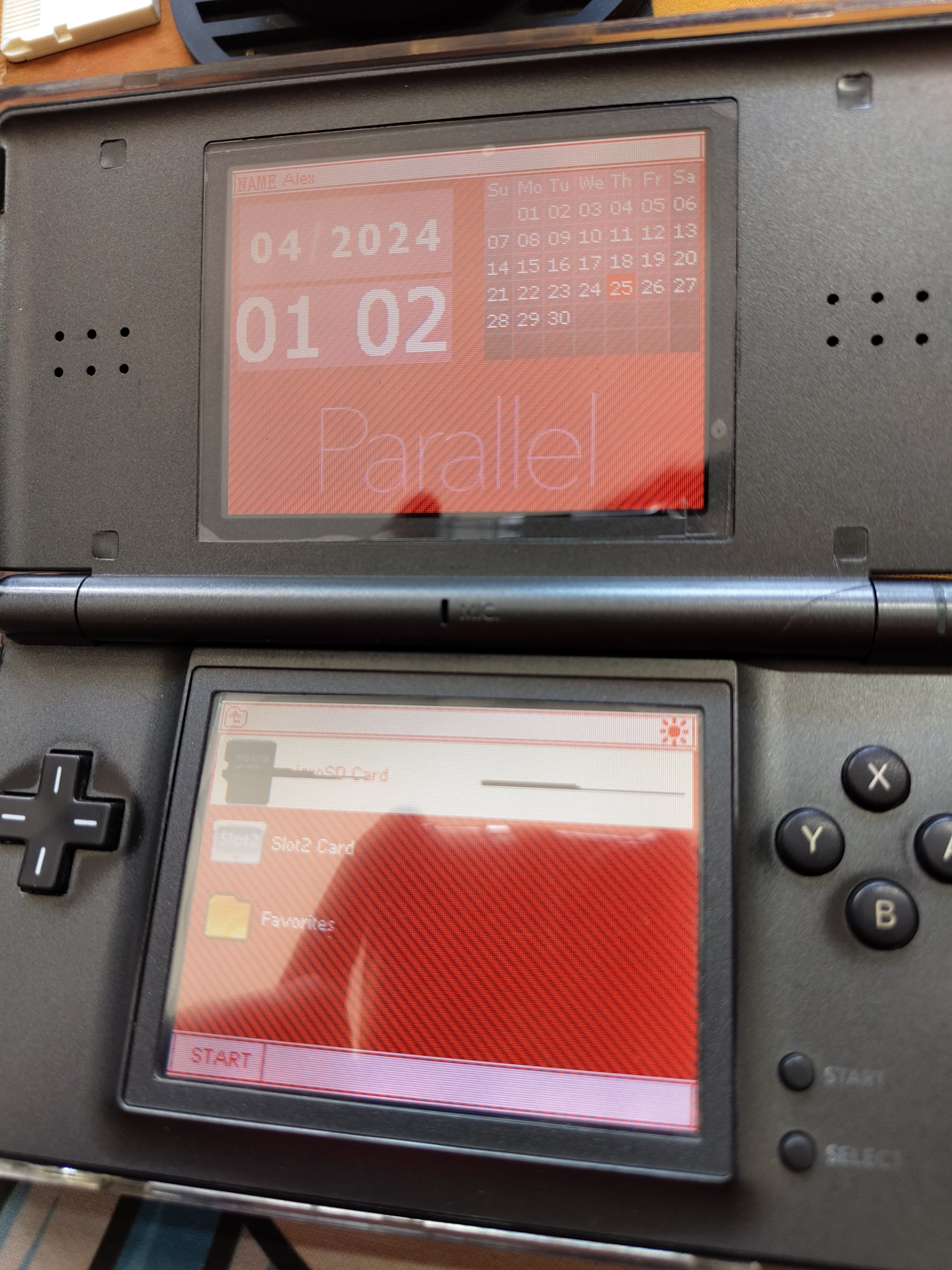

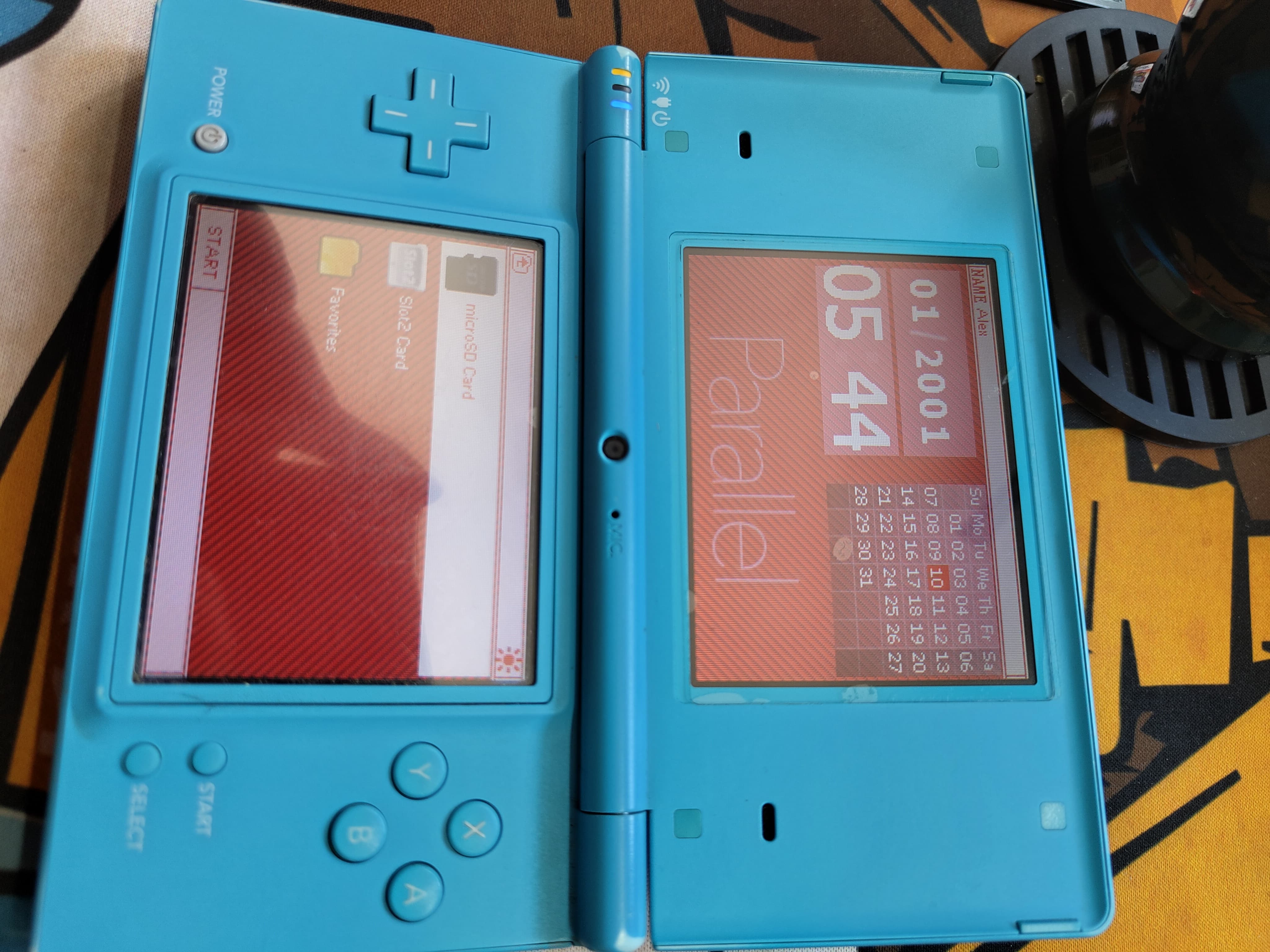

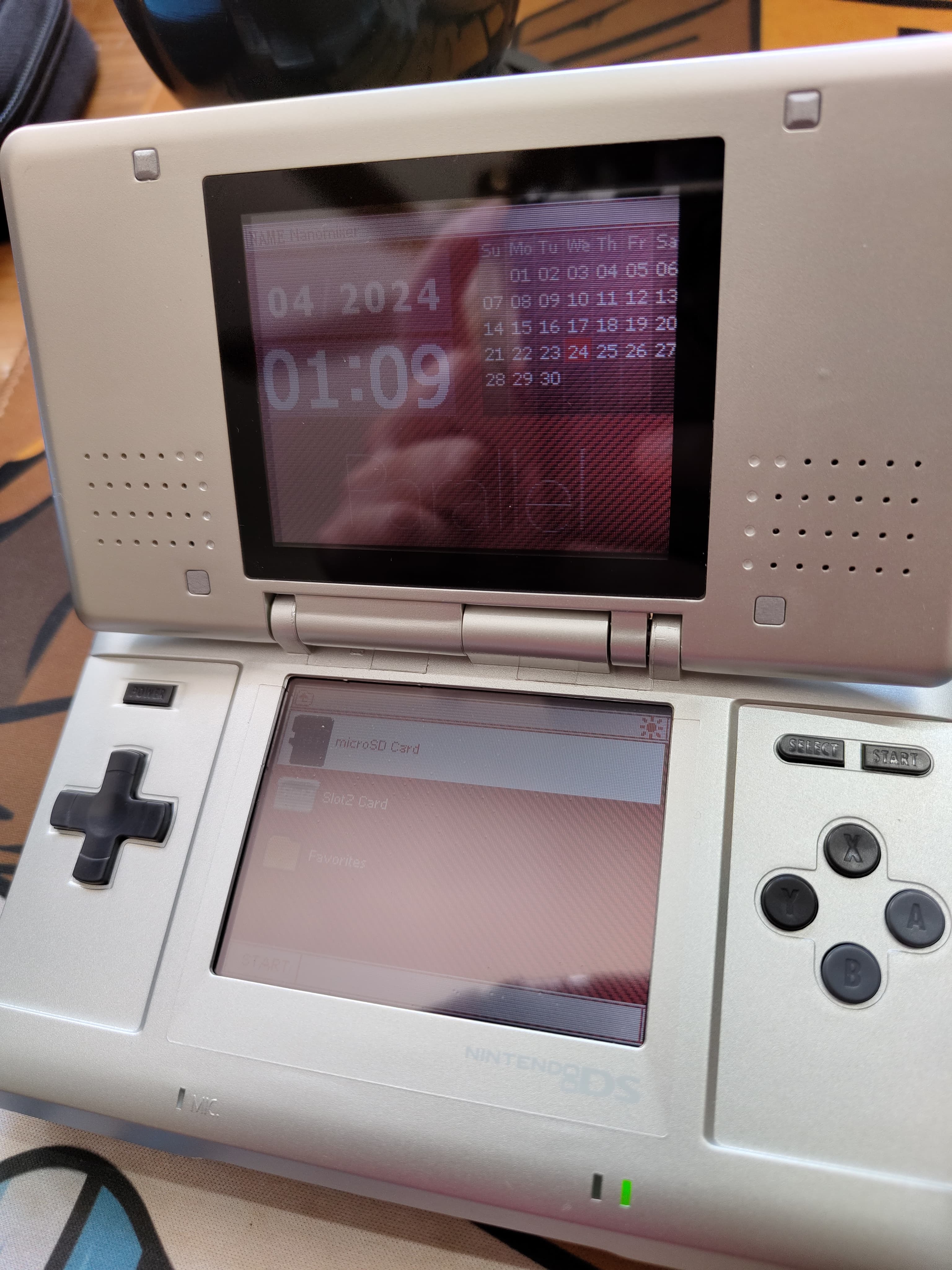

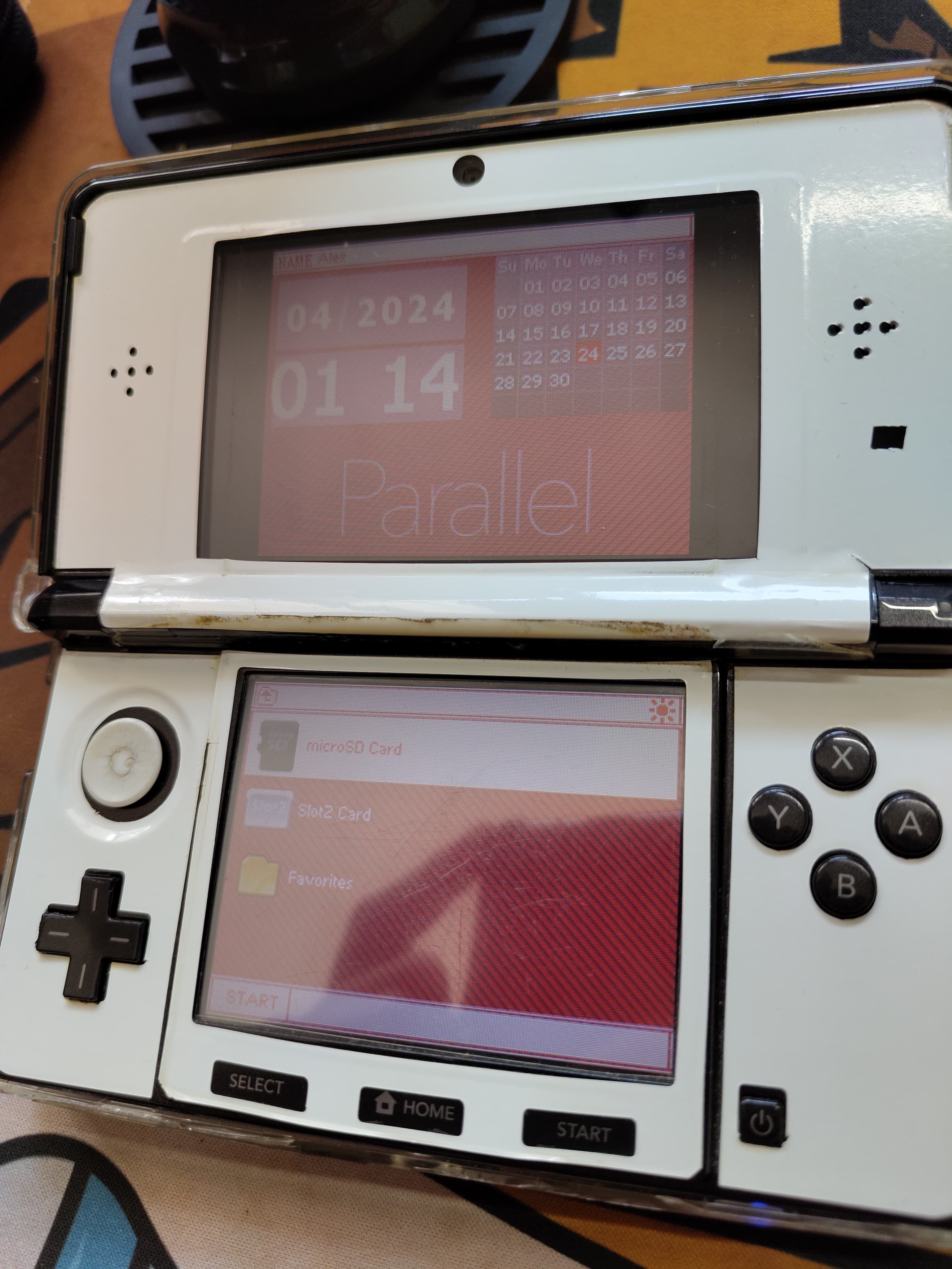

DS fat + DS Lite
(It doesn't have enough brightness, lol))
DSi stock firmware (v1.4.5)

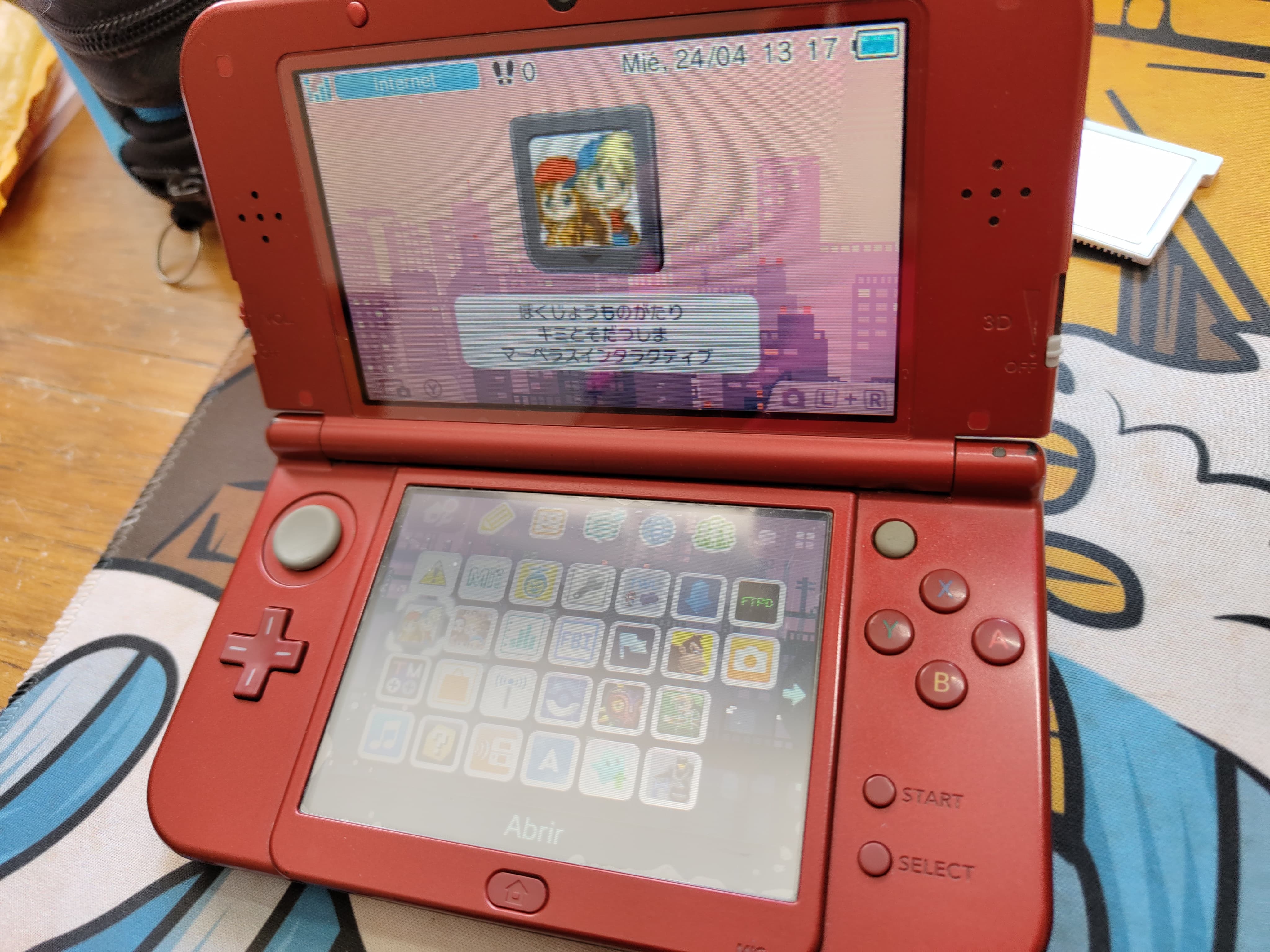

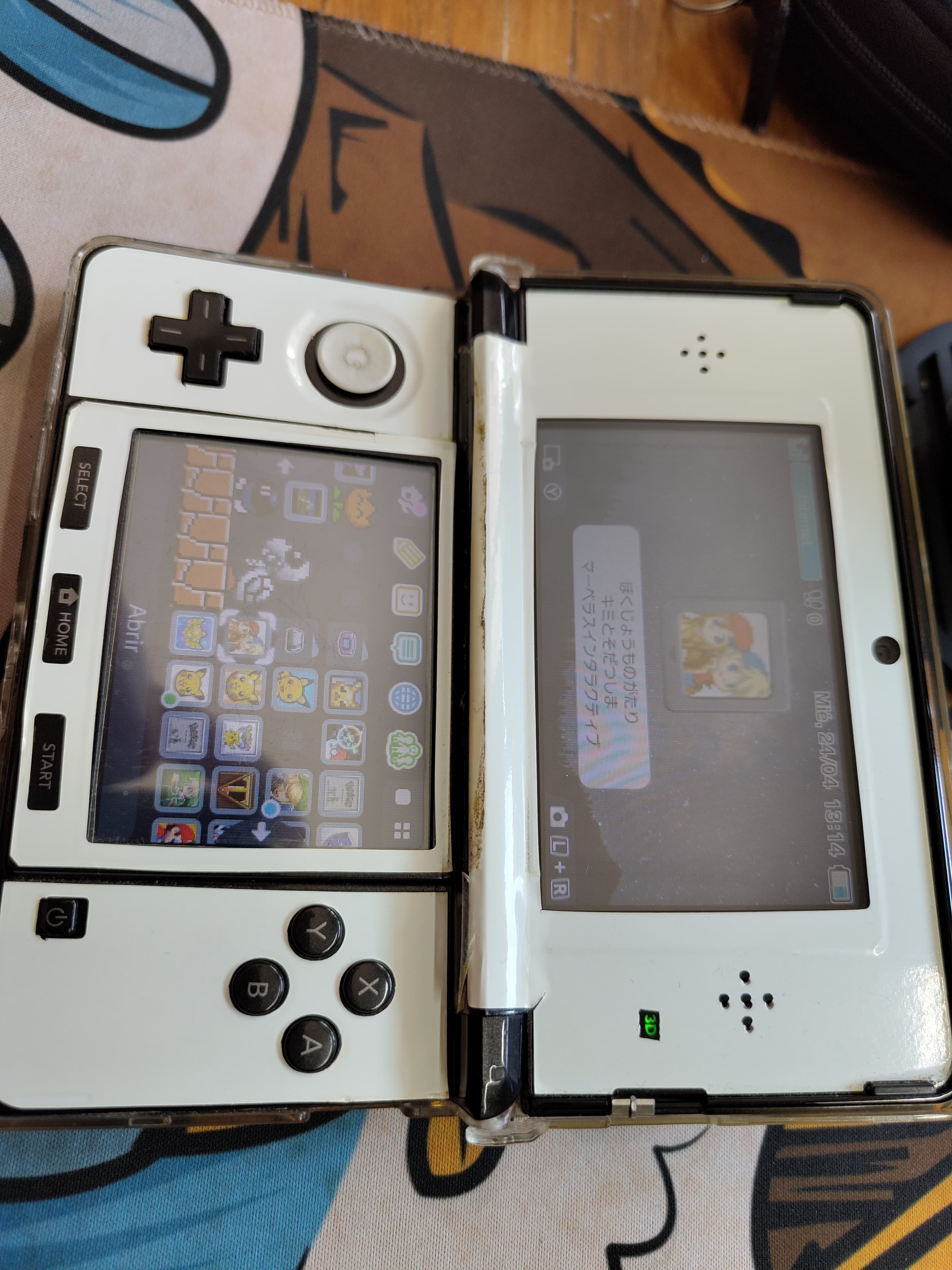

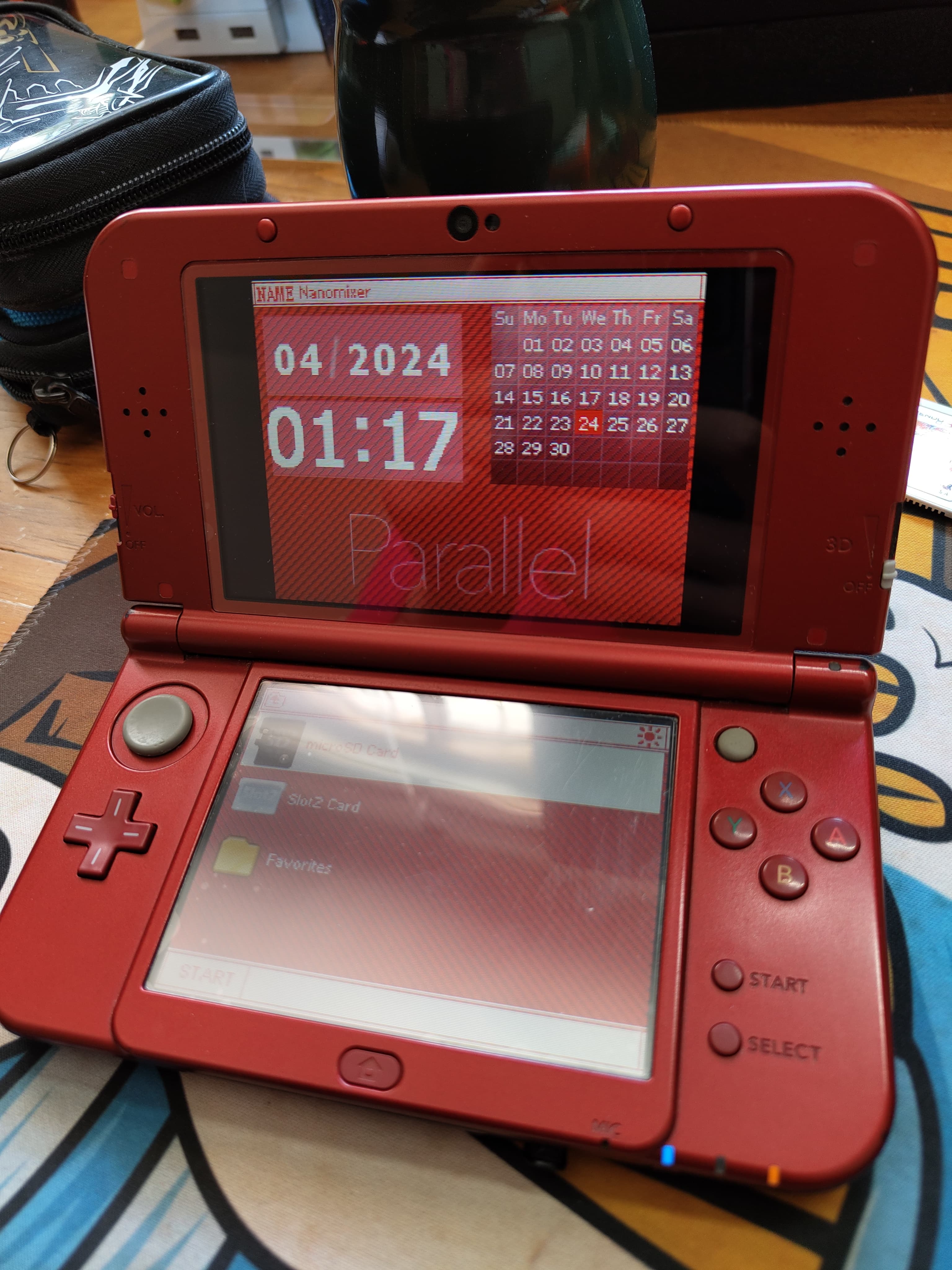

3DS + New 3DS XL with Luma CFW (v11.17.0)

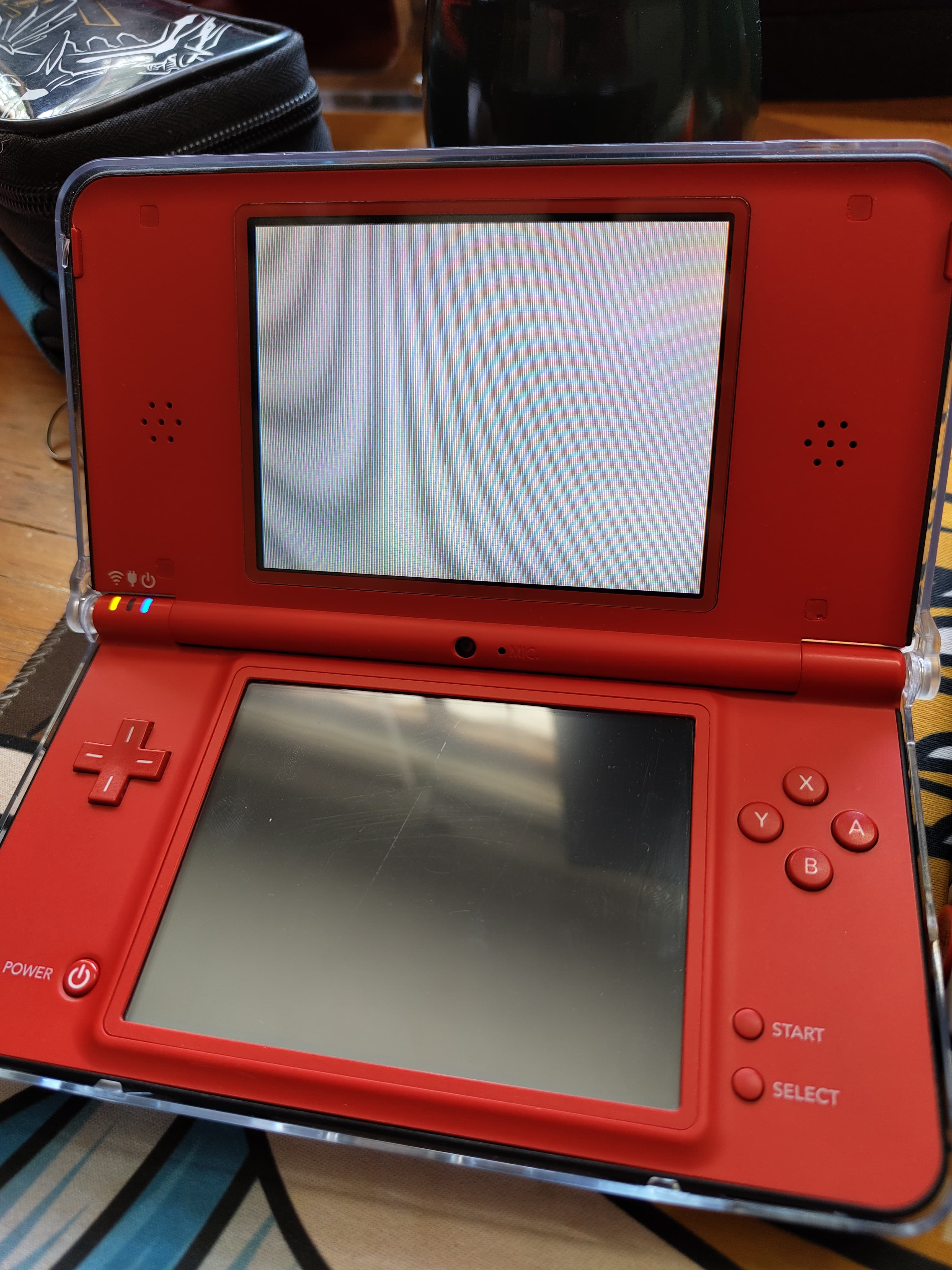

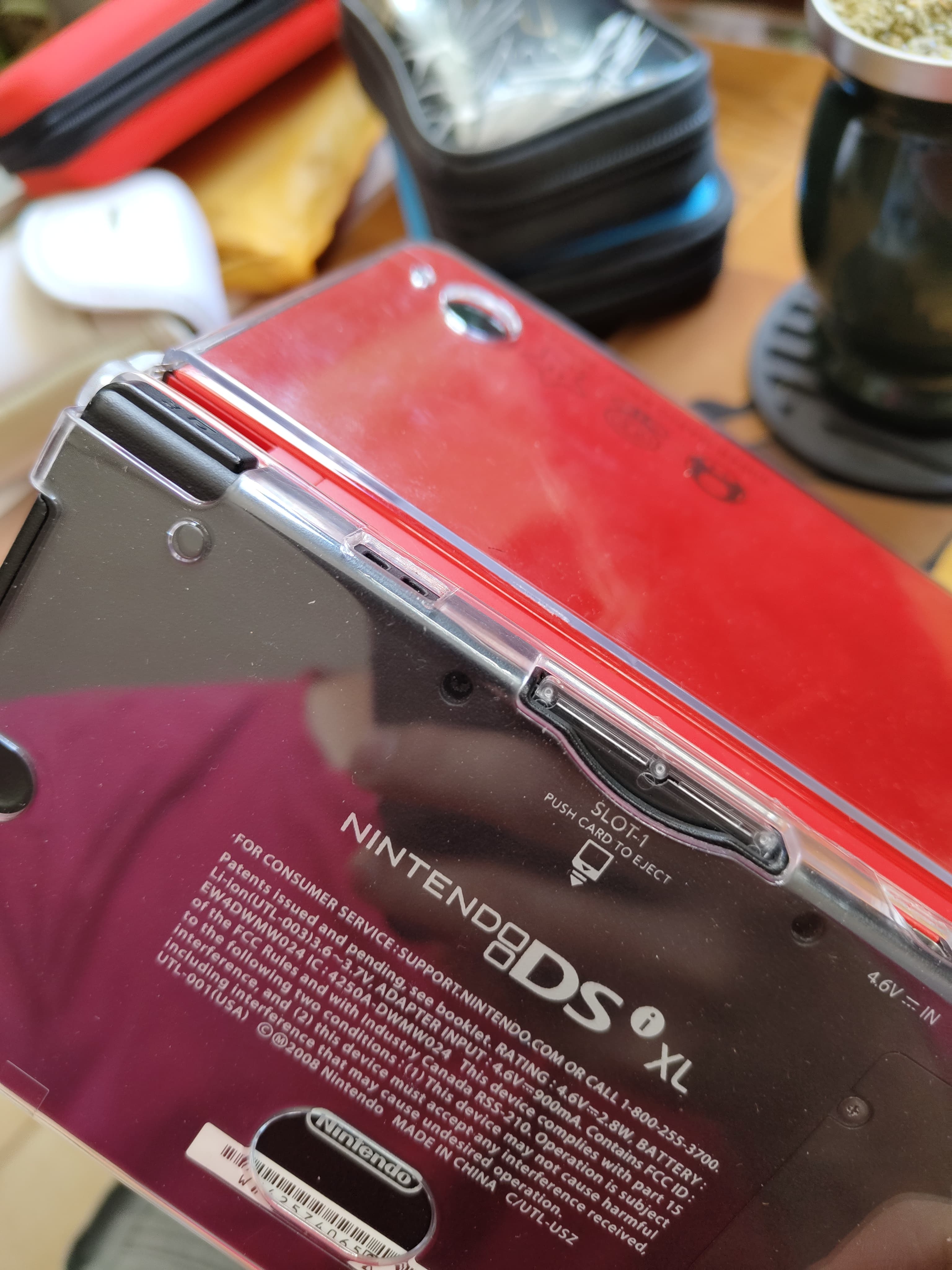

In YT there are several videos of people using it on DSi XL's but I can't figure out why doesn't works on mine. First I tried with stock firmware v11.17.0, it didn't work

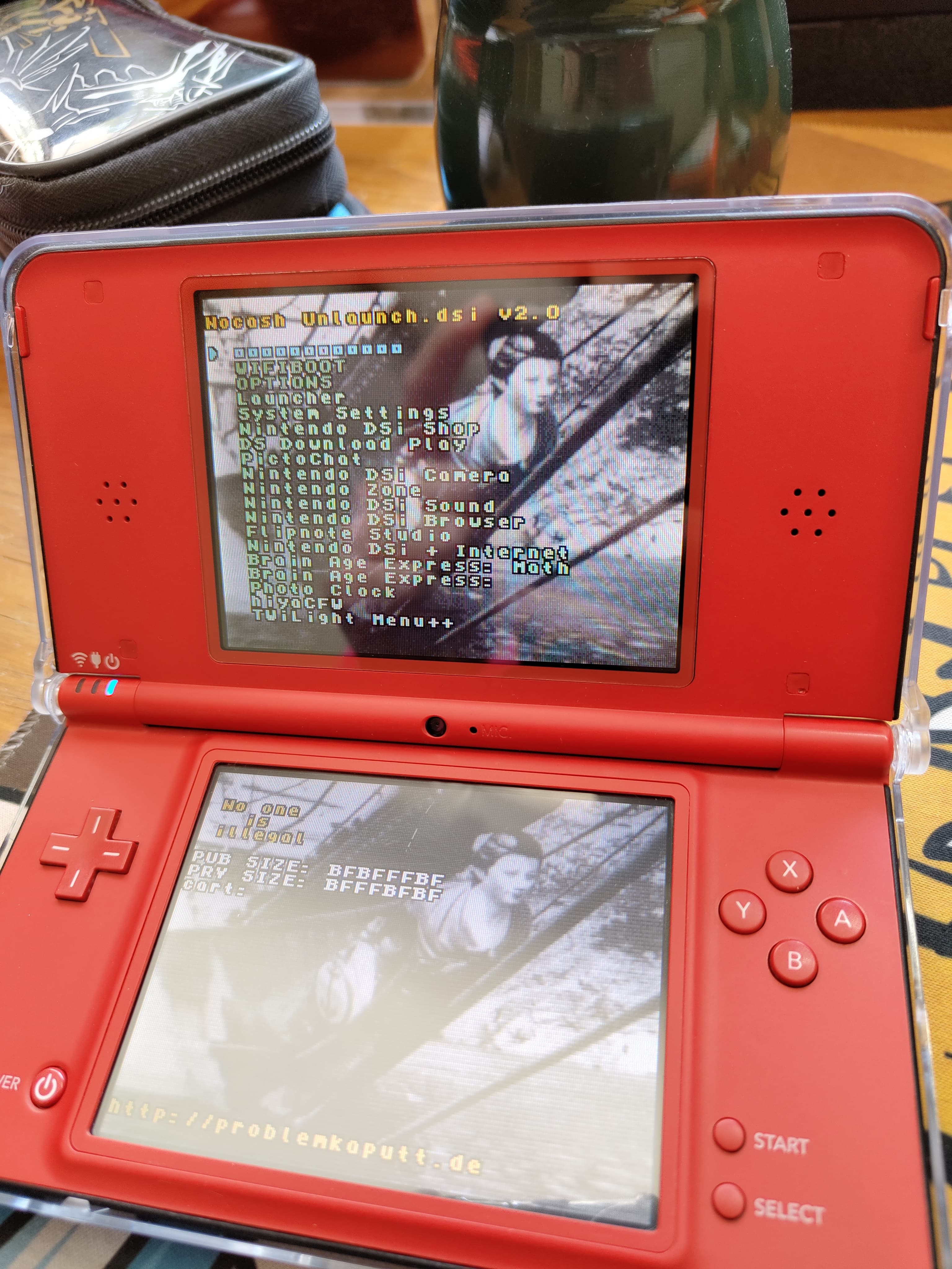

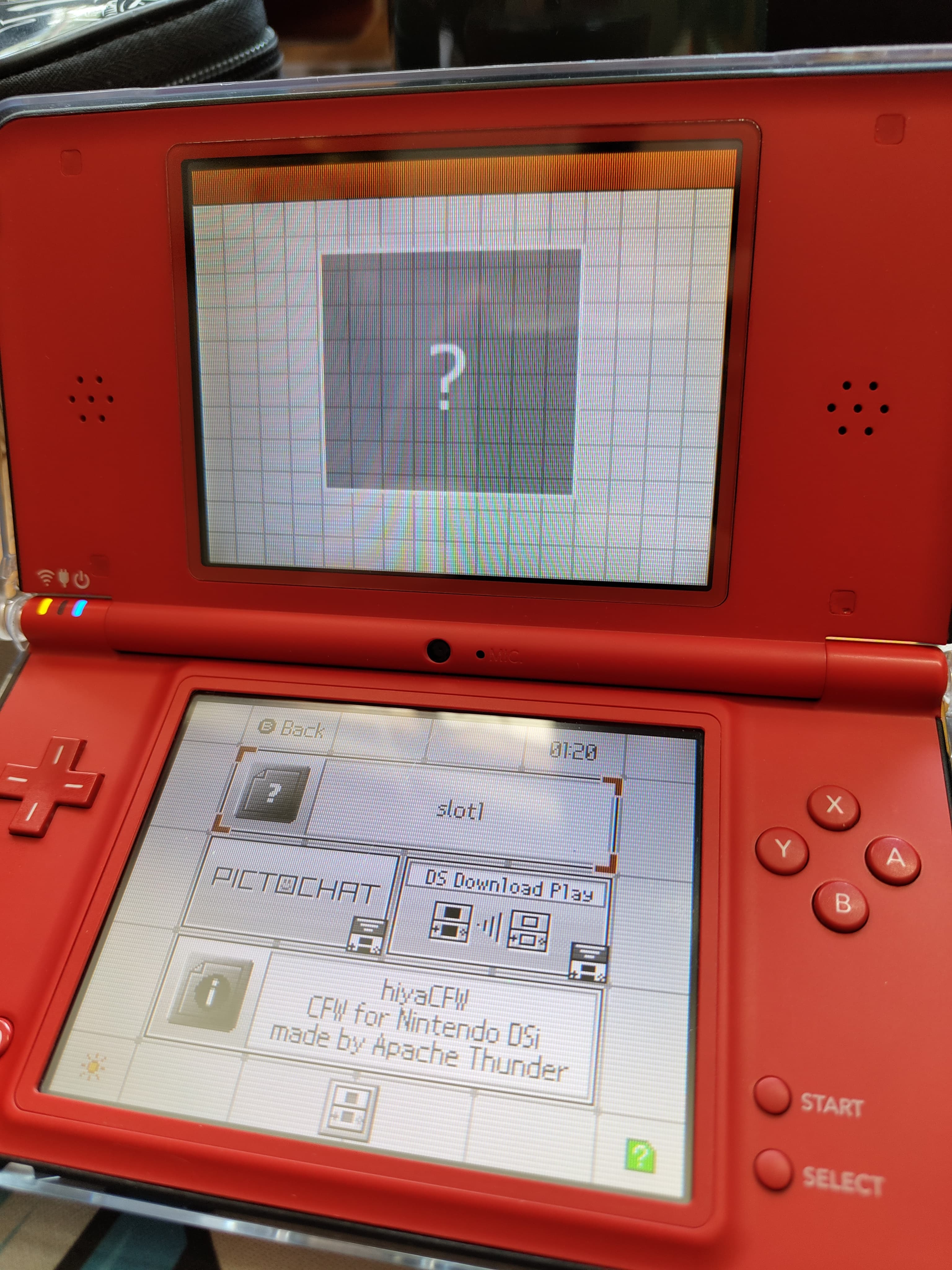

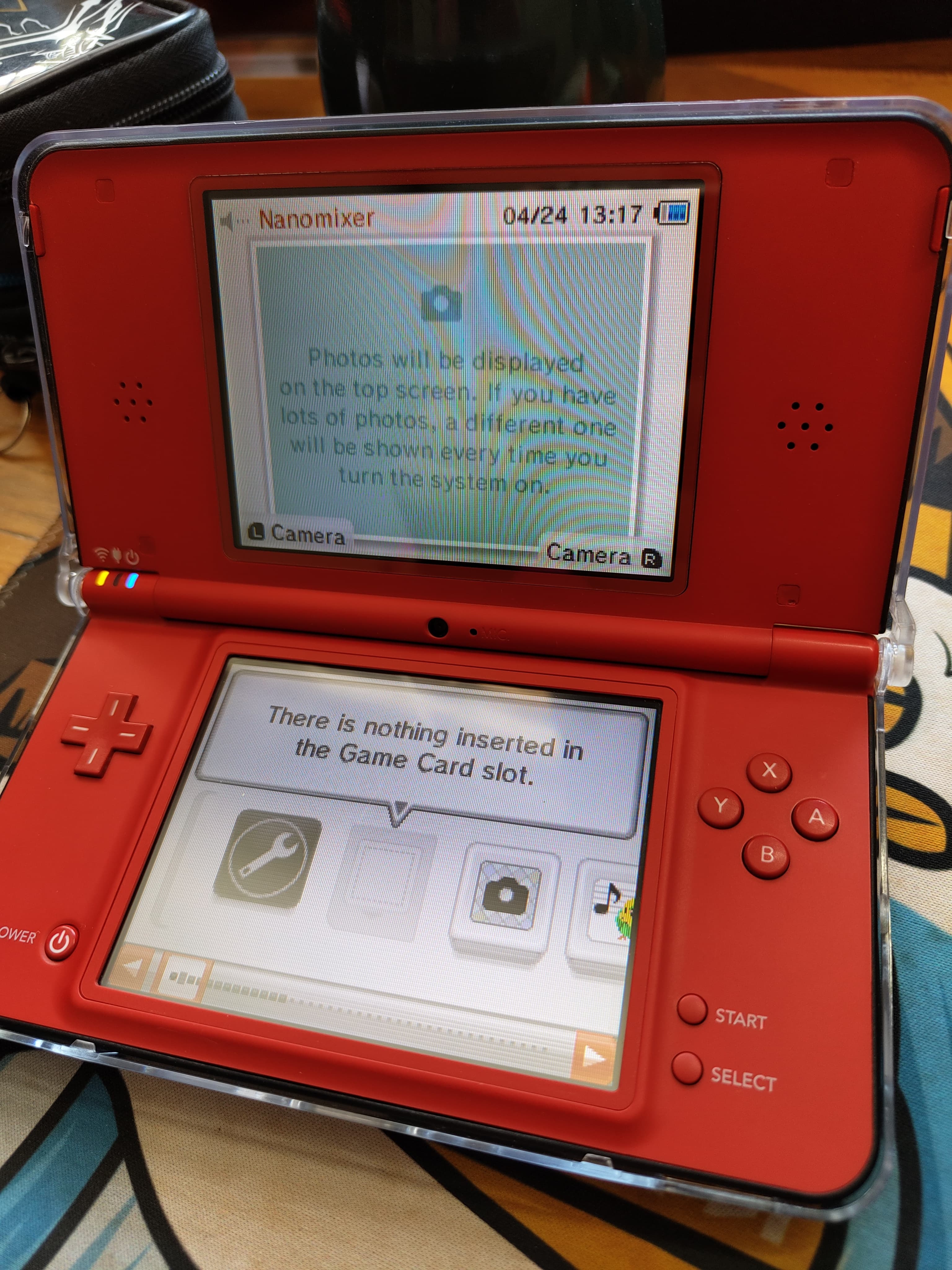

I was thinking that maybe my card slot was damaged, but it couldn't be because all my other games and falshcards work fine. So I decided to install Unlaunch and there I realized that my DSi XL is identifying the flashcard, but reading it properly.

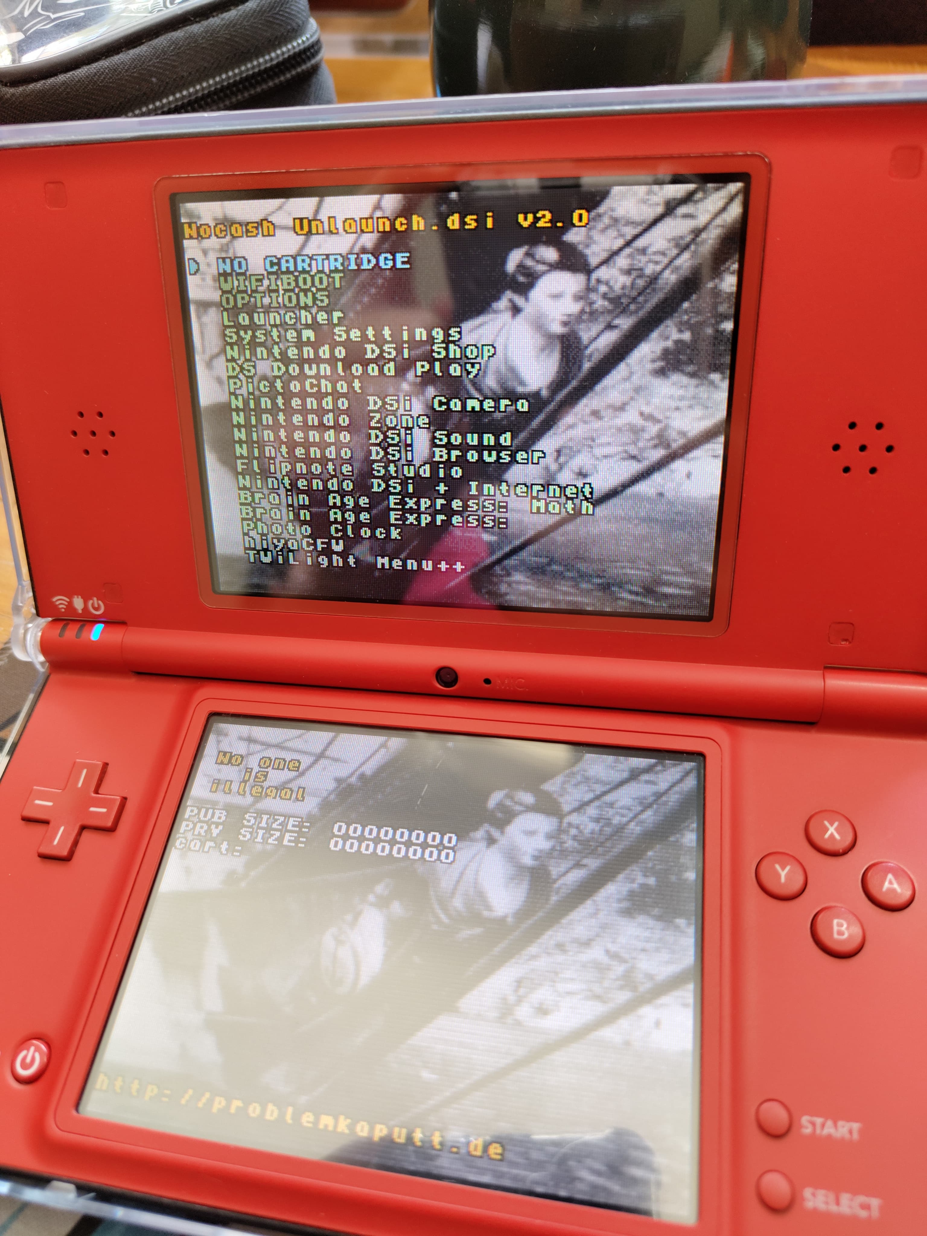

With no card ->
WIth card->
But despite is identifying the EZ Flash Parallel, it doesn't boot.
The I tried with TWiLightMenu++... and the same, it didn't work...
My last hope was installing HiyaCFW but, the same... it isn't recognized... (I know that this last image is the same as one above, but basically is the same haha)

It is likely a contact issue. I had this issue on my DSi XL as well. Insert the cart and then push it like you are going to eject it but hold it in the depressed position and see if the icon shows up. I expect that it will.
Although my cart is in a bricked state, the icon still shows in the menu.
Reactions: Theoretical Limi
Yeah, those squares in Unlaunch mean the cart isn't making proper contact. Likely need to shove a piece of paper between the shell and PCB for that console.
I think that's from the Japanese text. I have a Japanese DSi LL and some of the built in software shows up like that. The rest I agree with though.
