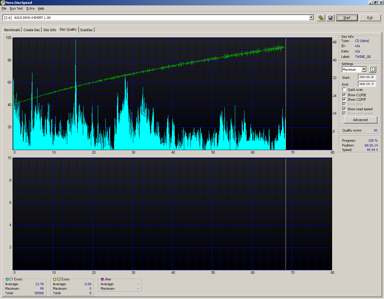

Use a drive capable of measuring C1/C2 errors and check your burned media. If you get a beautiful result like in the example in the spoiler, chances for the PS1 being satisfied increase dramatically. I believe this one was written with Plextor Premium. The PS1 consoles love this disc! Never got that near to a zero C1 error CD.
For comparison an original PS1 disc, which was heavily damaged and unreadable. After resurfacing (sandpaper with 3000, 5000, 7000, 10000 grain followed by car polish+wax) the bad scratches exceeding the limits of the error correction had been replaced with millions (literally!) of tiny scratches introducing widespread error distribution well within the capabilities of C1 level (aka fully meeting CD specification).
PC drives read such a damaged thing with full speed not even complaining the slightest (look at the green line representing speed – beautiful full speed CAV mode). The PS1 consoles on the other hand… weren't very amused by the mistreated game disc. Boots, looooong loading time. It wouldn't be surprising if it ended in DRE at some point. If your burning results look like this tortured disc (yes, this happens on bad writers/bad media), it is very likely that a console will stutter.
The quality of your writer absolutely matters as well. I just found out that a pretty new Lite-On DVD multi writer is considerably better at producing GameCube backups than all my other drives. Using the same type of blank DVD-R the backups load perfectly – while they don't when written with other burners. A measurement of Pi errors/failures revealed a much better quality as well.
All in all optical disc burning for consoles is a bit of a lottery and involves trial and error. I had not much luck with laptop/slim drives. They generally perform very poor compared to a proper drive.

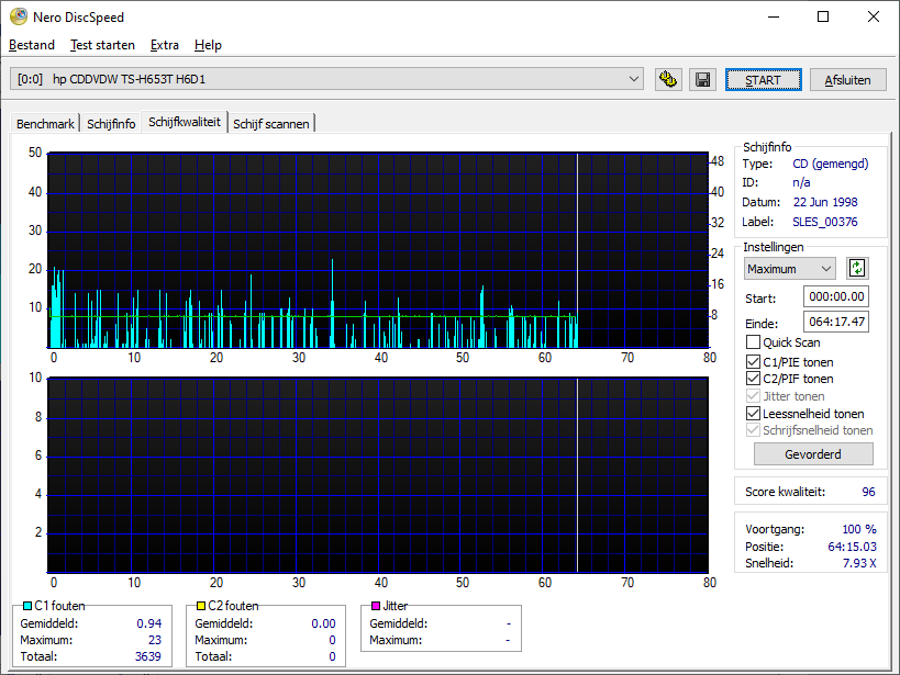

I want to check the quality of the 10+ years old copy compared to the new ones from the HP and TSSTcorp burners.
In your screenshot it's a ASUS drive, are they all capable of reporting c1/c2 errors? I have a ASUS drive in the storage, although it's already from the S-ATA era.
Are Plextor writers from the S-ATA era not good anymore? These are still sold second hand.
How should I know this? This is a fairly new SATA drive, already capable of overspeed DVD writing (using that function makes a scary sound). Some drives offer the option, some don't. Pi errors/failures scan for DVD is less common than the C1/C2 for CDs.
Old "real" Plextor can also do it, but not with the Nero application. This can be done with Plextools or the open source QPxTool.
I don't even know if the brand exists anymore. Got a new drive labeled with Plextor last year. Seems to be a re-brand from a Lite-On model. Fun features like GigaRec or VariRec are gone. Neither the very old PlexTools nor a slightly newer PlexUtilities can do anything fancy with it. Didn't find anything for doing interesting stuff.
It turns out my ASUS drive doesn't work with it... is starts the scan but doesn't nothing in reality. But the HP drive which I used to burn one of the copies does

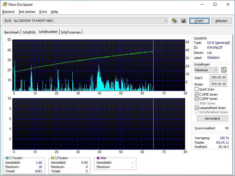

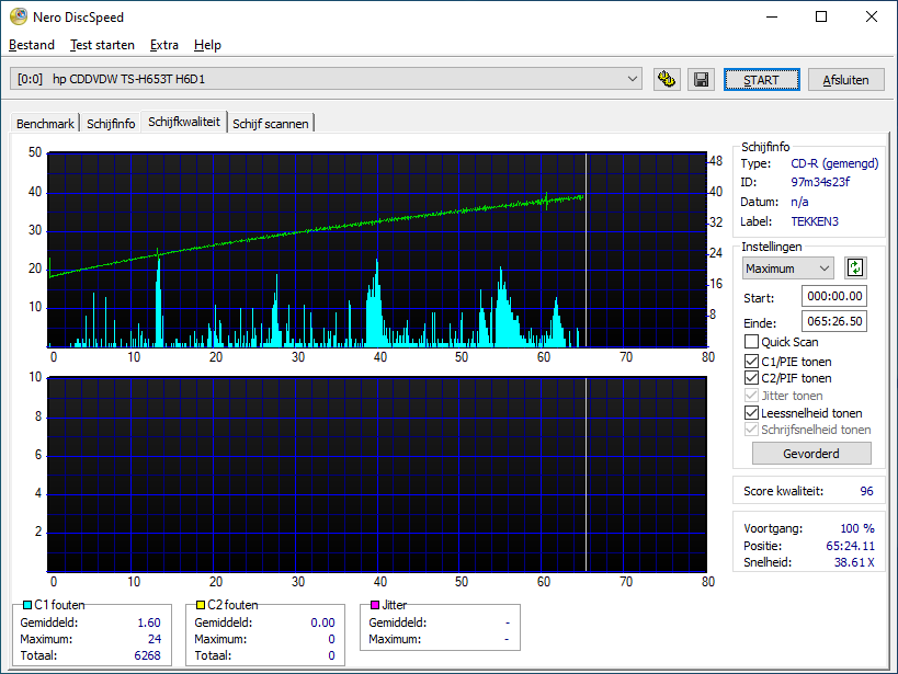

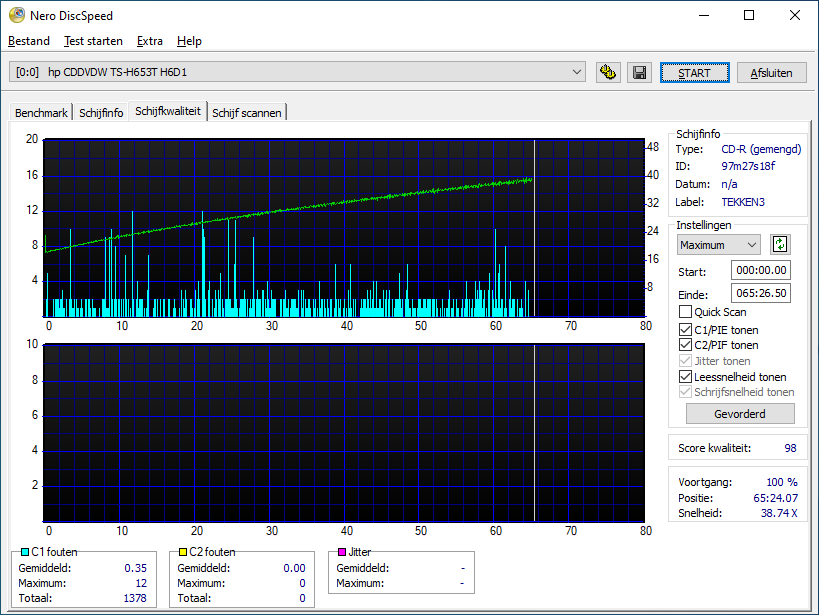

It looks like the 10+ years old copy has the less amount of C1 errors Maybe that's why only this old copy doesn't stutter:
This is the one burned with the HP burner at 16x speed:
And this one was burned using the TSSTcorp drive at 8x (which seemed be a old TS-652 P-ATA from sept-2006):
So they both have more then 6000 C1 errors, only the old copy has less then 2000
Is the problem the modern media or the burners? Not the whole disc is "bad", maybe that's also why only some background track stutter but not all?
All three they are not nearly as good as your Plextor-burned disc, but are better then the scratched original one.
Edit: I tested a original PS1 TOCA Racer disc too, it has errors as well, light scratched. Plays fine on the PS1 althrough some audio skips. The PC only reads it in 8x CLV, it seem like the HP drive cannot read those black originals faster:
