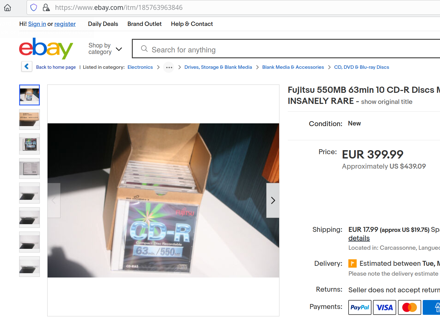

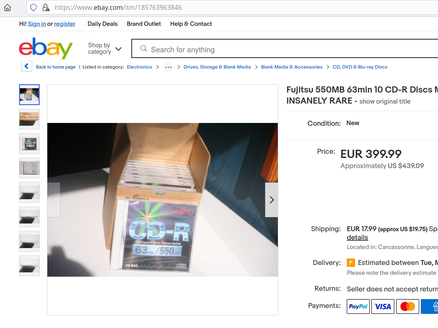

Are 650MB really much better? On a secondnhand market place online someone sells Emtec 650MB CD-R's 100pcs. I don't know what they cost yet. Is the chance not big that they have "disc rot" after all those years? I can't see/test them before buying.
The desktop drives from 2011 and newer can only burn 16x CLV at lowest. The slimline drive in a Dell Optiplex SFF can do 10x, I think they are the same like the external ones. Somehow I think technically the drives can do lower speeds because they can still burn 4x only CD-RW discs, it's just not selectable with CD-R.

I agree that the old stock is probably not worth it since it is so expensive. Old stock sealed in individual jewel cases should be ok from sunlight and the elements though, at least in my expierence. A spindle in a clear case probably won't fair as well since it is much more exposed to the elements. The DataLifePlus discs are supposed to last for many years longer then standard media, that is actually what the DataLifePlus part means. It just so happens that they are also much more reflective which helps the PSX laser itself in tracking.

Goes off-topic, but I'll put it here. Hopefully interesting enough. It is not that easy. With all readily available CD-Rs, a burner will write pits/lands at a defined size (I'll omit Plextor GigaRec, Sanyo HD-Burn and Yamaha Audio Master at this point)
Sadly I'm missing a source for one of the following claims. I have read it somewhere… at least I think so… and it is plausible deduction from what I can link below. But if it is wrong anybody correct me (or the contrary: If anybody has another source to confirm, please do so.)
The difference between 700MB/80min and 650MB/74min blanks is the track pitch. By using all tolerances to the maximum, a tighter spiral groove can be used… while any working CD drive must still be able to follow the track. For whatever reason, ATIP allows for a capacity of 79min, 59sec and 74 frames(sectors) at maximum, totaling in 359999 sectors (which is about 703MB in Mode 1 with 2048 bytes per sector).
Anything beyond that should not be stored in ATIP data (which is why almost all 90min/100min CD-R report themselves as 80min requiring overburn for using the extra capacity). 90min/100min definitely exceed the tolerances by further decreasing track pitch and no drive is guaranteed or obliged to read/write such CDs (Pressing plants do offer audio CDs with up to 90min as well, but they will demand you to sign, that you take all responsibility if your customers encounter problems).
Now to the part where I'm not sure (can't provide source): Your statement above is – to my knowledge – not really wrong (though also not correct for the transition 650MB/74min→700MB/80min). I think there have been blanks that will make any CD burner write longer pits/lands. A consumer writer is far to imprecise to keep rotational speed at defined accuracy on it's own and needs to sync itself with… surprise… ATIP. Absolute time in pregroove. The minuscule pregroove wobble (amplitude of 0.03µm compared to the pit width of 0.6µm) shall be detected as 22050Hz frequency running at 1x speed. Producing a pregroove with slightly longer spacial period will force the drive into slightly higher rotational speed.
For simplicity assume a very old writer supporting 1x speed. With such a special CD-R, the linear velocity is 1.4m/s instead of 1.2m/s. Each pit/land is slightly stretched compared to normal.
Now do a bit of math:
1.2/1.4≈0.857
0.857*74min≈63.5min
550MB/63min CD-R existed at some point, but they are almost impossible to get: (No, I'll not buy this! This price is insane!!) https://www.ebay.com/itm/185763963846
The scanning velocity during recording shall be between 1,20 m/s and 1,40 m/s with a Channel bit rate of
4,321 8 Mbit/s (see clause 20). The velocity variation for a disk when recorded shall be within ± 0,01 m/s.
In practice almost all CD-ROM and CD-R(W) use the 1.2m/s linear velocity to maximize available memory. I do have some pressed CDs deviating from that though. Interesting side note here: The last sentence with the very small allowed deviation across the whole disc is equal to the statement: "A SecuROM New ≥v4.8 disc is NOT a CD-ROM!"

I would love to know how the PS1 reacts to the insanely expensive and rare 63min/550MB CD-R

That is as near I can come to having/buying those insanely expensive CD-R.
If anybody is willing to do such (doubt anybody would pay so much for a bunch of old CD-R), the chances for it to work are good. Larger pit size is no problem for the PS1. The copy loads beautifully on my SCPH-1002 with still not refurbished drive. Intro video plays without stuttering.
Agreed: Those rare blanks would probably work great.
