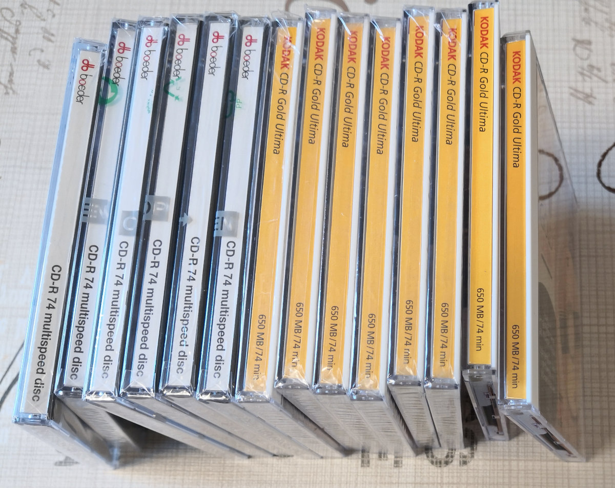

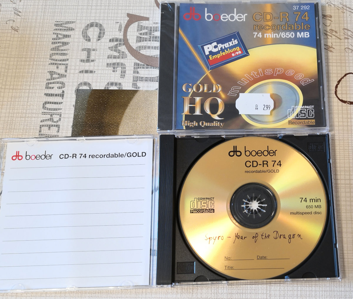

Don't have any old Verbatim 650MB, but the best results I ever got for a PS1 backup disc is this:
Short loading times (for PS1 standards of course), no noise from drives, no stuttering, no problems, nothing

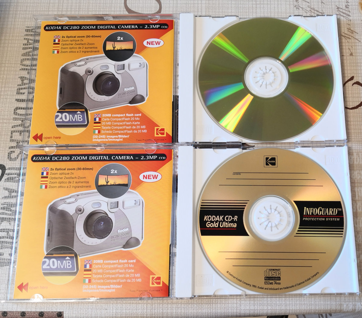

Almost equally good performed Kodak Gold Ultima:
Sadly this won't do much for anybody (including myself) as these are hard to find and outrageously expensive on eBay and the like. That is all I got:
Could not visit flea market for many weeks now due to hard work and weather. Maybe next Saturday. Always have the eyes open for some old discs and drives. Most people are happy to get rid of theirs.
Flea markets and thrift stores are your best bet. The few offers online are beyond good and evil.

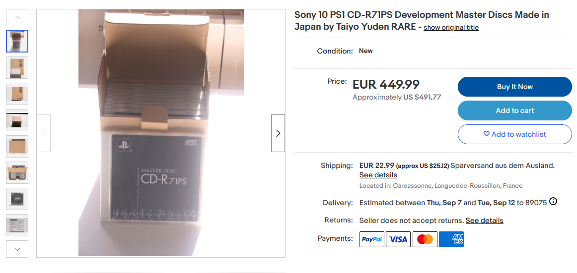

Anybody won the lottery?
I've never even heard of 71min CD-R even existing before. But…
The same seller on eBay, which I linked before in this thread (including screenshot for preservation) actually has PS1 Master Disc CD-R with PlayStation logo. And those have a number 71 printed on (which could be minutes).
Well, if those aren't the the perfect blanks for PS1 backups → :creep:
https://www.ebay.com/itm/185774937302
It is very tempting. But waaaaay tooooo expensive.
I searched for more out of curiosity. There are some of these from other sellers available in the US, but usually individually for around $70-80 (and up) USD for a single disc. Wild.
Imagine you burn a coaster with it because the PC/burner crashes... that will be very expensive :lol:
I can't imagine the dye was rated for 3 decades either. Also this does confirm that Taiyo Yuden was what Sony used for the official CD-Rs (so the great grandchild of this thing are the CMC Pro discs. Now we have some great pics to add to the guide though).
