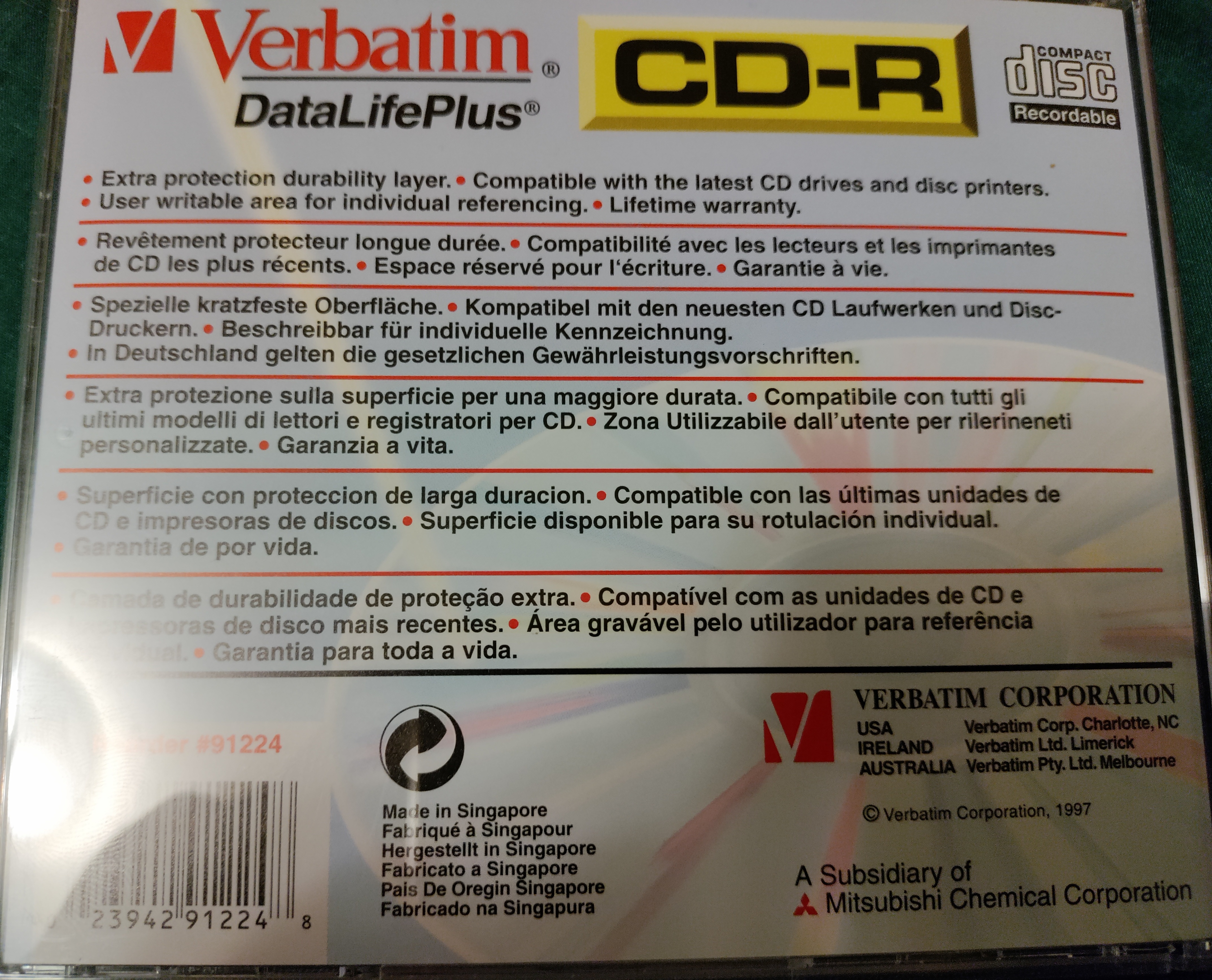

Don't underestimate your local thrift stores. I often stumble upon things like these for $0.50 (sometimes less) per disc.
I think those are the holly grail of PSX CD-Rs. Any with the copyright date of 1997 or 1999 like you have 1997 there. They have the real super AZO dye that is dark on the side that is burned to. What a steal
Those sure are amazing CD-Rs for burning PSX games. Can you show me pictures of the disc (hub, ring codes)?

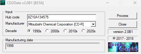

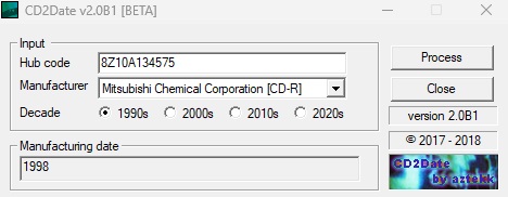

Wdym? Could you elaborate on that?
On the back of the jewel case it says that :rofl2: I actually believe it too having used such new old stock discs just last year. The date code lines up there are never any 1998 copyright discs that pop up on ebay just 1997 or 1999 in that style
A bit mysterious if it claims to be manufactured from 98 but not 97. Possibly a late batch? Interesting stuff regardless.
I think the label just wasn't updated until 1999 so from 1997-1998 the label is the exact same. I think the 1999 ones say '8x speed' and are a bit different but look very similar overall the design is basically the exact same on the 1999 labels.
