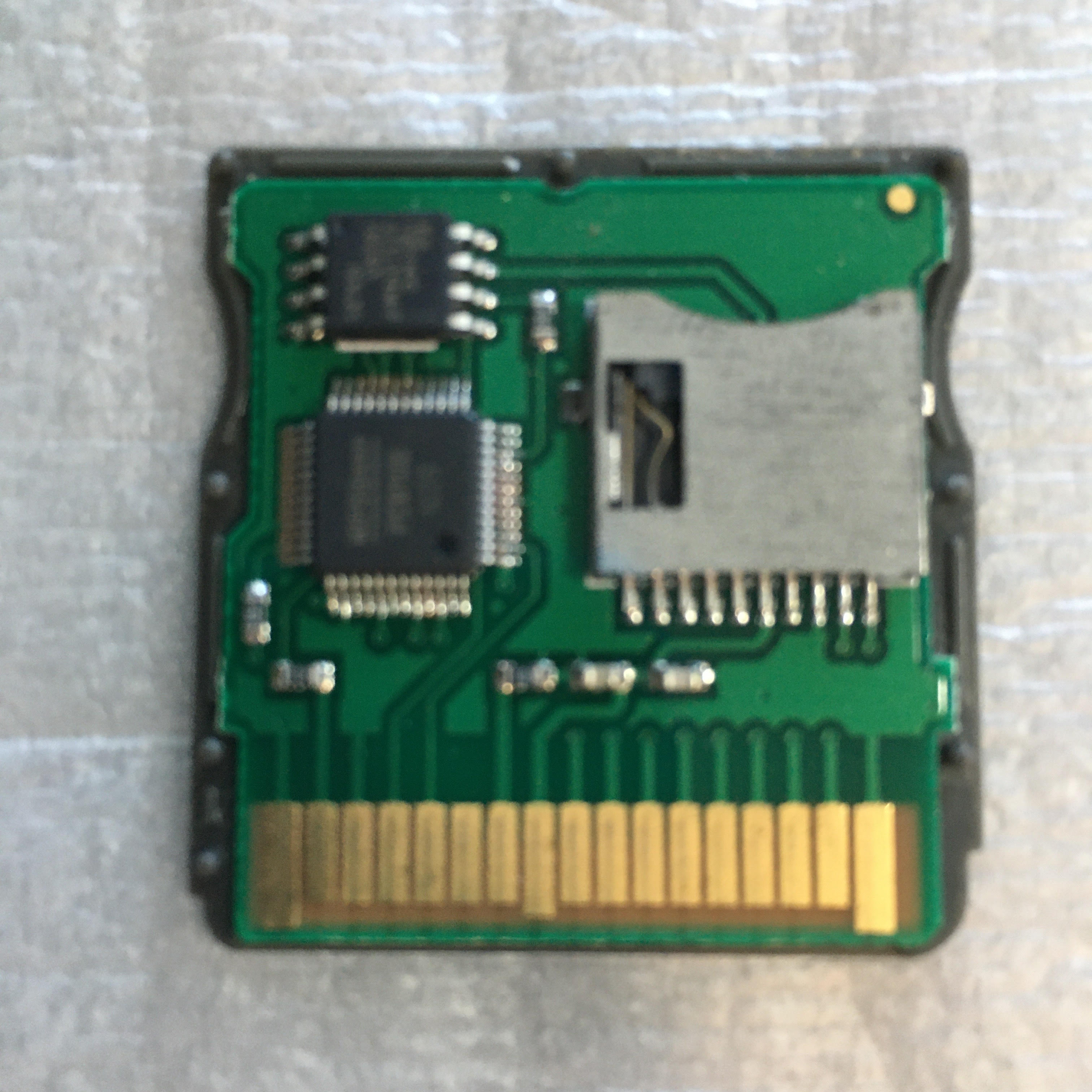

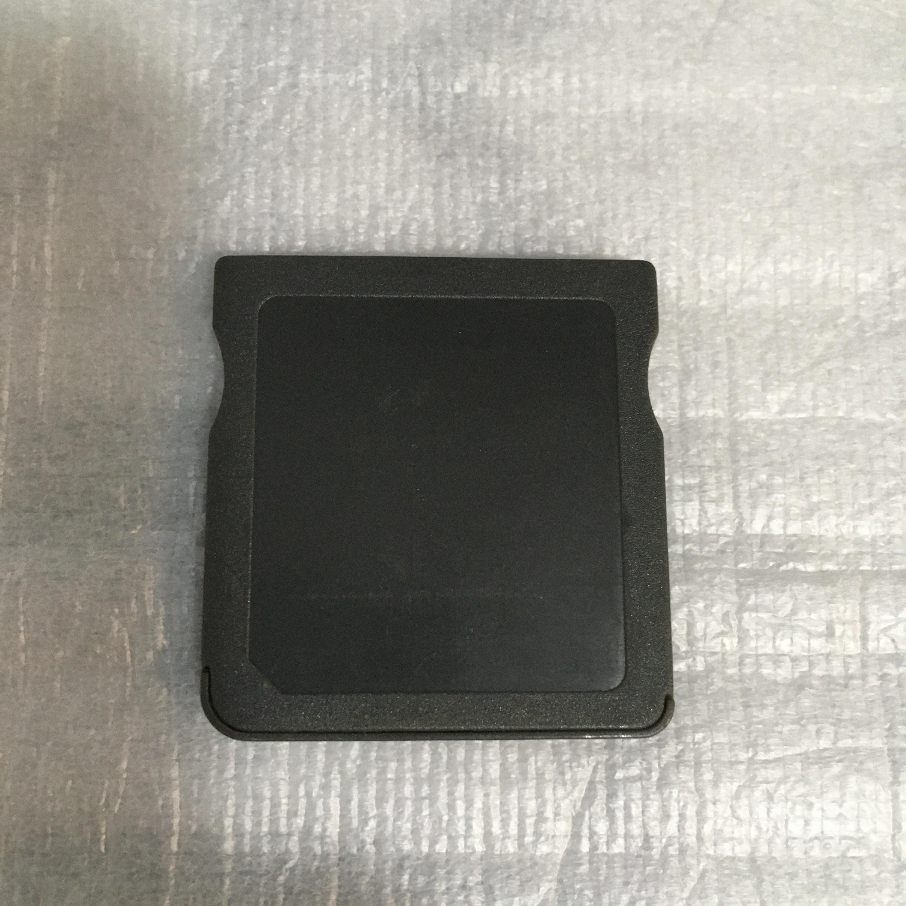

I bought a 3DS and it came with a R4 that the former owner allegedly used to play DS games. But it’s not working for me (stuck in the “Loading…” black screen). I’m trying to find the kernel on the web and install it again, but it's hard to identify because the R4 has no sticker or package and the former owner has no idea which model is this R4
So I wonder if I could find out the model of the R4 provided the information below:
  • The pitcures I took from the R4 are below: it has a green chip with nothing written in it. On the back, it has a small golden sticker written "2012 08-12", whatever it means
  • Both my DS Lite and 3DS recognize the R4 as a SpongeBob game when I turn them on
  • It came with a 16B micro SD card. Stored in the card was a _DS_MENU.dat file with 380 KB and date 14/08/2018. Strangely, there was no _system_ or __rpg folder in the card. I don’t know if is there a kernel that works with the .dat only… or if was the folder accidentally deleted

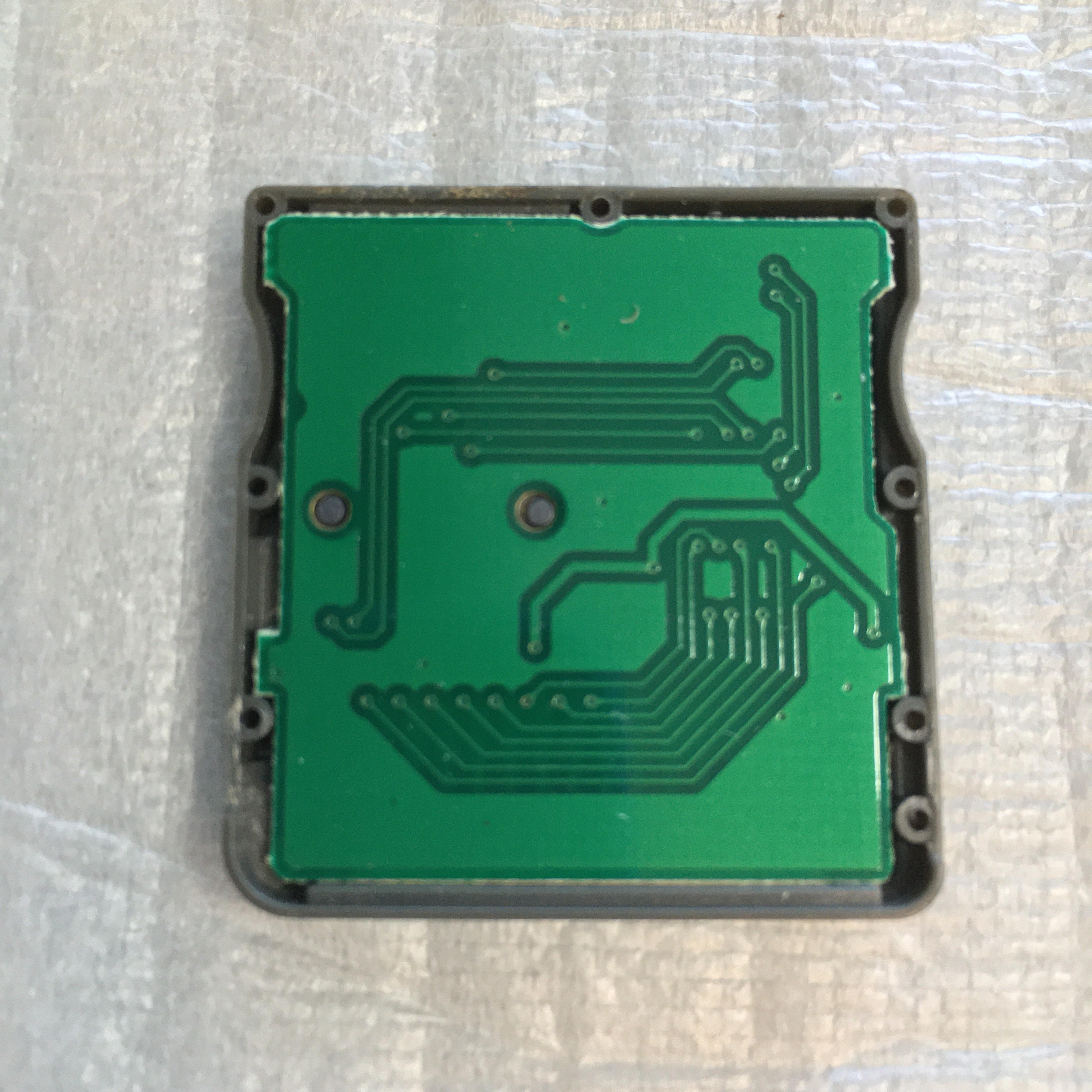

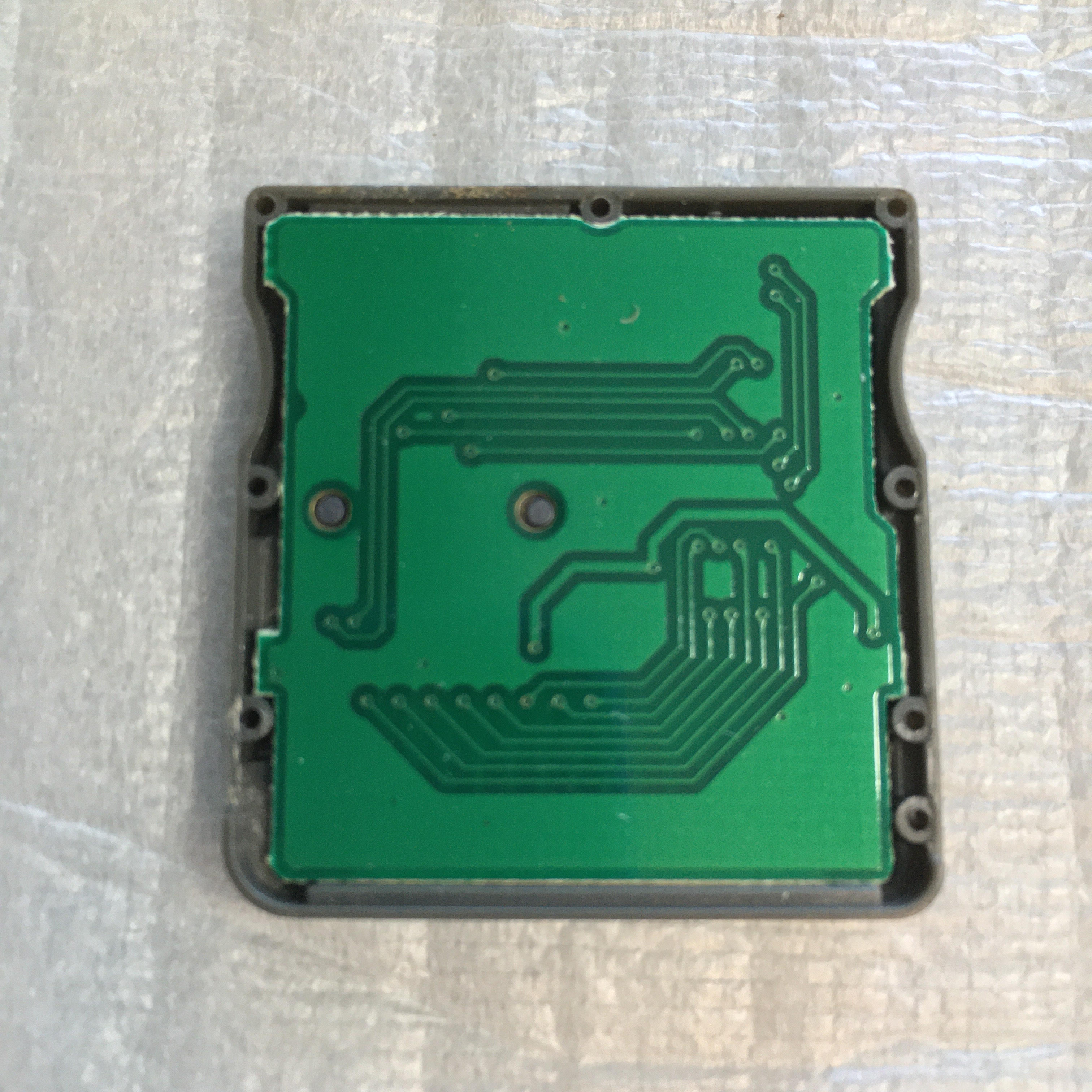

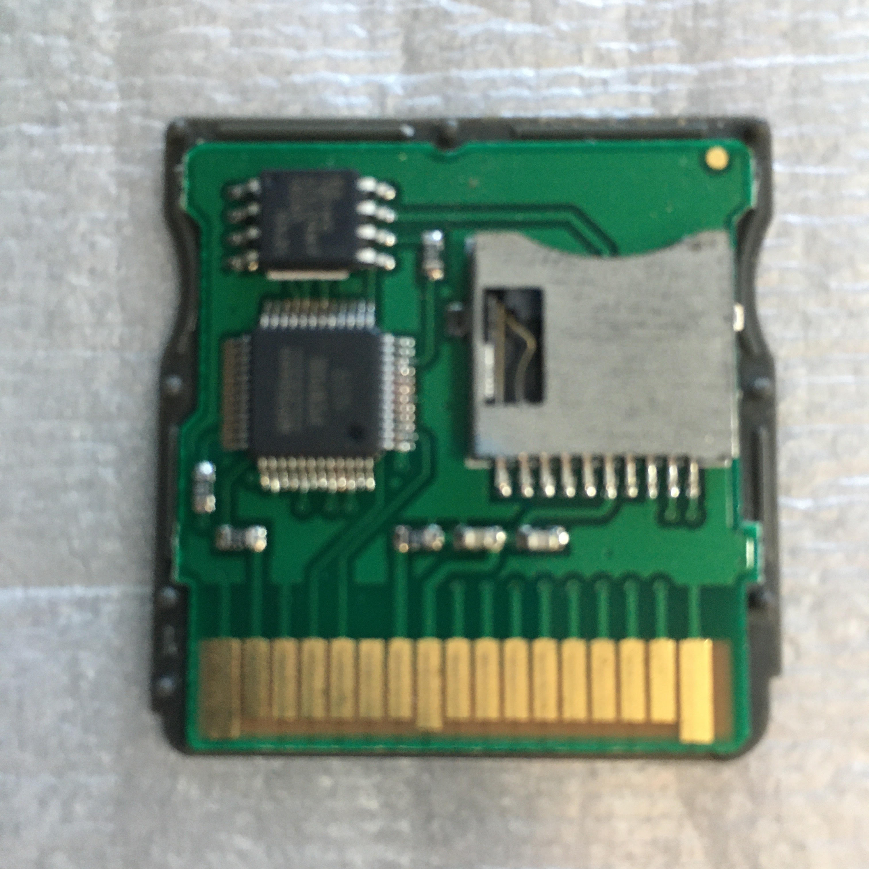

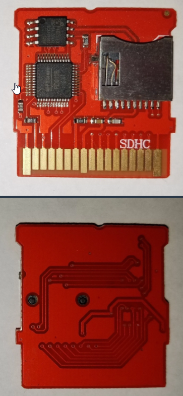

As requested, I took pictures of the pcb inside the cart. For some reason, my camera couldn't focus, but the larger chip says something like "MIPSGreen"

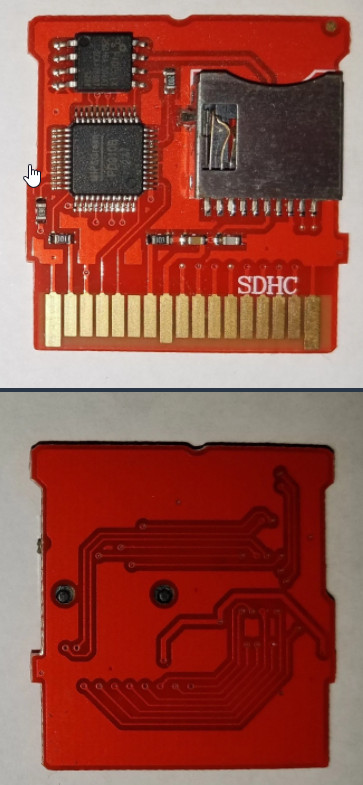

It seems to be a 1:1 to this one here, but the difference being it is in red. Even the lines on the reverse side match up.
The red one above is a clone of the R4 SDHC series from 2013/14/15.
I have a feeling that yours may be a clone of an earlier model?
EDIT: I think yours is a clone of this red one, reading your post properly shows that it is indeed an SDHC card.
Do you know which kernel works with this red model?
This does: https://flashcard-archive.ds-homebrew.com/BL2CK/BL2CK_1.30.3.7z
And if what we found out here is true, then never run YSMenu on this. It will die a painful permanent death.

Thanks a lot! This kernel worked (at least it went past the loading / white screen)
