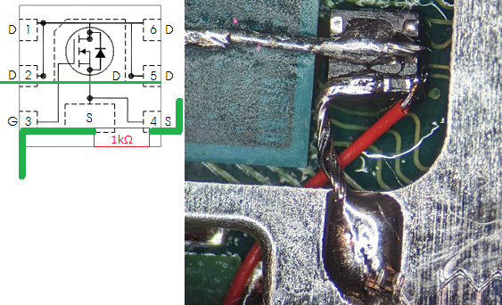

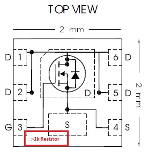

I would like to ask you about the soldering of the latest mosfet that you published before.
I understood it as shown in the diagram on the left, is that correct?
Edited:
The diagram is wrong (because it's the upside down of the picture). The picture is Correct.
You need the >1k resistor between Gate and Source (GND) so in case the Gate does not close correctly the resistor will draw the power and close it.

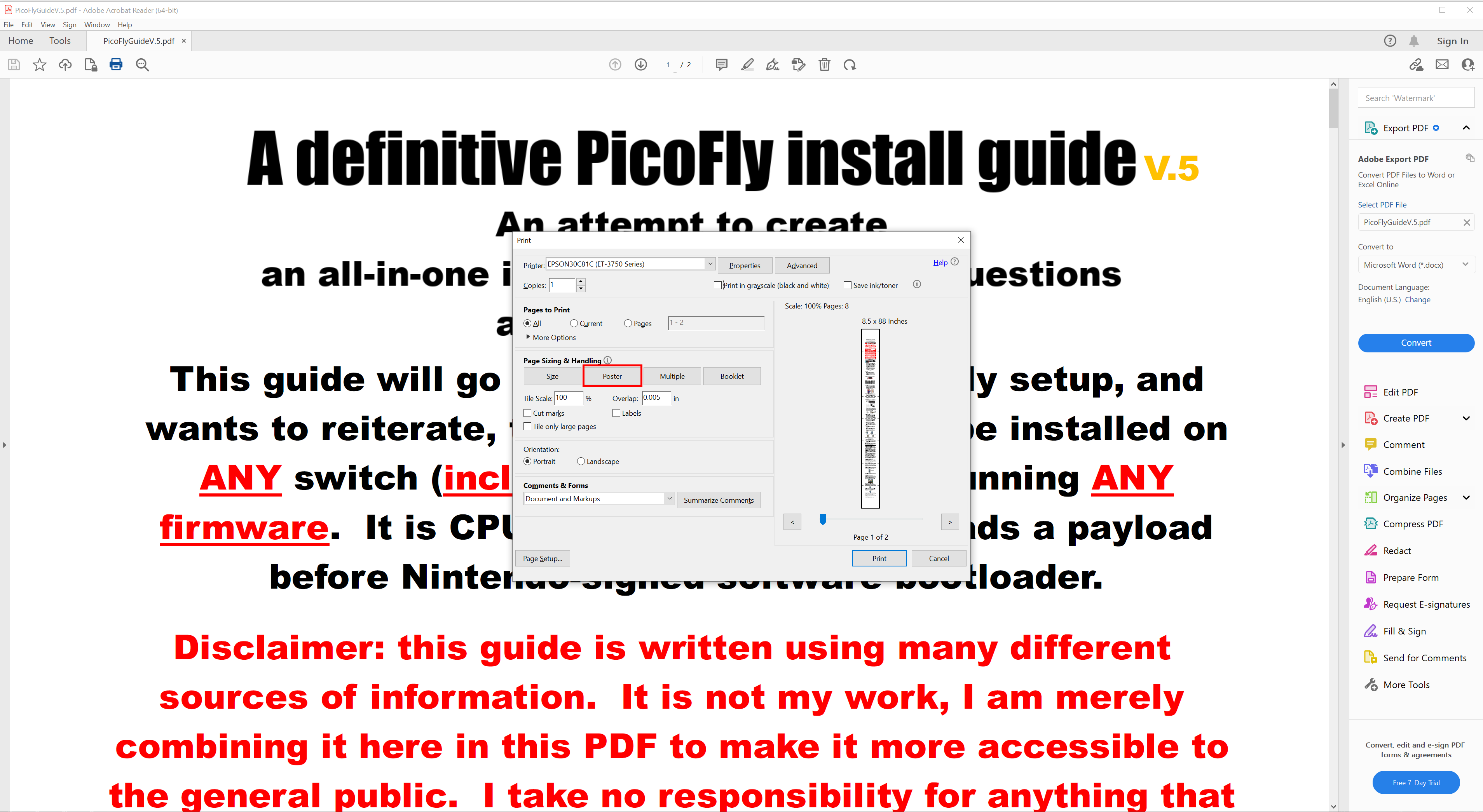

can you explain. What does this mean?
