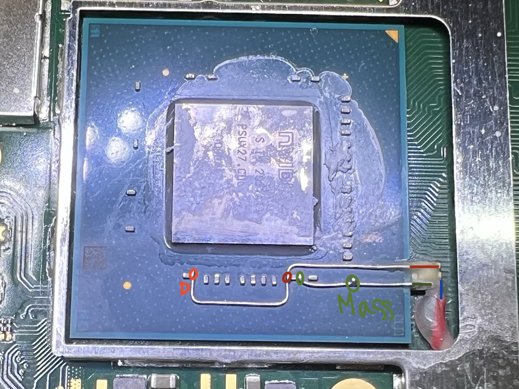

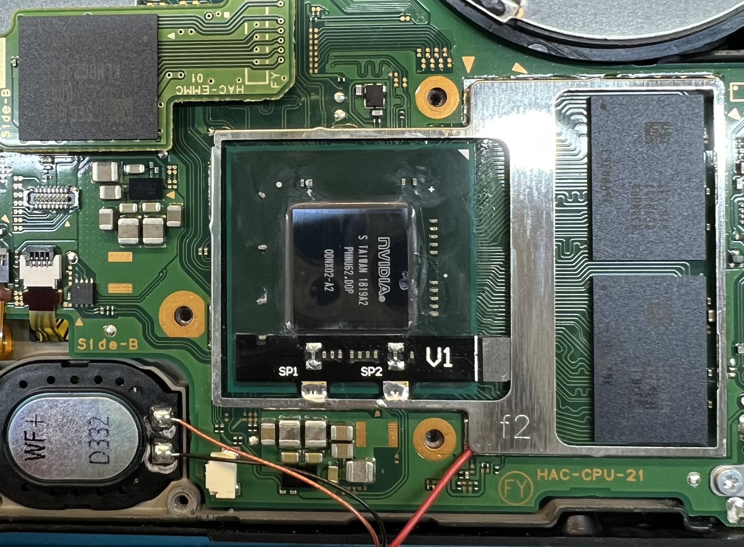

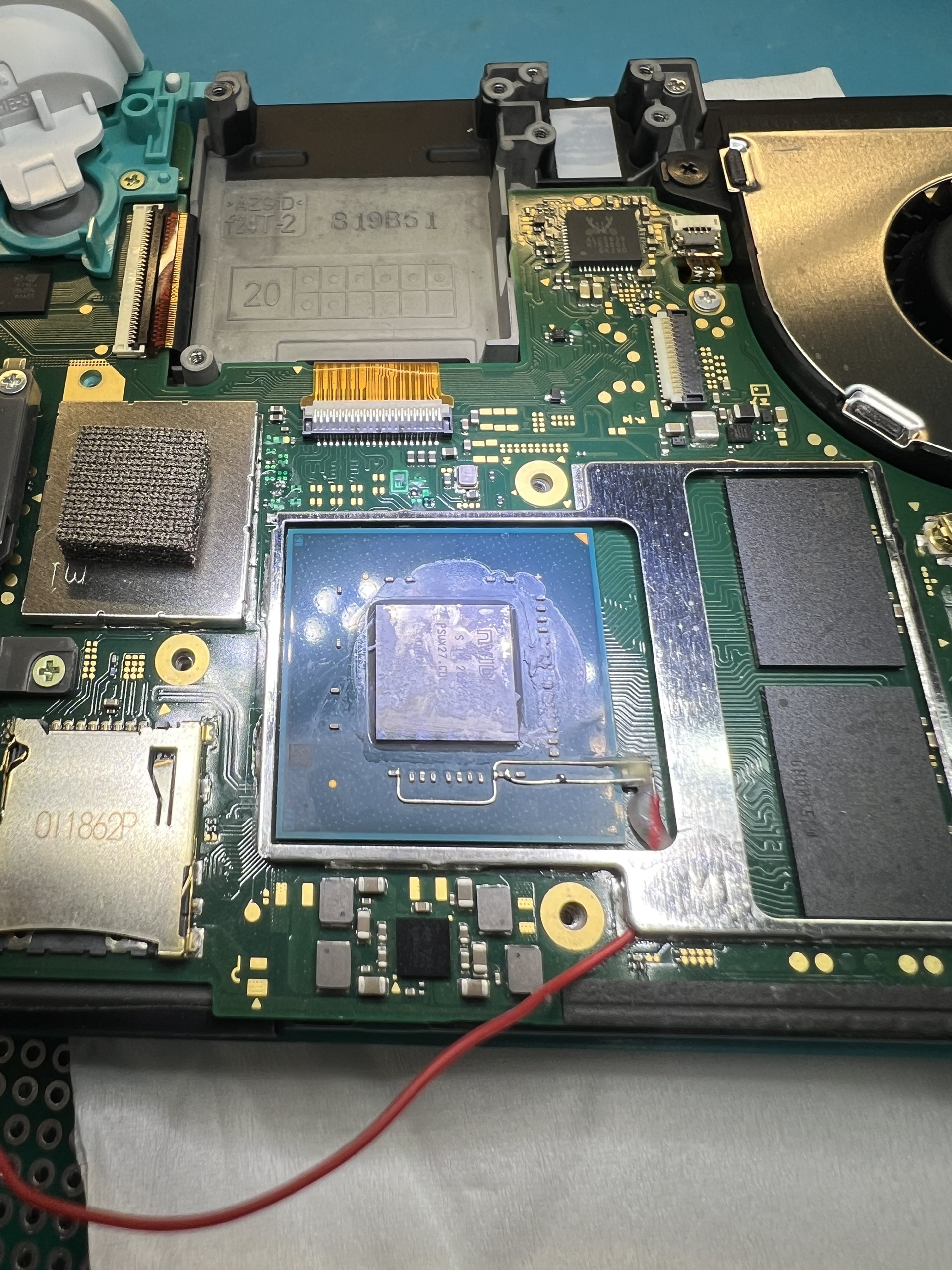

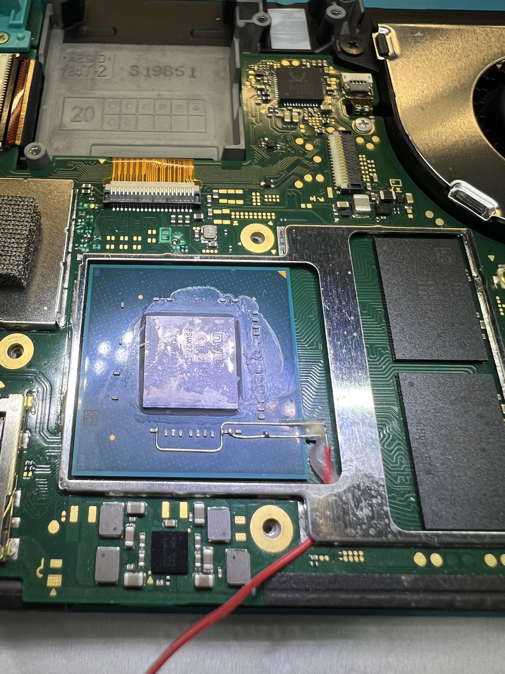

Removing that damn mmc was really thrilling, hot air at 400 degrees and a soldering iron tip on the ground to help desolder Without destroying anything.

Some pictures , hope it helps.
