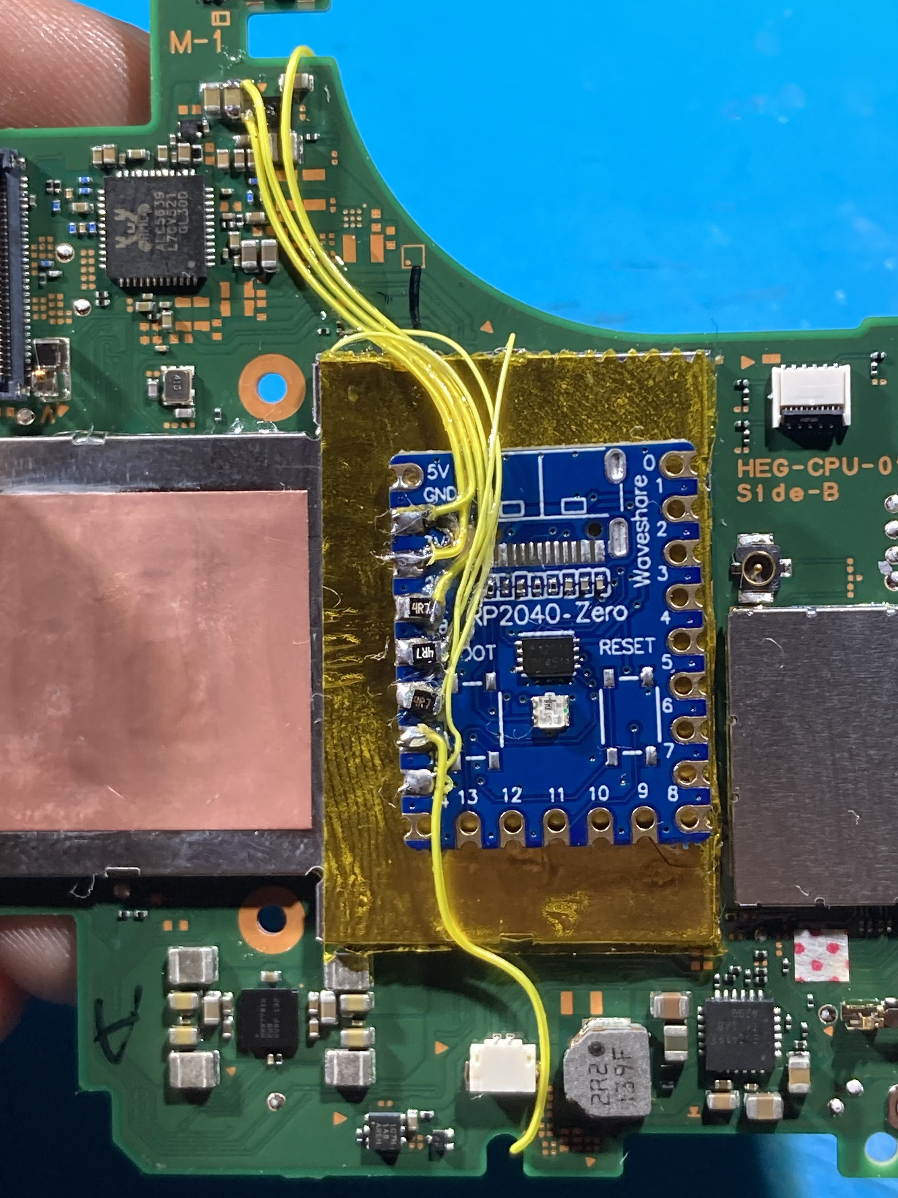

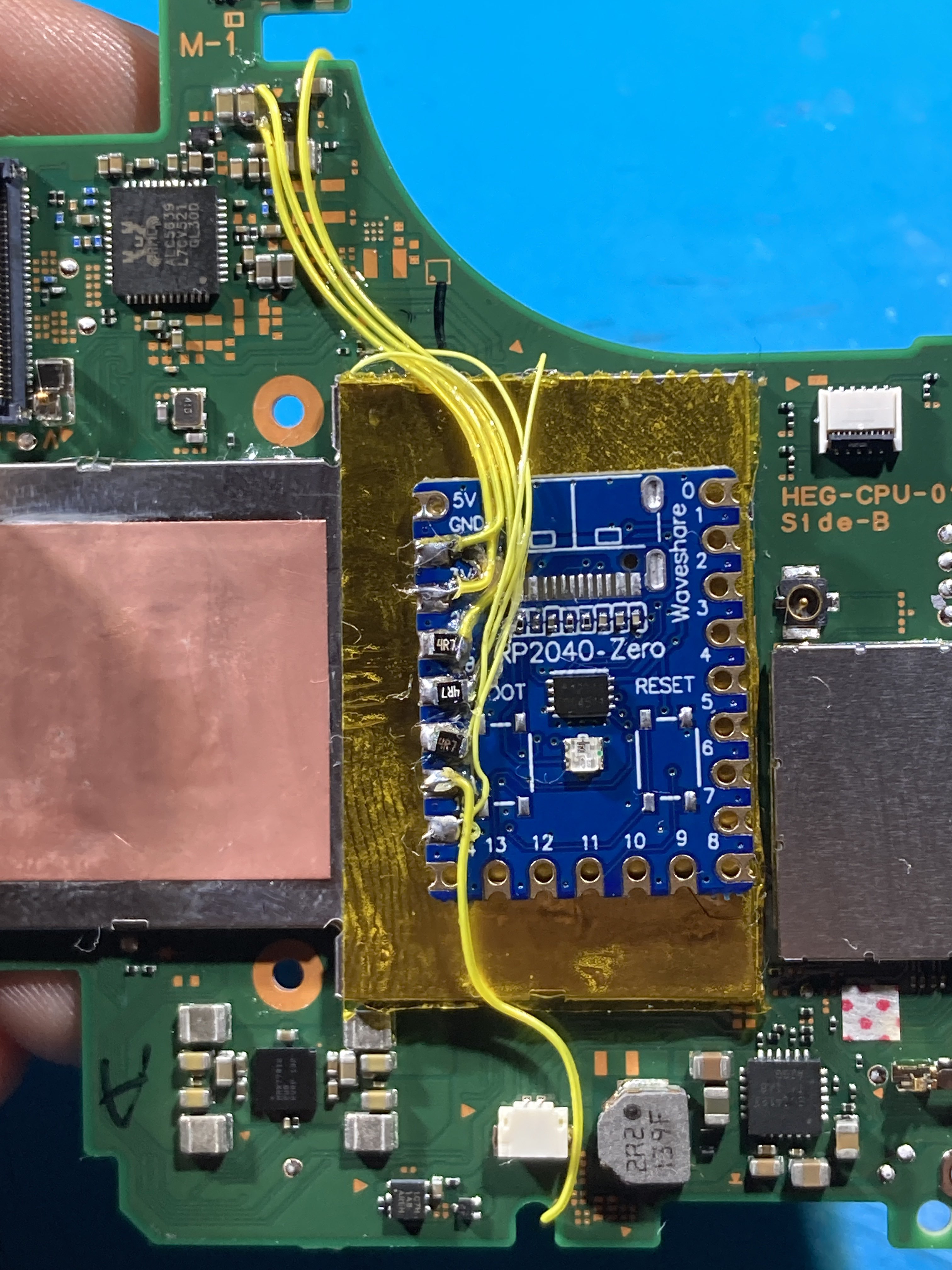

I join the question, i installed the rp2040 zero in a mariko v2 and works fine but the rp is too thick to close the console correctly without cutting the metal shell because is too thick, so in the near future i will replace for a thinner one, i was thinking in that picoboard you showed and in the tiny rp that i attach in the photo, anyone knows the pros and cons of each one ?
If you plan to replace that rp board anyway then just remove/destroy the usb c port and 2 buttons then just place it bellow the fan and secure it using some double tape, it should fit. And for the mod cable itself you can slide it in between the metal and the fan case.
