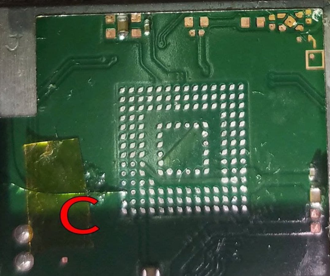

aliexpress and get the "4 anchor" one as in photo
permanent dat0 pin same as in photo

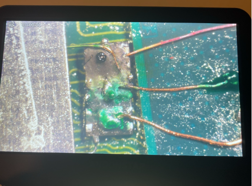

WELP 😃
what the hell happened :cry: i swear i did everything perfectly lol

WELP 😃
Sure looks like your CPU wire (Gate) at the top of the photo, is bridged straight across the crusty Drain pad that appears to be bridging the ENTIRE FACE OF THE MOSFET. Throw out that top mosfet and try again with more flux please. The bottom mosfet looks decent... However it looks like you didn't even hook the Gate wire to the CPU, so it's pointless.
the gate for the bottom one broke off when i was checking for damage, and the top gate well, i added soldering mask so i thought it wouldnt make a connection plus, my cable was enameled so i also didnt think it would short out. Also i got a question, what do you mean by more flux? what are you reffering to?

I see the green solder mask on the "bottom" mosfet, but the top looks all crusty and grey. Do you have two different soldermasks? My point of use more flux, is meaning that your solder joints look crusty and dull. More flux will clean up your solder joints and make things like shiny, pretty, and much more functioning.
PLEASE don't respond with "What is flux?" I might actually lose it...
This is what your install should have ended up looking like with proper flux and temperatures, with the right soldering tip, and tweezers to hold pre-tinned wires in place.

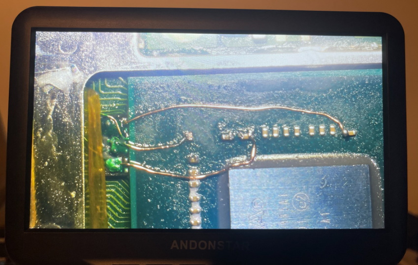

whats flux? Im joking lol i just wanted to know what exactly you meant by that. also umm.... the mask looks like that because the mosphet exploded lol. heres a picture of how it looked before everything went to shit. Also that is a very smart idea of what you did there, you combined both gates into one single cable, i should do that next time.
1684130834634-png.371439
The only way to install both gates in the manner I did, is to be very comfortable with tinning magnet wire precisely, because it requires tinning both the tip, and a small portion away from the tip, without tinning/ruining the insulation in the short span in-between that runs near the Source pads. Always ALWAYS check these points for shorts to each other before testing for a glitch. Otherwise, as you've learned, your mosfet can EXPLODE.

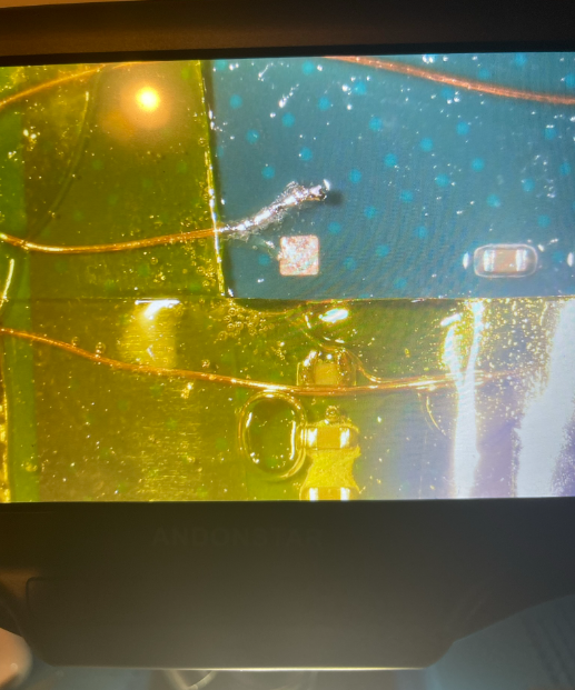

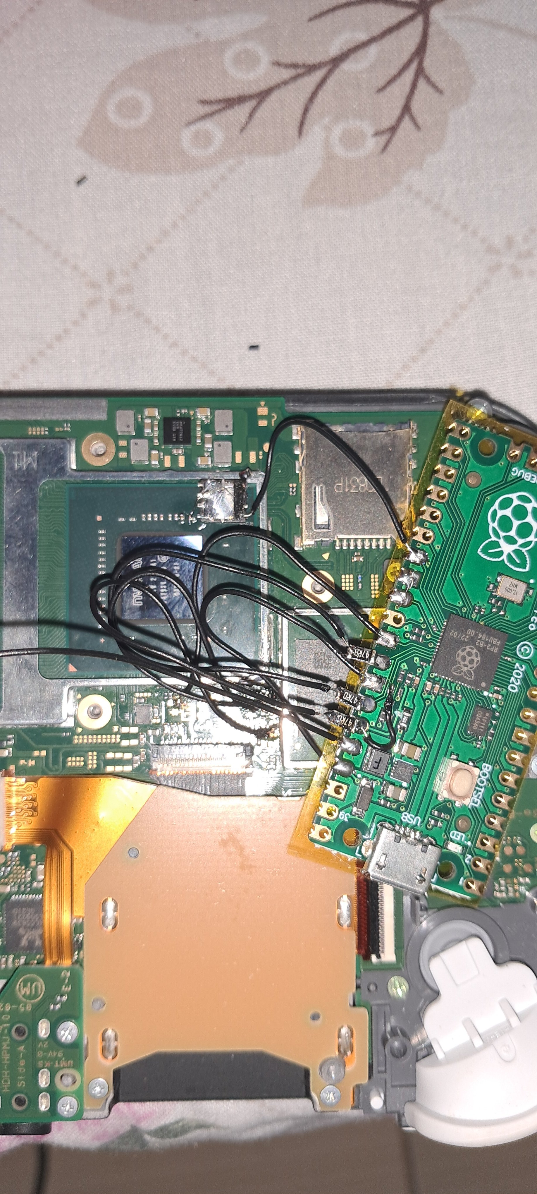

Hello everyone! I'm here seeking your help. I installed Picofly on a V1.1, and the glitch switch works normally. However, when I press Vol+ and Vol- to enter the original system, I get a blue screen. When I connect the reader with the SD card, the screen stays black. I have checked the soldering, and everything seems fine. I have also inspected the memory card reader connector, and nothing appears to be damaged. I have even tried removing everything to perform a factory reset as recommended, but when I turn it on, I still get the blue screen. I'm really at a loss here. I've done several installations before, and this is the first time this has happened. Can you please help me?

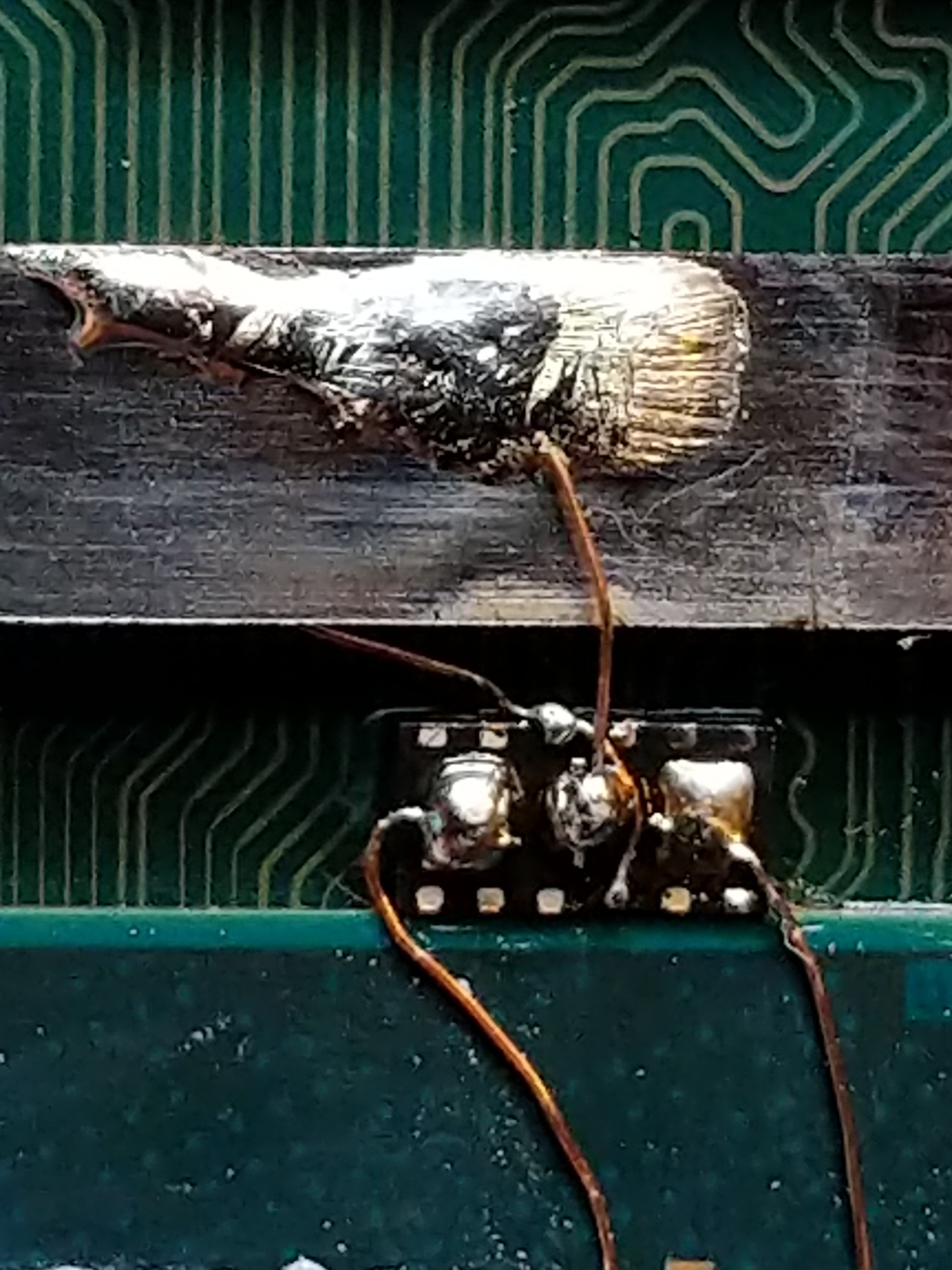

lmao
im sorry but this "ground" pinout.... its impossible to tin.... i cant do it. IT WONT STICK and yes im using flux. how can i make it stick?
scaped it a bit, we good now.

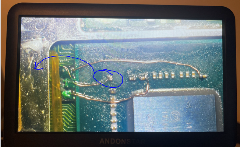

View attachment 371439what do yall think?
change the source point to another ground like the chassis as per arrow below, ive been there lol

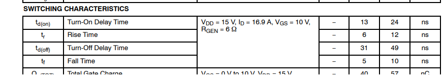

Nice finding. I think its more the characteristics of the glitch.
The rds must be at some range for it to be work, flawlessly.
[email protected]
AON6512: 2mΩ (15s)
NP2016: 9 mΩ (?)
IRF8714: 10.9 mΩ (?)
AON7400: 13 mΩ (2s)
IRF8342: 20 mΩ (1-3s)
From that data, the best Rds should be around 10 mΩ
If you try other mosfet, please let us know the result.
Thank you for the sharing information.
Or maybe we need to also pay attention to these switching characteristic value?
Also it can be that different brand states or we call it promote their specs differently.
Will update tomorrow.
