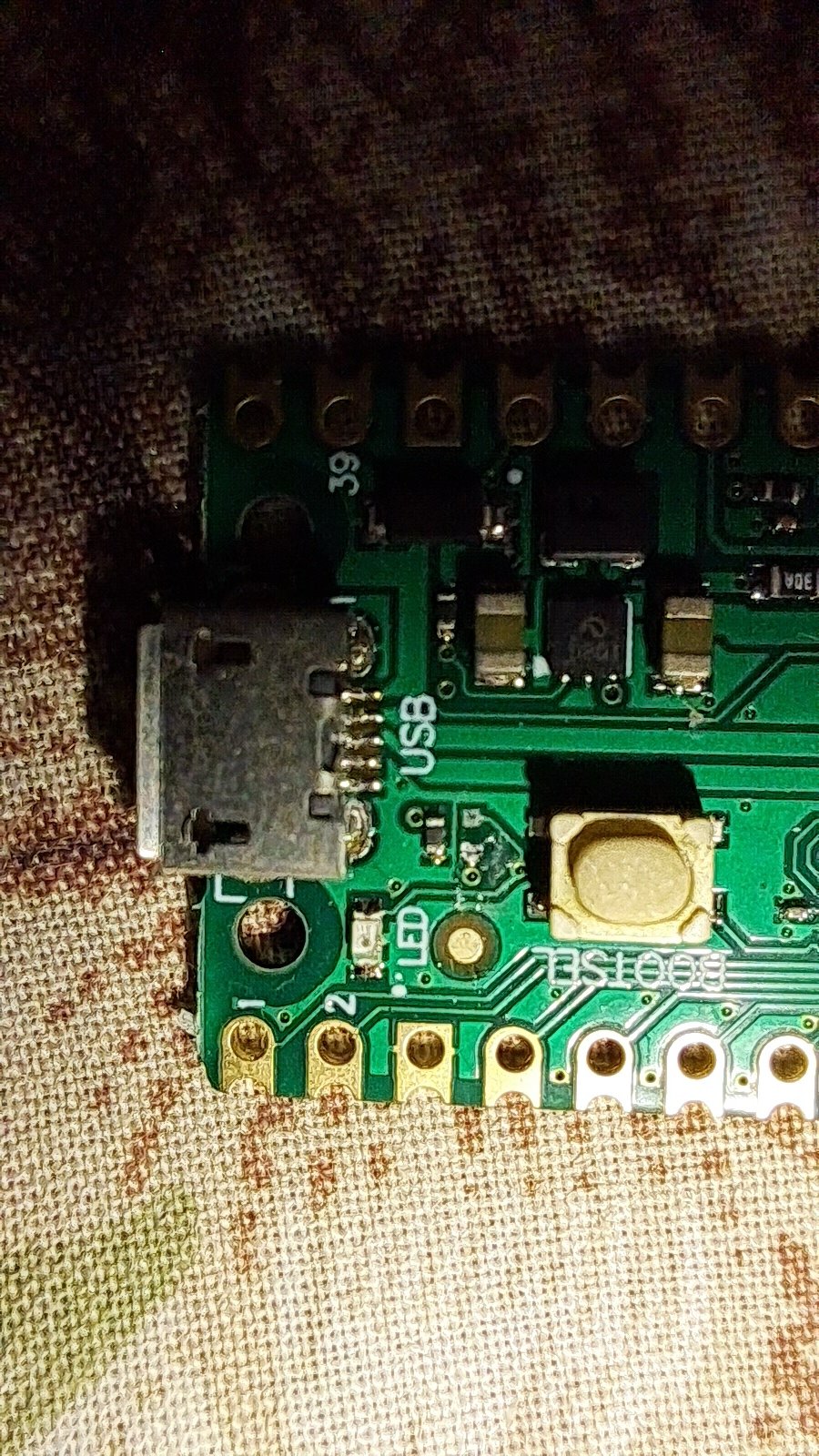

Hi everybody. First of all, thanks for clarifying the installation process. I got a rp2040 installed on my Mariko and it works flawlessly. There is however one thing that I think should not happen. Whenever I poweroff from the menu in ofw, next time I push the power button, the screen stays black. Then, I have to push power button for a few seconds and next time I turn the console on, hekate boots normally.
Any ideas about what could be causing this?
Hi bro. I have same issue. If you take a look at pico, it should still light up for some time after you’ve shut down. Hence it is not responsive when you immediately try to turn it on again because it is still shutting down.

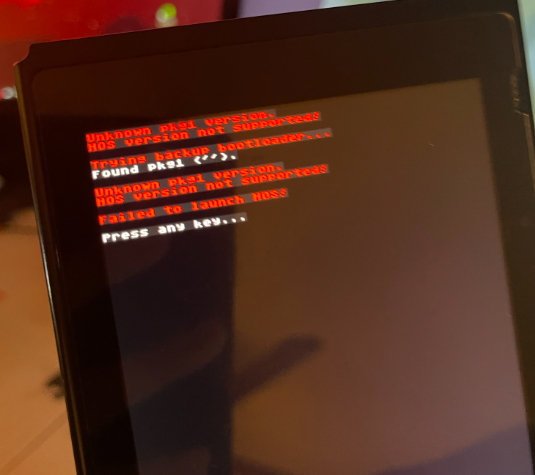

i get this when i try to launch hakete, whats wrong?
Check your SD card. It might be either fake or corrupted.

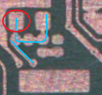

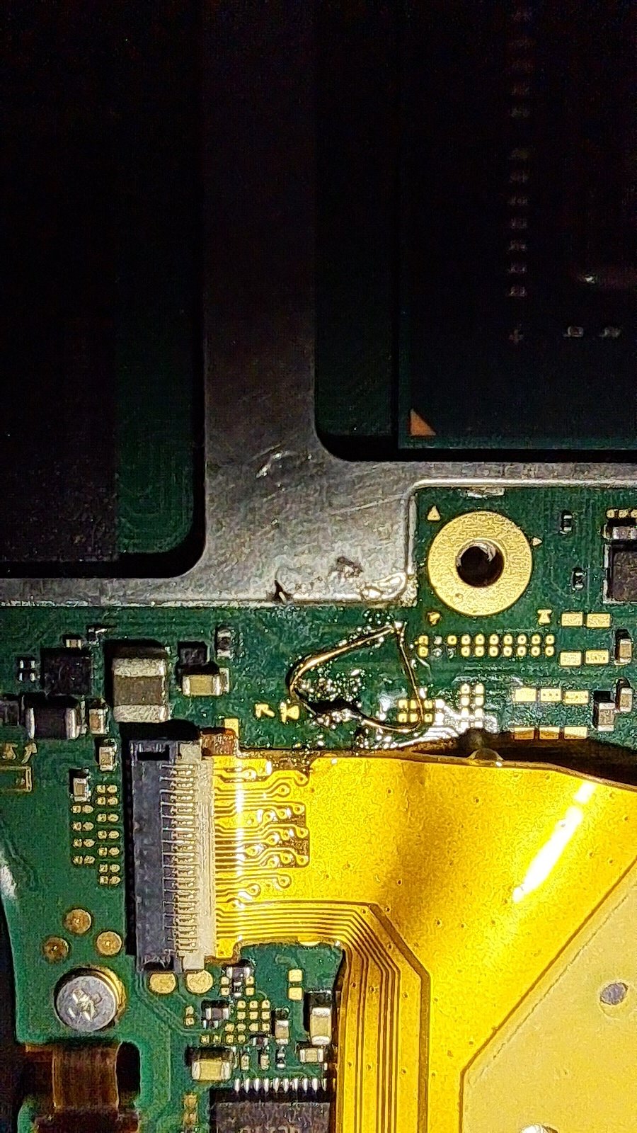

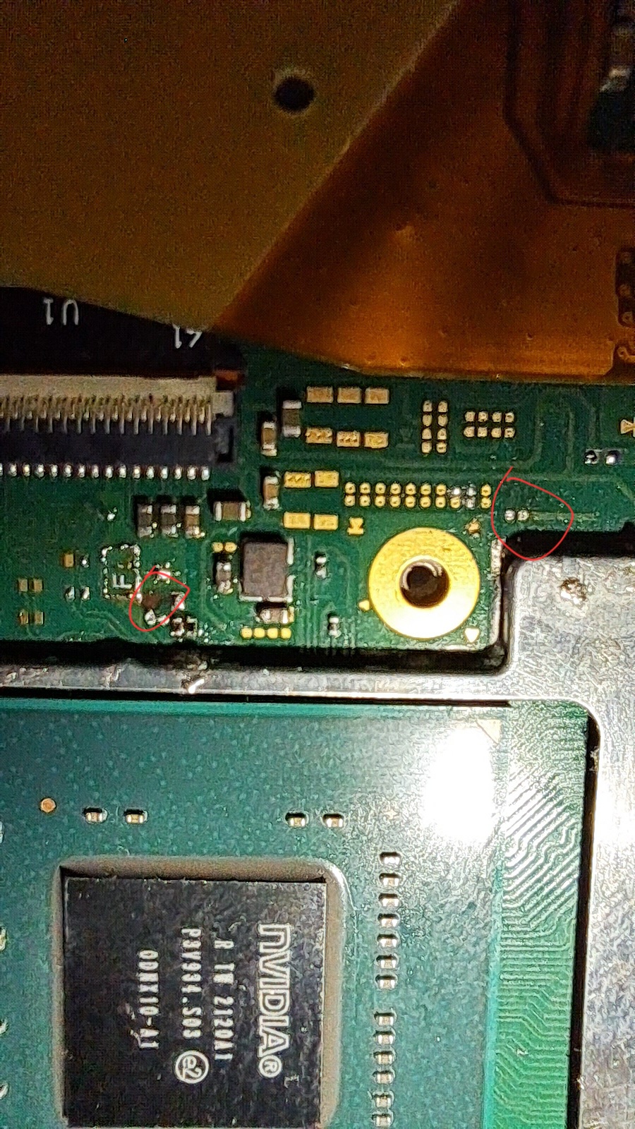

Please help, i need to repair broken rst point , what should be the technique.
Also what value the cap/resistor on alternate point on the right.
Its gives purple screen when i boot it up.
Actually ripped part is only in red circle, so it doesnt have any vias. Should be safe to leave it then ?.
It seems it has vias.
Any jumper point can be used to restore this connection?
And it means that purple screen is cause by cmd traces not connected because missing resistor?
And anyone know the value of this cmd line resistor?
Yes.
If it have vias, i don't think it could get ripped easily, since it has anchor deep down in the layer :lol:
I am sure it is. Since thats the required component which is missing.
Because the cmd is disconnected, then the apu can't R/W to the EMMC, and throws that purple. Just like what those on reddit says, its about kernel panic, or something wrong with the bootloader.
Yes i have look and it seems doesnt have any, if of course every image layer have the exact coordinate.
Please help measure the value as i lost the original one.
