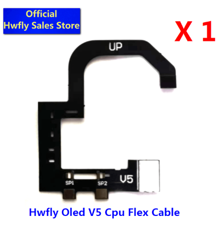

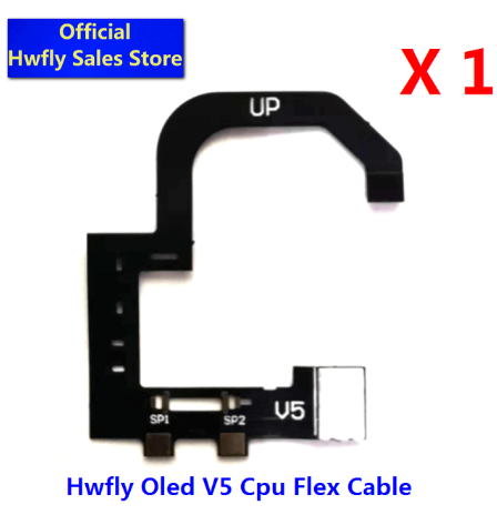

Hi, in the first page requirements, it says
  • Mosfet (IRFHS8342 MOSFET) or cpu flex cable - I personally recommend - (lite flex for lites, v2 flex for v2 mariko etc etc)
If I want to buy/get an Oled version, is this the only cpu flex cable compatible? Or are there any cpu flex cable can be used?
All flex cables that have this orientation of SP1 and SP2 points can be used.
(You can also use the other model, but it requires moding and I would advise against it in this stage)
