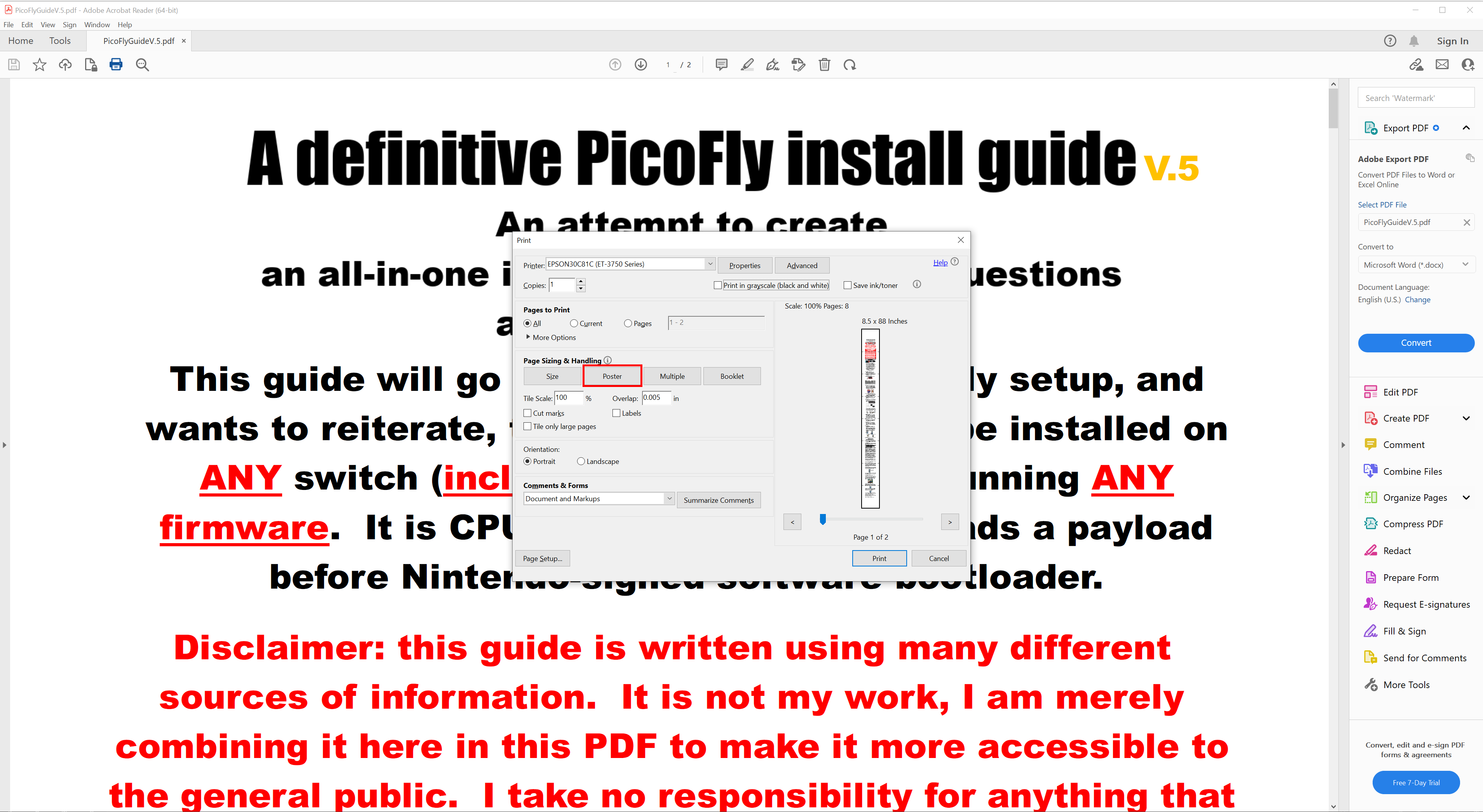

Does anyone have the new insturcations in a word document. I have a local repair shop that want to do it but they want a hard copy to see. I have tried printing the pdf but it prints everything on two pages and you can't read it.
tried it and same thing
You just don't understand print settings in-depth enough.
Open the pdf in Adobe Acrobat Reader, hit print, then hit the button that says "Poster" (boxed in red in the above image).
This splits the PDF across multiple pages to print.
