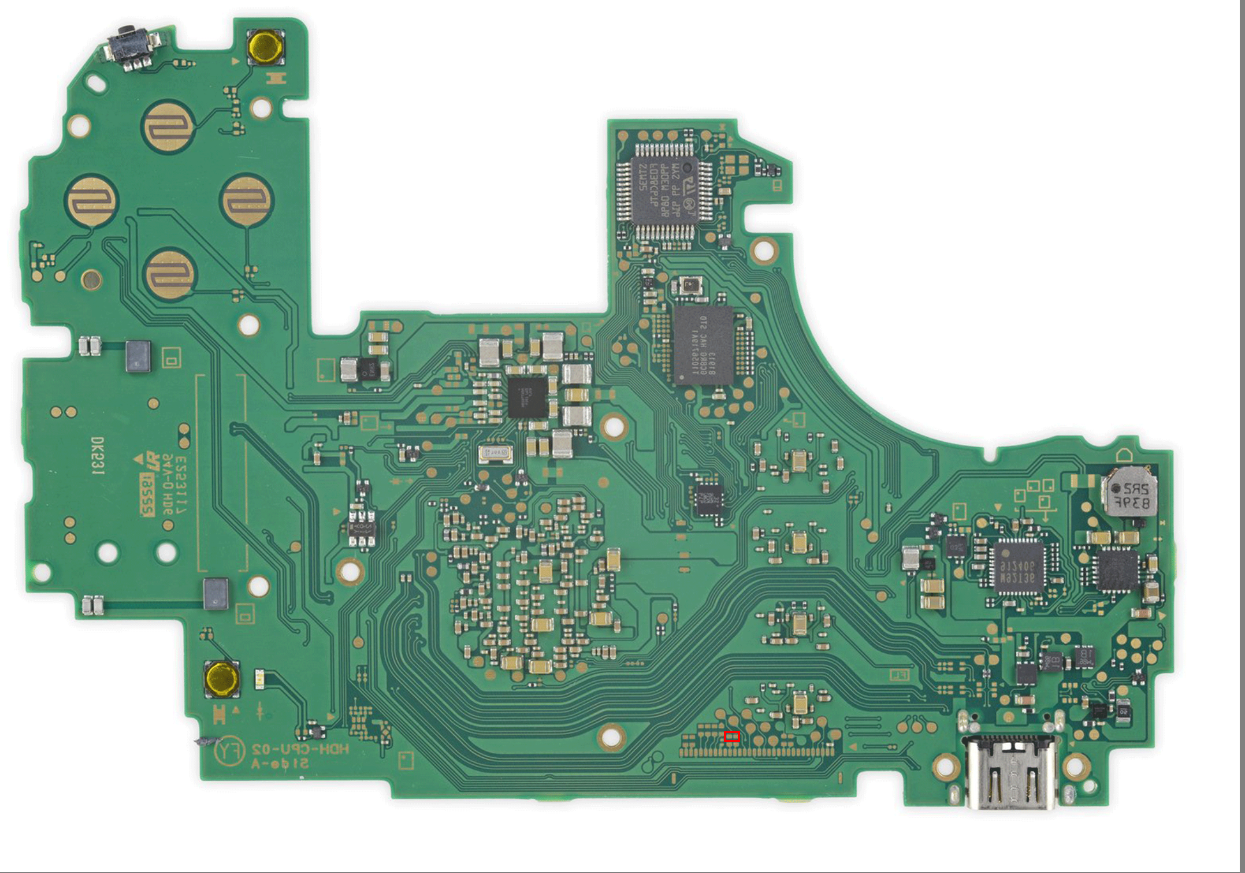

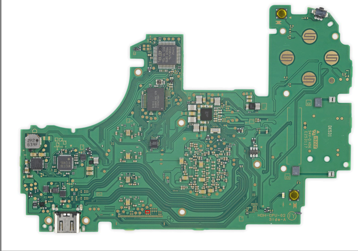

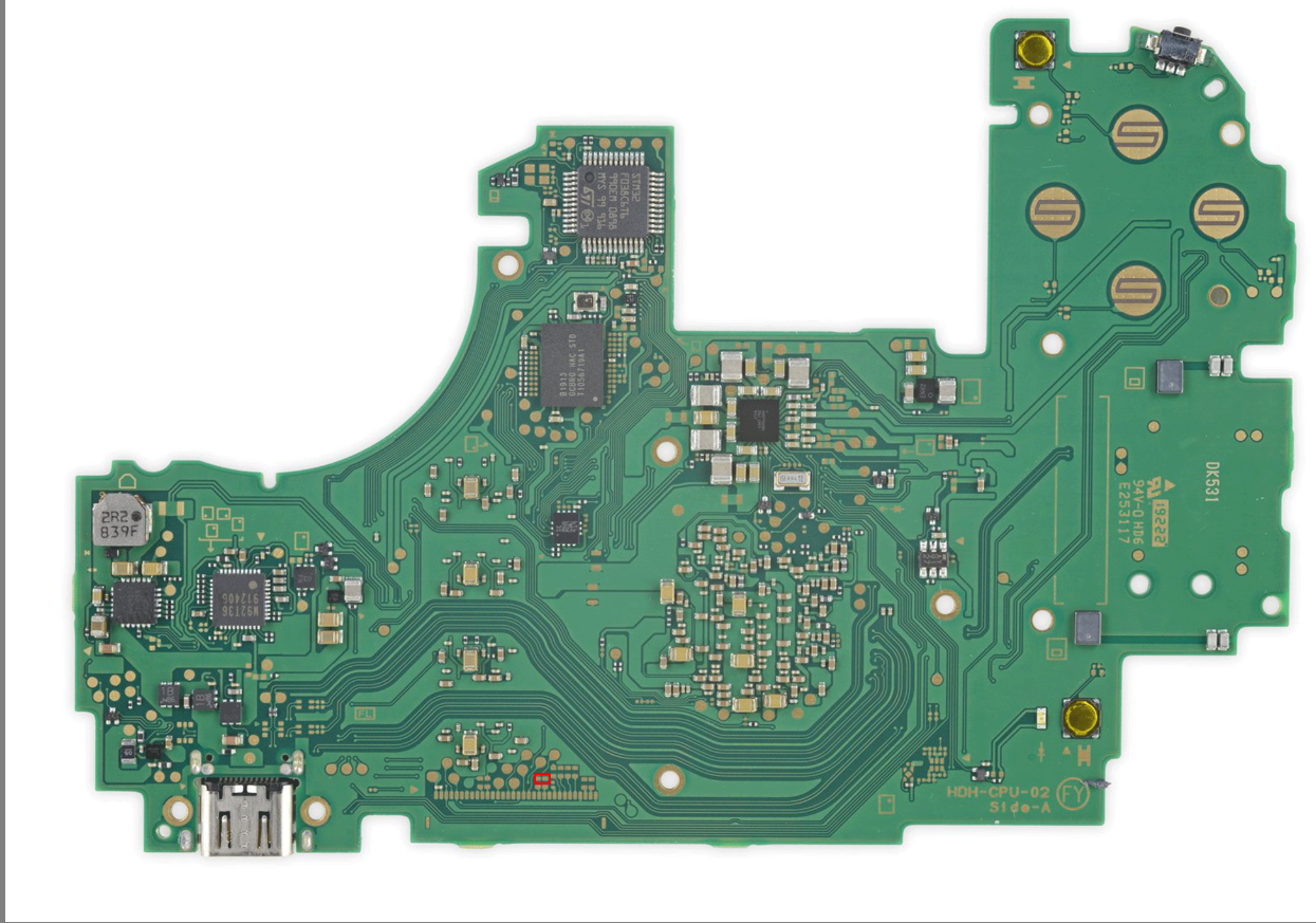

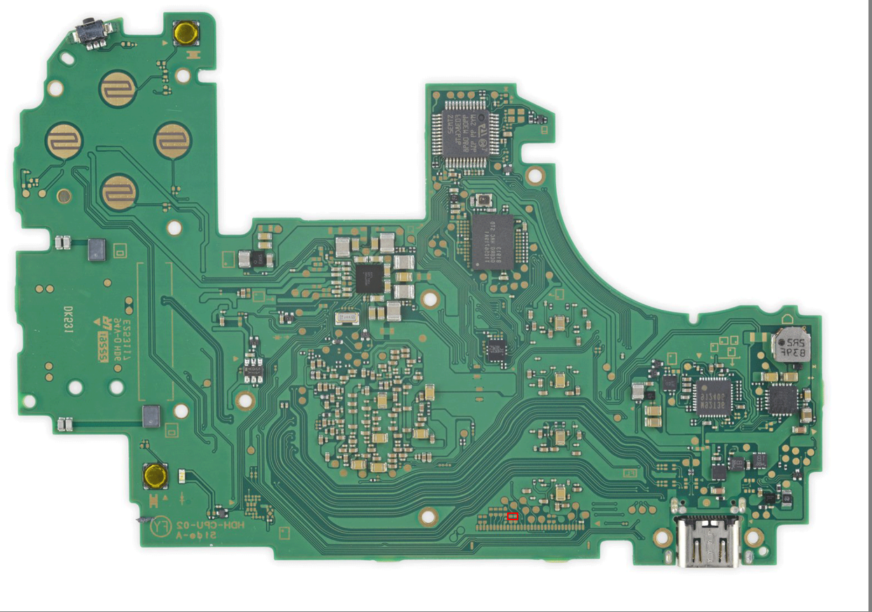

for lite
where that 2 point located ??
i cant find those point ? on the mobo? lite
for lite
Back side of the board, inside the red square noted here. DO NOT ASK ME WHICH POINT IS WHICH, READ THE GUIDE.
