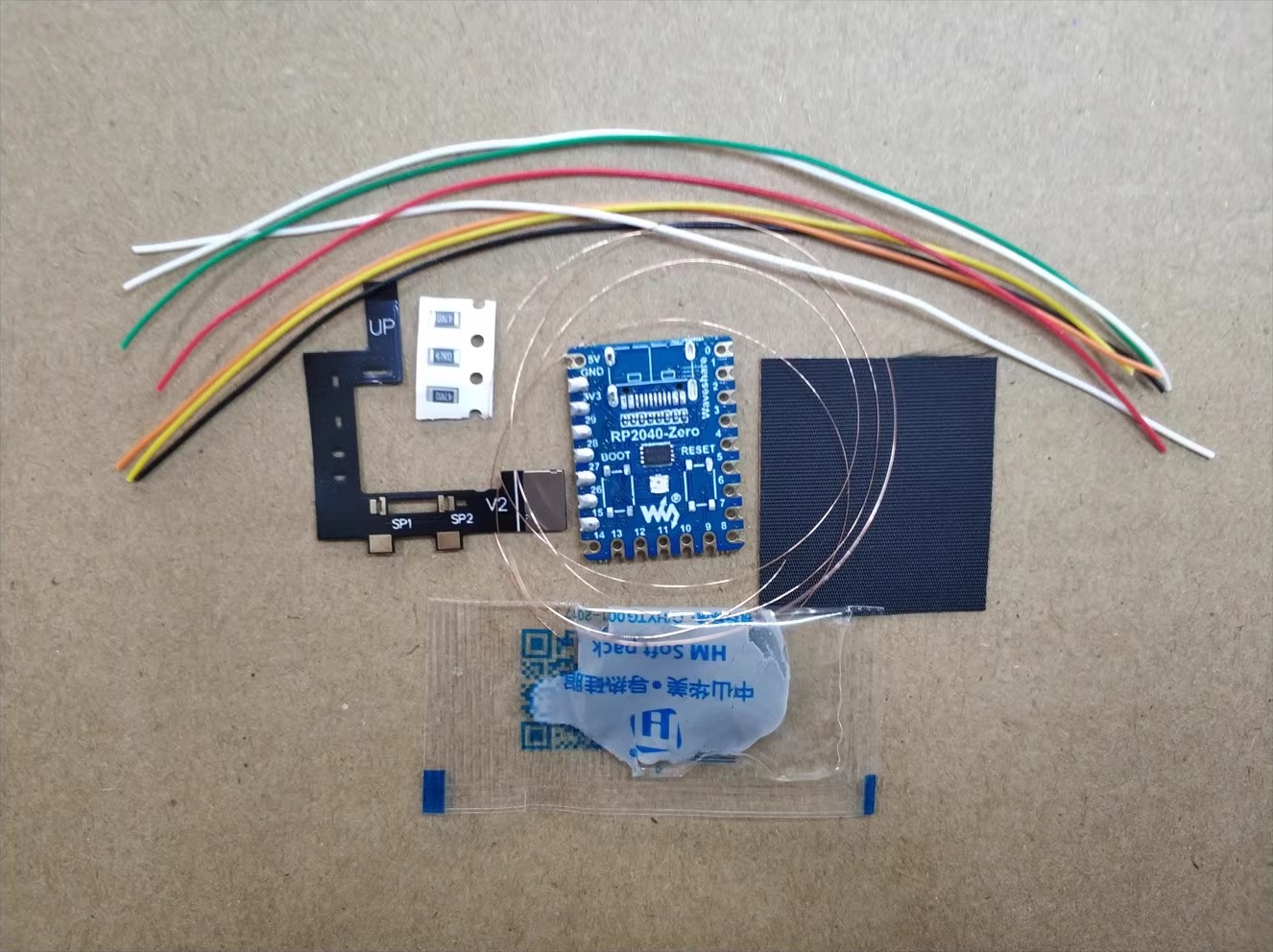

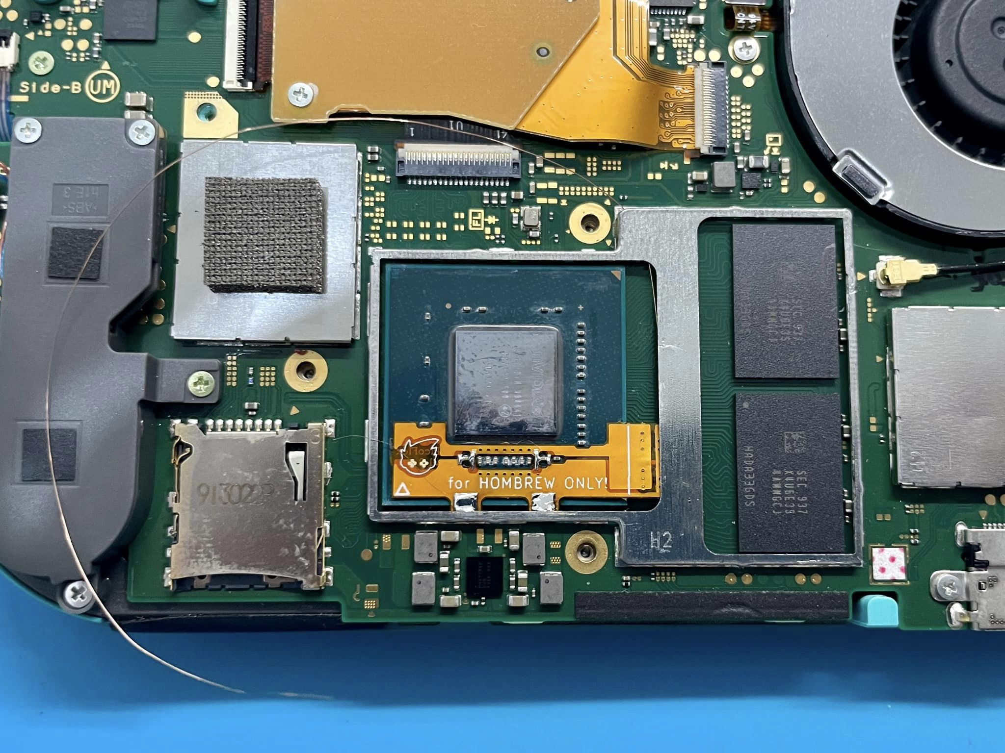

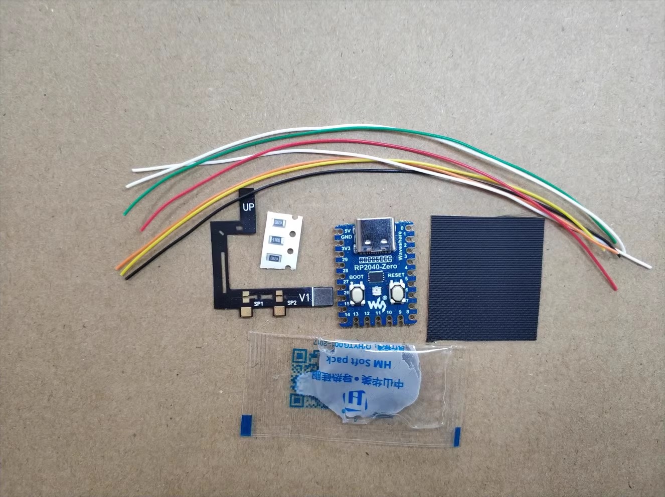

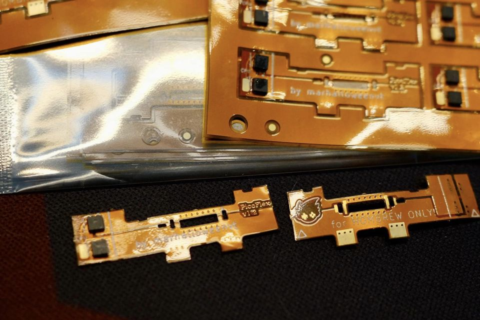

Finally, I can get out of my sick bed and back to my Personal R&D Headquarter (my beloved bedroom). During my sick leave, there are lots of thing has changed/updated with Picofly scene.
Good news is I have completed testing cable for Picofly (fab it with JLCPCB and share them among my friends who are able to do hardware mod with their machine). Cable works perfectly. Beside JLCPCB, I already try with oshpark and nearly 2 months, I haven't received them yet:hateit:
Bad news is I can only support Mariko variant due to not having V1 around. But I am willing to adjust if someone can give me dimension.
Some pictures:
P/s: Tidy something up and will upload them on github
Note1: According to another thread, I will add 1k ohm resistor between Source and Gate pin.

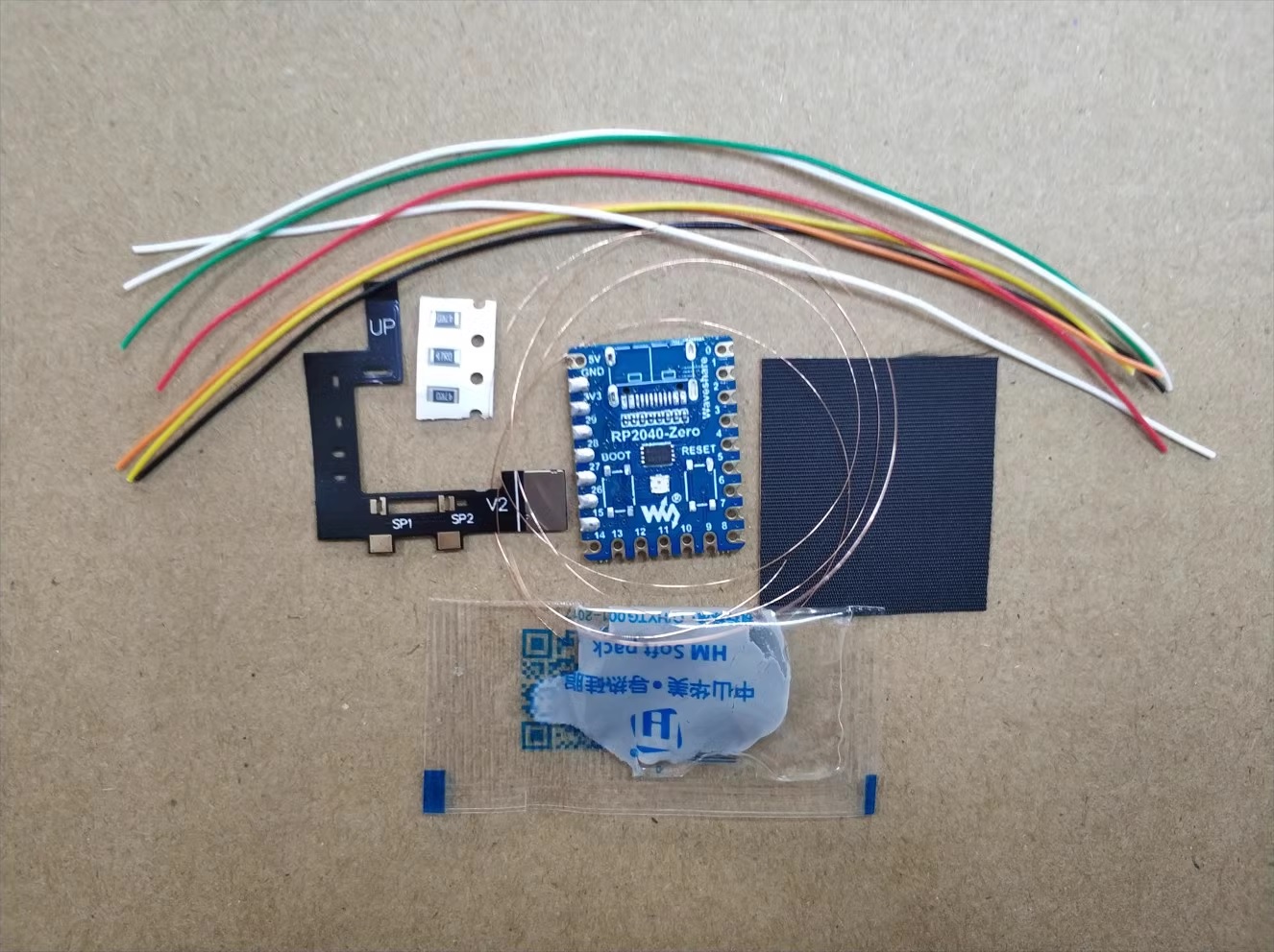

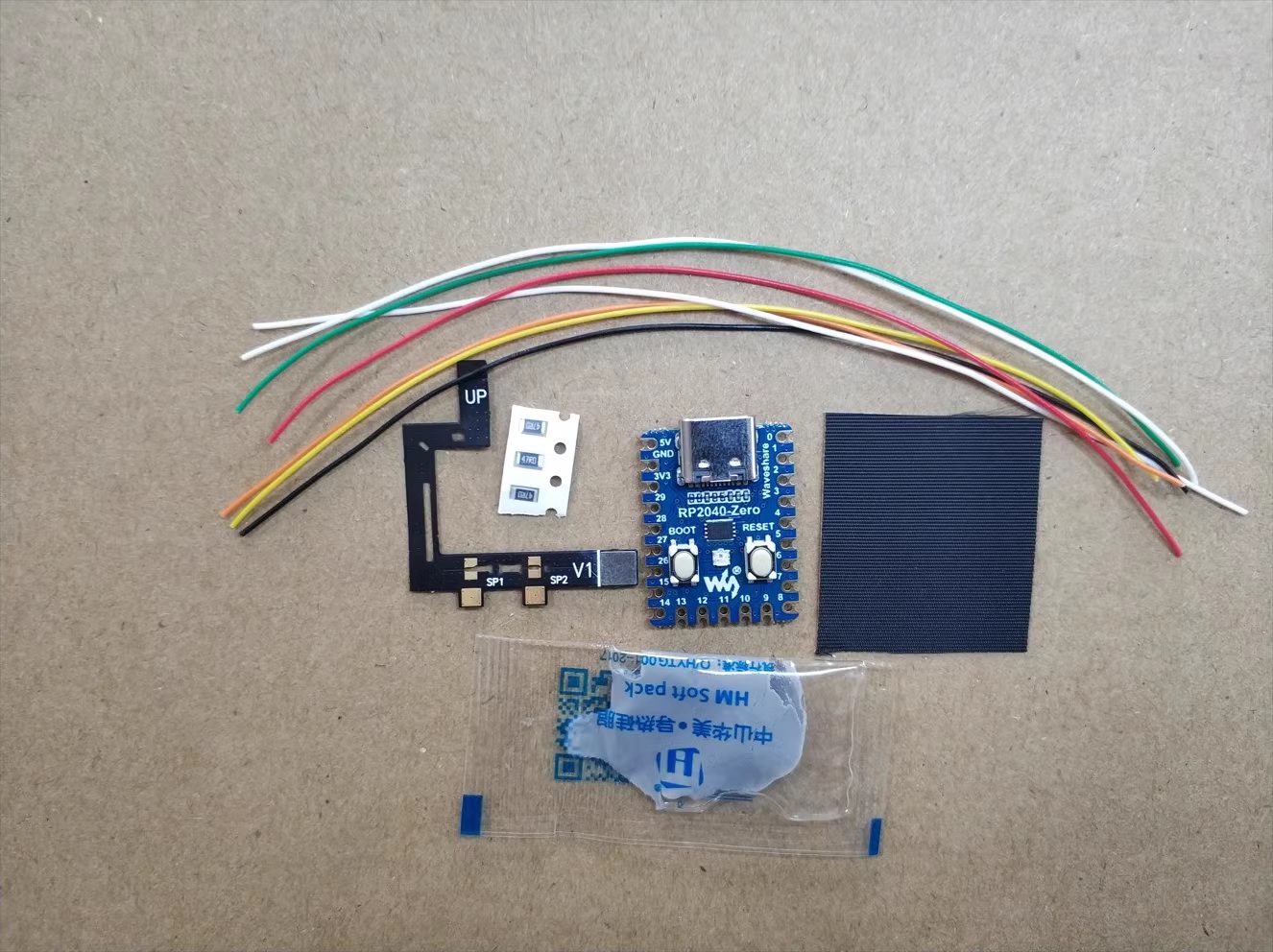

Some pictures:
