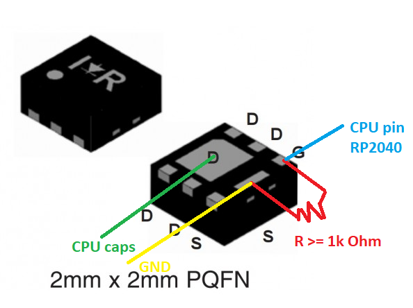

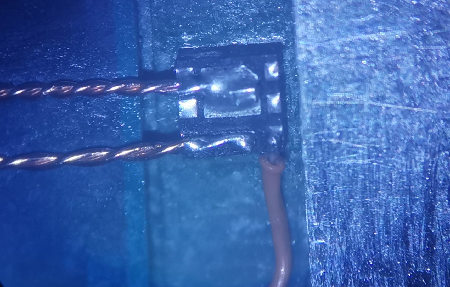

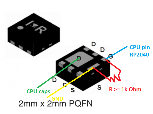

I would like to ask you about the soldering of the latest mosfet that you published before.
I understood it as shown in the diagram on the left, is that correct?
If one views you drawing from "dead bug" (bottom up) perspective, it's wrong. The resistor should be connected between the Gate (pin 3) and the Source pin on the MOSFET. Instead, if you replicate rehius' pic, that's the (correct) way.
Is this correct?
I have to put a 1k ohm resistor between G and S, right?
Is this correct?
Yes!
Right now you have a "flipped diagram" version of rehius' picture. Since there's only one gate pin, it should be easy to follow ;)
Here's a sh*tty paint drawing:

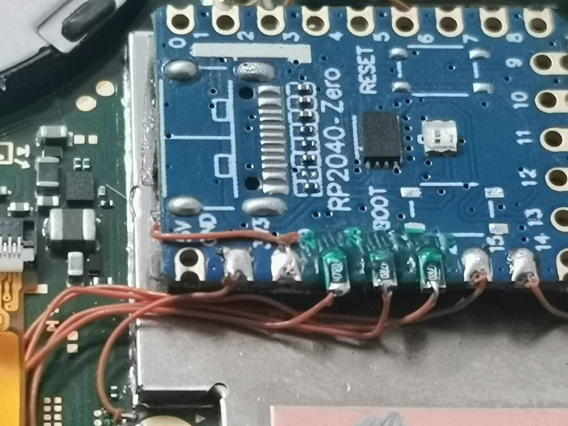

Those who ask can refer this. V2 with Pi pico, 1Kohm pulldown resistor on board, 100ohm Dat0 to eliminate slow emmc warning.
Not doing some low voltage glitch feature yet, maybe next install.

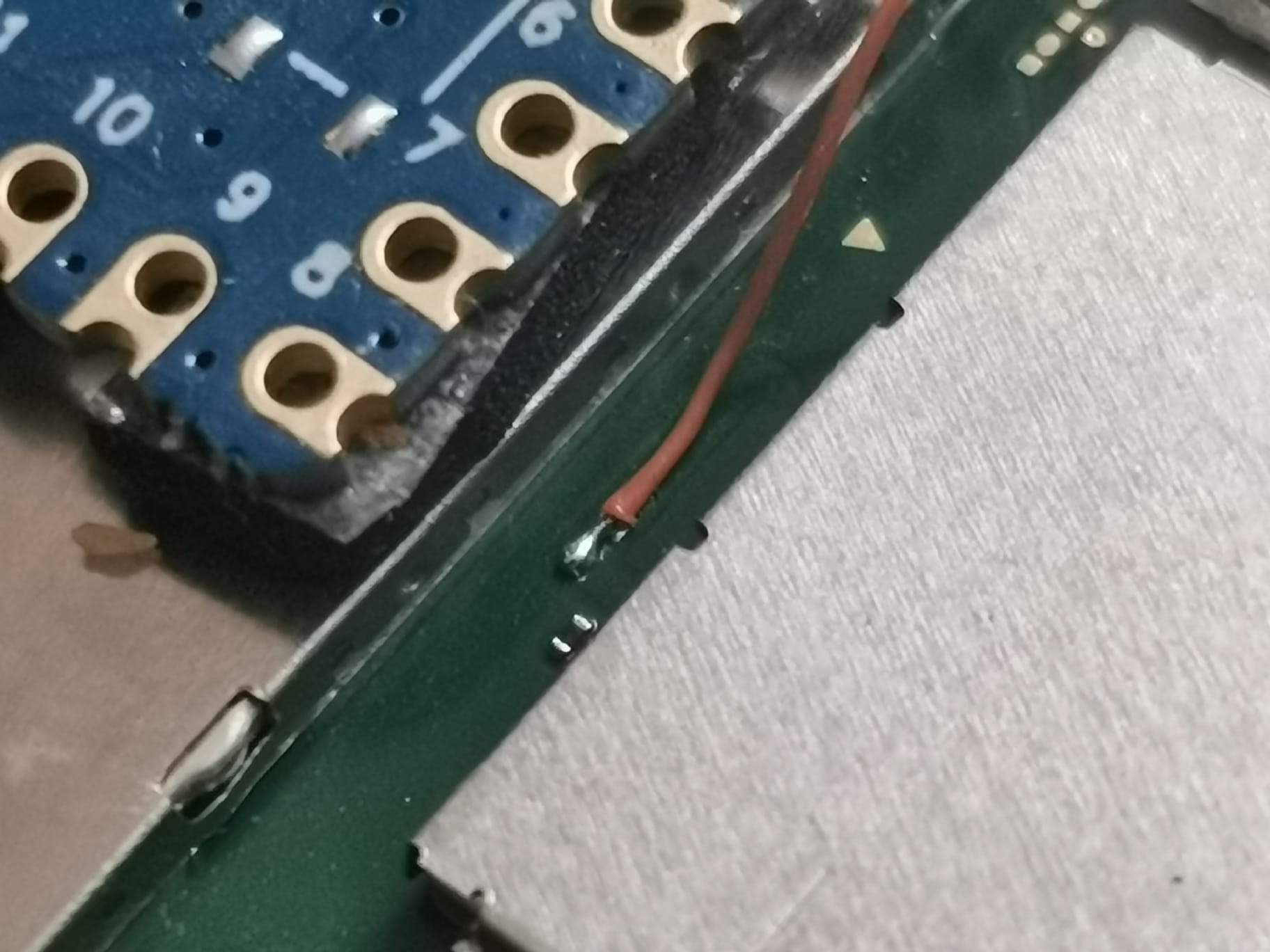

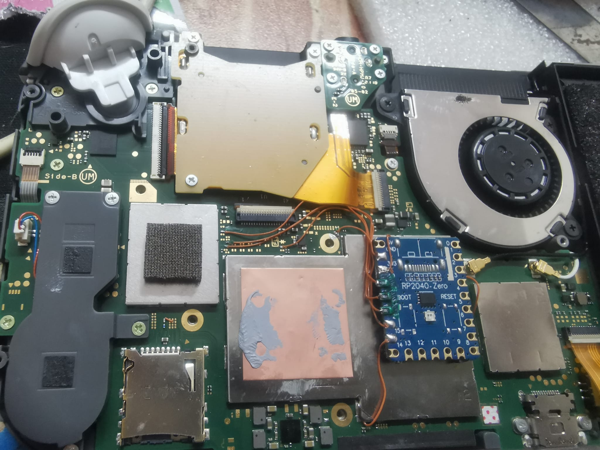

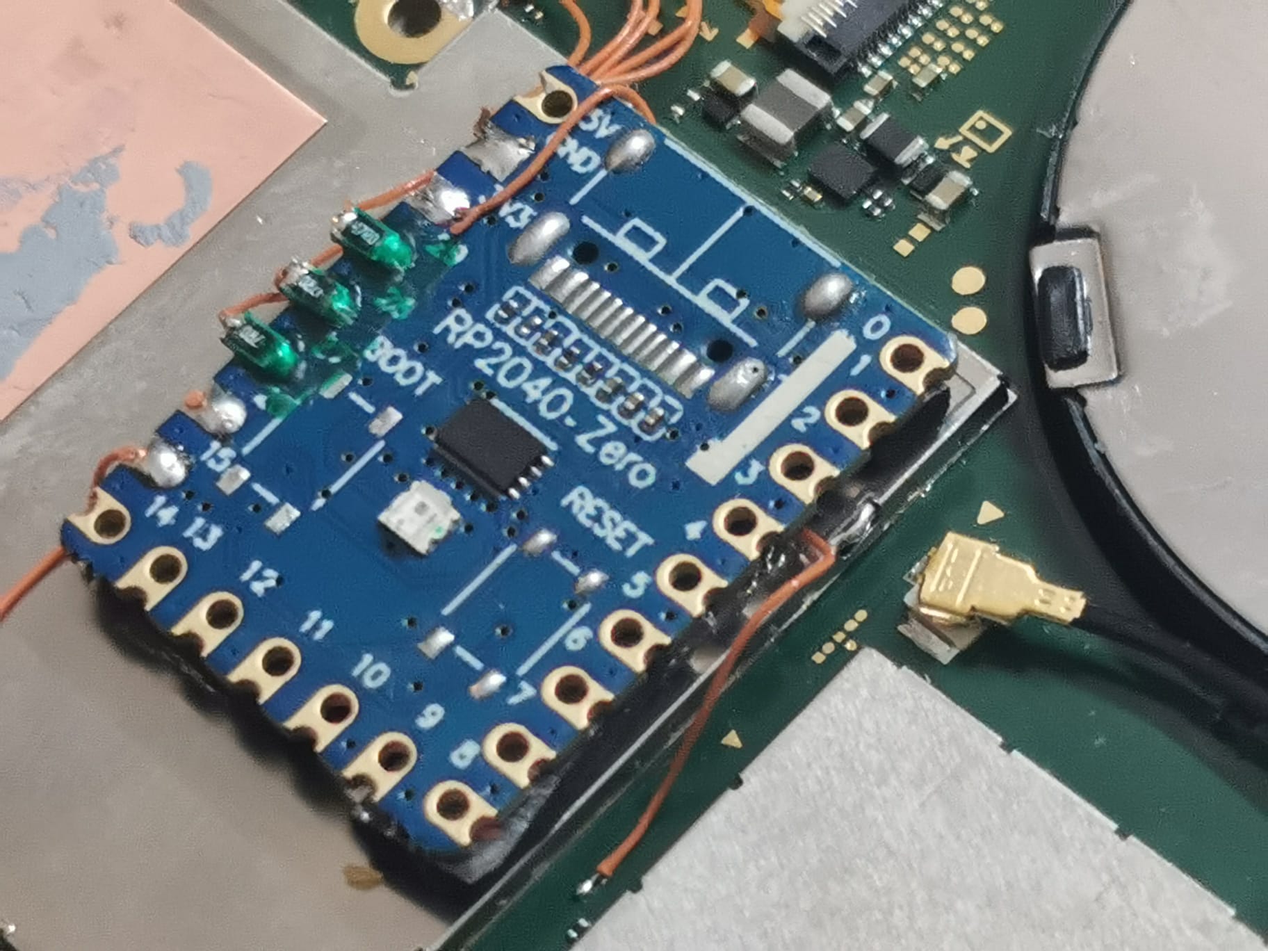

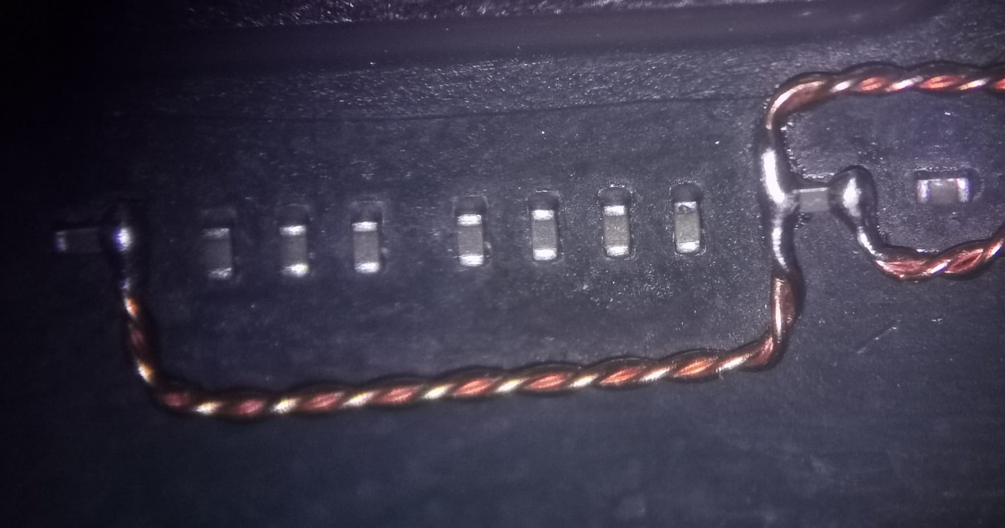

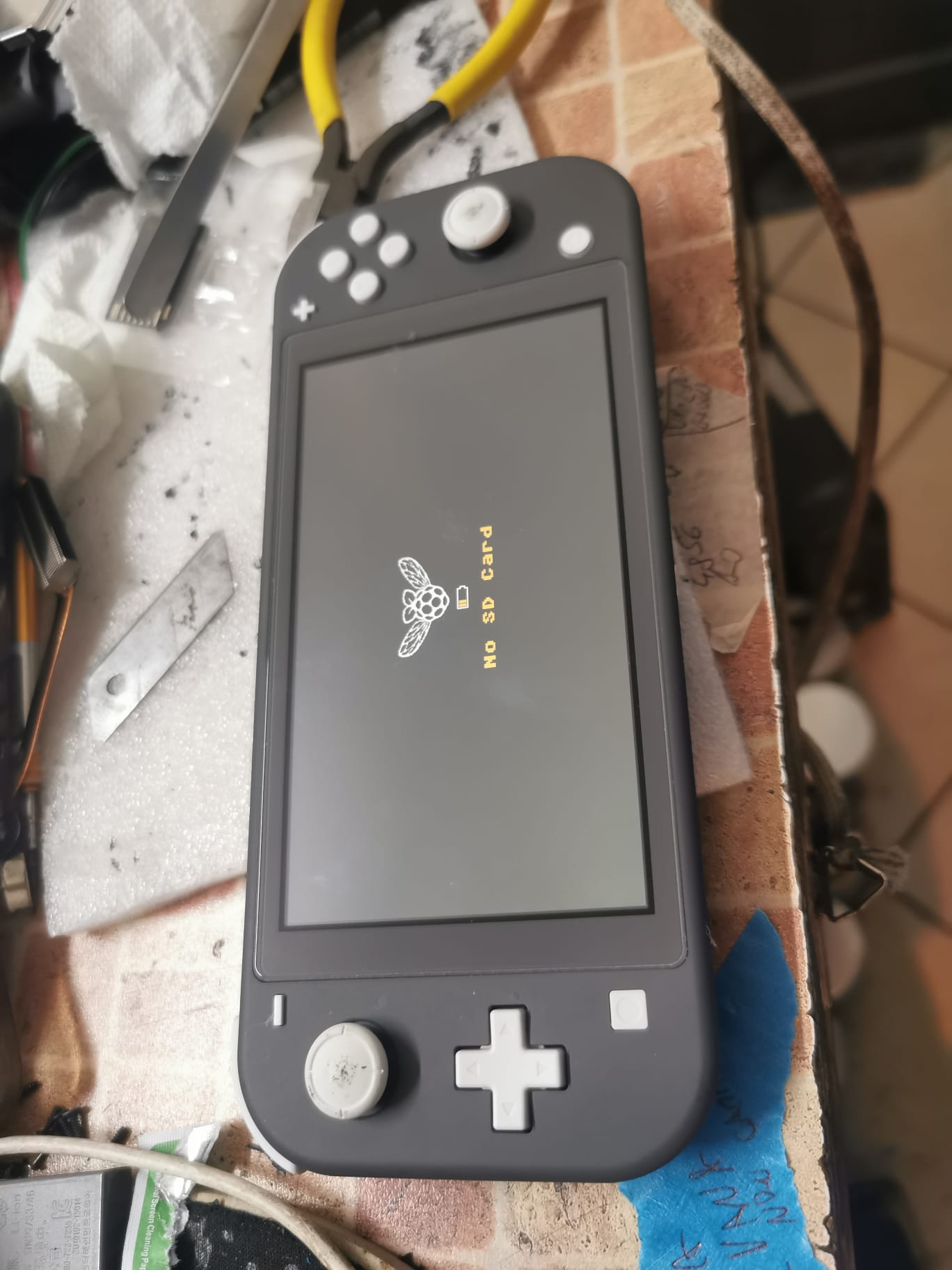

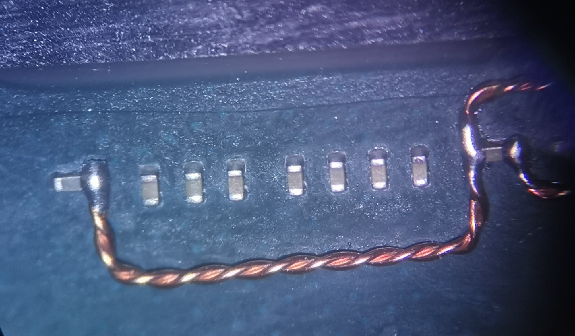

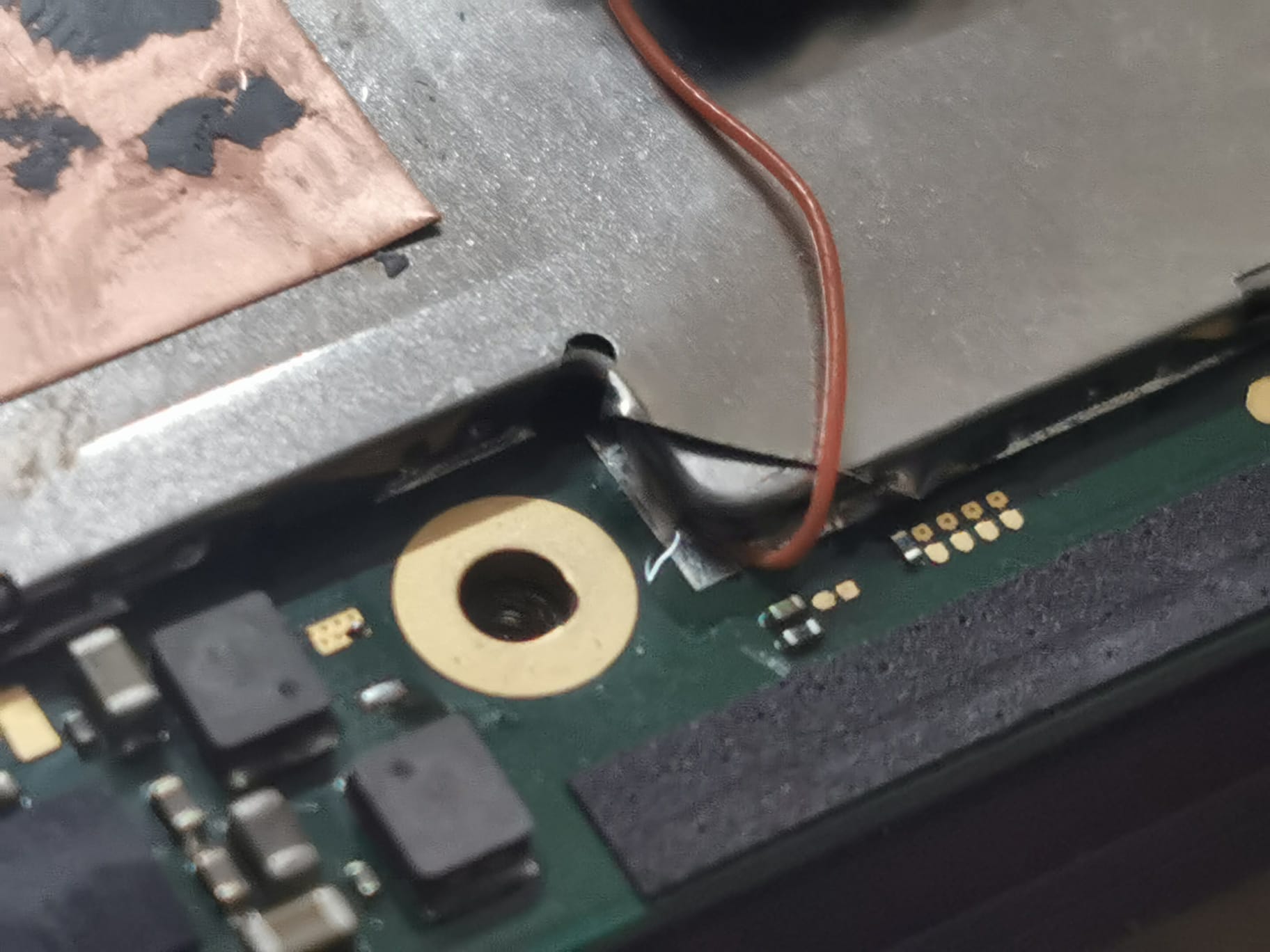

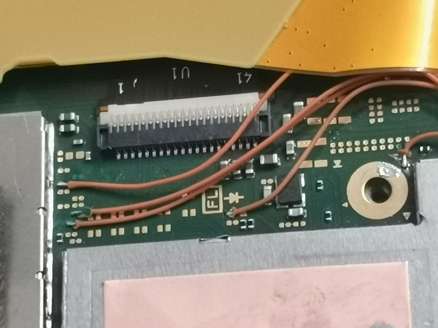

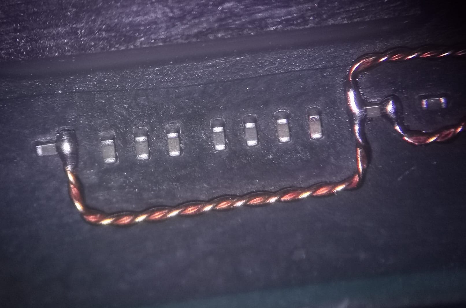

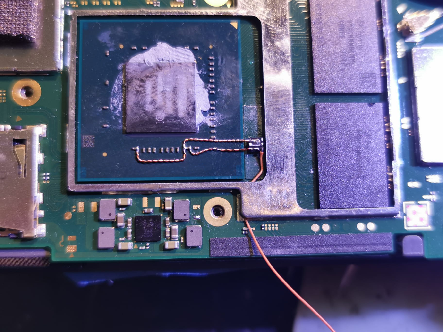

Ok, I installed today with 2.73 FW on a lite switch, classic installation, 1 mosfet, I didn't add resistor on mosfet, I didn't solder sda, scl either.
Everything starts instantly.
So, can I avoid adding?

you should avoid scl/sda, only when you can't do without it
1K Ohm is recommended, if possible. it makes the whole setup safier. less chances of accidental mosfet enable
