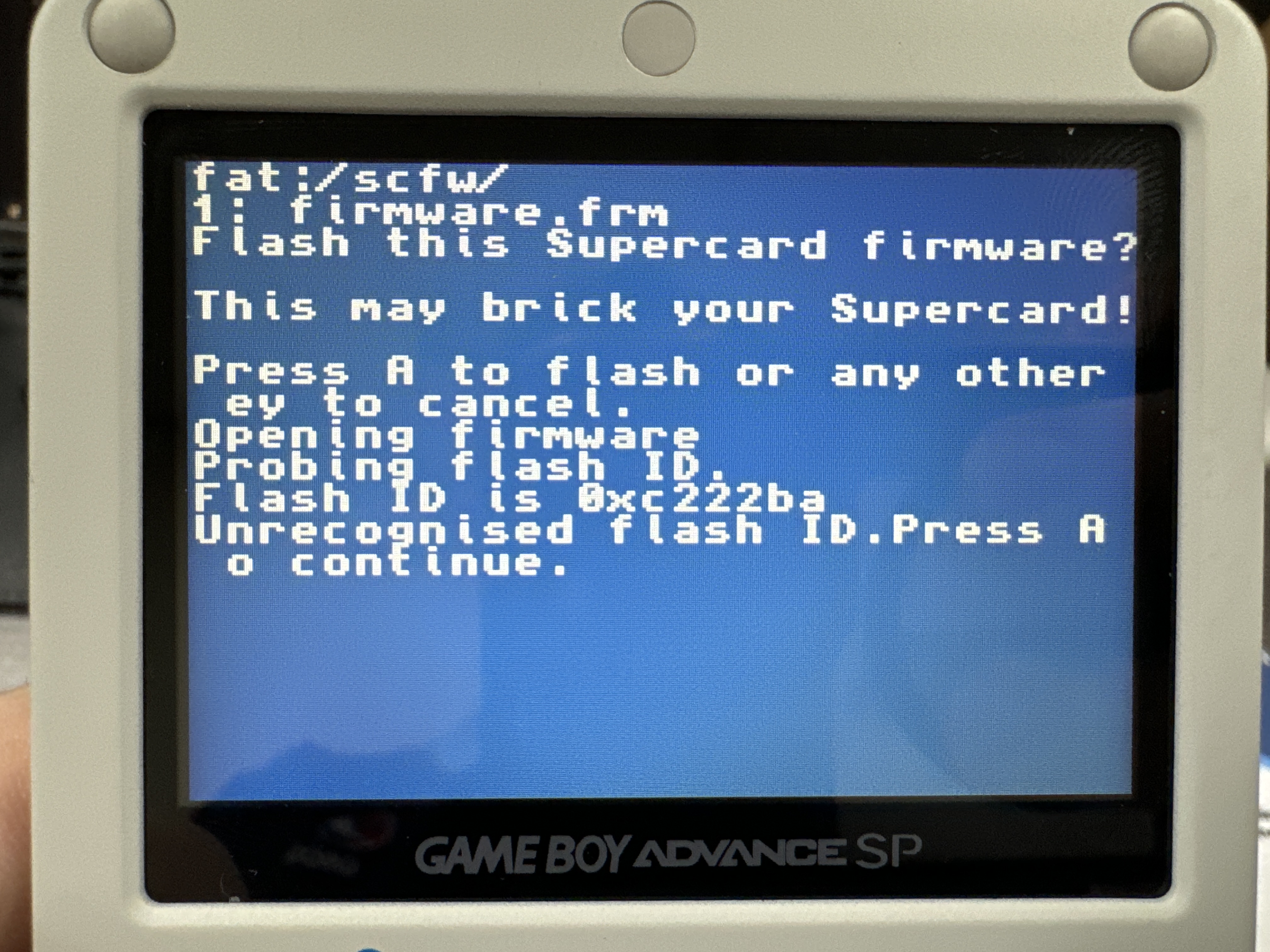

Hi, I was reading your post about the CF for the SC, I tried to run it on mine but I gave an error of wrong Flash id

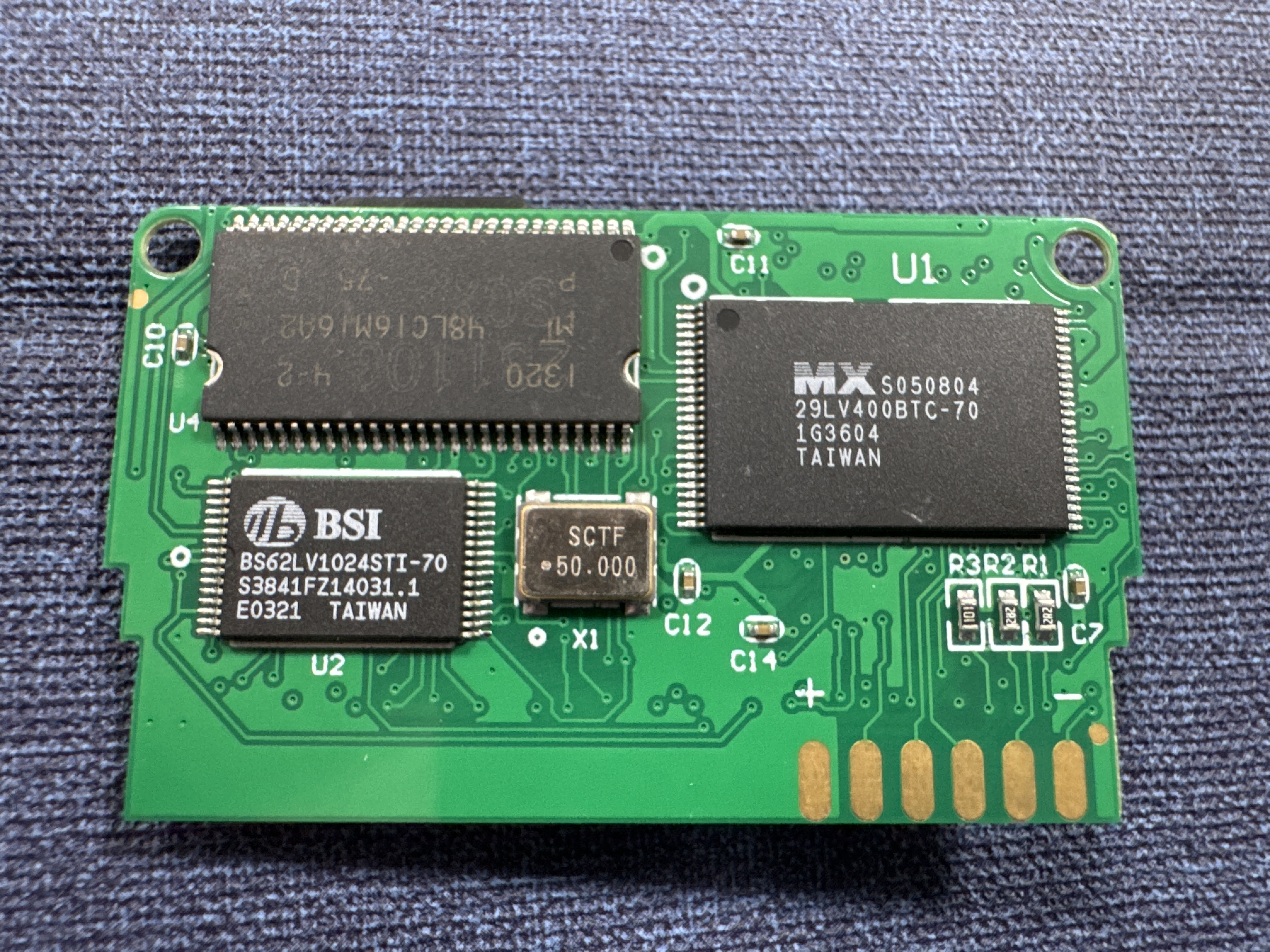

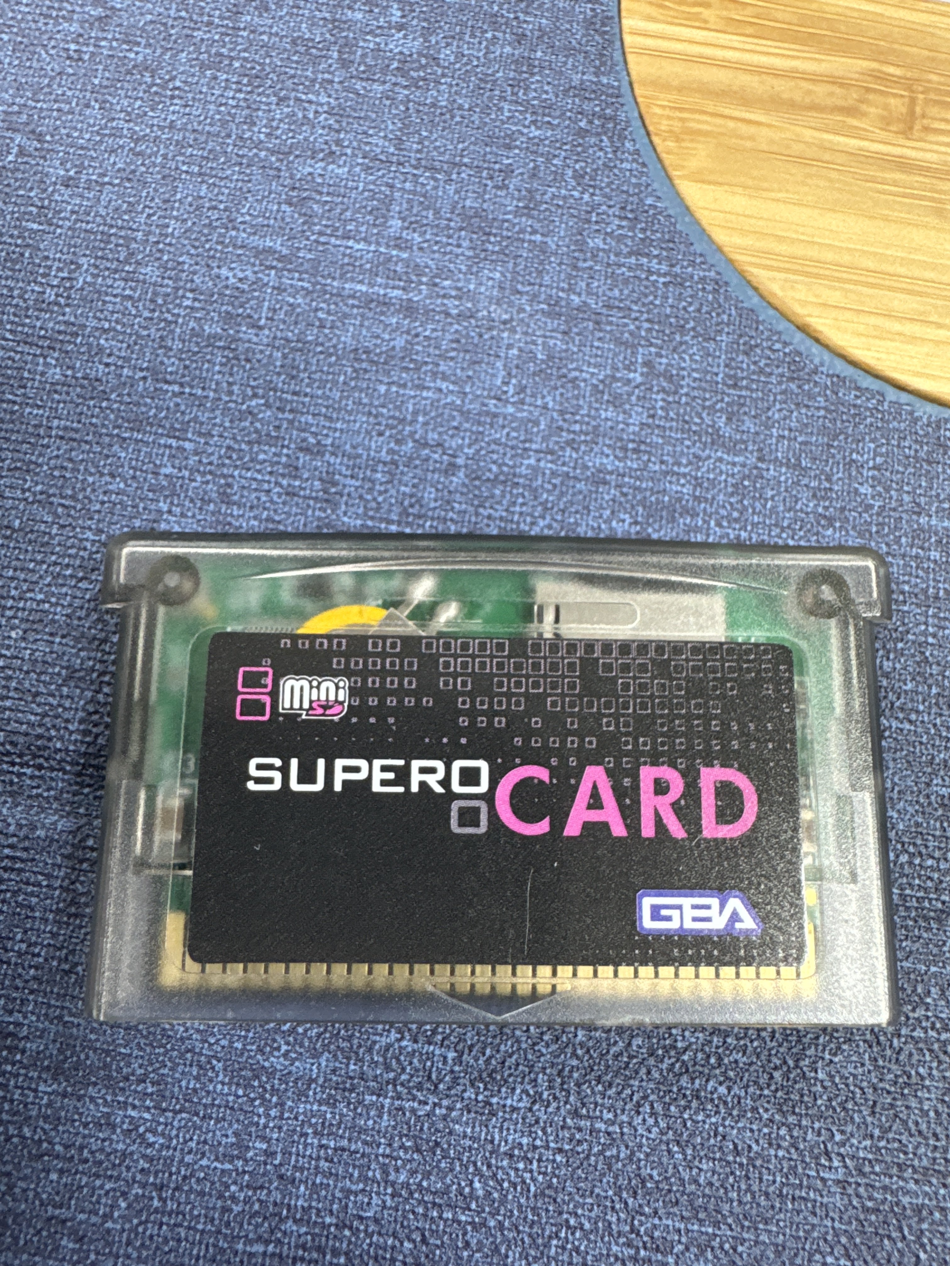

Do you have a picture of the back of the cartridge? It should be possible to look at the chips inside through the transparent shell.
So far I check that the flash ID exactly matches the one I have in my two Supercards, but I guess it would be fine to relax that rule a little bit.
Reactions: Expbot
