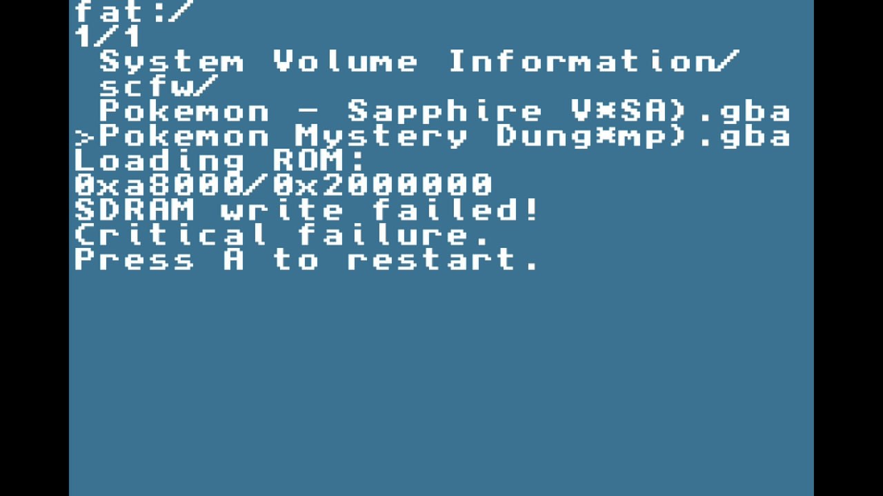

I attempted to use v0.3.1. I can load the kernel.gba but subsequent loading of any game results in SDRAM write failed critical failure
That sounds like a hardware fault. If you hold L+R with the original firmware while booting the cartridge, it should enter self-test mode. Then you can press A to test SDRAM.

I'll release a version which warns if any SDRAM errors take place but attempts to continue anyway. If it's only a couple bytes error, the game will probably still work.
yeah she goes nothing boots
I have released version 0.3.2 which will ignore but report SDRAM errors. Please let me know if this helps, how many SDRAM errors she gets, and whether games seem to play okay.

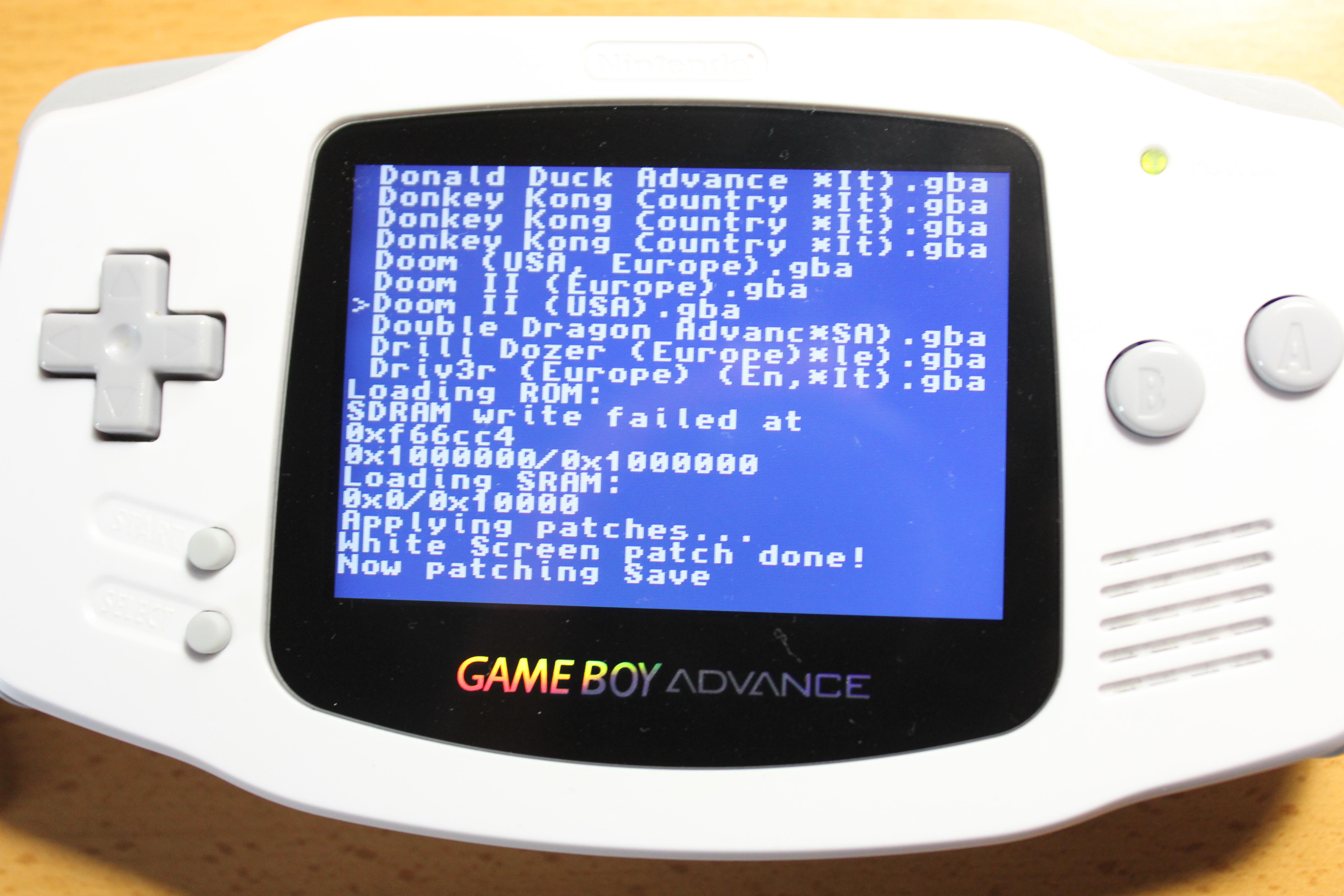

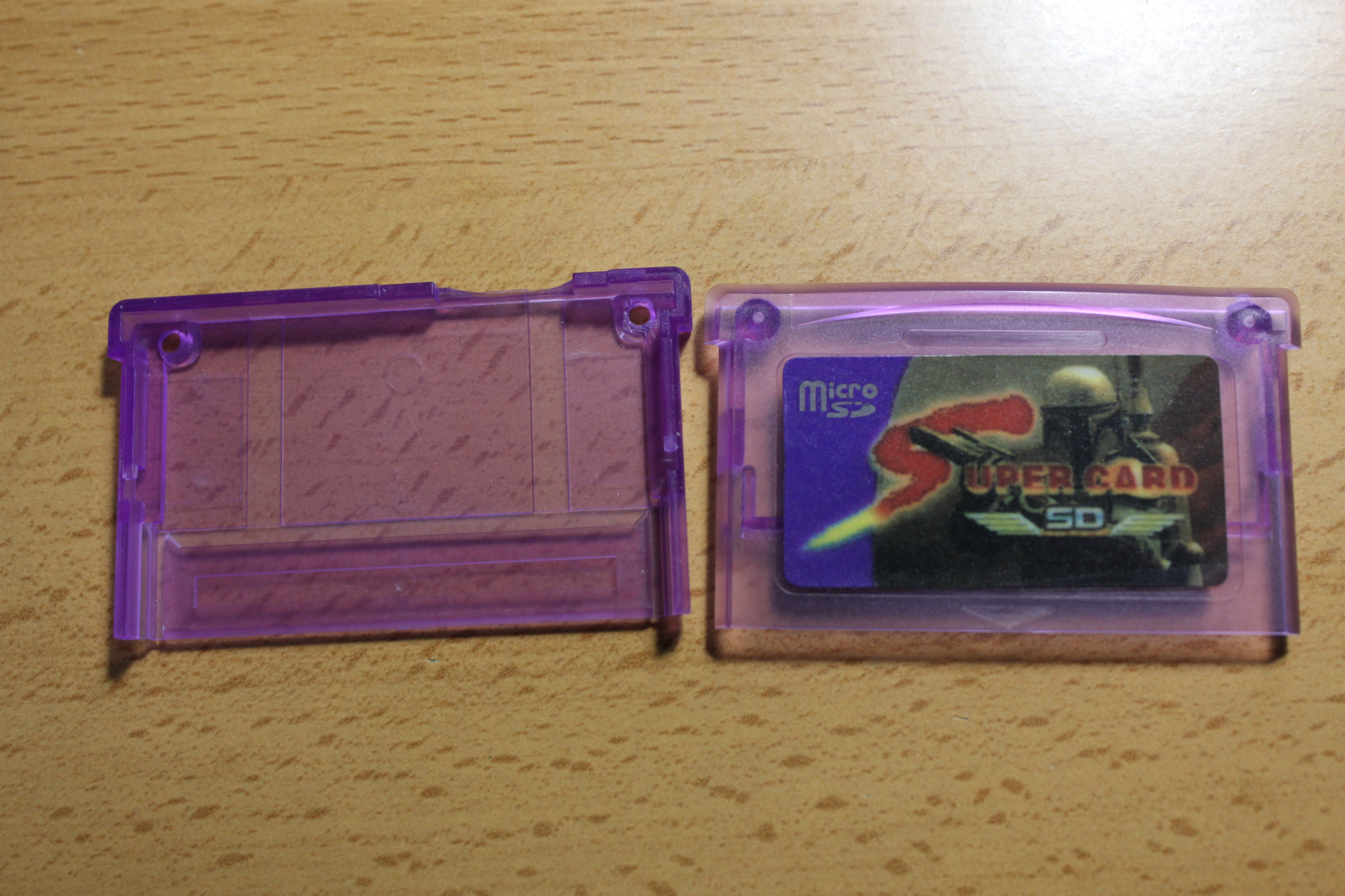

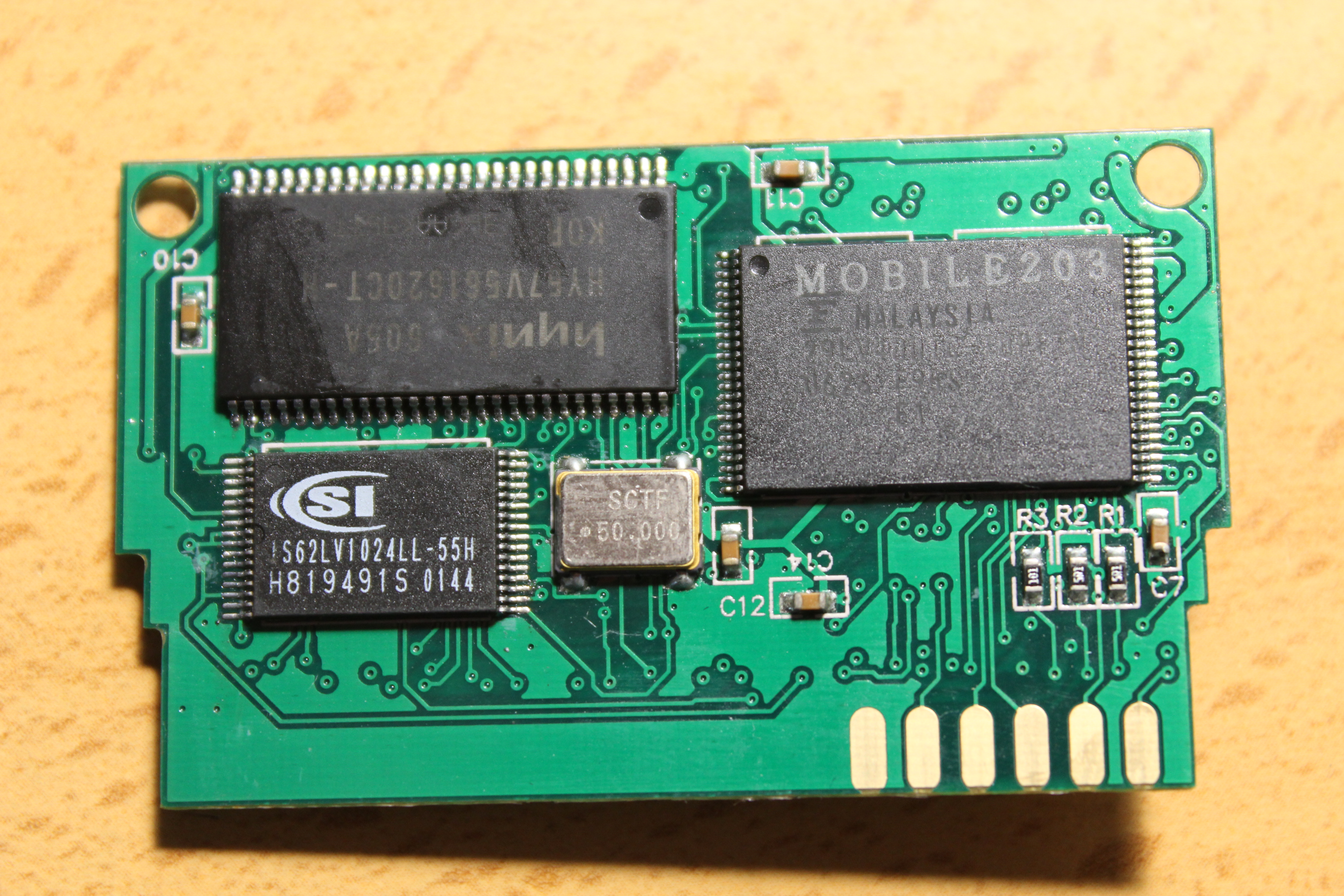

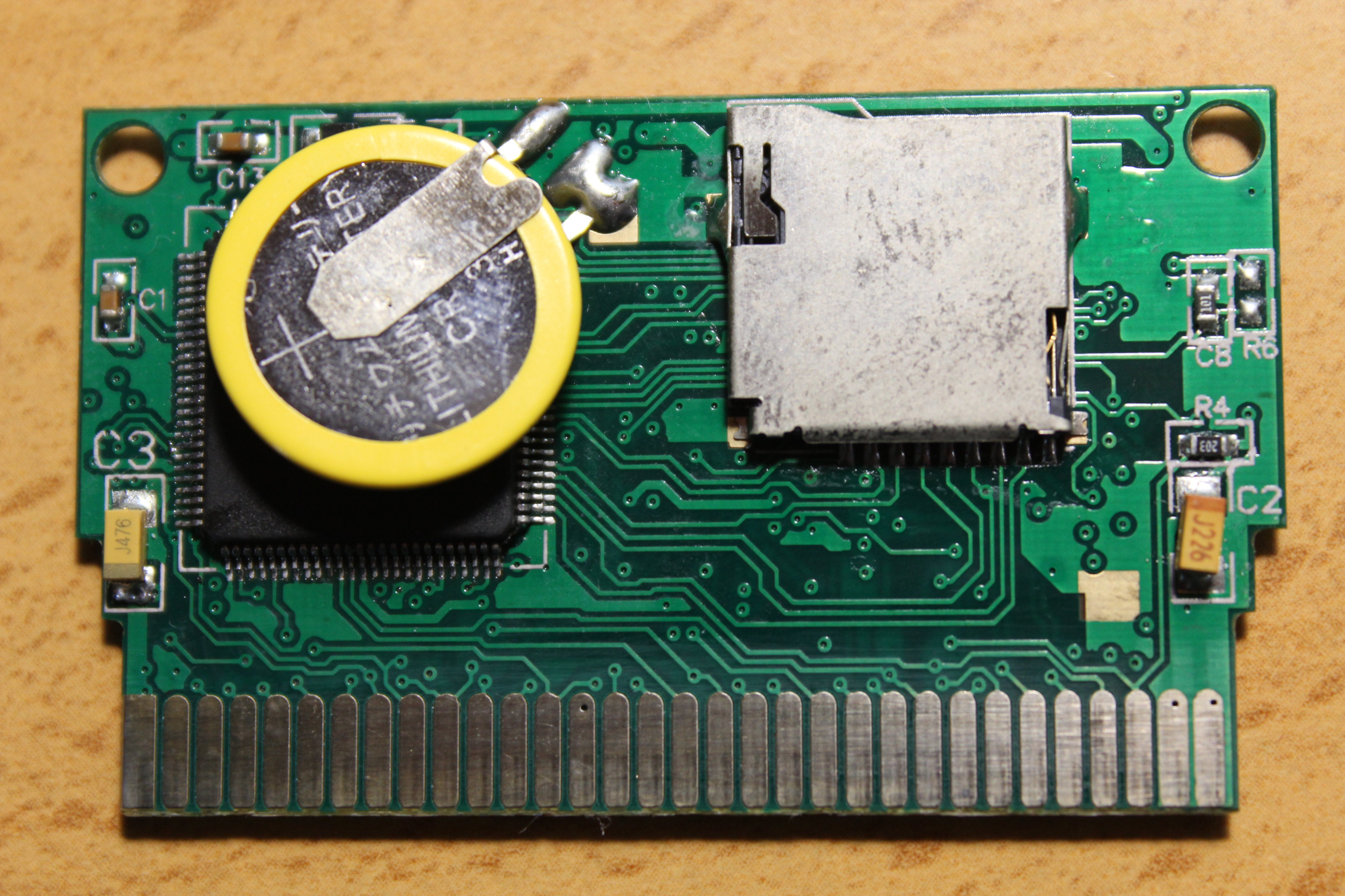

Which kind of Supercard miniSD are you trying, is it an original or one of the newer (possibly cloned?) ones with a microSD slot? Mine does not report those errors and it's one of the newer ones, I'll attach some photos of mine for reference.
EDIT:
I actually got an SDRAM error right now with Doom II, a bigger ROM. I tested again loading an smaller one and it didn't fail, the weird thing is that now Doom II doesn't give an error!

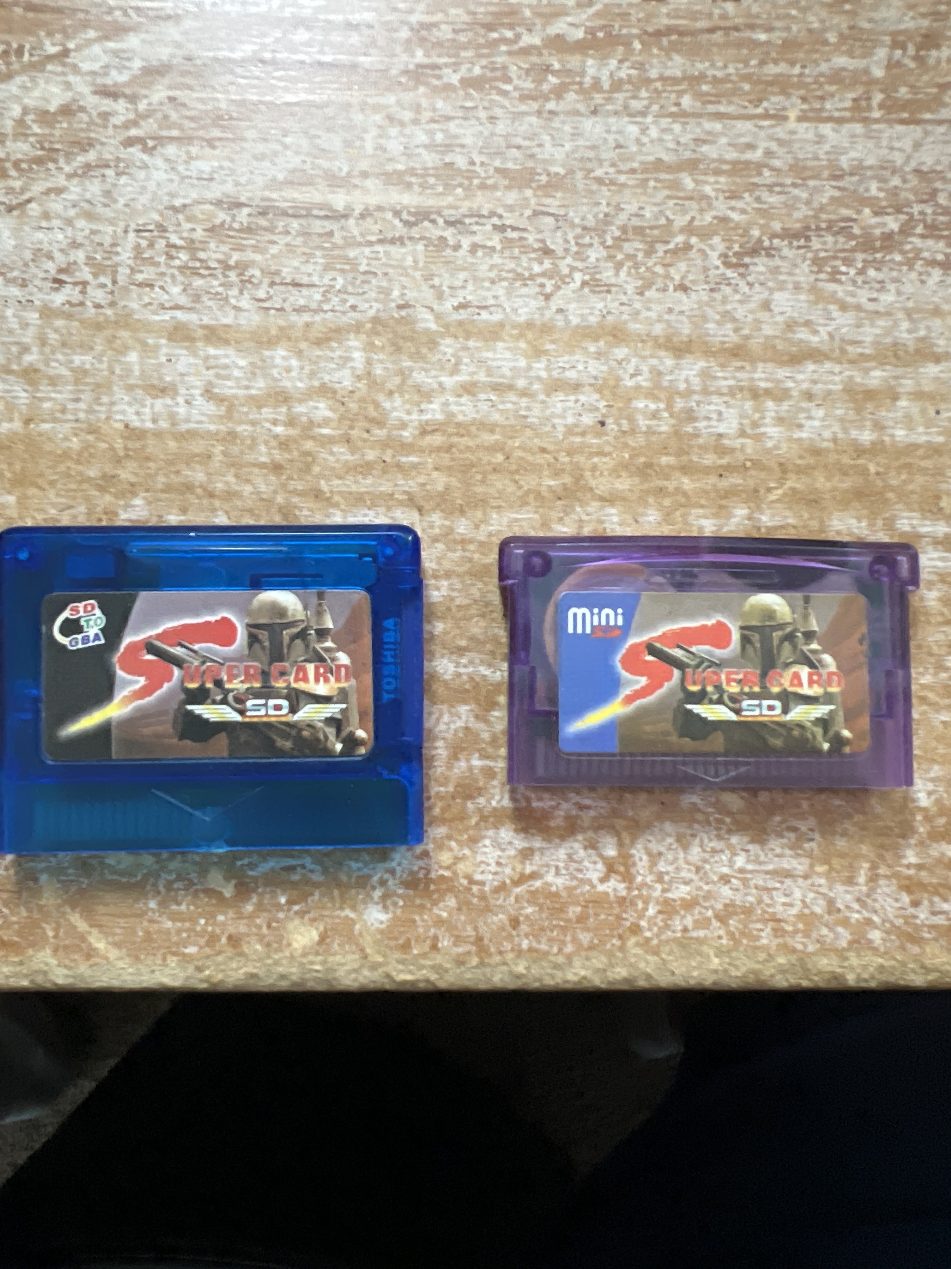

My Supercard SD is one of the original ones I got many years ago. I also have the larger Supercard SD (blue) that uses full size SD cards. Getting harder to find miniSD so I hope mine will last for awhile longer. Seems fine so far after format (1 GB size).
