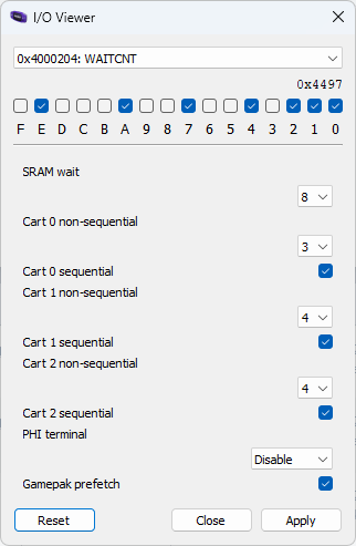

For the record, if you want to test what slowdowns will be like for a particular game, you don't need to use a Supercard. mGBA is an accurate emulator which emulates slowdown very similarly to real hardware. Using the IO viewer feature, you can easily modify the IO register which controls cartridge speed.
All retail GBA games will set Cart 0 non-sequential to 3, cart 0 sequential on, and gamepak prefetch on.
Supercard-patched games will run with cart 0 non-sequential 4, cart 0 sequntial off, and gamepak prefetch on if it has been prefetch-patched.

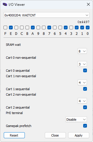

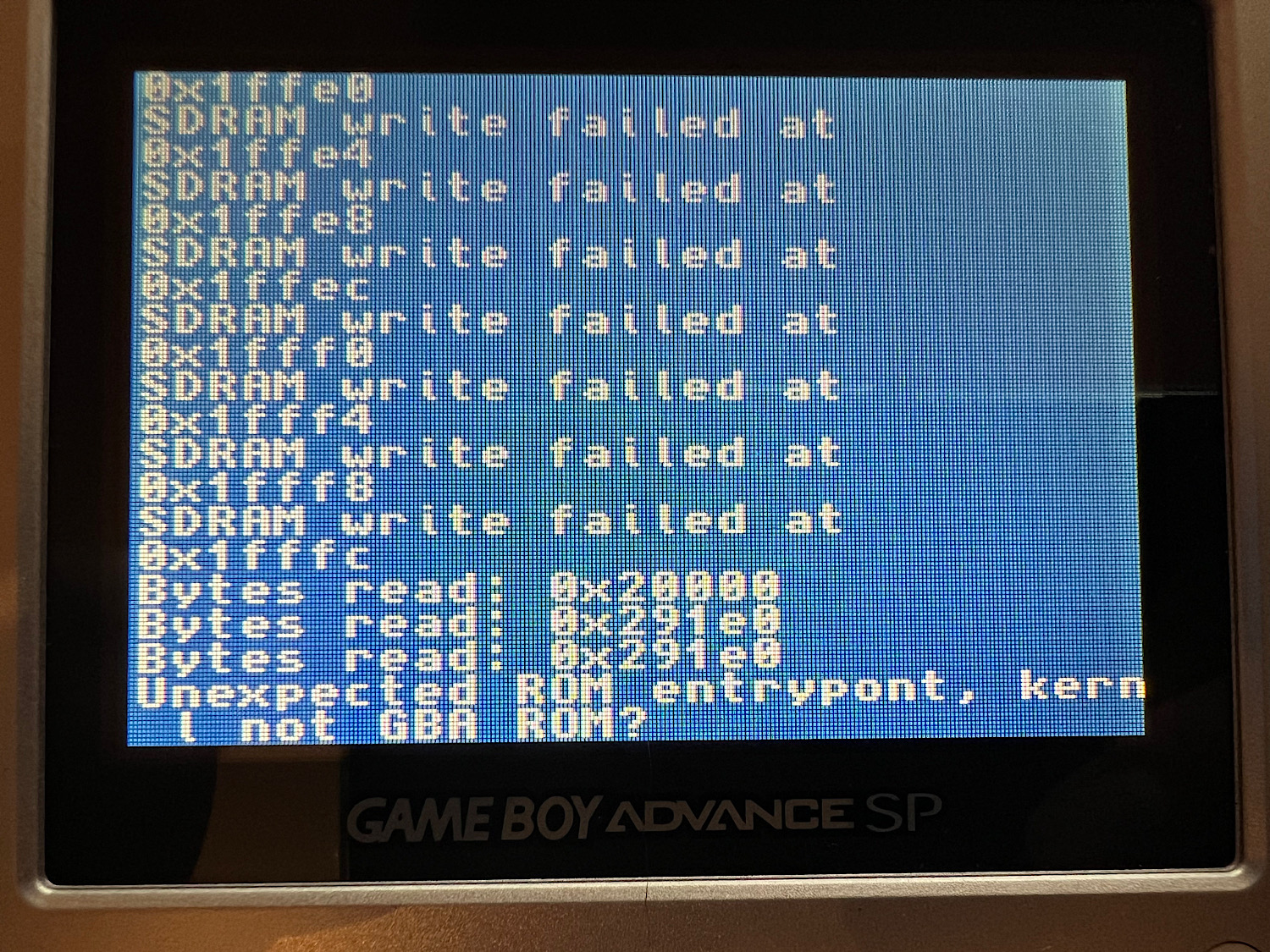

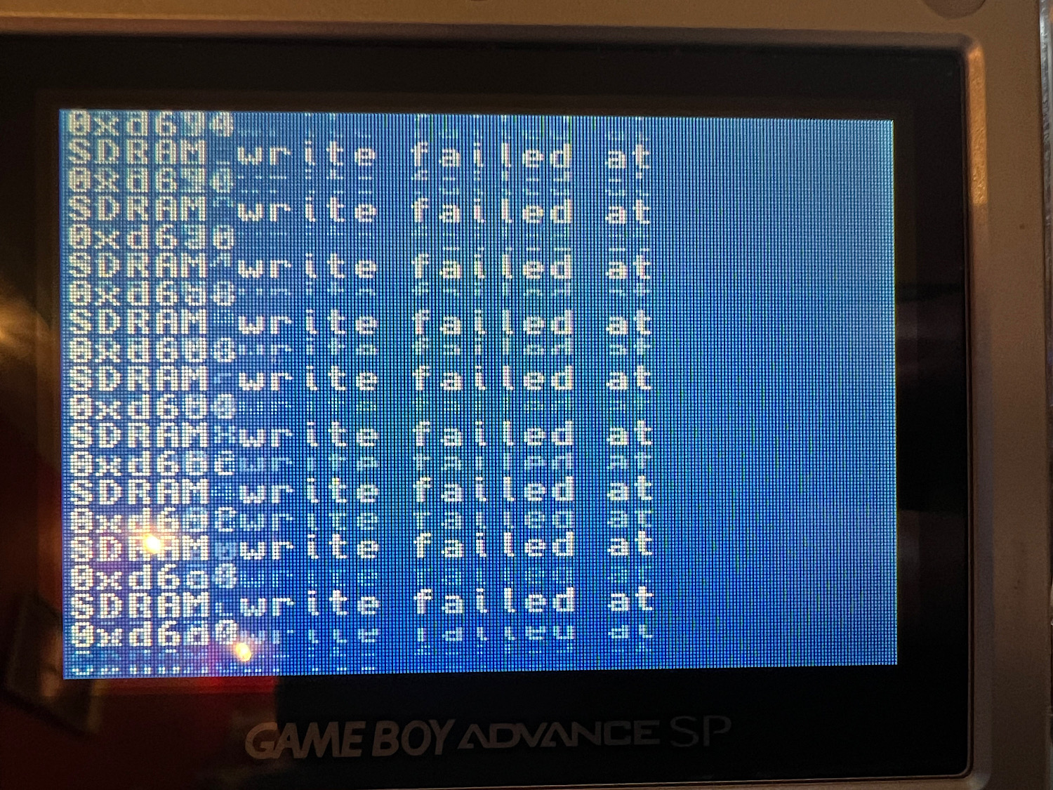

I've tried everything, doesn't want to work. After installing the firmware on the cartridge, the first boot allows you to start the game. But after rebooting the console, the firmware does not even start, only errors.
If you run the firmware from the original supercard menu, everything works perfectly. Checking the cartridge also does not show any errors.

It might help to clean the contacts of the supercard with IPA

you can restore the original firmware with flashmp and a Slot-1 flashcart
