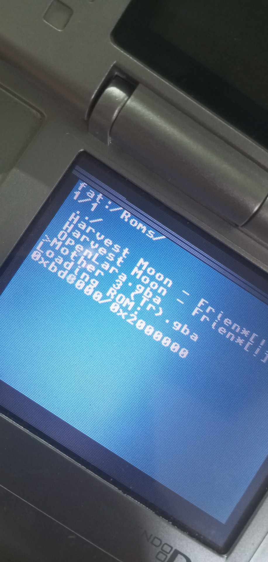

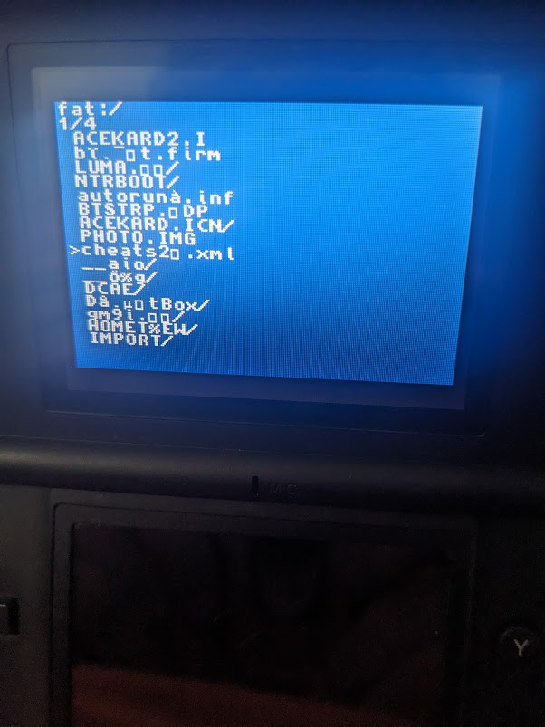

I get this if I boot the kernal gba rom as is:
Either it's showing a fully corrupted folder tree or fat init fails.
But the odd thing is it seems to work fine if I prepatch the kernal file with the SC PC software like the other games....
