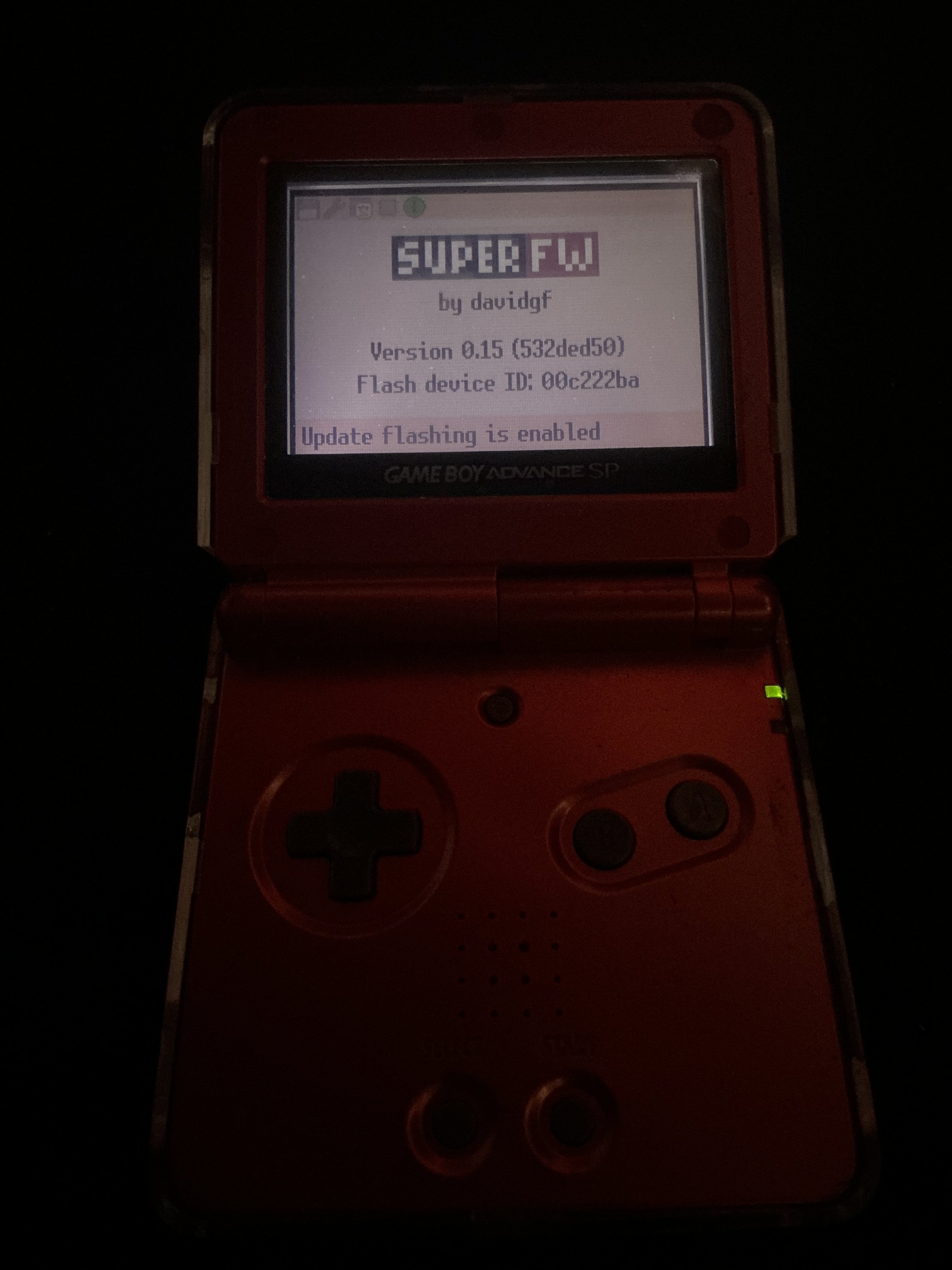

Following the identification guide in the super few thread I found out my cart is not on the list. I think. It said to look in the info tab and this is what I got:
I was really hoping to use the rtc function, am I sol? Or should I just try updating, and if so with the non-lite package, right?
Okay it has a flash dump feature. I’m going to try this on my sp. my ds isn’t reading my r4. The contacts are too thin. Can a mod merge this with the other thread. I’m pretty confident now it is the non lite variant because it is the same guy listed in the title screen. I’m going to flash it.

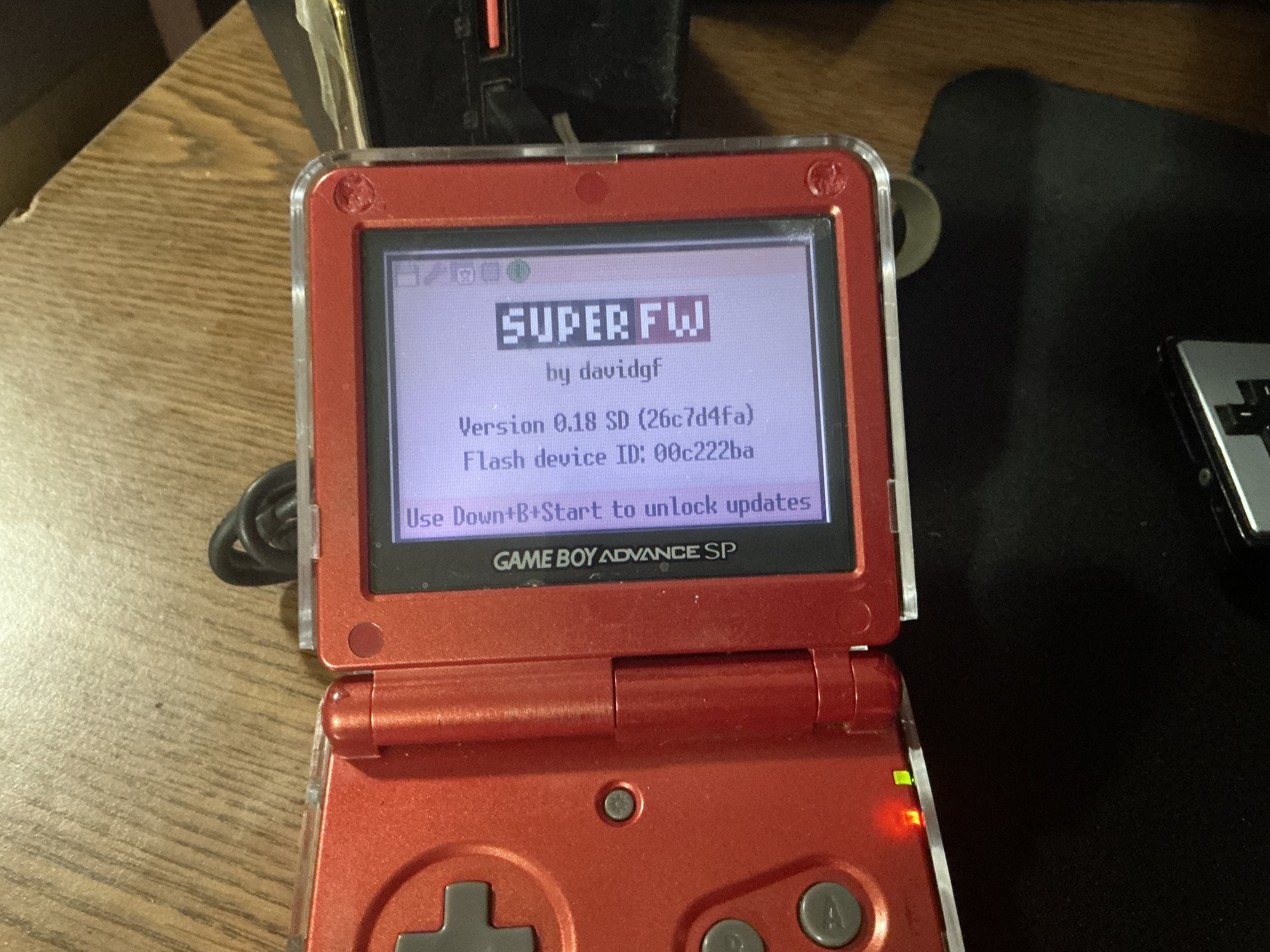

Aaand it worked, I’ve got access to to a fresh sd card. I’m hoping it all works now.
