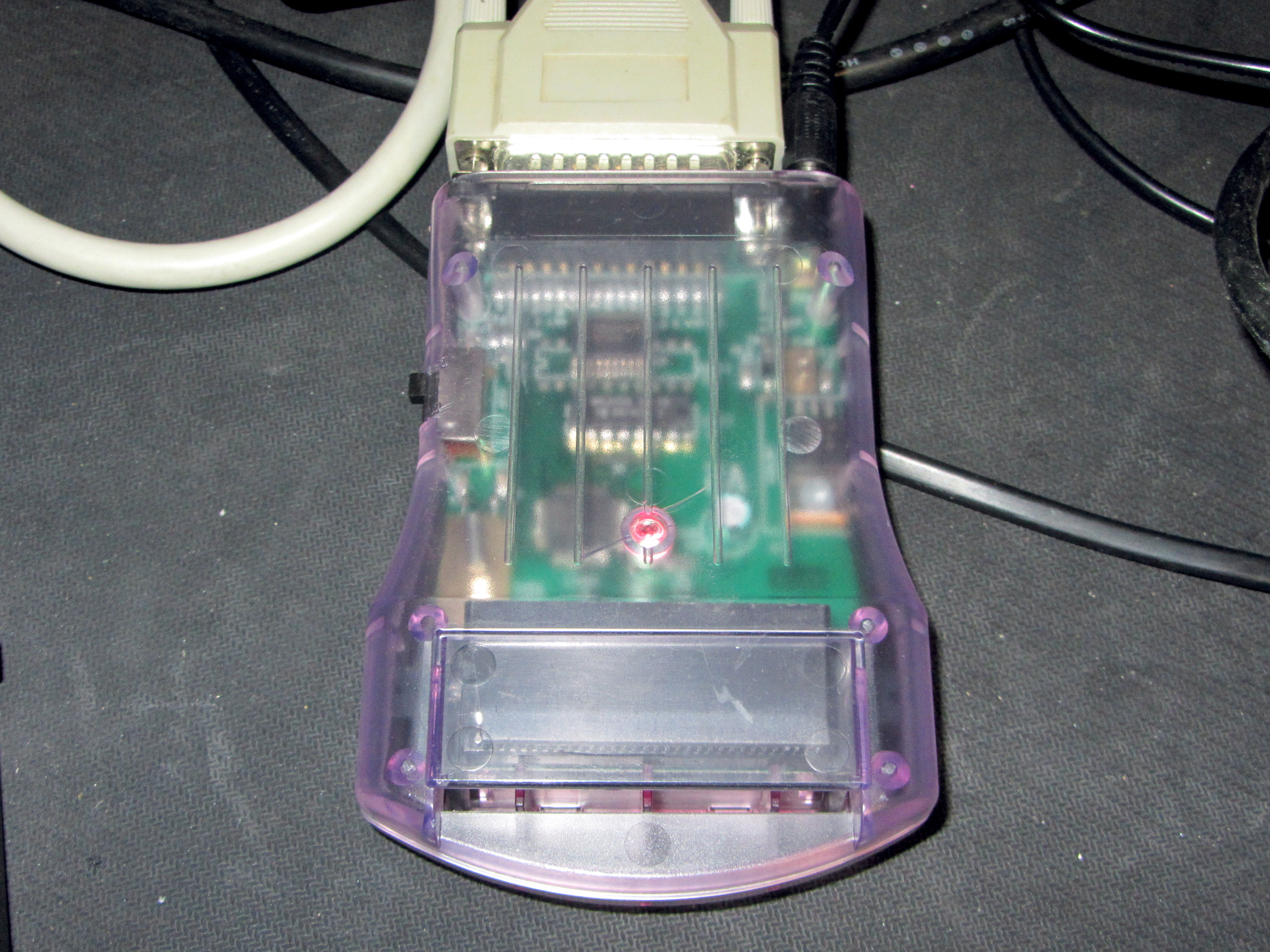

Anyway, I have a retro pc, all setup for it. I got a purple flash2advance FA linker with <1meter 25pinto25pin cable in my LPT (which is setup in bios EPP/SPP). And the right settings inside windows etc. All checked. It works and stuff. But it can not find my flashcard. It finds a mr.Flash 64M thought in the DBX max. But it does not find my flash2advance card. In the F2A3.1 writer software it says "Use portIO.dll".
Maybe the Flash writer itself is only for the GBX/GB/GBC and 64M flashcards for GBX?
And I miss the orignal Flash2Advance linker for Gameboy advance cards? I can not come to another conclusion?

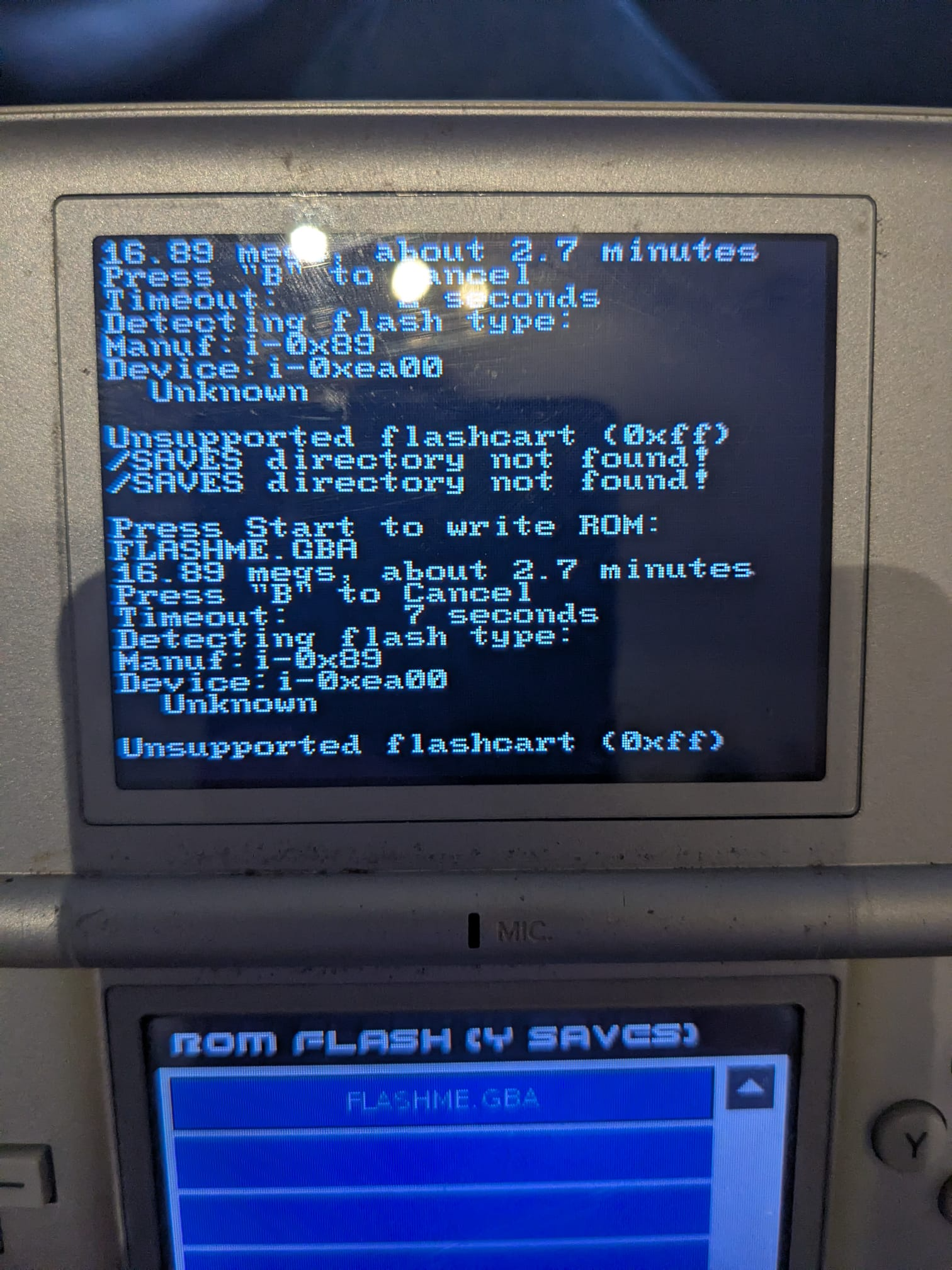

Anyway, I am now trying this guide. And it gives me this error:
Detecing Flash type:
Manuf: i-0x89
Device: i-0xea00
unknown
Unsupported flashcart (0xff)
Can someone please make a fix for the 128M flashcards?!
I tried both the 1.5 and 1.7 file. What am I doing wrong here?! I don't get it. Does it only work for 256M, and why not for 128M?
Thanks for helping out

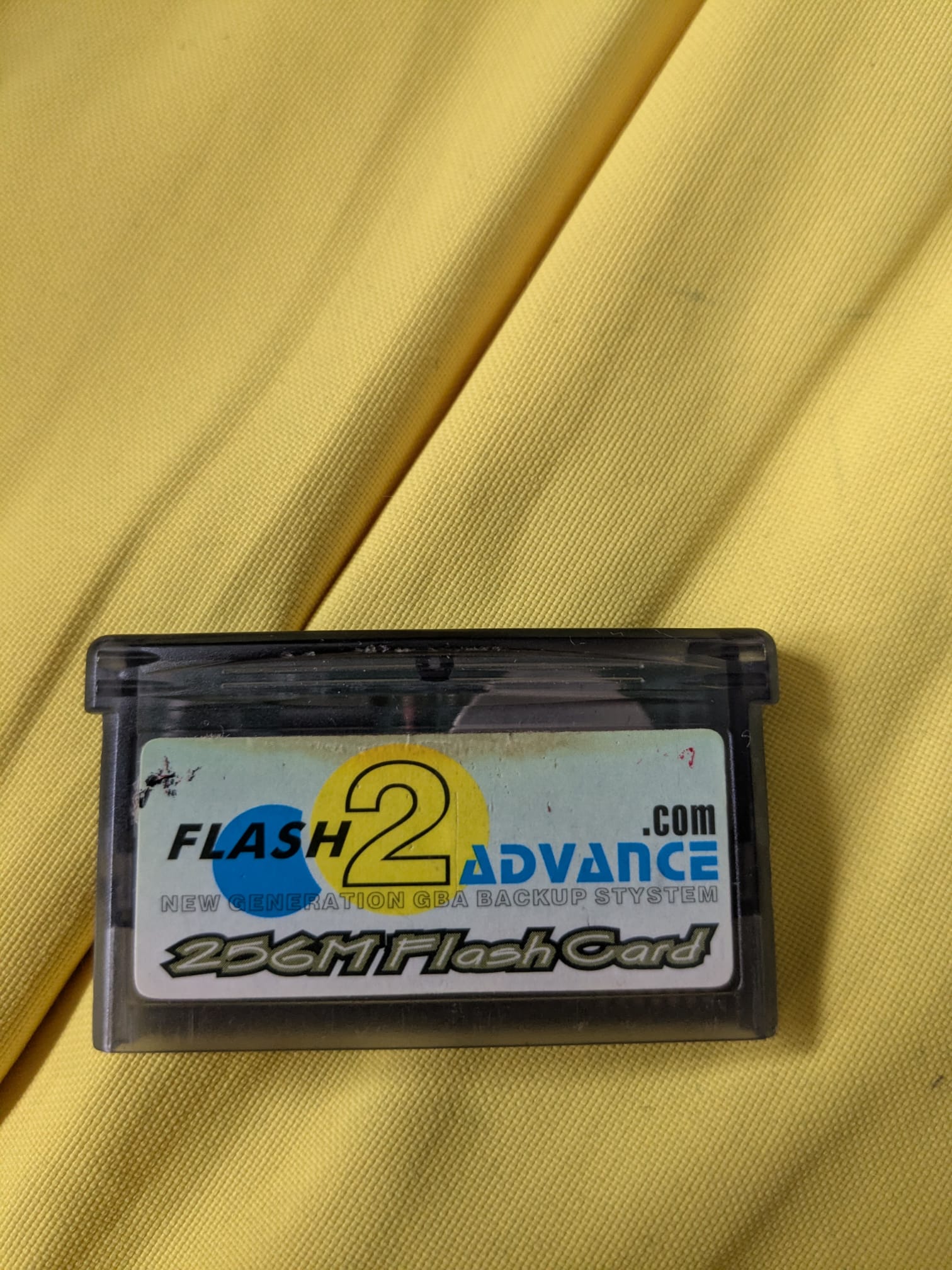

It gets more complicated now. I just bought a 256M Flash2Advance card. I bought one second hand. I just received it. Also with the blue and yellow letters saying Flash2Advance.com 256M. (the flashcard you picture in this forumthreat, exactly the same one)
Now I try this guide again, and it still fails. the same error. even with a 256M card.
But you really used this flashcard that is pictured in this forum topic right? the Flash2Advance 256M.

1. i put 4 .gba files inside the root directory of the Pogoshell. I let it create a flashme.gba. i put this in a GBA folder inside my R4 Revolution for DS R4DS card. I load up the FlashAdvance Slot1 Flasher v1.5 with game. loading up that file. i get in the menu. like the picture i send (you can see it right). then i get this same error again, like on the picture?
Tried it a 2nd time. All the steps , again. See image for the error message I get:
did you really try it with the flash2advance cards? because the original guide says it is not working with flash2advance cartridges. so this might be the problem.
yours say Turbo FA 256M . maybe you used a different flash card then mine?
the error is a little bit different now. but almost the same as the first one with the 128M.
the first image had this:
Manuf: i-0x89
Device: i-0xea00
and as you can see, it does say nothing about ManuF: or Device: instead you will see a unknown message only.
Do you have any other suggestions how to fix this?

Yes I am using the exact flash cart that is in the picture in the guide. What cart are you using for the DS Slot-1? Ive done this with DS Pico and R4.
I only get errors like you if DS doesnt see the Flash2Advance in slot-2, but taking it out and putting back in fixes that.

I think you are really lucky , that your Flash2Advance 256M card is showing the "Turbo FA 256M". Because it does not really work 100% it seems. I am the living example. lol
I don't know why you say "it works and stuff" when it's evidently not working?
I also don't know what "retro pc, all setup" is supposed to mean. Is it running Windows 98?

Ok, give this version that I just made a go. It should work. If it doesnt please tell me all the info you get on the screen.
I just compiled a new version of FAS adding support for Flash2Advance (at least my 256 Mbit version, I dont have any other to test on). If you have F2A carts that didnt work before please give it a whirl. If it errors out please provide output of the error, I put a bunch of debug info in there, hopefully it prints out and gives me enough info to add support.
https://www.mediafire.com/file/iepi0ss8x2syloe/FAS1Flasher_2026.5.20_by_Duxa.zip/file
Change log:
Compiled on 2026.5.20
Changes:
- Added Flash2Advance support
- Added forced flash option, when cart is 'Unknown' you may force to flash it as if it was Flash2Advance, Nintendo or Nintendo 256Mbit cart. This should help with flashing clone carts
- Added more useful debug for when things dont work. If asking for help please include it.
- Fixed some bugs, cleaned up code
Note: I only have Flash2Advance 256Mbit cart. So am unable to test on any other cart.
Change log:
Changes:
oke i give it a go. if i brick my card, i don't mind. because I still have another 256M and a 128M.
test
I have not tried this package on my "Flash Card 256M Advance" (Different Sticker from a Flash2Advancve, I think the same internals?) simply because I don't need it - I still have all of the tools in this package on my hard drive from decades ago, including pogoshell.
What I can tell you is that my specific version of the card had a translucent black writer, like this one. This is not my picture, but this is exactly the flasher/cart combo I have.
https://commons.wikimedia.org/wiki/...d_Flash_2_Advance_Linker_with_flash_carts.jpg
The purple writer you mention is most likely a Bung GB X-Changer/Mr.Flash flasher, a GB/GBC flashcart writer (I think there's identical variants with a different sticker too), which I also have and that's why I "recognized" it from your description - it's the same mold for the case:
https://gbatemp.net/attachments/img_0044_compressed-jpg.567766/
All of that information is available in https://gbasp.ru/historyofflash1-en.html and there used to be a good wiki with all of the variations, including pictures i sent, but I can't seem to find that anymore.
You most likely have a GB/GBC Flasher and are trying to use a GBA card in it - Which might be a problem, since GB/GBC carts run on 5volts and GBA carts run on 3.3 volts - if I remember correctly, you could damage your GBA flashcard if you popped it into a GBC flasher, but that could also just be a fairy tale.
Hopefully I can get a clone version of GBFlash off Aliexpress that's not an incomplete/earlier version someday - or that GBFlash is available in aliexpress (shipping and taxes wise). Being able to flash my Mr Flash64 again and my FLashAdvance without a DS would be fun.
I'm an idiot, the same place I can buy legit DSPicos and SuperChis on Aliexpress also sells legit GBFlashes.
yes, thank you for the heads up. 100% , mine is a GB/GBC Flasher. I keep trying but of course it does not find it. :) thank you.
