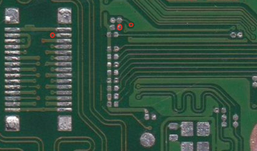

Hi guys, I bought a Nintendo switch V1 but it had a catch, the last owner tried to instal a pico fly, he didn't got to far since he ripped off the reset(rst) trace off the board, he didn't try to continue the installation, and the board is clear.
Since I got it I repaired the trace but didn't work, and I used a thicker wire to redo the trace and voilà is working!
At least was I thought... After a minute or so I went off, in order to turn it back on I have to remove the battery for a while and it's back on but still after a minute or so it goes off.(literaly working, i can open games and charge it while is on)
Any sugestions?
Is ther any point that it lead to on other part of the board so i can "bypass"?

make sure these 3 red circled have solid continuity to each other.
And also 4.7k ohm resistor on the line still have reading
