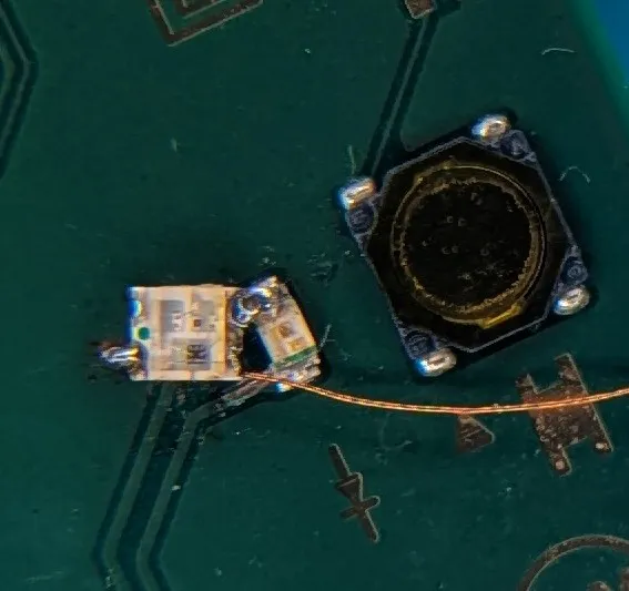

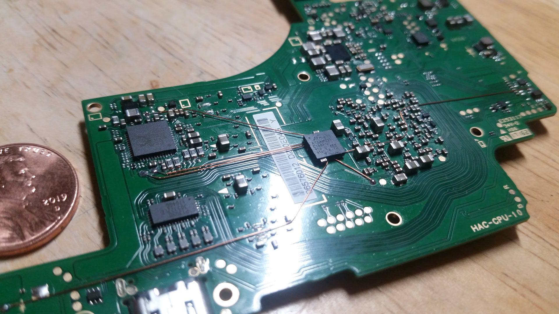

I have done internal trinket installs for the v1, haven't done any in ages due to the picofly but I quite like them as you can get them down to just the atsamd21 itself and a couple of capacitors. a fun and clean install imo
(old image from.. 2019, wow)
This is a piece of art.

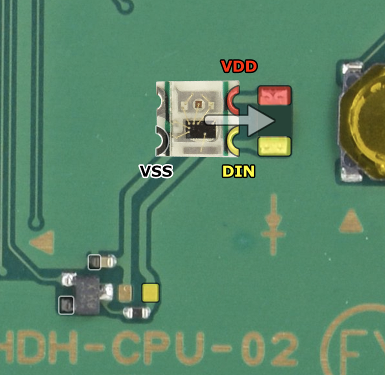

I’ve already unlocked some V1 and V2 models, but never the OLED or Lite versions. My question is more about the PicoFly LED mod, so that it blinks when powering on and indicates at the front of the device, as shown by user vulp_vibes (by the way, thanks for sharing the knowledge!). I found this feature very functional. From what I understand, I will need an specific LED and a wire to connect the PicoFly point to the VSS on the new LED, replacing the original one. Could I use the LED that comes with the PicoFly itself?

if you have a hot air station to remove it, yes, you can use the existing LED; that is what I did with my RP2040-zero installs. if not reusing it, you will need a ws2812b or sk6812 2020 (2x2mm) led. the line connected from the picofly to the LED is DIN, or the LED data signal line. the existing LED for the lite's home button is removed, and the picofly's LED is soldered in its place, to supply it with 3.3V and repurpose the other pad as a breakout for the DIN connection. an additional wire for VSS (ground) will need to be connected to the LED as well. I will repost the diagram I made for the lite here (though I would now recommend just soldering to the exposed gold areas on the ground plane instead of directly to a component as to avoid potentially damaging them).
I also found this alternative method posted by another user that is non-destructive to the original home button LED and only requires the DIN wire, though it appears to require scratching the solder mask to expose an area of the ground plane.

Great, appreciate it! Now I get the installation way better! :D:D
I can also use a low-melting solder, known here as 'chip saver,' precisely to avoid damaging the LED with high temperature. Anyway, I’ll give it a try this weekend and share the result.

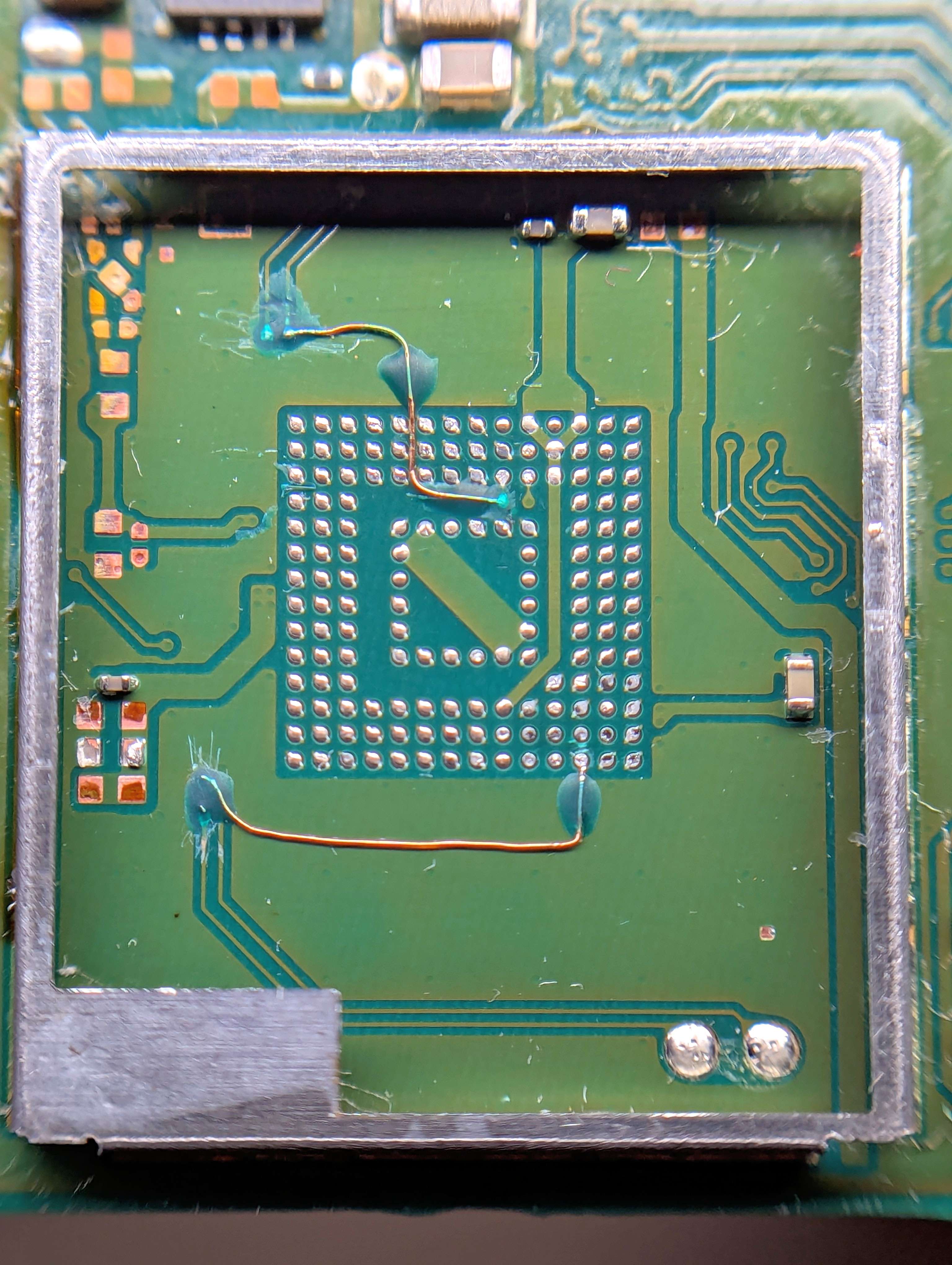

workshopping repurposing the display driver test pads as breakouts for clk and dat0; testing the wiring on a parts board first but I think it may work (all of the pads that the clk wire routes through are not connected)

Your idea should work as I recall seeing it before.
But aren't those wires way too thick for the eMMC BGA balls to connect to the board?

it's possible that the wire could cause issue, though it can fit beneath an already installed emmc, and I made sure to keep both the wire and uv mask as flush to the board as possible. I will be testing it tomorrow on one of the kamikaze boards I recovered, so we will see if it works out

The concept is indeed very interesting. Nevertheless, could there be a risk that, when reinstalling the eMMC, the solder might strip the enamel from the wire and potentially cause damage to the device or the memory module? If the procedure proves successful, it will be remarkable, and I sincerely hope for a positive outcome.
