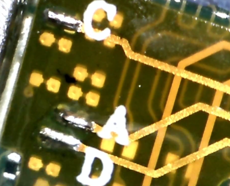

C/D/A:

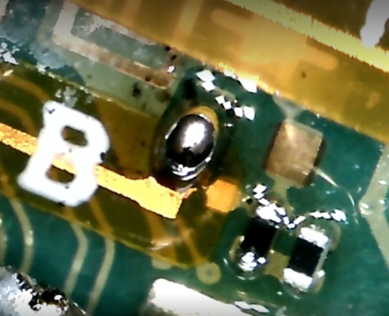

B (Again, a bit too much solder, but that shouldn't cause problems):
For the record, I never left my iron at these points for too long (especially the SP caps) to avoid burning anything out. My iron was at 310 and I used 60/40 solder with Chip Quik SMD flux.

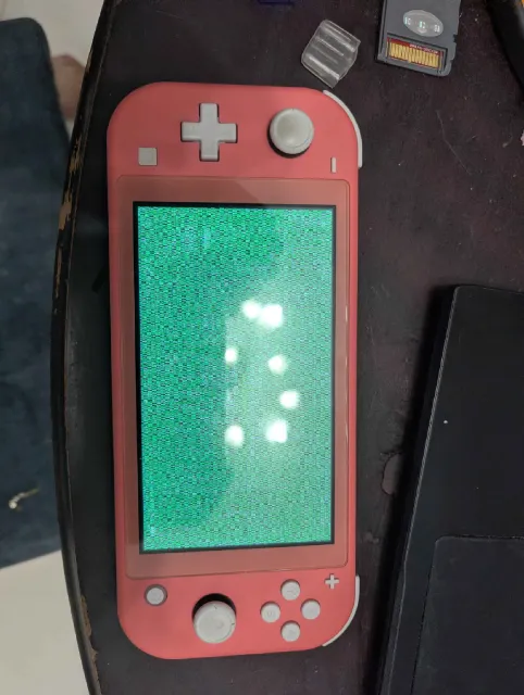

The install works and the Picofly succesfully glitches the Switch. But the Lite never stays running for long. After a while, seemingly at random, it freezes. It sometimes freezes silently. Other times, in a more noisy way—the speaker buzzes and the screen is pixelated and green.

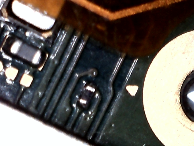

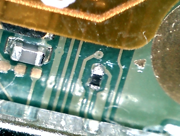

The only thing that, I think, I did wrong during the install is I accidentally left blobs of solder on two resistors. I cleaned up the mess but it is possible their values have been thrown off and this is what causes the freezing. One of those resistors is visible in the B picture. It's value is 8.21k.
The other one is this one. it's value is 100 ohms:
If anyone knows what the value of these resistors are (or has some kind of board they can probe to test), that would be massively appreciated.

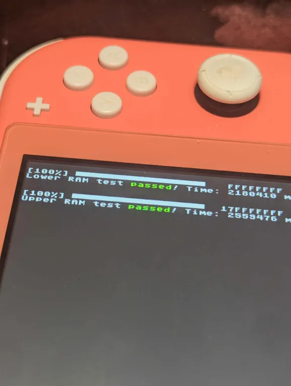

  • It completed a "slow" RAM test with a Hekate ram test payload someone gave me from the NH discord server.

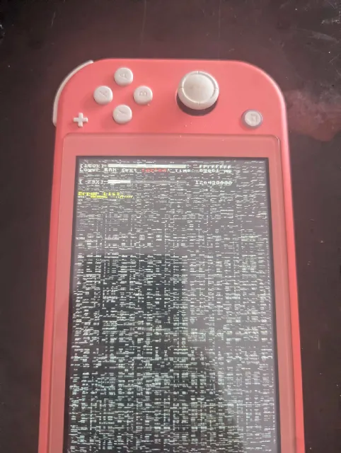

  • The next day, it failed the RAM test, and a bunch of "TV snow" artifacts came up during the test. But even though those appeared, the console didn't crash. It kept doing the RAM test—showing errors this time.
So, overall, the console works. But, at random, sometimes with an hour between power ons, it entered this broken state. I find it really interesting that it completed a slow RAM test one day (ran fine for a whole hour) and failed the fast one the next day very swiftly.

To me, it looks like instability because of a bad component. Not anything major like the APU or RAM though. Those resistors I accidentally touched with the iron could have gone bad and be responsible for this oddity. I'm not sure what they are.
The help which I need
Right now, if anyone can tell me what the values of the resistors I posted on the pictures are, that would be massively appreciated. If it isn't them, I at least know where to focus my attention next. I don't think this console is a goner since it does actually work.

(Crash inside Horizon OS)
(Failed RAM test and weird artefacts (menu still controllable!)
