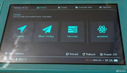

Got this offer on a local craiglist:
The seller says it's a new RP2040 Picofly based version modchip for Switch Lite and Oled, only.
What do you think about it, looks like it's a clearly fake, am I right?.. Or not?

They named it PicoFly while obviously this is not Pico but Zero.
Was theoretized that it has too slow bus to be a glitching modchip. So I am very sceptical it's legit.
Providing uncutted video would be helpful.
Beside instalation looks like fire hazard on this pic. Curious if they even provide full instructions instead of just "solder here and here" and figure out mounting yourself.
I've never heard of an RP2040 modchip appearing in the wild, and I can't find any information about it. I'm also kind of skeptical if this thing is going to be safe. I mean, looking at the photo of how it is soldered into place, it looks crudely done to the point that something could shorten. They should've just given you a diagram that tells you how to do it yourself. It also looks like this chip doesn't have any proper circuit protection even, so that can lead even to a potential hazard in many cases.

Everything about Craigslist is shady.
It could be just a proof-of-concept, that's what I'm thinking.
Glitching Mariko with a rp2040 is definitely possible, I know several people have done it. Why would someone build a custom board and then sell it on Craigslist instead of mass producing it and selling it on AliExpress though? It makes no sense. If someone just did it for fun, which I know some people have, then why sell it at all? Either they want money or they don't. Selling a single one and no more is stupid.
They could've just made the project open-source on GitHub so that it can be mass produced.
EDIT: Warning! The pics have "Avito" on them. That's a Russian Craigslist. So stolen pics?

The only theory I can have is this is for a v1 switch basically. Just auto-injecting the rcm payload and pressing the buttons.
I was thinking that as well, but the bend in the heat pipe is straight on a V1 in that location so it’s definitely not installed on a V1.

It seems fake to me. I mean, you need 1v8 logic to Interface with the emmc. And rpi runs at 3v3. I don’t see level shifter on the board.
The wiring of the cpu flex is cringeworthy but could probably work. (If it were legit)
Even if it works, I’d give it 80% probability it can’t flash the emmc with the custom boot code.
Edited: RCM chip doesn’t make sense, as no usb.
Honestly, it’s weird. More info and/or uncut video of this thing booting, or it didn’t happen. ;)
