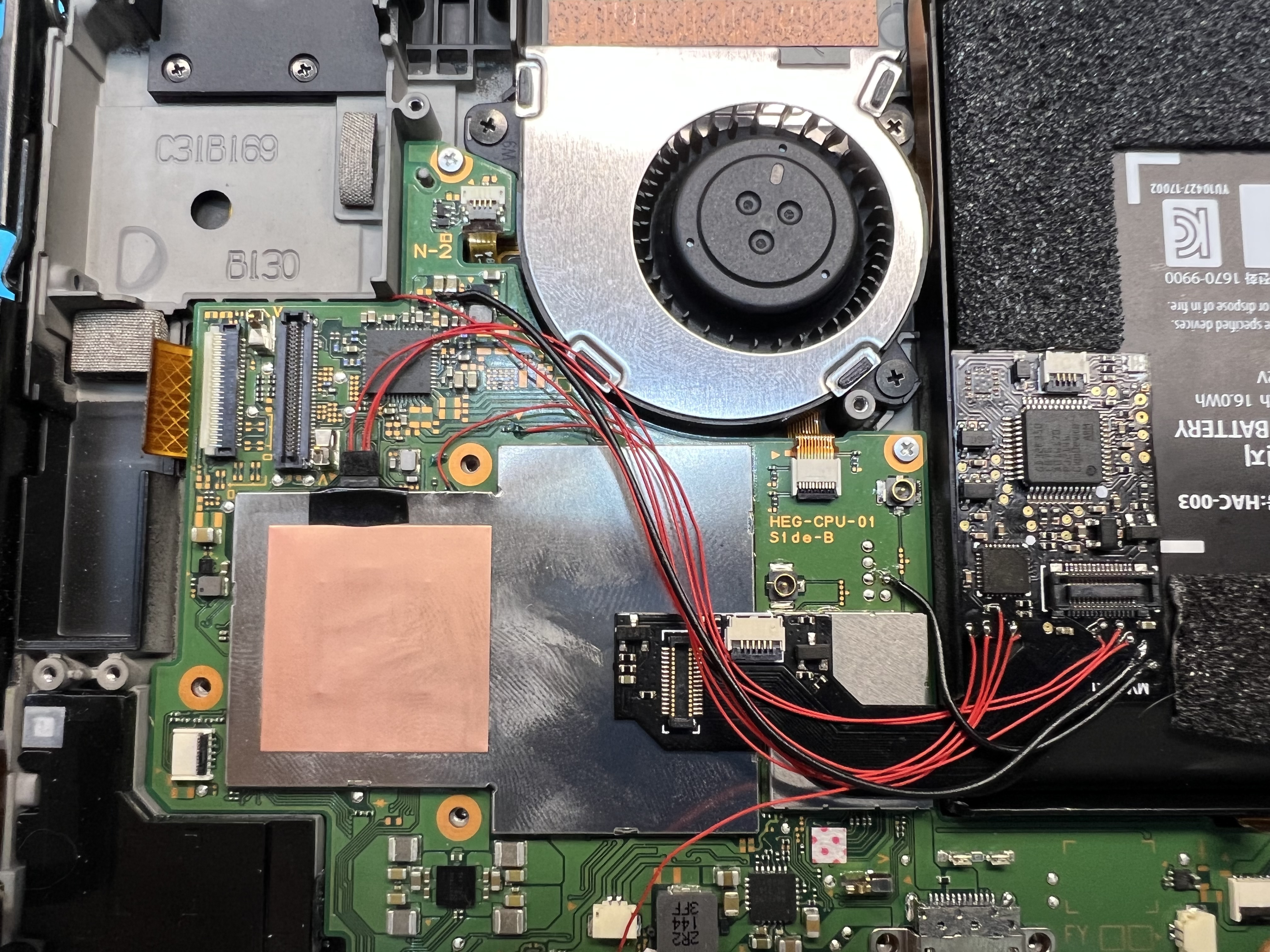

Same problem here. Flashed .uf2 (1.1 unlocked Ubuntu one), soldered all points correctly to switch lite… aaaaand yellow led at the end :(. Tried several times, several rp2040, with and without resistors (0806 smd 47ohm) same thing. Used np2016dr mosfet (taken from hwfly V2 flex) - soldered with enameled magnet wires according to the diagram provided - no hekate, just a black screen with no backlight. With hwfly V2 flex and hwfly lite flex - ALL the same yellow led at the end of chip working :(. After all, I’ve soldered the same wires directly to hwfly lite chip and it all worked like a charm (so it is not the soldering problems :(((

Have you got a photo of your wiring and solder joints?

Unfortunately no, I’ve done that install just to test current implementation of rp2040. I’ve done maaany OLEDs for now, so it was caused not from the lack of skills, believe me :)
Once I’ve had to install several V2 hwfly to oled and that was the tricky moment, because there were no diagram for newly hwfly v4 and a slight trouble with fitting V2 chip to oled case, but I’ve managed with it.

Reduce your wire length by about 75% and check your solder joints. That will fix your issue.
Bro... Your wires are way too long. Are you trying to reach the moon.

Are your wires on your rp2040 as long as the wires in the photo above? If yes this could be the big problem. Please also measure your connections using a multimeter!
