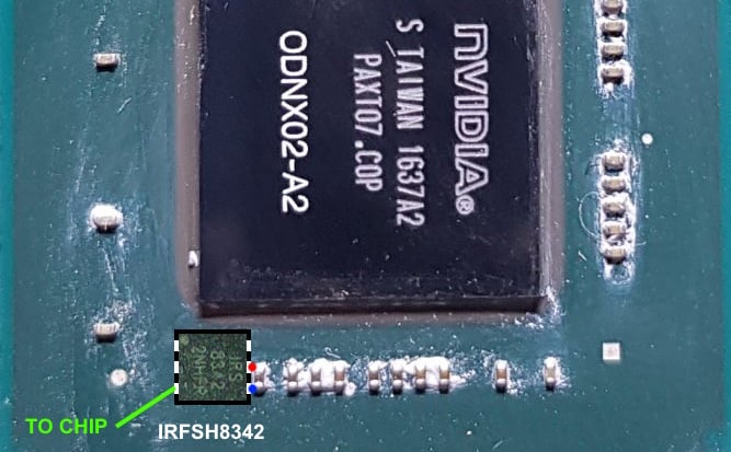

I have a boot0 from a pikofly console and I can confirm that the bct normal and safe are modified (the backup ones no) Probably that is the reason because is not possible to launch HOS.
oh cool! saw that but thought it might be too sketchy for me, does this also apply to that dat0 port?

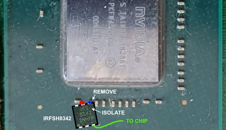

Those are are just the V1 and V2 solder points in lieu of the chip flex cable. If you’re doing an OLED you should probably buy the DAT0 cable. They are tricky enough to get right as is. I‘m sure some folks on this thread could make it work with just a wire but if you were one of them you wouldn’t be asking the question, so buy the DAT0. :-)

thank you! got a switch lite that I have abandoned due to the steam deck that would be perfect for this, need to get a pinecil and work my way up to the switch

Mine does blue > brighter blue (very brief) > white > green
I'll touch up my CPU points.
that sounds right to be honest
is it showing the no sd card screen once it has gone green?
Nope, black screen. I'm not convinced the console isn't just faulty, might have to try with a known working console. Was hoping this one had just bricked itself instead of having a hard fault. I'll investigate it's power delivery, MAX77812 is getting a little warm. It will pink screen without the chip installed.
