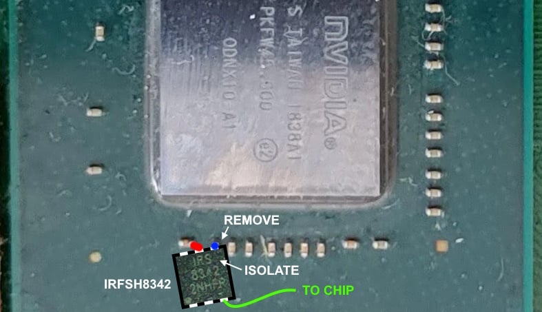

is someone can confirm the point is ok for erista and mariko flex.
I use the diagram for flex lite to do this picture.
But I have no flex lite, so I can't make a continuity test for to be sure.

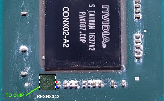

You should be able to do a continuity test using the legs of the mosfet, no?
similar to the pics for V1 and V2 in this post:
https://gbatemp.net/threads/pikofly-a-probably-fake-hwfly-modchips-or-not.622701/post-10066639
V1
V2
you dont need to actually remove it if you run jumper wire from mosfet to top pad of the cap right?
Correct. It’s not removed when using the HWFLY flex cable. They are simply getting the components as close to the caps as possible. You could introduce jumpers for more clearance. I would secure it somehow as you don’t want things flopping around in there.
