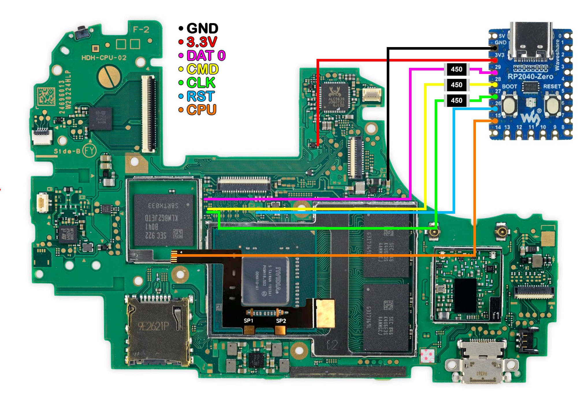

You are probably better waiting for this to be cracked, then a new board will be released with resistors + flex cable points added. Once all the testing is completed and this thing is able to run homebrew properly, it's easy to make a modded board or even a board addon to include those extra components needed to make life easier.
already ordered couple mosfets from ebay, hope we can use original rpi pico instead of rp2040 mini
what resistors are we using? and where can I buy those resistors and the flex cable?
47 ohm you need 3, get smd ideally probably 1206 is the best size for this but I haven't acctually checked so don't quote me on that and cpu flex can be ordered from Ali express

I have many flex, so for erista motherboard it s the same pin to solder to the flex ? Because this flex on the picture is for Mariko. And I don't have HWFLY LITE for verify myself
