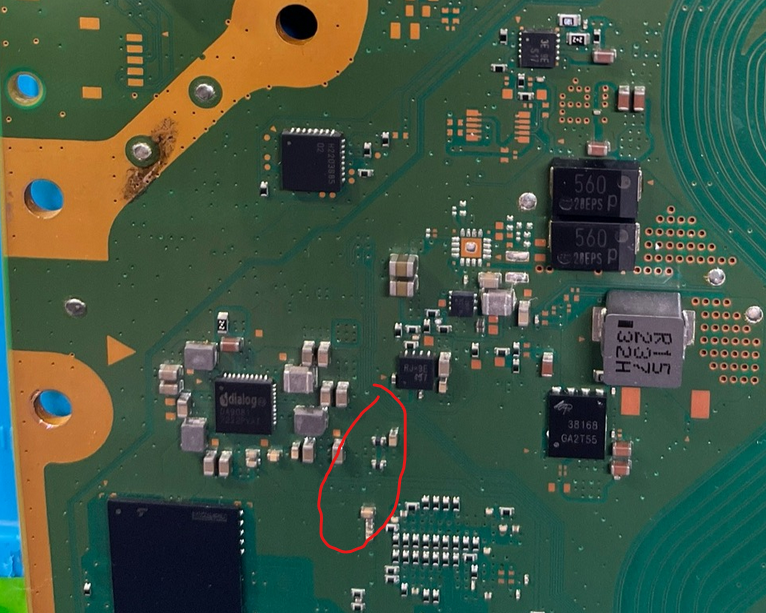

Hi everyone,
I’m repairing a PS5 Fat EDM‑033 that shows UART error 80870003 (SSD controller boot failed).
After checking the board,
I discovered that two capacitors and two resistors are missing near the SSD controller / PMIC area.
Could someone with an EDM‑033 board provide me the values of the missing components?
This would help me restore the board properly.
Thanks a lot !

I Desoldered them for you to measure, the capacitor shows as 11.6µF the resistors both show at 0.5Ω but my multimeter doesn't show milliOhm so i don't know how accurate it is
The orange marked components are both 0402' EMI ferrit bean 0µH and
the blue marked component is a cap 0402' 10µF X5R 6.3V
