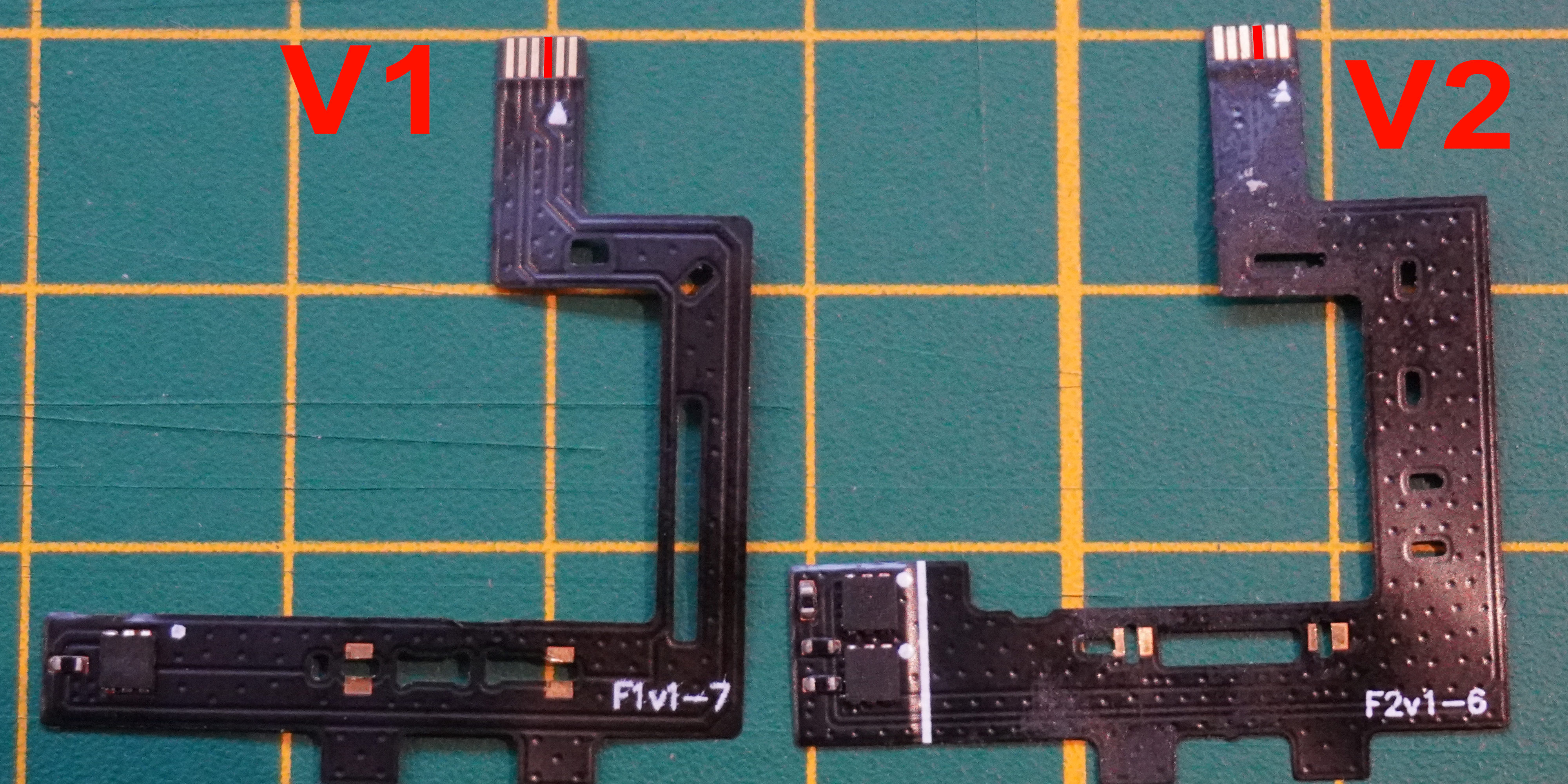

there are no difference in flex for v2, lite, oled.
The components are the same, but the termination end is different between all three.
