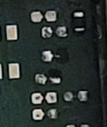

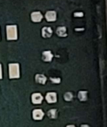

genuine question...how did you manage to do this...had you attached a wire and accidently tugged it forcing the pad off...or did it happen during soldering?

I see tinned pads that don't need to be tinned, so right off the bat their tip and solder are probably too large. I don't see flux either, but could have been cleaned off (or no-clean). Pads can usually take a decent tug, as long as you don't overheat them or use too large of wire- I recommend 40AWG for this size of work as it'll almost always be weaker than whatever it's soldered to, so yanking on it will break the wire, not the component or pad.

I'm using a grossly oversized tip honestly because I haven't felt like replacing it, but I can 2nd the importance of low-temp solders for things like this.
Good thing solder has flux in it. What on earth type of flux were you using that smells like food? Personally, I use Kingbo RMA-218 BGA flux. Use the syringes, not the jars.
