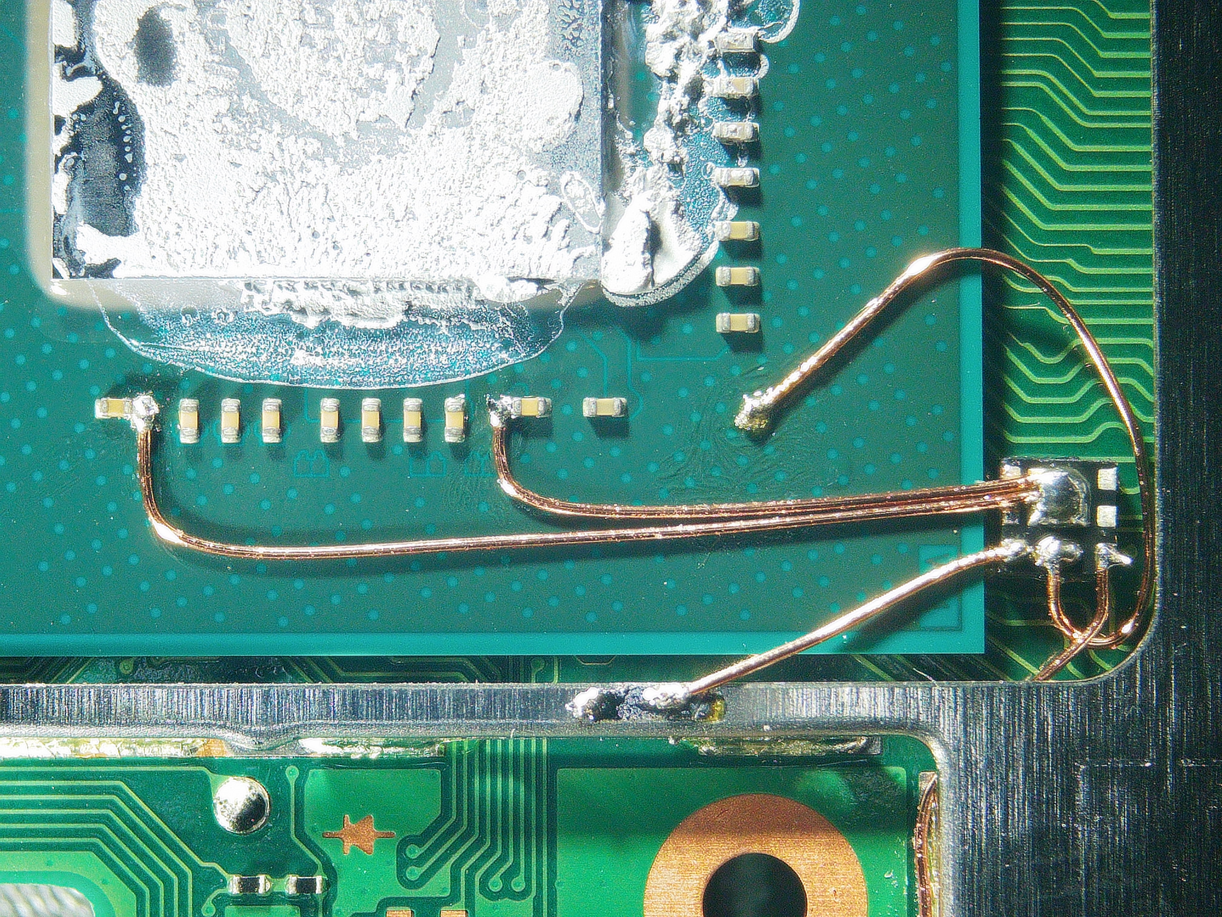

Probably 1-3 seconds. 0.2mm magnet wire from mosfet to drain and source, then 36awg from gate to tiny.

In my experience, glitch time is mostly related to the mosfet setup. I've tried all combinations of everything (mosfet on front, back, double or single, different wire thickness, wire length etc) and the setup that I find performs the best (tested across many switches) is 0.2mm thick wires attached like in the picture.
0.2mm is risquy man in these conditions, but so you probably have more soldering experience and tricks than me...

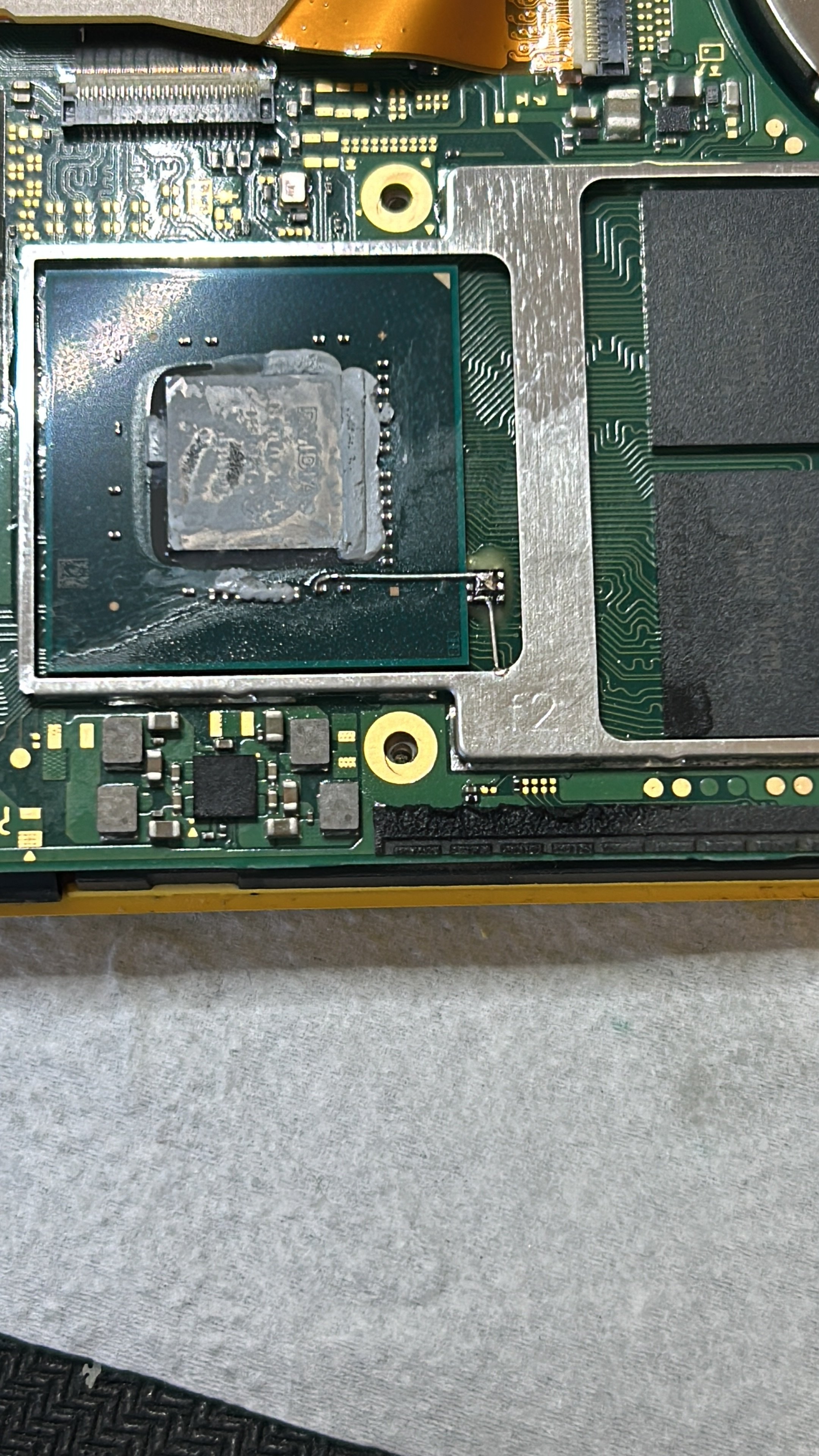

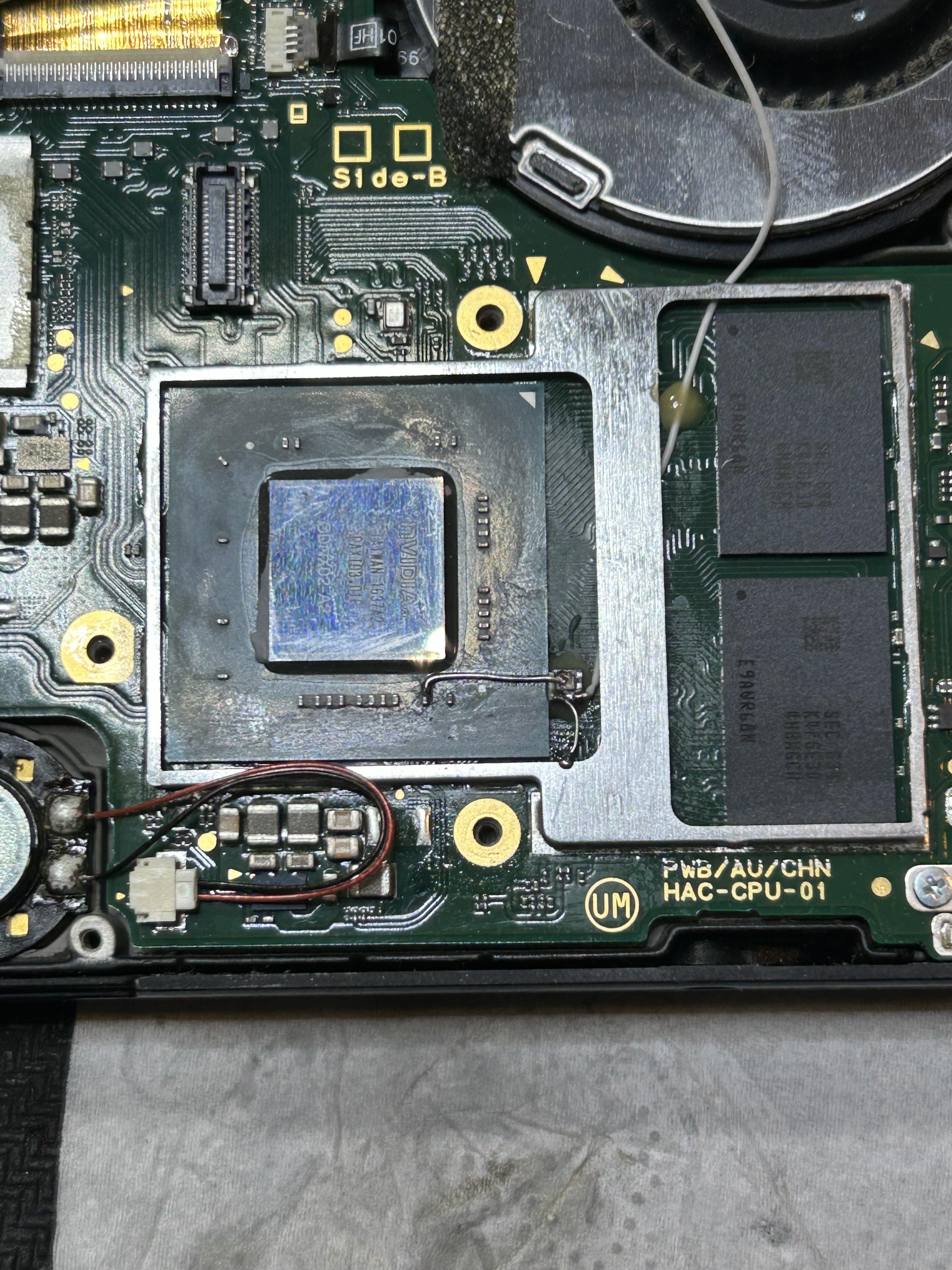

I had always chose for the single MOSFET directly on APU. The results are almost always instant boots.
