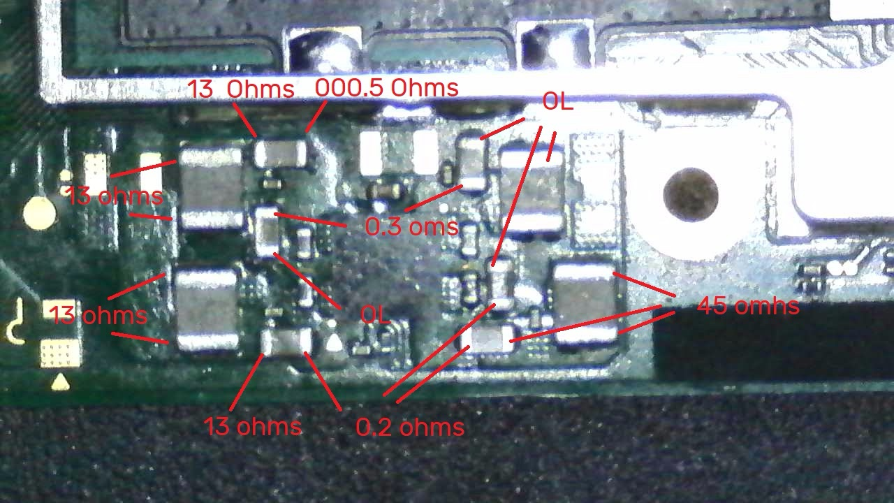

I noticed that around the Max chip, just below the APU, quite a few components seem to be shorted. But I think they have such low resistance that they behave as if they're shorted. Is it possible to confirm this?
Some of those capacitors are low impedance capacitors.
Measure the resistance to ground to see if they measure something like 25 ohms.
If you get 0 ohms then you have a short.
Otherwise they are fine.

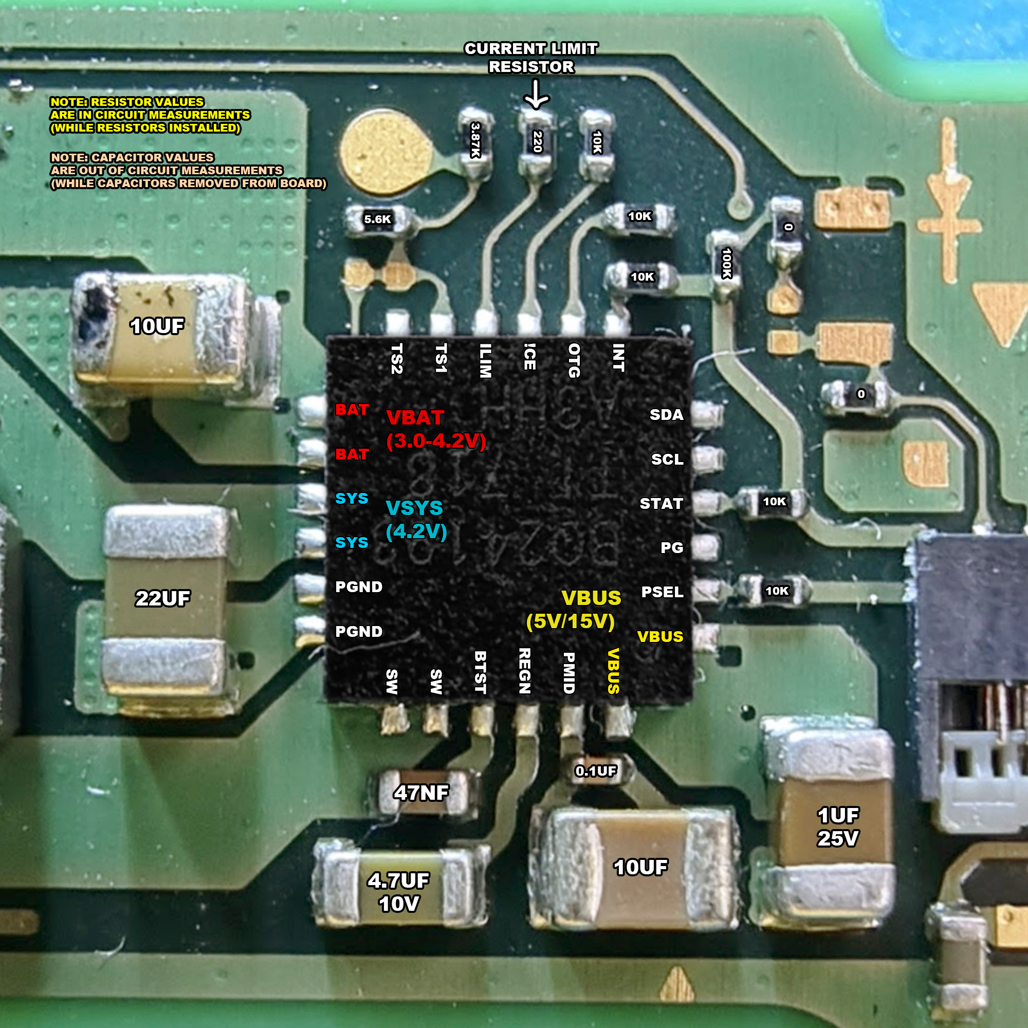

These are the expected voltages on the BQ charger ic :
Next I would check whether the voltage rails are fine before thinking about reballing the emmc.

i've take measure around MAX under APU :
On BQ chip, i have 15V on VBUS, 4.2V on VSYS and 4.2V on VBAT.
I'll take measure on the other MAX chip tonight
thank's again
I took measurements on the other MAX CHIP :
I don't really know what to deduce from this.
