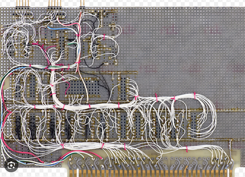

>>Magnet wire is a very thin wire.
When you get older, you come across many things and conclude that it is perfectly OK to use magnet wire.
Even in the 80's one would occasionally come across something this like this :

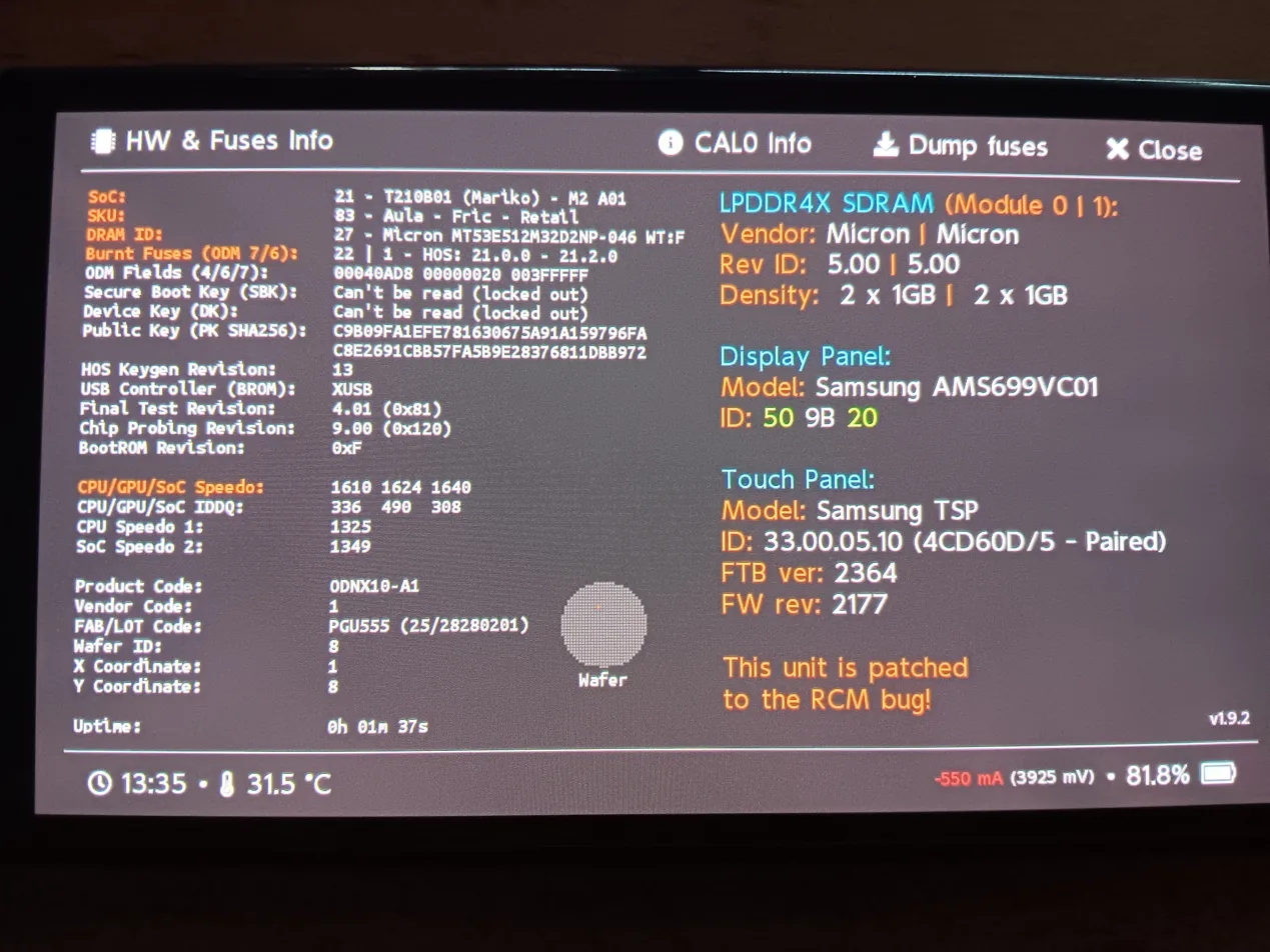

Mariko OLED Picofly - all boot options black screen, persists after verified NAND restore
Switch OLED (Mariko, ODNX10-A1, codename Aula), Picofly modchip installed by family member.
Symptoms:
  • Hekate 6.5.2 boots fine to launch menu
  • All three launch options (Atmosphère emuMMC, Atmosphère sysMMC, Stock sysMMC) black-screen during the loading handoff
  • Holding Vol+/Vol- to bypass chip shows Nintendo logo briefly then black screen
  • Was working at some point in the recent past per family member who installed it
Specs:
  • HOS: 21.0.0 - 21.2.0
  • Burnt Fuses (ODM 7/6): 22 | 1
  • Atmosphère 1.11.1 (clean install)
  • Hekate 6.5.2
What I've already tried:
  • Wiped SD, fresh install of latest Atmosphère + Hekate. No change.
  • Restored a verified NAND backup from 11/13/2025 (when console was working) — full RAW GPP, BOOT0, BOOT1. Hekate reported successful and verified.
  • Before BOOT0/BOOT1 restore, Stock sysMMC threw "pkg1/pkg2 decryption failed - pkg1/pkg2 mismatch or old hekate." After completing BOOT0/BOOT1 restore, all three options just black screen with no error.

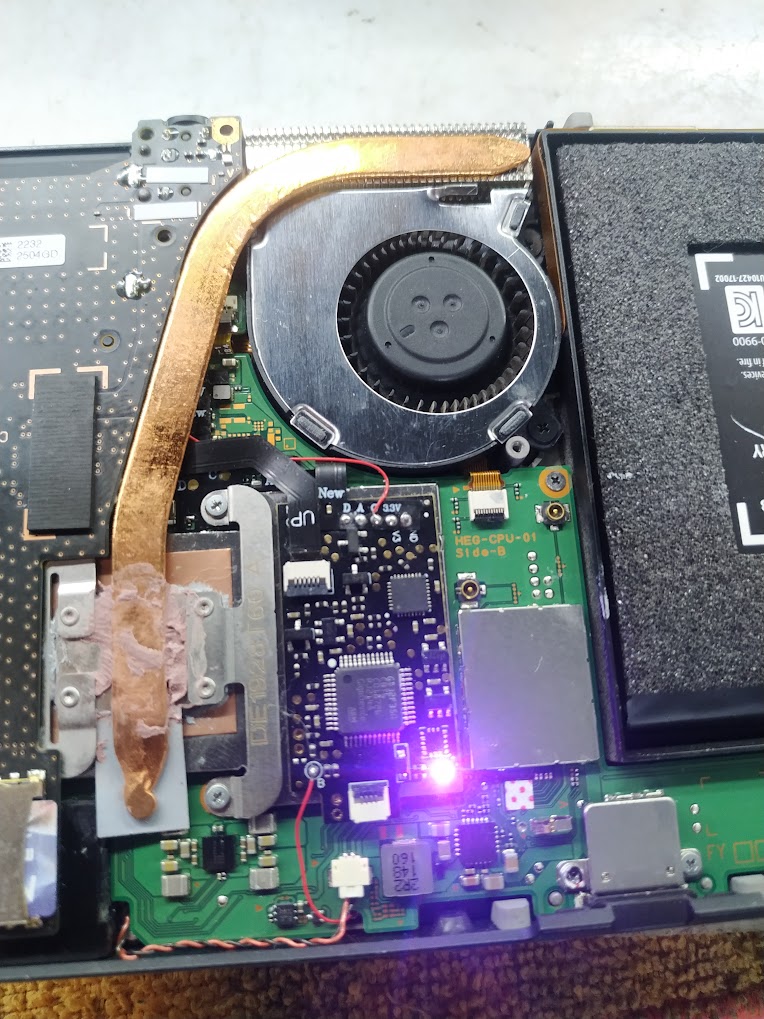

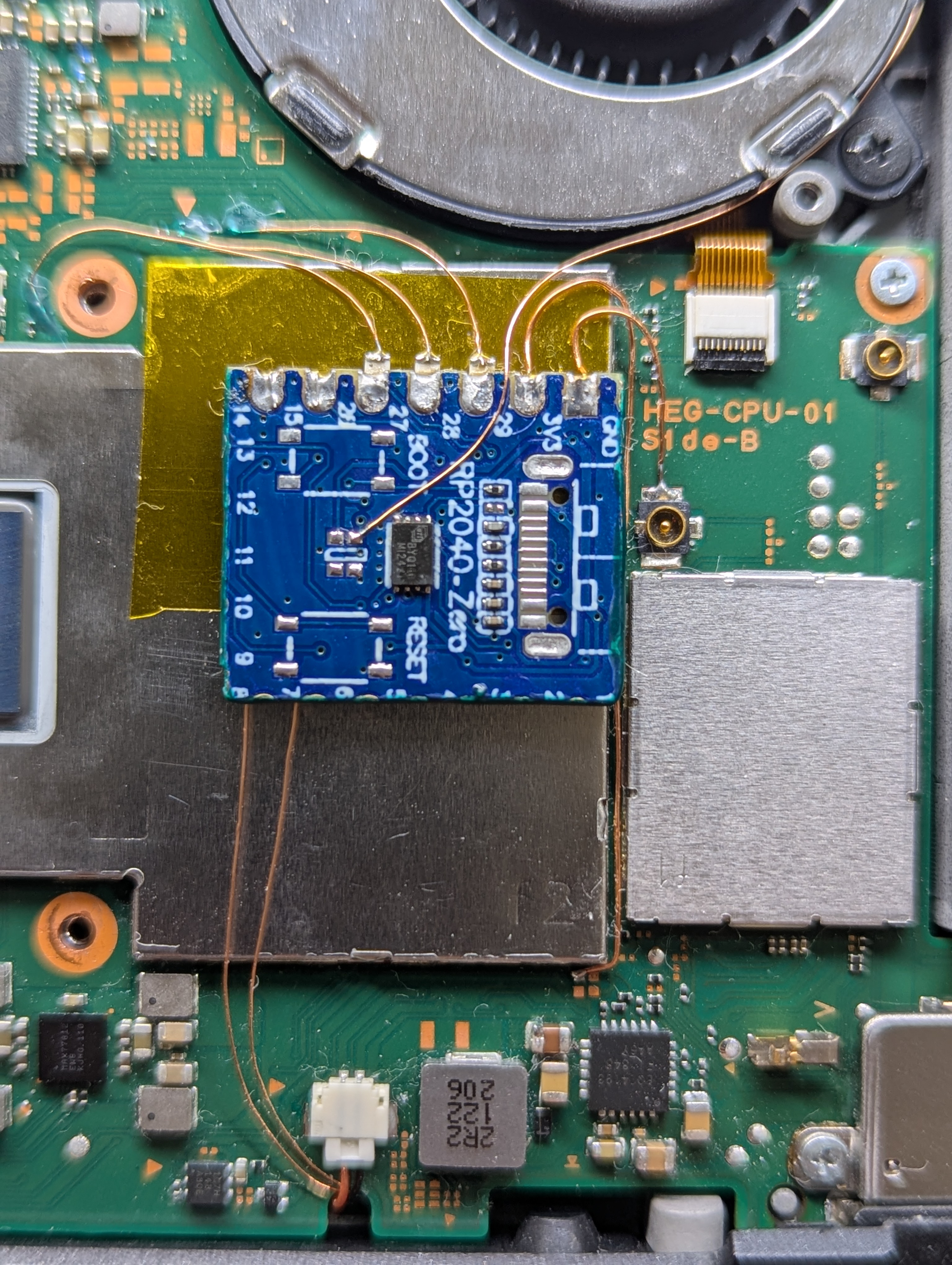

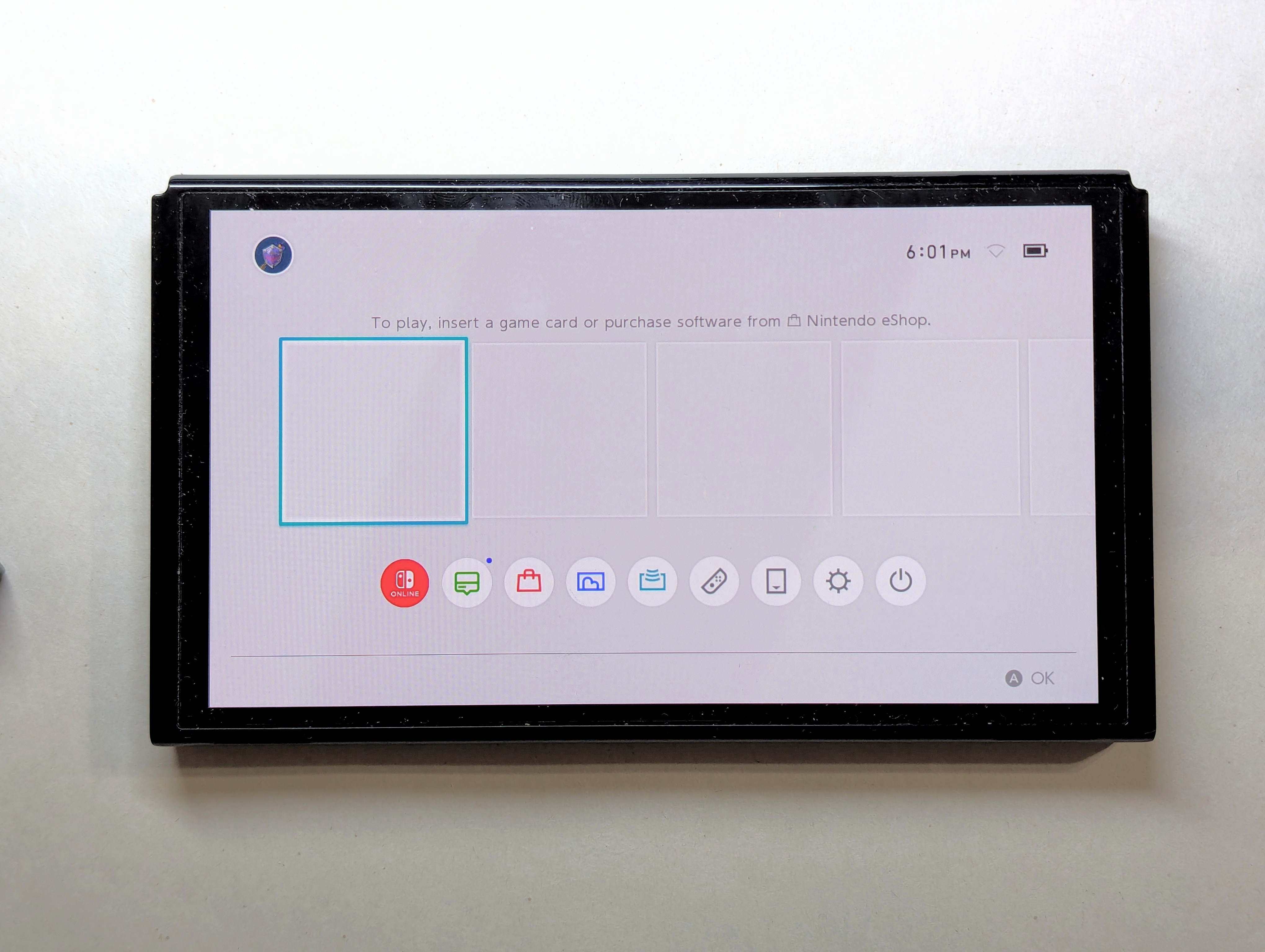

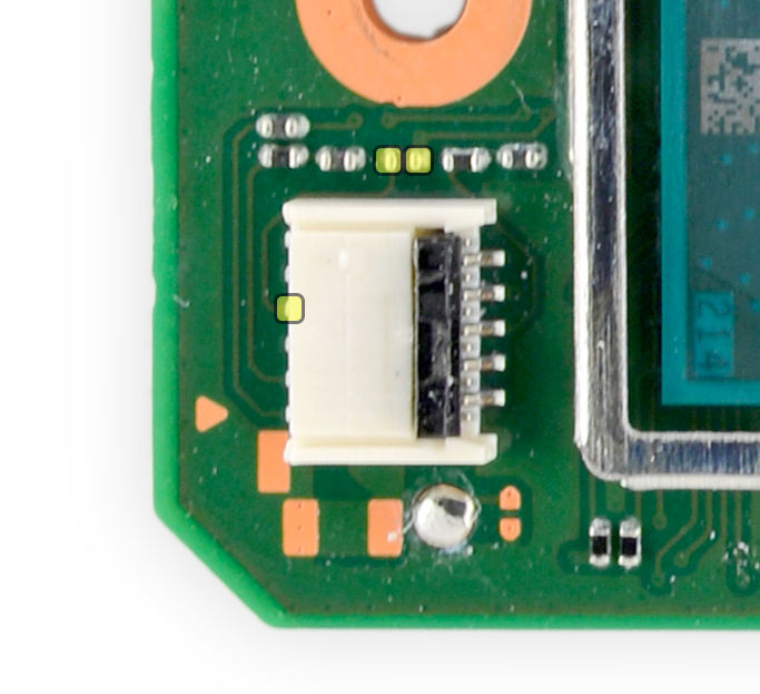

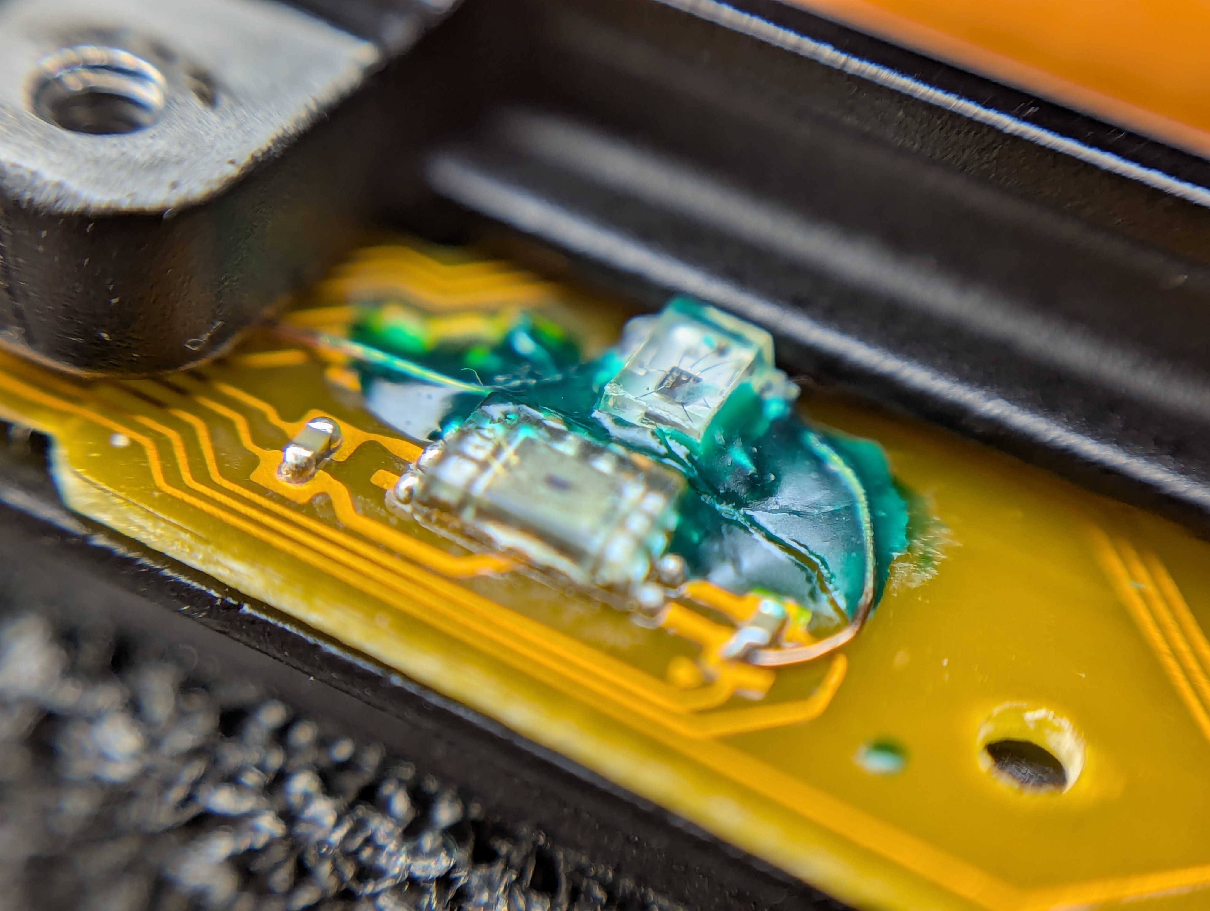

I needed to disassemble my own OLED to diagnose a board repair I was doing on a different OLED, so I thought I would post my own picofly install while I had mine open, as well as the repair. I used a trimmed RP2040-Zero with a kamikaze drill for DAT0 and a single rear mosfet, and relocated the status LED to the light sensor area, so you can see the LED through the light sensor window.

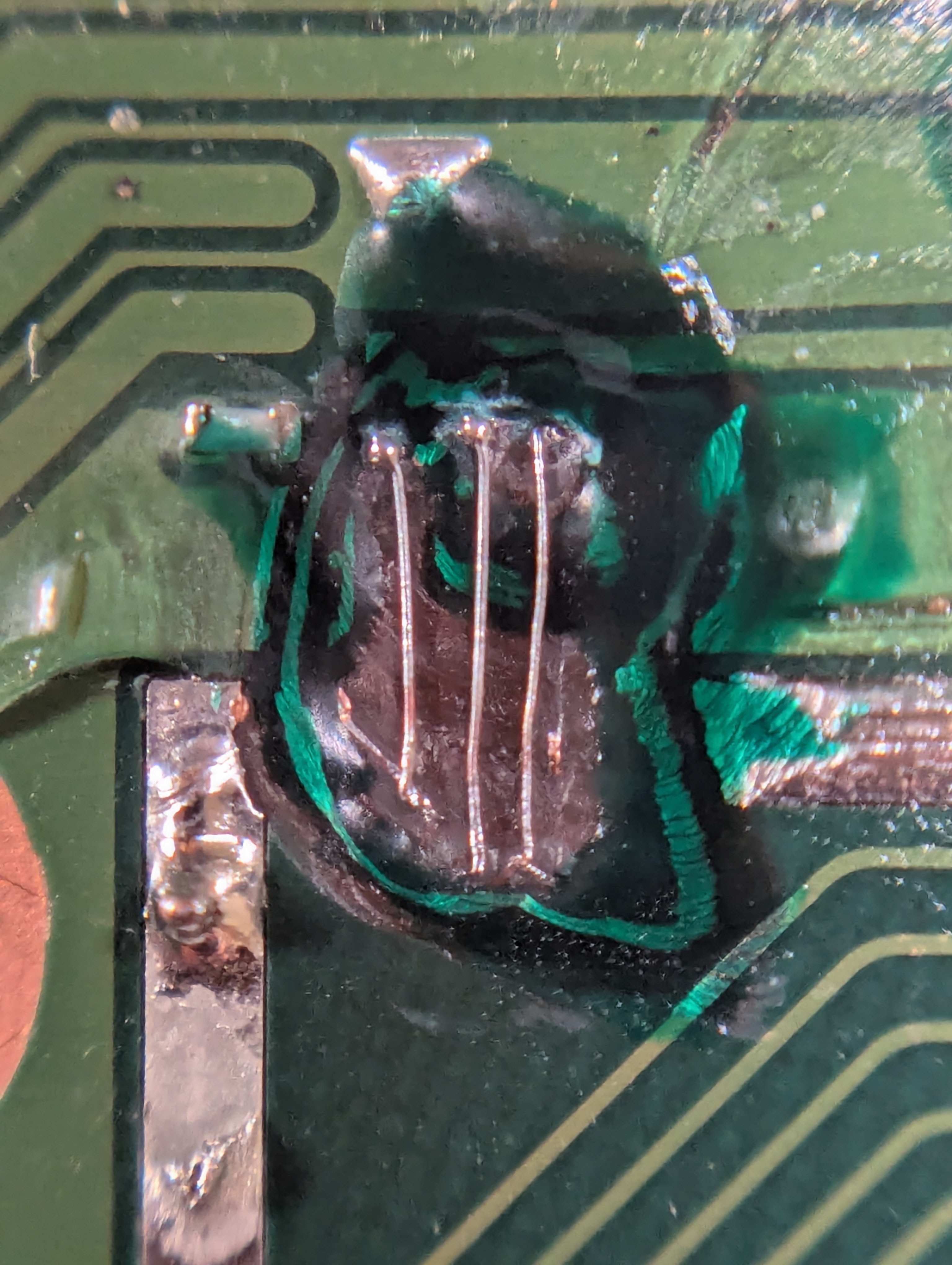

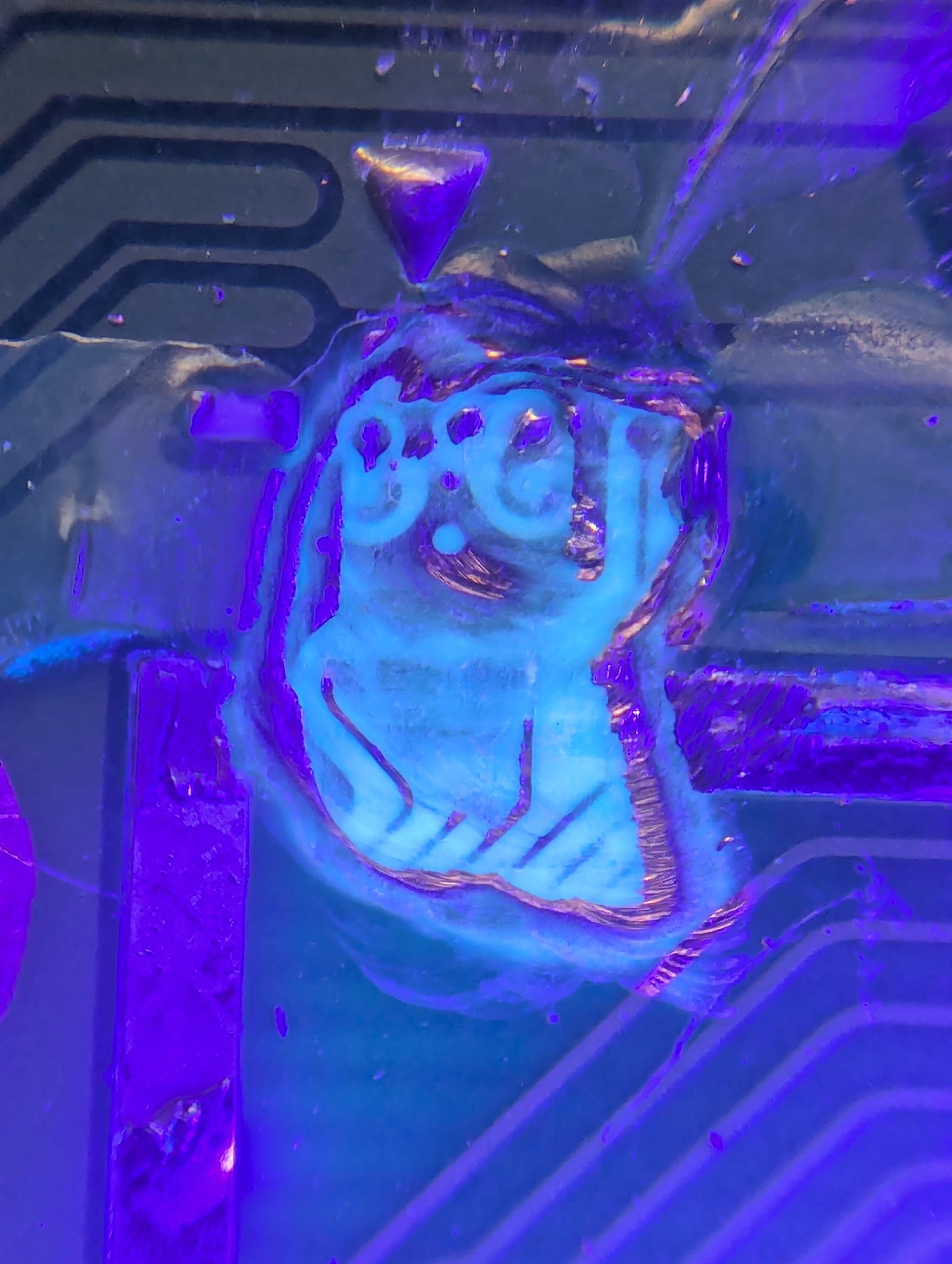

as for the repair, it was from a lot of boards that were all failed kamikaze attempts by a different, uh, "installer"... several of the traces going from the SOC to the EMMC were severed here. I was able to drill out the surrounding area and restore the traces along with some other rework; after successfully booting and testing all functionality, that switch passed a three day docked stress test and seems to be stable. this was my first time attempting a kamikaze repair, and I am happy I was able to do it successfully.
View attachment 572909View attachment 572916
as for the repair, it was from a lot of boards that were all failed kamikaze attempts by a different, uh, "installer"... several of the traces going from the SOC to the EMMC were severed here. I was able to drill out the surrounding area and restore the traces along with some other rework; after successfully booting and testing all functionality, that switch passed a 24 hour docked stress test and seems to be stable. this was my first time attempting a kamikaze repair, and I am happy I was able to do it successfully.
View attachment 572929View attachment 572931
Hey there.
Nice repair and very nice idea with the location of the stsatus LED!!!
I installed one in the right joycon, but the problem with this is, that you get some connection problems sometimes...
Is thr single rear mosfet installation working properly? I thout about it but i read that you should use a double mosfet installation...

hi, I'm the one who originally prototyped these LED relocation mods (OG switch (follow-up, speaker alternate), lite, joy-con), with my previous post being my first time showcasing a version for the OLED, as I didn't have a personal unit until recently. following my post about the joy-con, I wrote on how I also found connection issues, and due to the extremely narrow application of the joy-con install, I did not have the motivation to troubleshoot it, and only recommend methods that relocate the LED within the console itself.
as for the single mosfet, it has not given me any issues; you can see from the attached video in my previous post that boot times are good. double mosfet is additional insurance in the scenario of a weaker mosfet being used, less than ideal soldering, or particularly finicky consoles. a single, well soldered, suitable mosfet should be fine in most cases

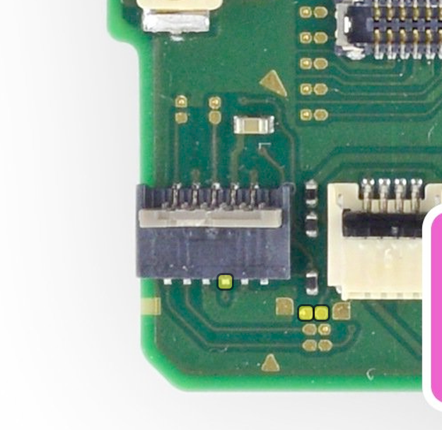

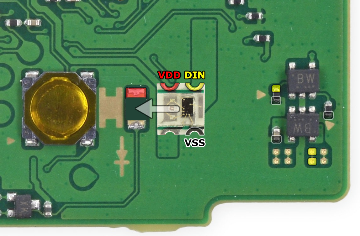

here is an updated diagram for the joy-con status LED mod which uses pin 5 (serial data console -> joy-con). I originally ruled out this pin as I assumed it would interfere with the joy-con's function, but in testing the only issue I have found is that the attach/detach animations do not play. if you wish to test it, please let me know how it performs for you and if you notice any issues.
joy-con: (any of the highlighted pads are okay to use for their corresponding color)
DIN point on the RP2040-Zero:
points to connect the DIN line from the RP2040-Zero (V1/V2, OLED):
