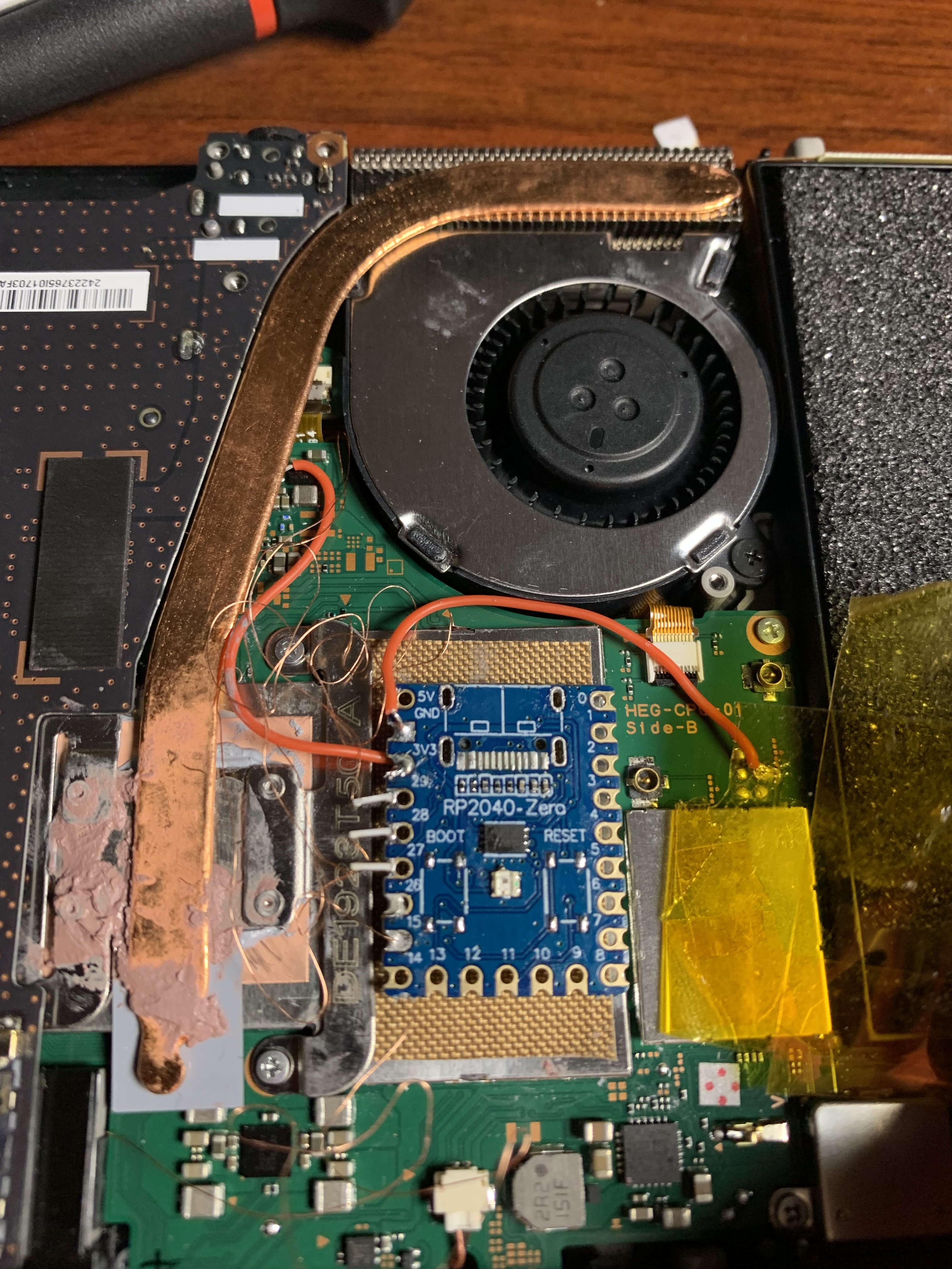

Okay so you’re right, I opened up my switch and it looks like there’s a lost connection to the RST and potentially D0. Should I ask my modded to re-do the whole thing? The way he attached the resistors look different from how everyone does it.
woW, those pasta looks so fantasy
Those wires do look a little long too. Also I ran into a problem lately where my chip was shorting/reloading into heakte suddenly because it would touch the heatshield metal bracket every time i pressed the back part of the switch. Was so lucky that i pinned the problem down. Solder masked those points and fixed it. Potentially your problem too but man....how much did you pay for that job!? But I would say to him to reattach those wires properly rather than telling him to re-do the whole thing.
I paid $70 haha, he’s never done it before but had micro-soldering experience.
How about the resistors? Aren’t they awkwardly placed? I see people place them flat on the board, but it looks like he has them kinda hanging on the side.
Every chef has their own recipe.
Every modder/hacker have their own style.
For example, i prefer enameled wire. Other might choose insulated wire. Its preferential.
Price ain't bad. Yeah, resistor work is weird to put it side ways like that. Best of luck with it.

This might the worst looking install anyone has ever charged money for.
weird resistor mounting method, no kapton tape underneath them basically asking for something to get shorted, and wires so long they curl up into balls, wtf?
U paid money for that?.
I don't understand how people offer installing a mod chip and don't even try to make it look nice and take some pride of there work......
It doesn't really matter how much u paide.
If he had micro soldering experience then he has enough experience to know that this install is a peace of crap.
Bring it back and tell him to fix it while he is at it say u want him to get rid of that spaghetti ....
